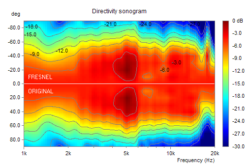

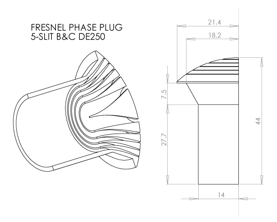

Tome the top octave looks noticeably smoother with the stock phase plug.
... see below graph normalized to flat power. Better repeat on SEOS and baffle.
I find it hard to judge the directivity performance of anything other than a spectrogram normalized to flat on-axis response.
I'm not sure why, but I also find the stepped shaded graphs harder to digest than the previous smooth shaded ones.
Thanks for all your effort, jzagaja.
ARTA directivity sonogram.

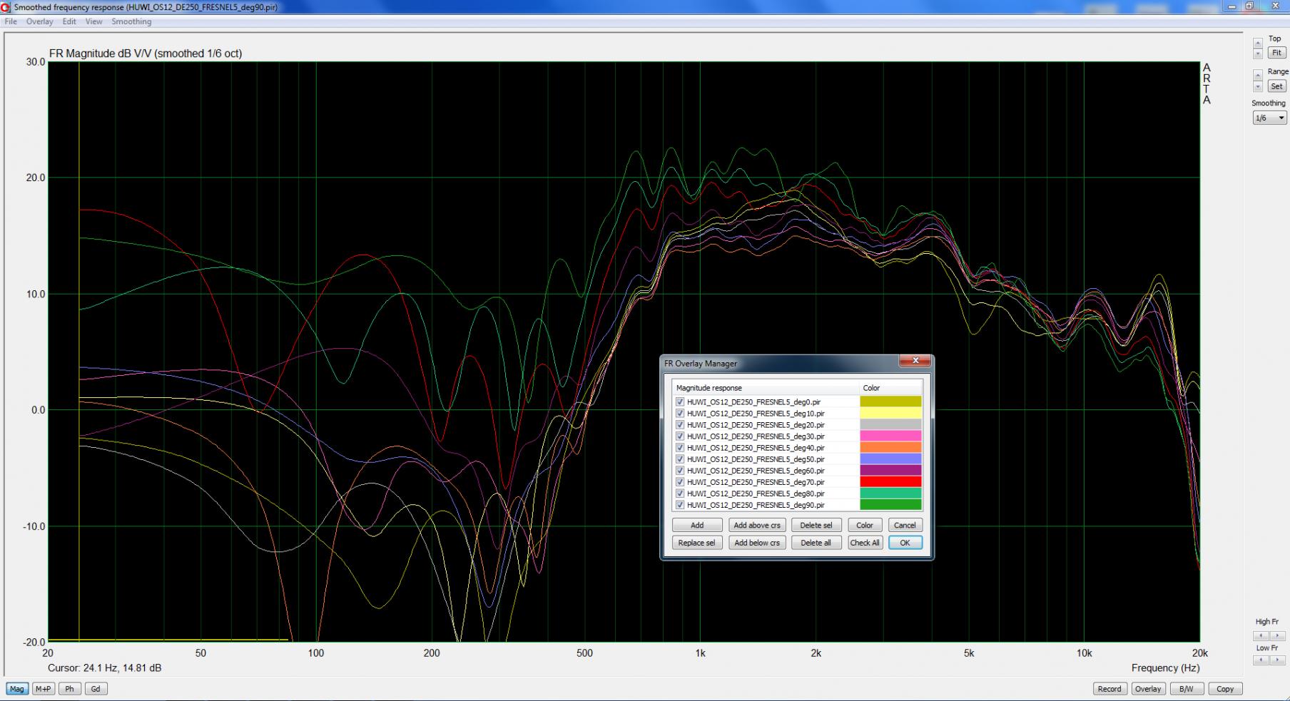

Hello jzagaja,
I get some strange results looking at the raw data. I had to convert your files to pcm-format with Audacity before Arta could read them. But there seems to be something strange with level, as the higher of axis measurement are louder than the on-axis measurements. Did you make the measurements with Arta, of did you use some other software?

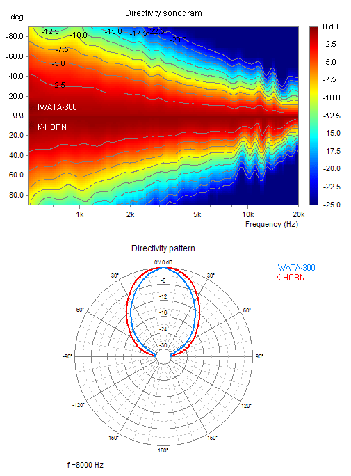

K HORN
Hi
i just saw the K Horn on the autotech page and was wondering if someone has more details ???
how do they compare to the iwata 300 regarding directivity ?
how do they sound w/ radian 950 etc. .....?
oh yeah and of course , what's the price ?
malcolm
K Horn vs. Iwata
Thanks for the comparison graph.
you say : to be used instead of JMLC-400 .
jmlc-400 has a recommended xover point of 600hz , KL51 has min rec. freq. of 400hz .
i thought i can take the KL51 down to 400/500hz according to autotech page .
have you had a chance to listen to KL51 ?
any comparison to iwata 300 re sound ?
