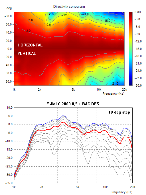

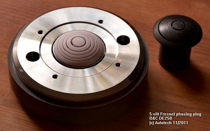

It's rather good when phasing plug length is equal or smaller than dome radius and transition between channels and waveguide contour is smooth? This require inverted type driver, maybe some neodymium could work. Go back to the roots (WE555).

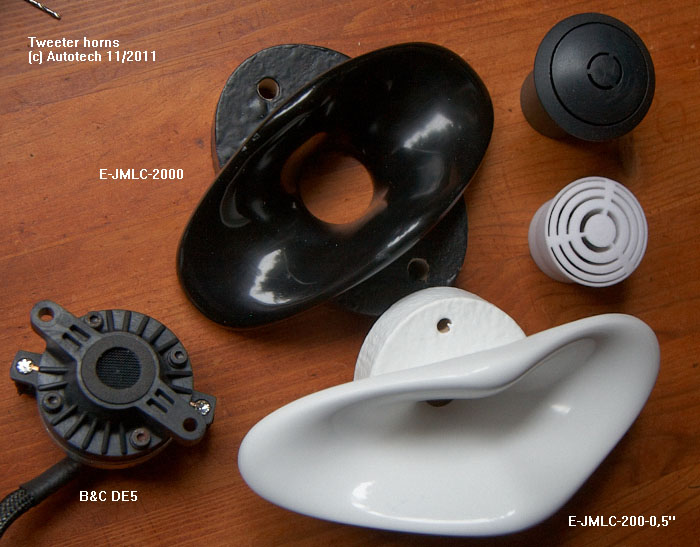

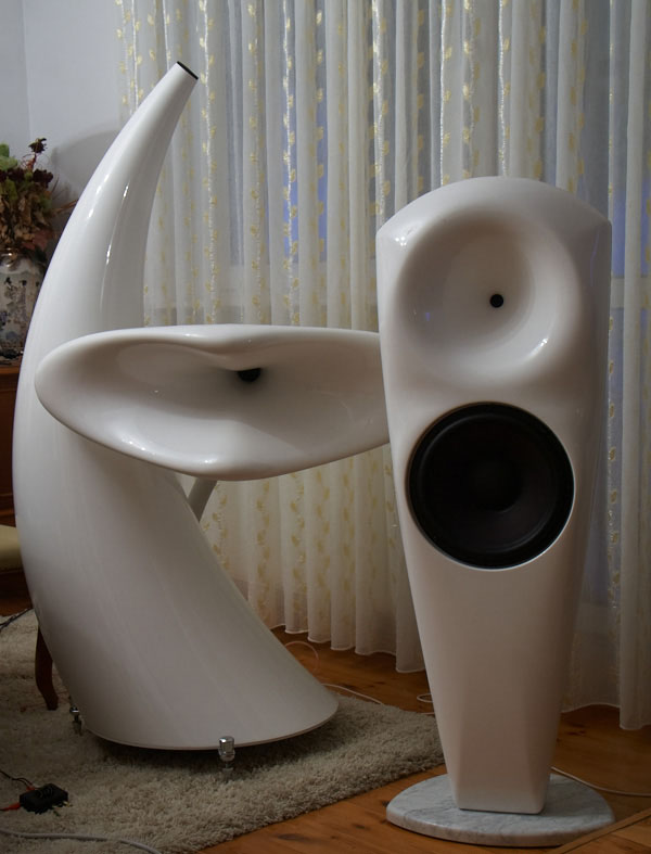

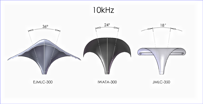

Thank you for the answer,

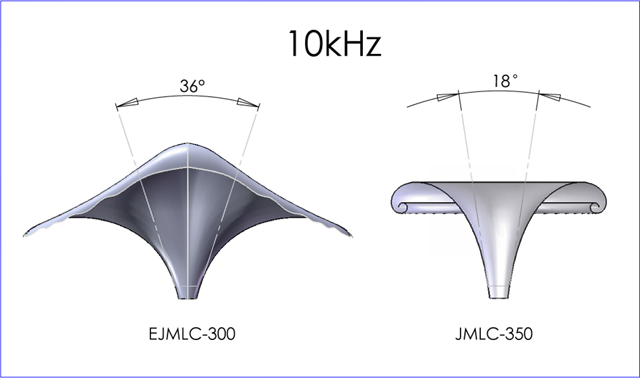

Have you similar schema regarding the iwata300. It is very useful for me to make choice for one of the horn above..
Actually, I am using a TAD 4001 CD coupled with my wooden Diy bi-radial horn (similar to the TAD TH-4001), the plan was provided by MJ magazine in Japan.
A couple of year before, I had the opportunity to hear and compare by switching my horn and with the Jmlc horn by 'Musique concrète' with my set up. I was very impressed by the musical quality of the jmlc horn. The musical enjoyment still remain with me, I guest that is the quality of the jlmc curve calculation.
For this purpose,I had dropped some word to Jean Michel Le Cléac'h at one HI-FI show in Paris.
One more question: what is the pricing+shipping of a pair of ejmlc-300 horn. Ship to France.
Van Loi

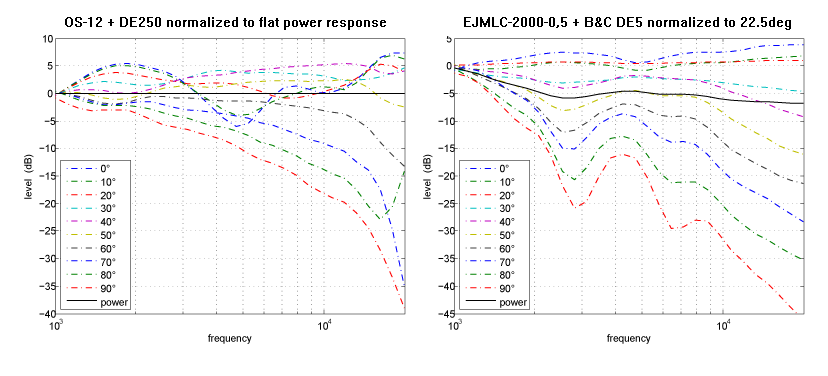

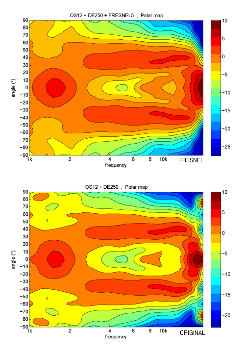

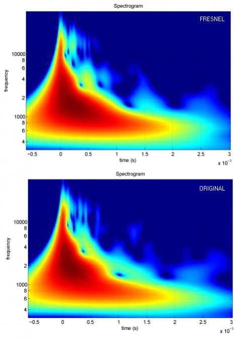

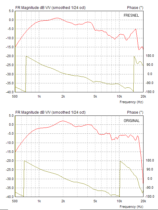

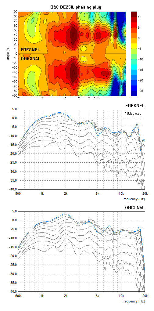

Good question. BC has minimized cone breakup so it doesn't peak in power response but Fresnel seems to have slightly more even phase and directivity - see below graph normalized to flat power. Better repeat on SEOS and baffle.
