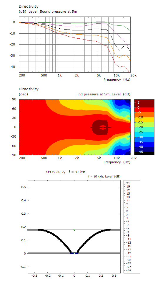

Waveguides and horns

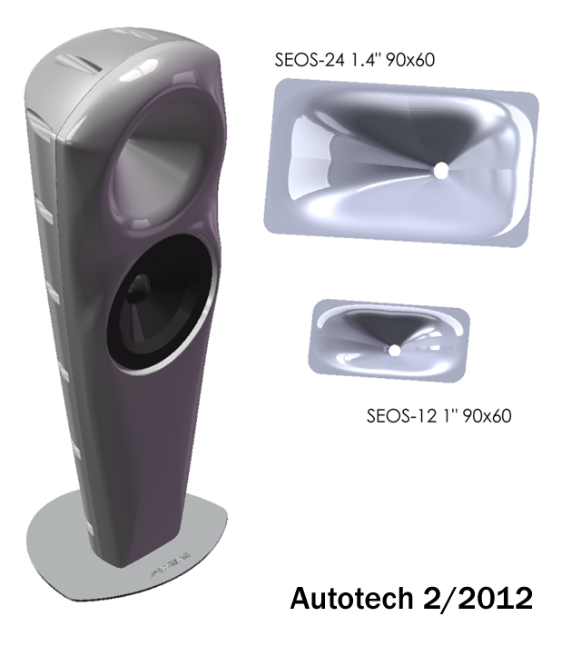

But I've been working on 3 other nice compression drivers a bit more extensively trying to get them ready to go. The company that supplies the diaphragm has been pretty darn good so far in making changes as needed and I believe they're at the final stage, so I ordered the parts in the past 2 weeks. My guess is that most of the first run will sell very quickly to go with the plastic SEOS-12 that's coming soon. 😀 There's going to be a big pre-order set up in the next few days for the SEOS-12......if you've been following on the AVS forum where it all started. I'll also be giving away a bunch of left over stuff from group buys I helped with last year. Even some JBL pro gear. Should be fun.
