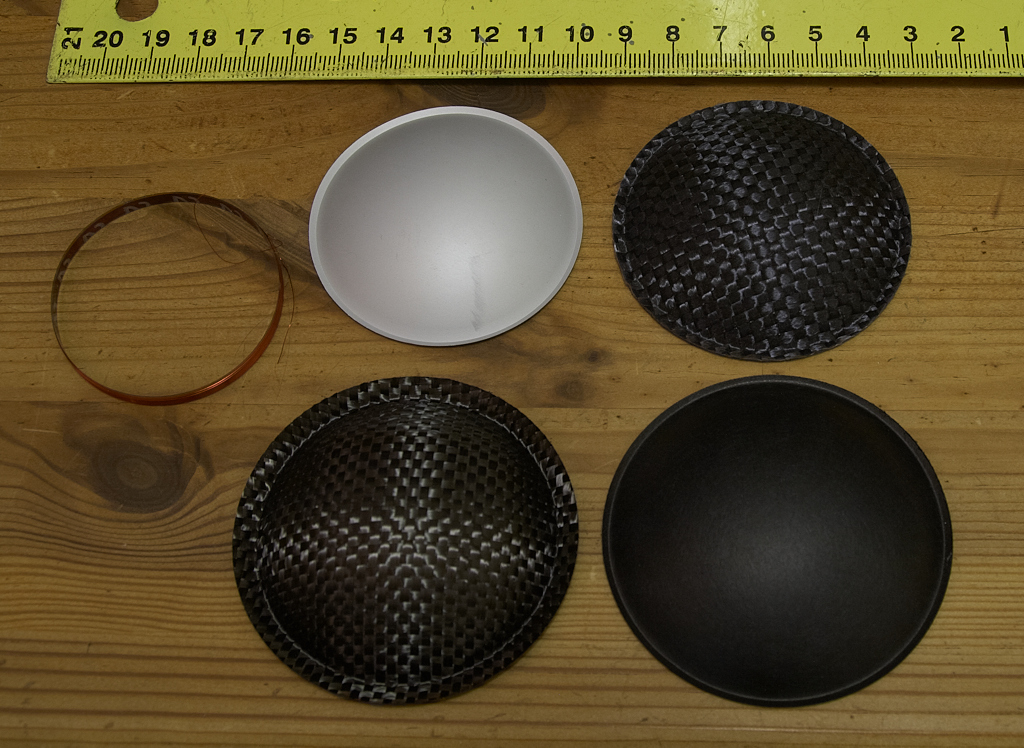

Cellulose, carbon and alu domes, different size and 44.5mm coil. Time to make same moving coil diaphragms ;-)
Optimum dome height ~8mm@44.5mm diameter for OS means HF roll-off frequency, also mismatch between phase plug curvature and diaphragms forms different roll-off e.g. differences between 18sound diaphragms and STX.

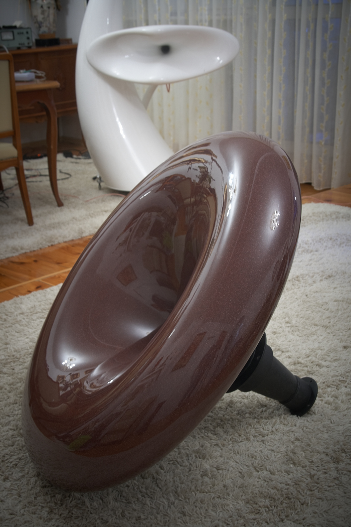

Nice set up you have there. Can you give some specifics on the drivers in the VOT boxes and the crossover? Are you using the original Iwatas that does not have metal reinforment in the driver flange area? I am wondering about long term stability of the horn hanging off the drivers like you have. Do you think they will hold up over time and not develope fractures in the stressed areas?

Hello David,
Those are the original IWATAs that did not have the metal reinforcement ring. They were weak. In fact one of mine broke. The waveguide pulled completely free of the MDF mounting ring. When I made the repair I added fiberglass to build up the transition from MDF flange to waveguide. The fix worked and I don't think there is much of a chance that they will come apart again.

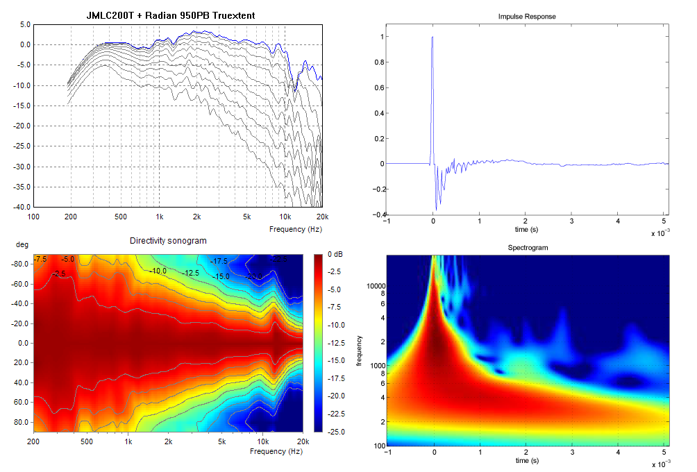

4590 - 1uF on HF unit out of phase, no crossover on rest. Hard to tell subjevtive difference as i have only one Radian, BMS has more sparkle. Radian look is awesome and it's light.
Cheers for that info. Not the way I'd use the 4590 myself: I much preferred a a steep active xover at 6k5. Notwithstanding my preferences, most people would have something more there than what you have, so not too much should be made of the comparison between it and the radian, based on that.
