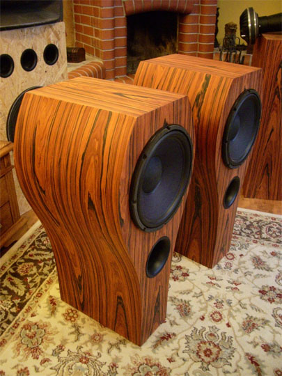

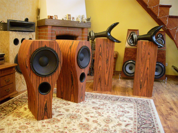

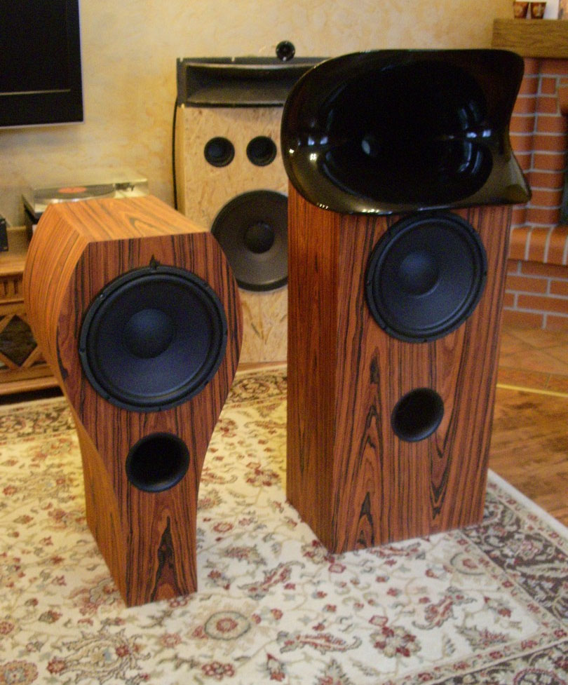

Beyma Power 15 in a closed box (5.5 cu. ft.)

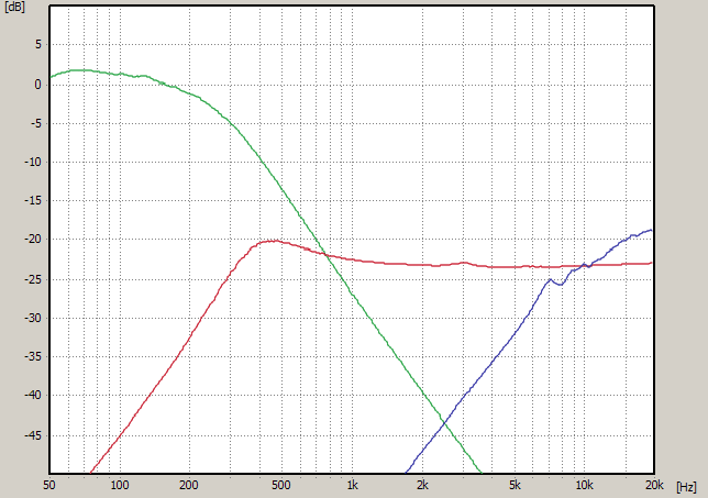

What is the x-over point to the BMS coaxial comp. driver? A down firing woofer, I imagine, could result in problems with the lower mids when crossed too high, but am guessing it represents no issue in your case.
Nice to see a closed box configuration.
EDIT: with regard to sonics only, I'd recommend you may try removing the banana plugs from the wires to the BMS unit. Maybe it makes no difference, maybe you've tried already 🙂
Crossover points (acoustical) roughly 350Hz, 6500Hz.
