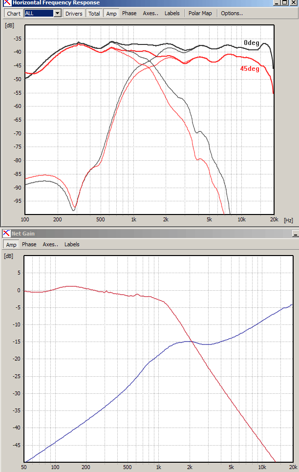

Crossover for SEOS-10 Flatpack ready for voicing. Time to make large Flatpack (JBL Everest style) for 1.4" drivers.
In a nutshell (DE250+10CL51+SEOS-10 Flatpack) - reference mid and highs, perfect blend, high sensitivity, bright airy powerful but no sibilance, requires sub (Rythmik?). I want one 🙂

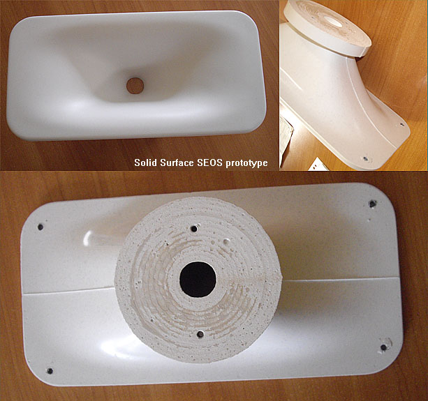

Perhaps a stupid question, but what does "Flatpack" refer to? Are there serious plans to make the larger "Flatpack" version you mentioned above?
SEOS-10 Flatpack:
http://www.diyaudio.com/forums/group-buys/166312-waveguides-horns-101.html#post2939927
made out of solid surface, as a kit for self assembly initiated by Erich (diysoundgroup). Cost unknown yet as it's prototype but for masses so keept low. Larger will come later.

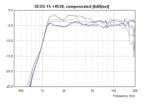

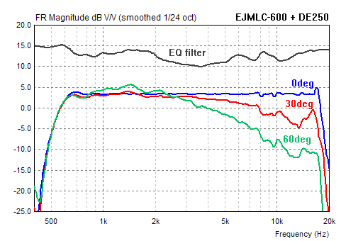

A little play with Acourate. SEOS-15+4538 equalized to 20deg (EQ filter not shown) versus ejmlc-600 + DE250 (EQ filter shown) equalized to 0 deg in a range 600-16800Hz.
Hello Jack,
http://www.diyaudio.com/forums/atta...d1332454599-waveguides-horns-ejmlc-600-eq.gif

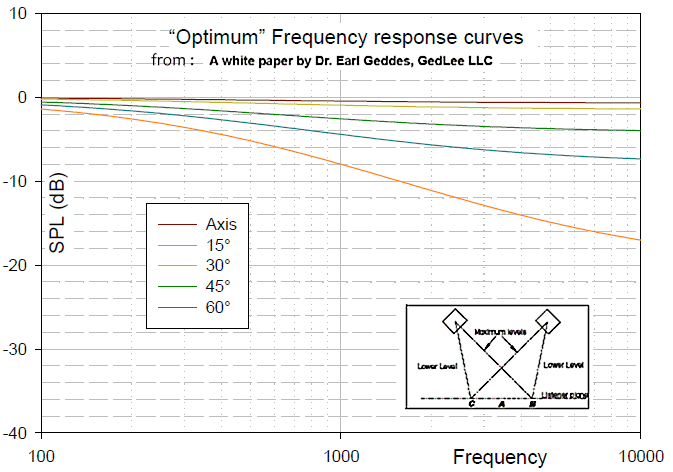

to be compared with the optimum frequency responses curves for stereophony defined by Earl Geddes in his paper on directivity :
http://www.gedlee.com/downloads/directivity.pdf
see figure N° 11
Here attached figure 11 (from that paper, copyright Earl Geddes)

I think that you are taking my data a out of context. The lower figure in yours (the room/speaker layout) has nothing to do with the main figure, the two are describing different things, but you are linking them together. The curve that you show is not "optimal" in the sense of "desired" (I will admit to using the wrong words in my paper - I will correct that) but they are examples of what should be expected given some physical limitations of acoustics being described - namely that the lower frequyencies cannot have directivity but the higher frequencies always will. Hence, the purpose of figure 11 was not to show the "ideal" but to show what is likely to happen.
Thanks for pointing this out as rereading the paper this section could easily be misinterpreted as you have just shown. I will correct it shortly. To represent what you are trying to say they do represent, the curves should be much closer together and flat not curving downward.
