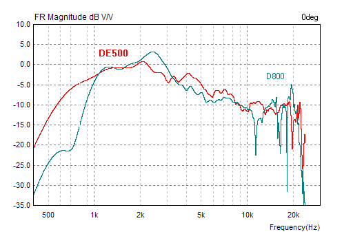

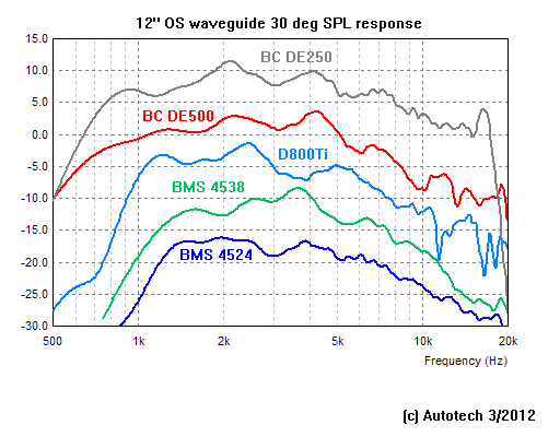

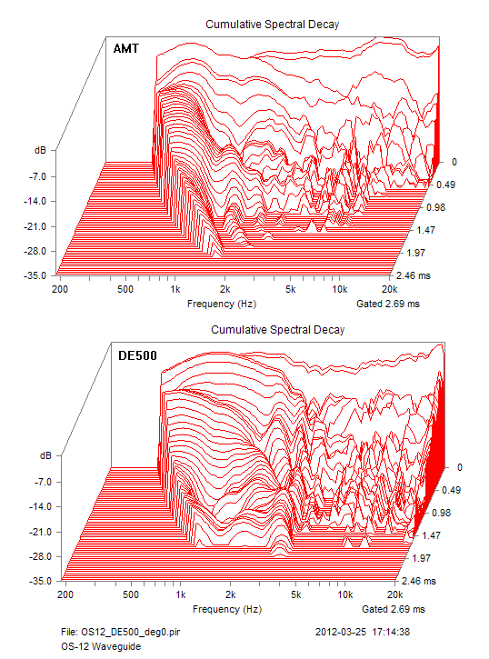

Different drivers on 12" OS waveguide (30deg).
Thanks for providing these measurements.
The metal cone-equipped drivers, DE500 and D800Ti, have a somewhat "nervous" response above 10kHz - especially the latter, which I gather is break-up modes in the diaphragms, though it seems they may have an advantage in ultimate extention compared to the polyester cones. With the exception of the BMS 4524 all drivers have notable peaks in the upper mids, whereas the 4524 has a slight dip around 3kHz - though still by far the most well behaved of all.
Being that I have heard both the D800Ti and 4524(incorporated in my current iteration of the Auto-tech Mummy 2's) via named waveguide their measured performances correlate quite well why my listening impressions. In fact the 4524 appears to be more extended as well, though it may have more to do with its performance here being better differentiated and notably smoother.
D500 rings slightly near 20kHz while D800 between 10-20kHz. Trying to get NSD1095N. New 18sound beryllium driver is now listed on website.
That's some nasty break-ups from the D800. The DE500 curve looks very respectable, actually, and the near 20kHz break-up here mayn't be cause for much concern.
The 18sound beryllium driver sports a 4" VC, doesn't it? Well, if JBL can squeeze their 4" beryllium driver in the Everests to reach some 15+kHz, supposedly in an acceptable manner, why shouldn't 18sound be able to do so with their driver? Perhaps I'm holding on naively to the hope of seeing a 4" compression driver going unassisted towards the 15-20kHz region...

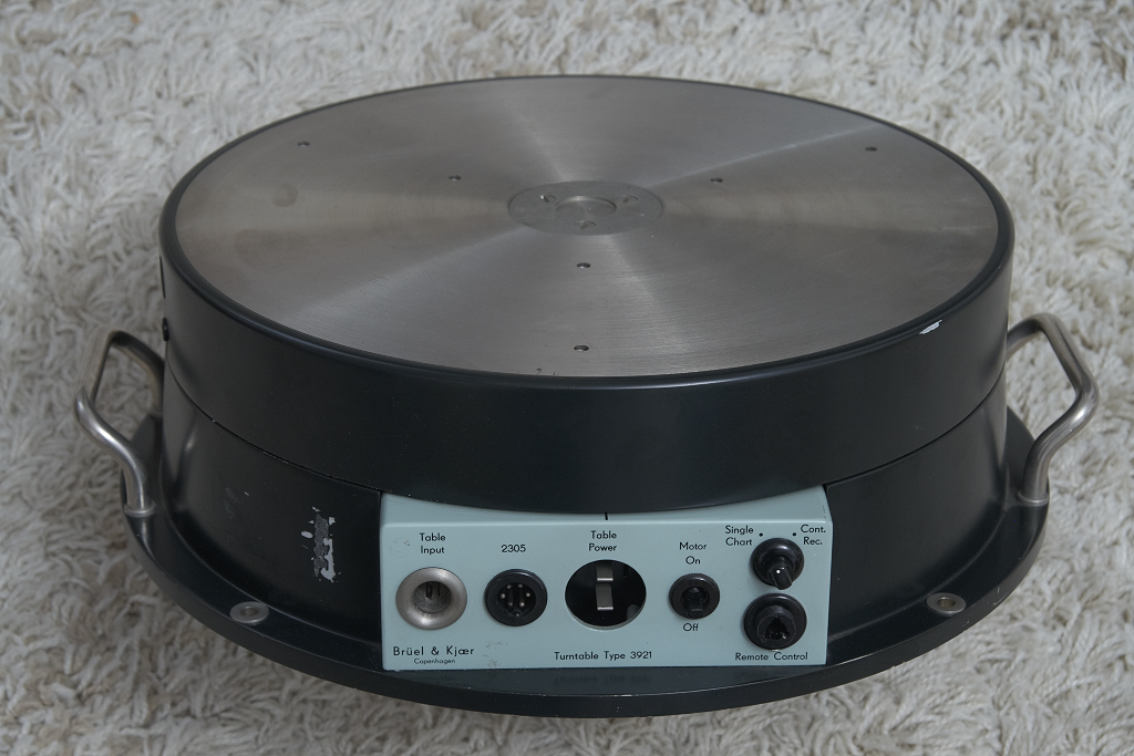

Hello,
I am also working on an automated rotary table (nearly finished). It uses a pic microcontroller that communicates over USB. The USB framework came from this excellent site:
Open Source Framework for USB Generic HID devices based on the PIC18F and Windows - WFFwiki
Status so far:
- C# test application in finished. It can servo control a motor with encoder (I used a pittman motor from Ebay)
- Rotary table is mechanically finished
- Now working on Auto-it script to control the rotary table and Arta automatically
Goal: take polar response data with 1 mouseclick
When finished I will post code here on DIYAudio.
