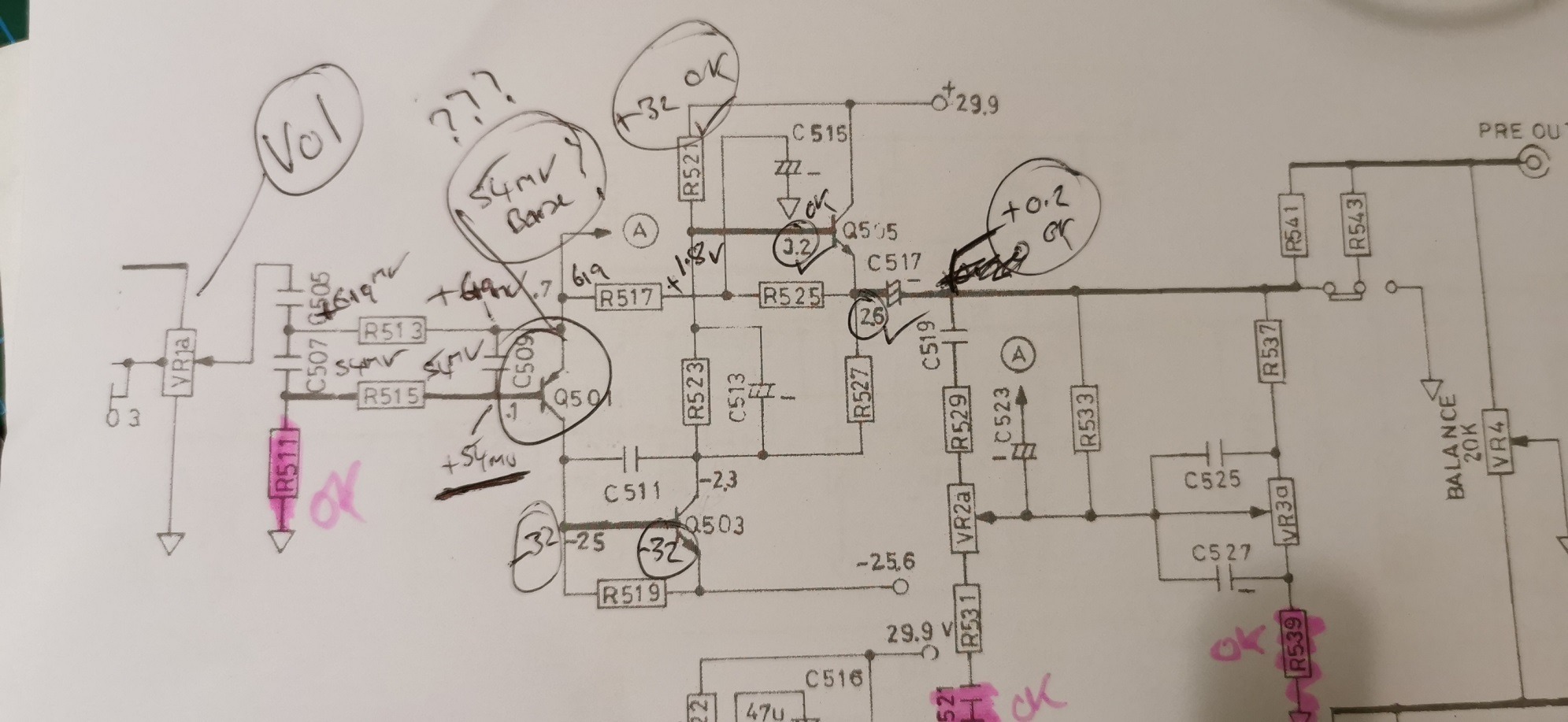

im concentrating my efforts elswhere now.Ive has suspision about the volume control, or what it does directly to affect the centre .
0 ohms to about 5k (quarter turn) centre stable at about 2mv, but then the more you increase it, it just goes crazy and both channels are affected, although the left is worse.when at anything more than 1/4 turn its anything from -200mv up to +1.2v
I dont think it is the control itself because i took it out and checked it with the meter and both sides seem pretty consistant when i dial it up and down.
so its onwards from this point realy
so this is the current cenario
centre stable with or without the pre out links in even turning up volume to full-no movement on voltage
the minuite you play music it goes wild when you turn it up, on both channels.

Random thoughts while I think...
The chassis to ground voltages you had and that were different between two different amps. If the chassis does not connect to ground then any slight leakage differences would cause massive differences in apparent readings but would be of no consequence. Its like saying the leakage in one amp is like the resistance of a foot of damp string and in the other a couple of yards of damp string.
The latest issue... I would use the scope and ground the probe to the reservoir cap ground and then look at all the rails as you turn the volume up.

The base of Q501 needs to be around 600mv negative with respect to the emitter for it to turn on (negative because its PNP). So it looks reasonable if you +54mv on the base and +619mv on the emitter.
If the emitter of Q505 is at +2.6v as you show then it all sounds good DC wise. Although you might expect zero volts at that point the circuit lacks DC precision and so to prevent C517 ever being reverse biased the design will be set to make what should be the midpoint of that stage remain positively biased.
