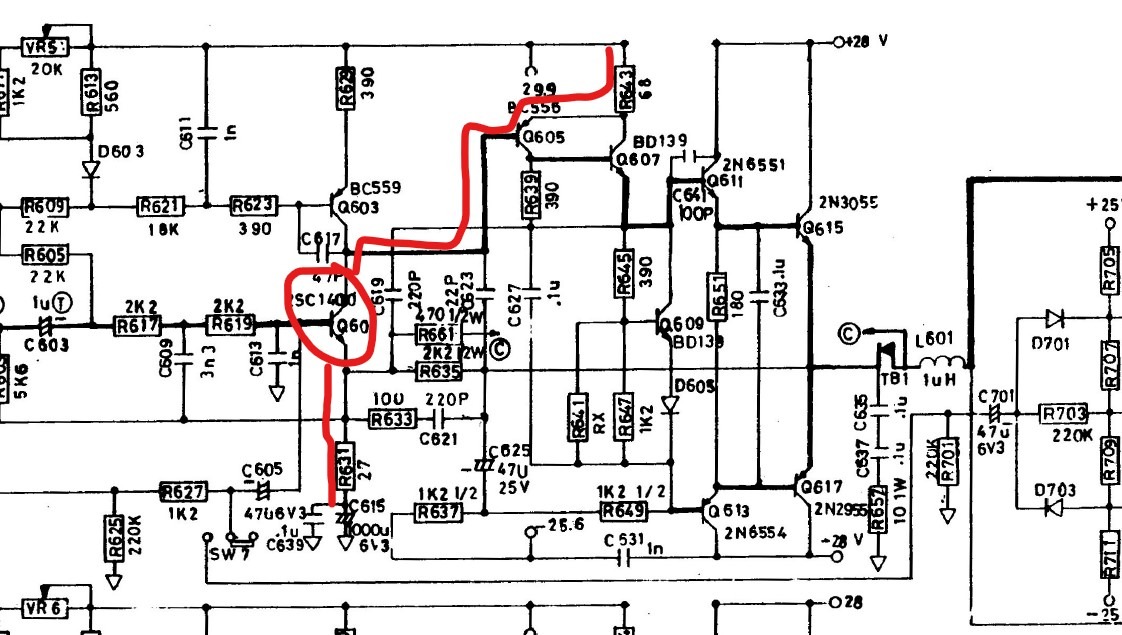

It sounds like you have fitted Q601 incorrectly at some point and so you have created a direct path... easier to draw...
So Q605 may possibly have suffered (perhaps) but what happened is you put the positive supply across that 6.3 volt cap via the 68 ohm and the 27 ohm in series with the cap. The transistor would have been fitted incorrectly so it functioned either as a forward biased diode or so that the junction was reverse biased and broke down.
So the 68 ohm, the 27 ohm and the cap need checking replacing. Maybe Q605 and of course Q601 needs fitting correctly.
ok i get what you are saying here. the original c1400 was fitted to the board as per the print and this is how i put it back, but i will check as suggestedSo the forensics are starting to come together now 🙂

so done as you suggested.
27ohm checked ok
68ohm replaced(this is the one that burns)
Q605 checked out ok but i replaced
Q601 put back as originaly fitted
C615 is brand new
turned on R643 still burns

So you need to try and find where the current in the 68 ohm is going, Rule things out one by one.
Put your meter across the 27 ohm and very quickly switch on. If you have voltage (how much if you do?) means that current is flowing in that path.

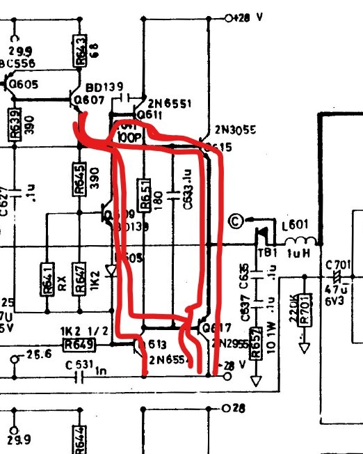

If that is OK then it looks like you still have a problem around the output stage and current is flowing via some failed junctions. If the output and drivers are good then no DC fault condition can push current down that route.

current across r631 is -13mv
voltage either side is about 1v
but blimey this is getting stranger by the min
so i re soldered a few of the resistor joints around R631 and now we are back to the start of things, no burning of R643 but the centre is wandering again like it was to start with, al beit not as bad as before 🙁.Time for ☕ and a re think

So back to how it was and you haven't really done anything. Could there have been a whisker of solder going between pads unseen that a resolder fixed.

I think the trimmers effect is very limited when you look how it works. It alters the current in D601 and so alters by a very small amount the fixed voltage that diode provides. It also effect the voltage Q603 sees between B and E and that voltage set the current in Q601 and that in turn has the effect of altering the offset voltage. It all operates rather indirectly on the offset voltage.
Q603 is a classic text book current source. If you fix the voltage between B and E then the voltage (and so current) in the 390 ohm R629 is also then fixed and this current will not alter even if the supply to the transistor changes over a very wide range.

Yours is similar but because it uses a PNP transistor it is upside down and works into the positive rail.

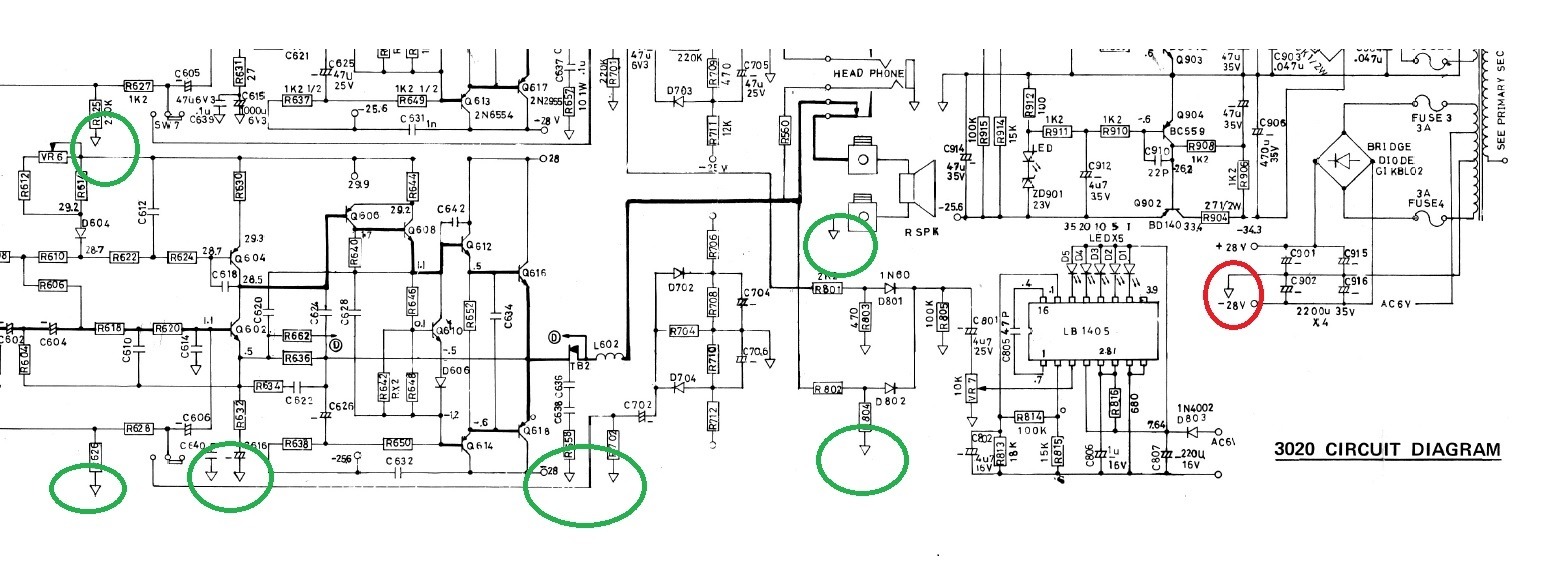

but get this, and i cant work it out, the minuite i connect the earth bar to the heatsink R643 starts to burn, how weird?
i have triple checked and there is nothing touching on the underside and also checked there is no current on the heatsink
so connecting both grounds causes an issue
so i took off the new ground wire i used to connect the points we discussed earlier on, and it doesnt burn now
so i checked the other 3020 i have here and that isnt connected to ground either, so maybe its not supposed to after all.

Could this earthing weirdness be anything to do with it? All those green circled points have to go to ground. They are ground.
