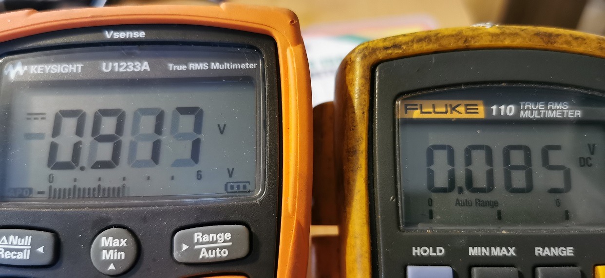

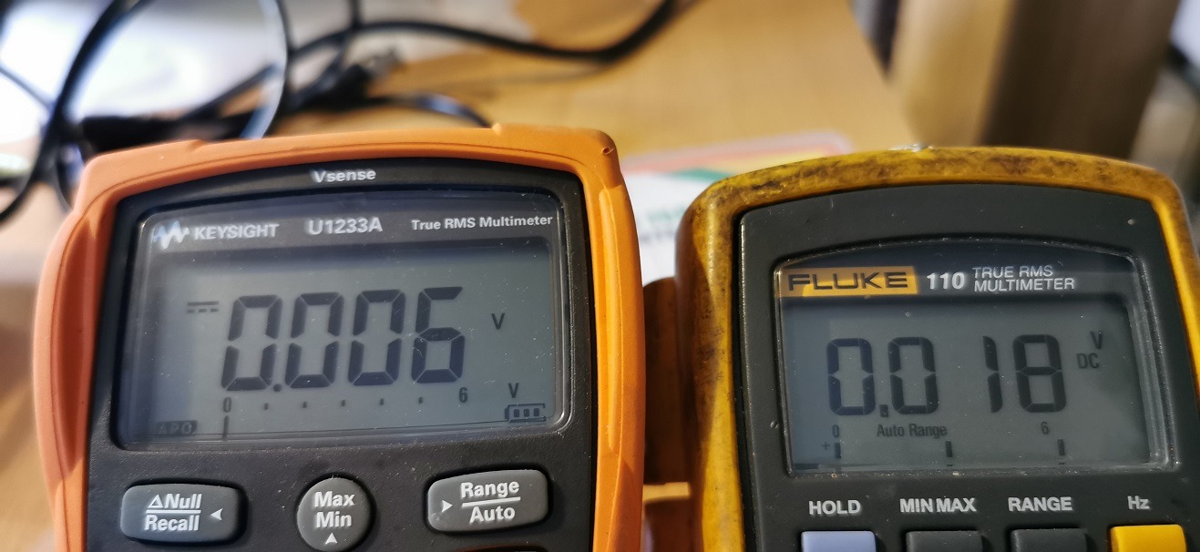

i am right in that if a cap is to ground it should be near to 0v
I have a cap C613, same amp its 800mv one side and -150mv the other, so this is suspect right? Its a poly
And although ive been using this all morning i realy ramped it up a little while ago and it started to wander a bit again, so i thought id check out some of the caps as you suggested.I did do this yesterday but only the ceramic ones
could poly ones go duff? ive not had it before
also when i check the ground continuity from the cap to ground its about 45ohms
Easiest answer is yes, one end of the cap should be at the same voltage as 'ground'. That is normally zero volts. The other end of the cap can be at any DC voltage as dictated by the circuit.
Ground does not always have to be zero volts... it usually is but is does not have to be. Remember voltages are always measured with respect to another point. All components that connect to the same ground should always have continuity between them.
C613 (1nF) in that NAD diagram should connect to every other part that is marked as going to ground. So if you have 45 ohms then that needs looking at. Easiest way to be sure is to follow the print and see if it really is ground.
Its very very rare for a poly type cap to fail in these kind of applications. It just doesn't happen as a rule.
so they are to ground if you use the transformer ground as the reference.The casing appears not to be that reference as none of the component grounding references have continuity to case ground, only transformer ground.Now when i did this yesterday and connected both together r634 went up in smoke, and i just reconnected it and the resistor started to burn again.Easiest answer is yes, one end of the cap should be at the same voltage as 'ground'. That is normally zero volts. The other end of the cap can be at any DC voltage as dictated by the circuit.

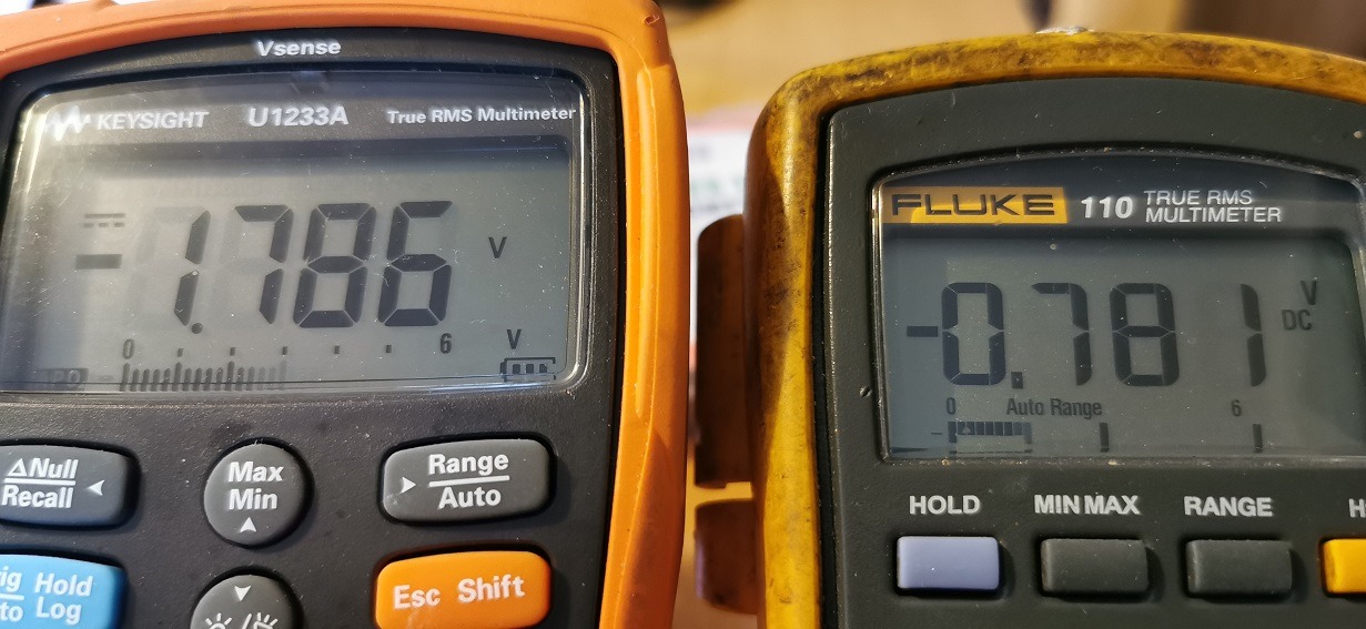

so this is the current cenario
right channel works perfectly right up to full volume
left channel is distorted and you can here it get more distorted as the voltage increases at the terminals and as you raise the volume
if there was a ground issue wouldnt the right channel be affected?
if i use the case as ground reference
i have -250mv with a load
with no load 46 ohms
if i use the transformer as the reference all are 0v
so you could say they are correct realy
why the case ground isnt reference i dont know but i have checked a couple of other amps and they are the same so it must be correct and im not going up a blind ally with that one.
i just have to find the source of the distortion somehow
Not necessarily because a ground problem might be effecting just one channel.

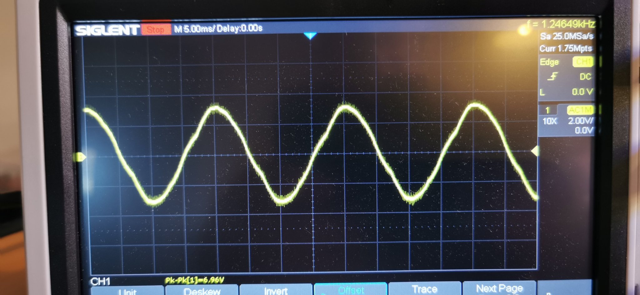

Look with the scope at what the distortion looks like, it might give a clue. For example on a sine wave you might see the top or bottom half distort which would point the one or other half the output stage.
ok ill give this a go in the morning.I think it is something simple.Not necessarily because a ground problem might be effecting just one channel.

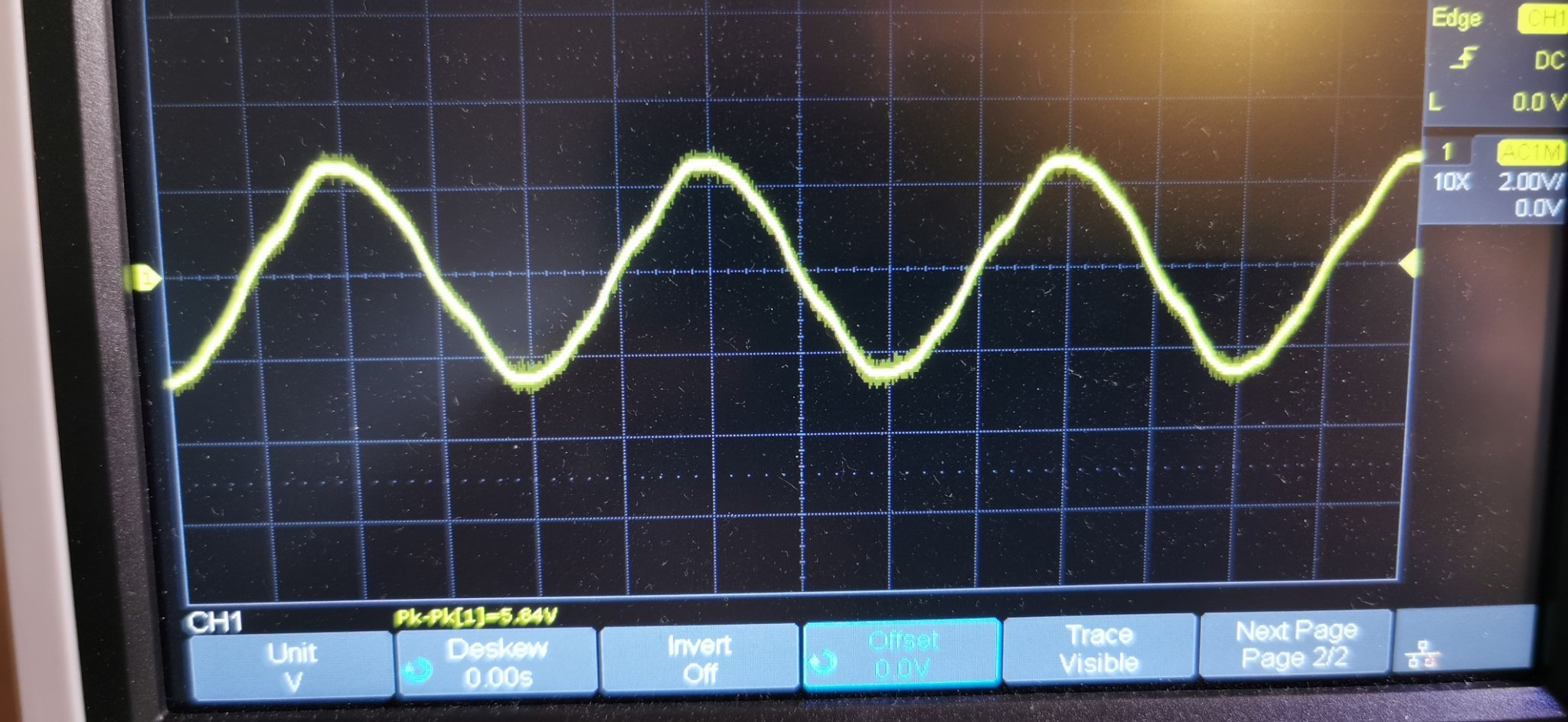

Im hoping i have done this correct.ok ill give this a go in the morning.I think it is something simple.
pictures of the sine wave at full volume
this is AC coupling though, not DC, you didnt mention what it should be, but i can do it again in DC if i need to.

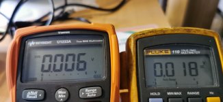

also some pictures of the offset L/R at volume 0, mid and full volume
I have triple checked everything on the output side and there is very little or no difference with the voltages from one end to the other when there is no load
The issue now is definatly attributed to when the volume is raised and current increased so i will keep plodding on.
the difference is the original problem was it was wandering without touching anything form zero to +/- 2v
so i i think know where we are at with this.Not necessarily because a ground problem might be effecting just one channel.
The offset is fine while its sitting doing nothing, so im not going to be chasing a problem that isnt there.
im pretty sure the issue is with the grounding somehow
i compared another 3020 and measured to ground from the chassis C613
on my amp its over 400mv
on the other amp its less than 1mv, so i guess its leakage from a component.??
i guess the only way to find this now is process of elimination by removing a leg from each one untill i find the one that is leaking because the voltage is common across ground.
question is can i safely remove a leg with the power on without damaging the amp.
If you are comparing two identical models then it just sounds like there is a floating ground somewhere. Depending on what any ground resistance was would have a a big impact on the voltage between those two points.
So I wouldn't automatically say something is passing current to ground. Currents do flow to ground from parts that connect to ground but the whole point of a low resistance ground path is that those currents would not generate any voltage.
The scope shots are a little inconclusive I'm afraid.
Can you not just physically follow the copper print from C613 and see where it goes?
