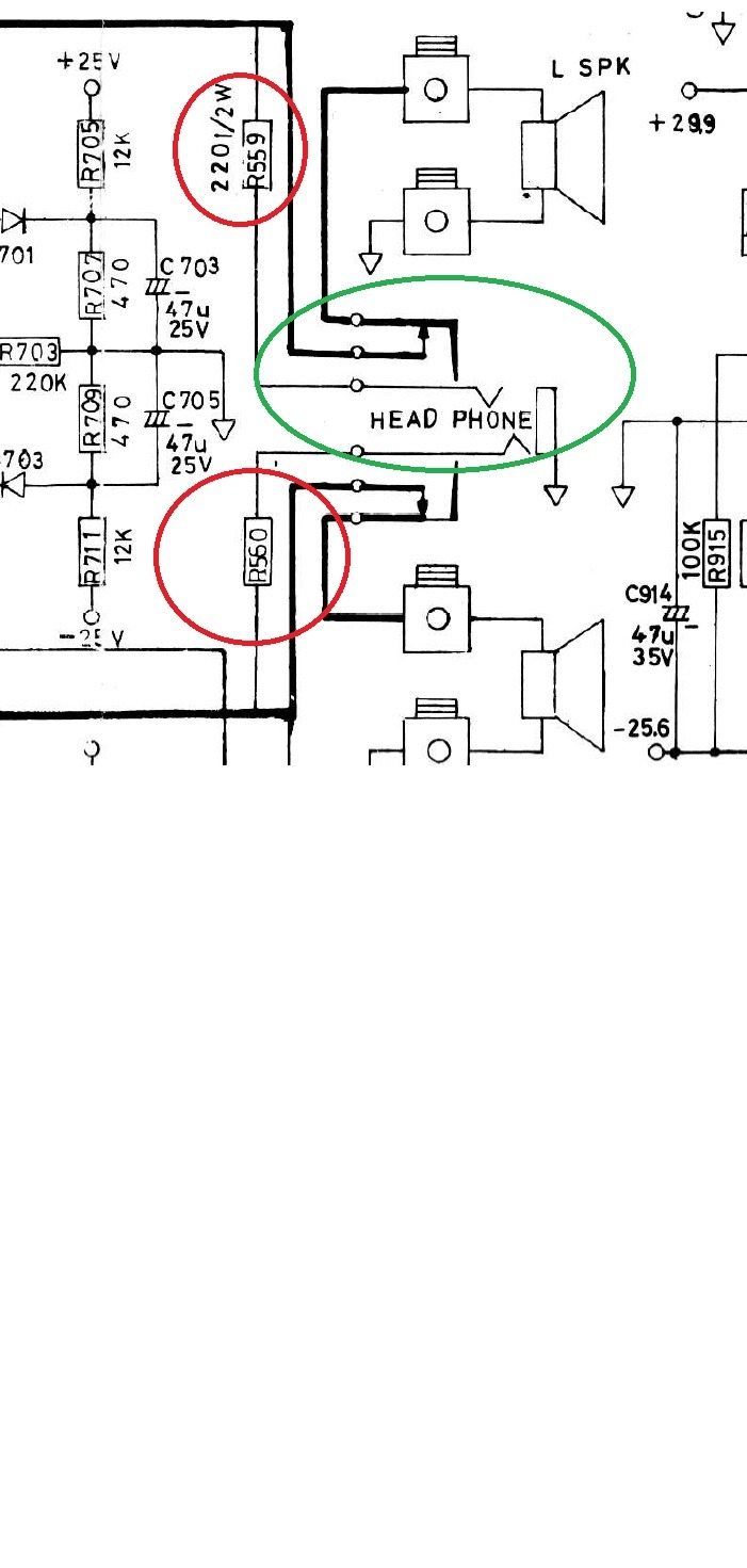

ive had to switch my attention to smoke coming from the direction of R659/660 and the main filter caps, that were brand new, just occational whisps at full volume, strange, but i cant ignore it, this has to be priority for now
Not sure if it has ever been driven that high TBH, it might just be a bit of glue on a component burning off when getting hot

Smoke doesn't sound good. I'd have to see them on the circuit to get an idea why they might burn. There are that many NAD 3020 variations I never know which we are looking at 😉

Well done 🙂 So those resistors are just in series with the headphone feed to limit power to the headphones.
Two things would have to happen for them to smoke. Firstly they would need a path to ground or via the speaker load to ground. Bit weird because that should not happen. Look at the way the socket is drawn. When you plug headphones in then the plug pushes the switched speaker line apart and disconnects the speaker while connecting the headphone through the resistor.
Everything connected to that is in the socket. Who knows what might have happened. Could be some silver foil shoved up there or anything 😀

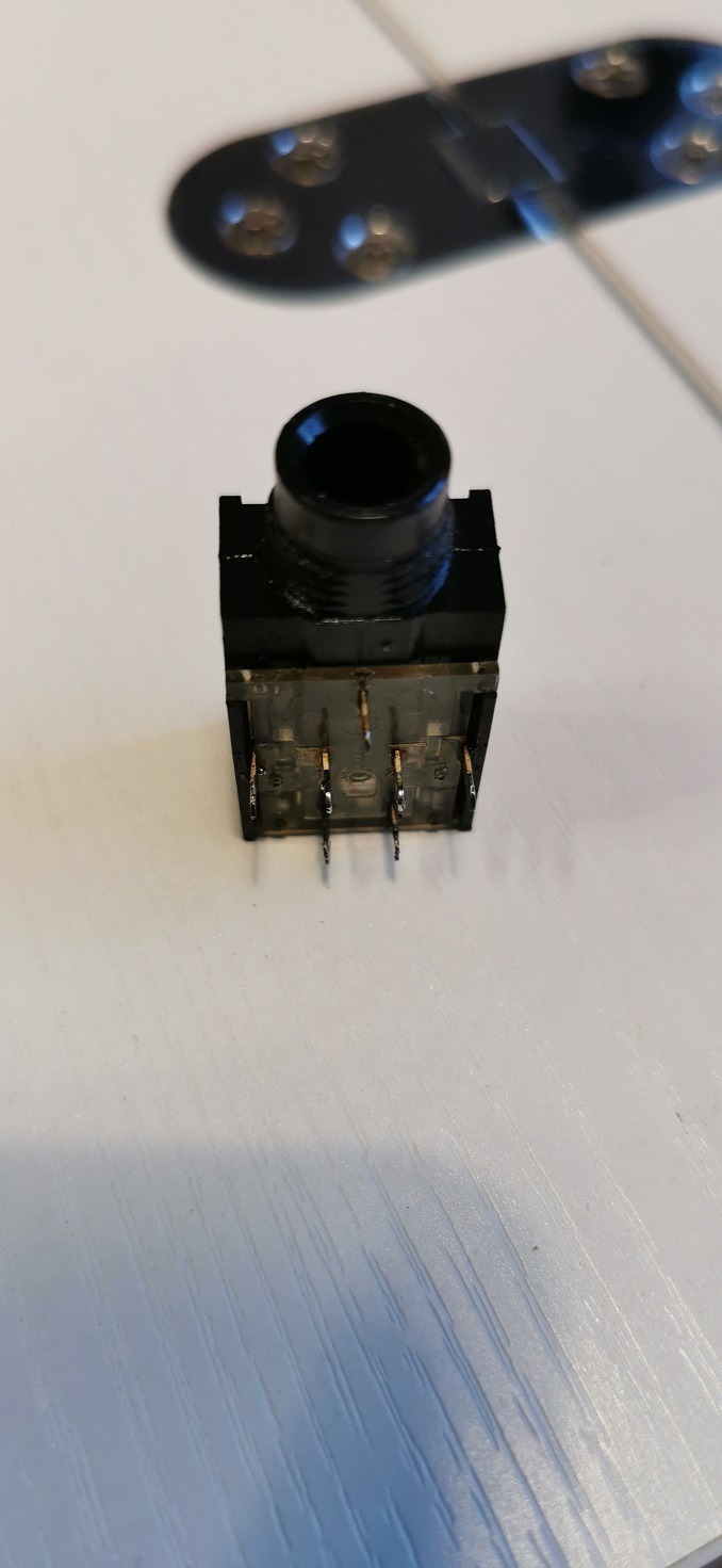

with regards to the headphone socket, it was full of some liquid and ive just stripped it all down and cleaned it, so we shall see if it was the socket iself when i put it back shortly, if not its on from there i guess,but im real close now(again 😉).This thing has had multiple things wrong with it, but its all good learning.

ok latest-its not the socket itself, i did have my doubts, so now we have a new trail to follow as when you put it back in it all goes mad again

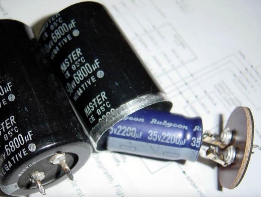

TBH,they do cost more but i only buy panasonic,nichion or other reputable makes, and from proper suppliers
LOL seriously someone sells stuff like thatSocket been squirted with something perhaps. WD40 perhaps.
If you buy caps from reputable suppliers then you should have no problems. Lots of eBay offerings are dodgy and/or fakes. Do an image search. Here is a cap within a cap.
so by removing the headphone socket it cures the issue ,but it isnt the fault

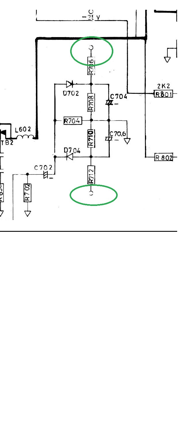

any idea what the 2 circled in green are supposed to be doing?
so senario
if you push a chopstick into the headphone socket and engage it, it stops going wild
so senario

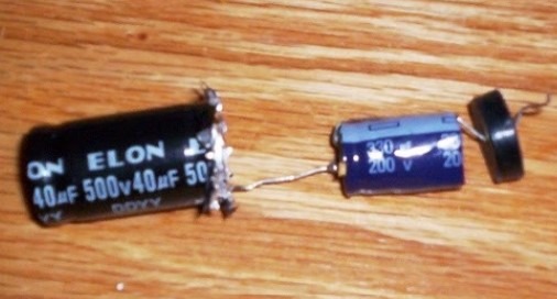

Plenty much stuff like that, yes. Same for transistors (remarked to say something else) and same for IC's

Look at the other channel. They just go to the - and + 25 volt rail. The resistors for a potential divider to give a known voltage across C704 and C706. When the signal voltage on C702 exceeds the divider level then the signal is effectively 'soft clipped' and it can not increase any more.
So its all part of the soft clip feature.
