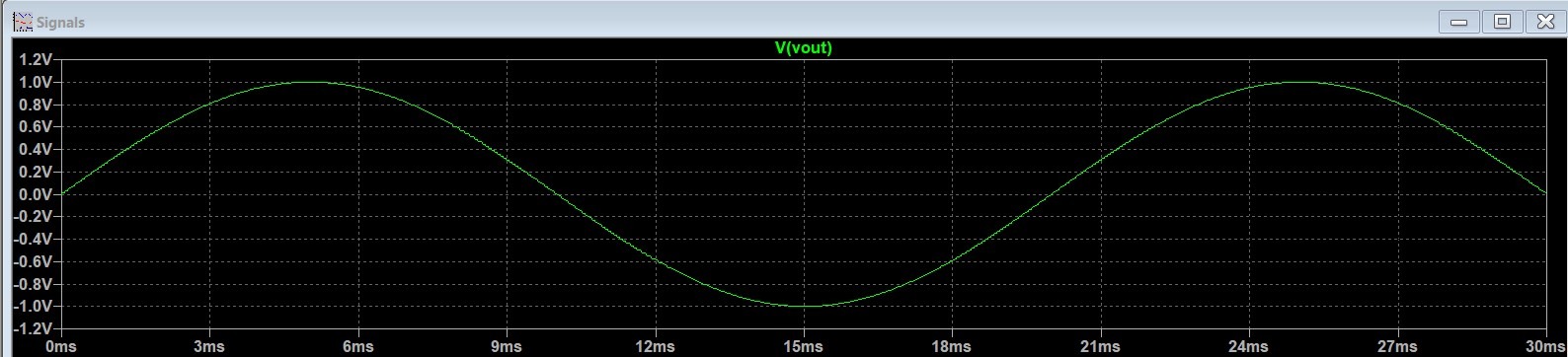

I'm sure mine is always that thickness, I'll have to check it out
If you look at the output of your generator or look at the scopes 'Cal' output then it should be a single clear trace, no furriness. You should prove that is correct first,
Any thickening of the trace after that shows a problem either in the unit being worked on or in the measurement technique and set up. A pure sine from the generator should pass through the amp and look the same at the speaker output,
NP ill chek it out later🙂If you look at the output of your generator or look at the scopes 'Cal' output then it should be a single clear trace, no furriness. You should prove that is correct first,

For testing most stability problems, you should be using dummy loads to check the actual working performance of the amplifiers, using a steady, pure tone input signal source of maybe 100Hz, 1kHz and 10kHz. Monitor the loaded output of the amplifiers with the 'scope, by checking the output for stable level and the waveform symmetry. A dual channel 'scope can also be used to scale and superimpose the input on output signals to see if anything subtly different is happening by comparing input and output waveforms directly. Differential mode testing may be ideal for this but it's both expensive on equipment and demanding to do properly so 'not a good idea unless your pockets are overflowing with cash and you have a well paying electronics career to justify it.

The scope is the right tool for the job here. Use your generator and check the channel matching and also the overall frequency response to see if one channel has any HF roll off.
