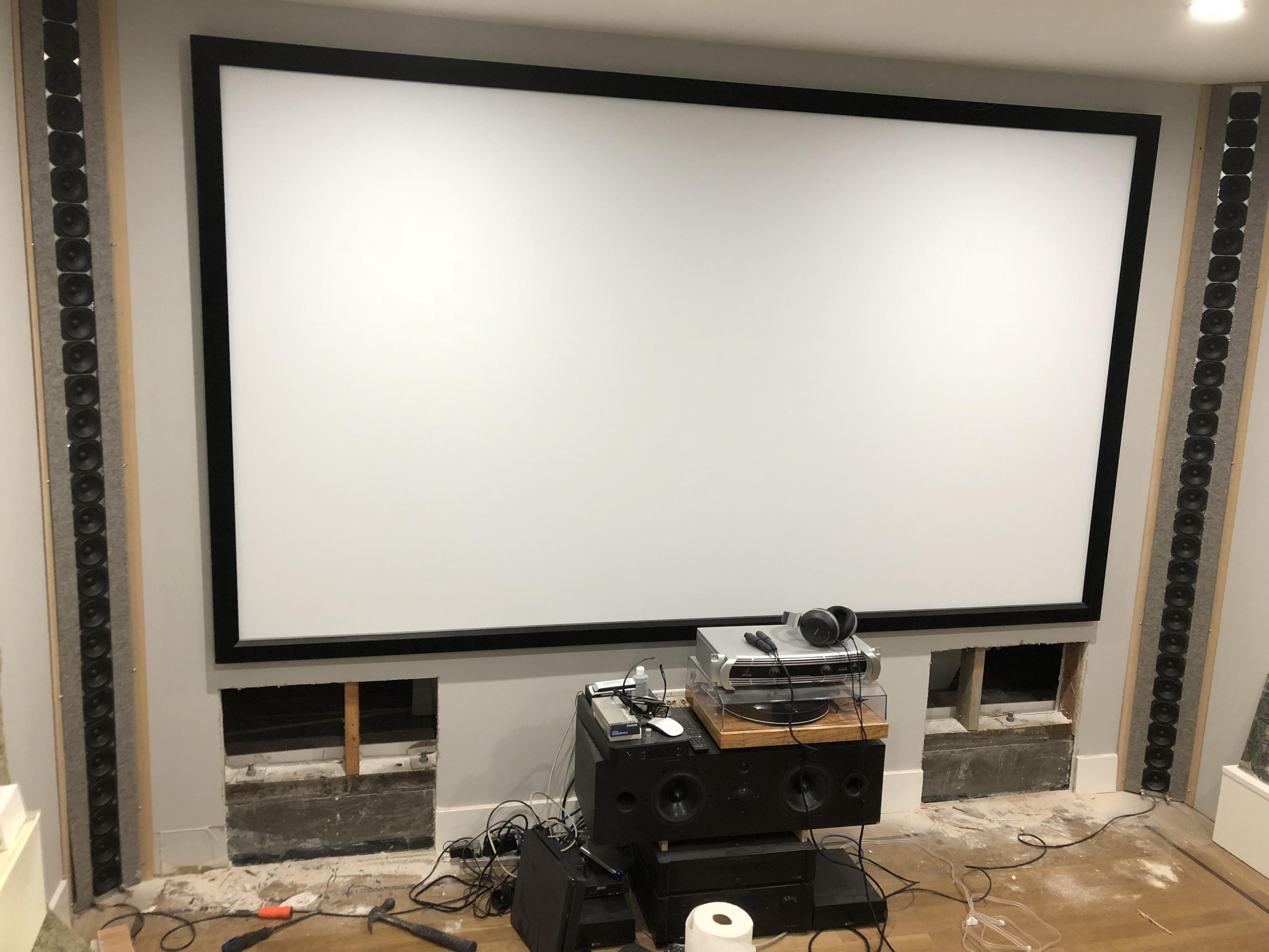

I managed to squeeze in 28 drivers per side wired 7x4. So that worked out well from an impedance perspective as well as literally having drivers floor to ceiling. Well, there’s about an inch on top and bottom.

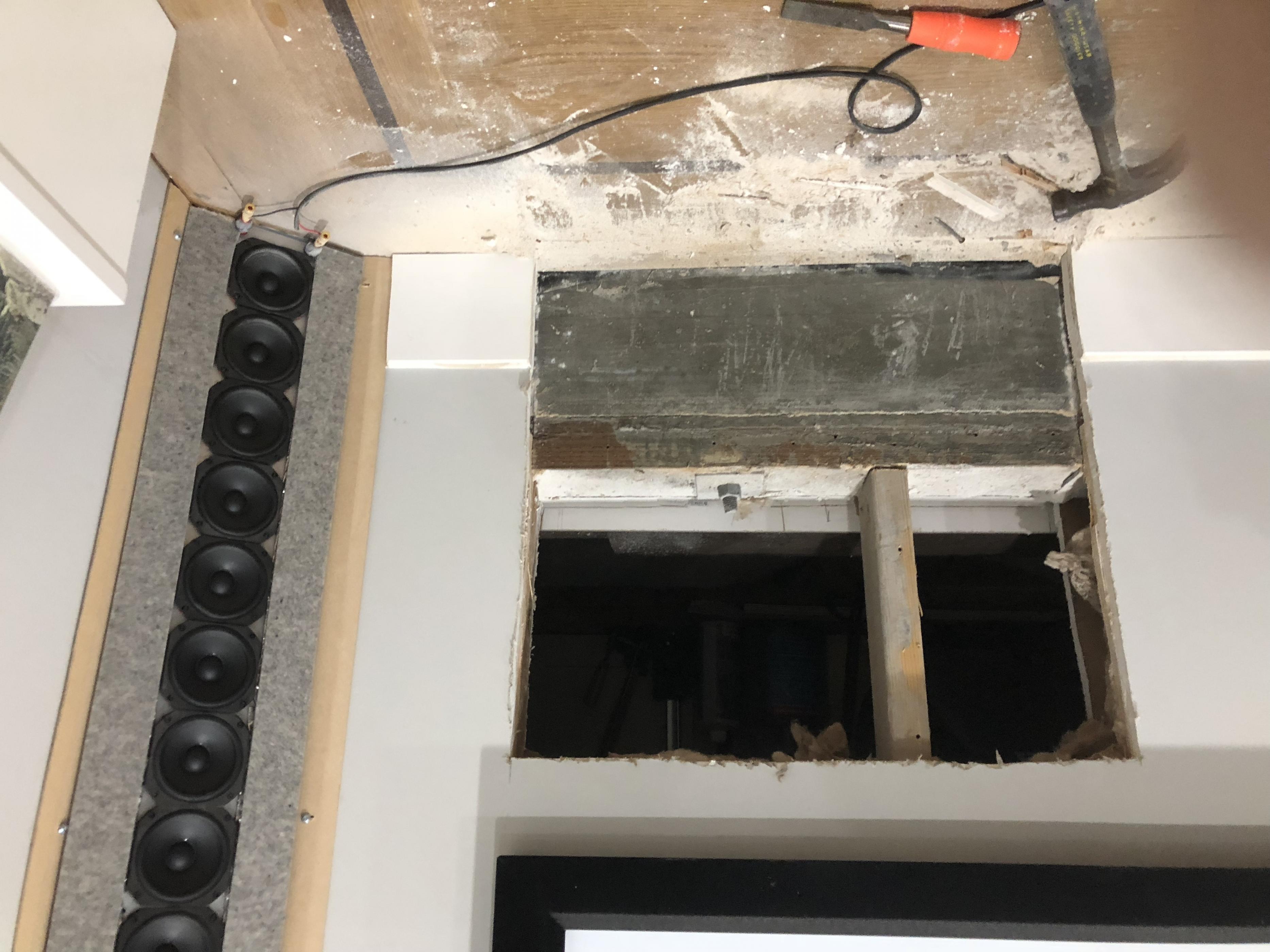

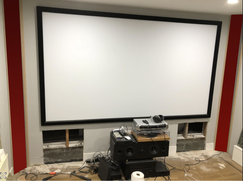

The final hardware phase of the home theater is well underway. The boxes for the drivers are nearly done. And the holes in the walls for the infinite baffle part of the equation are cut.
Next up is cutting the holes and mounting the drivers. Need to make the frames for the frames for the grill cloth as well.
Then mounting holes into the concrete and the shelving between the cabinets.
Finally, finishing trim work. Still haven’t decided how. Maybe just some darker gray matte paint to match the walls? Open to suggestions.

Thanks... need to redo the grill cloth... although I kinda like the visual impact. The wife, however, is not a fan. 😉
Maybe you could try to match the colours of the furniture that will go in there.
Me, I'm a big fan of dark burned red, so if your couch is that colour, try to match the couch to the arrays.
attachment.php
The couch is dark grey. The grill cloth I have is between the color of the walls and the couch.
Do you think the color of the cabinet will make a difference. I was thinking about minimizing the reflections so I was leaning towards something darker. I have some walnut I can piece together as a thick veneer of sorts as well as milling pieces for face frames. I would also use it for the shelving between the subs that would support the amps/receiver/PC/center channel/turntable.
Most people designing a HT room will use darker colours.
So, when you turn off the lights to watch a movie, you are not bothered by light spatter and your attention is on the screen.
If the space doubles as a living room, then it makes sense to use lighter colours. I have that limitation, so, our walls are cream coloured. While watching a movie, the room never gets dark. Annoying, but that's life.
It is mostly a theater room but I think it may become more of a living room as the kids get older and we ultimately finish up the unpacking and the wet bar and other things. So I think I'm likely sticking with the grays. I think the wood parts of the sub cabinets and shelving can be walnut colored though.

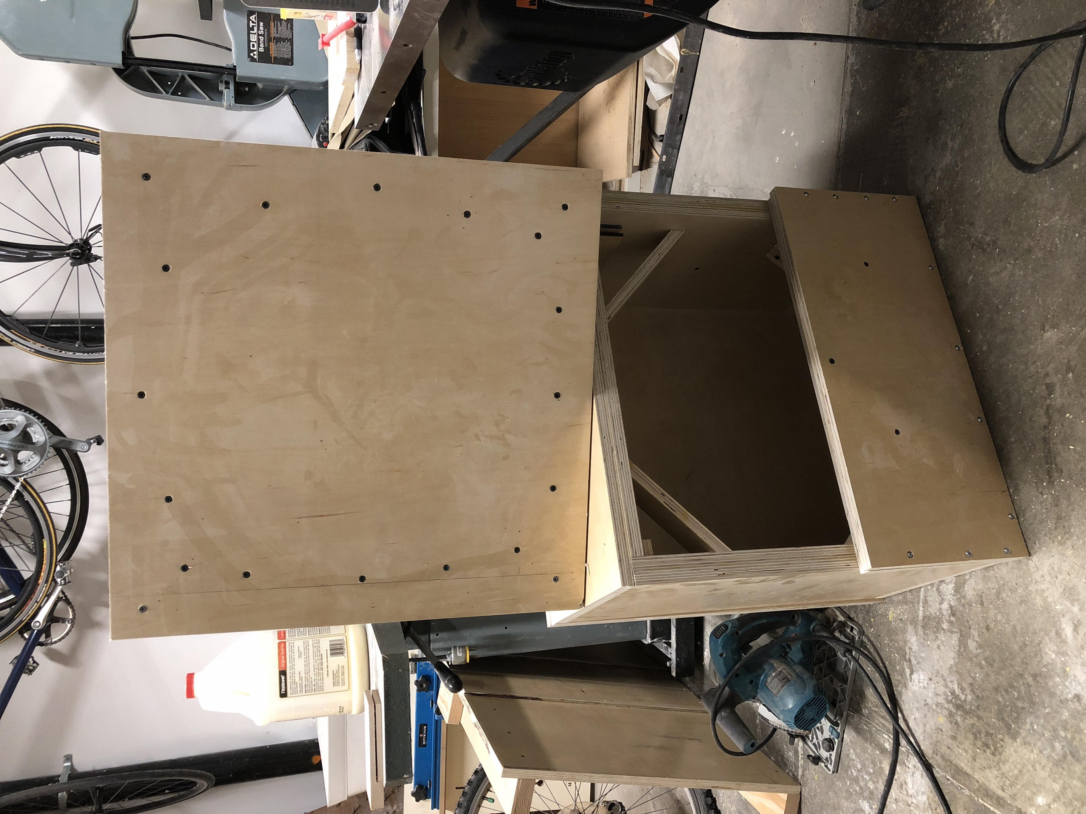

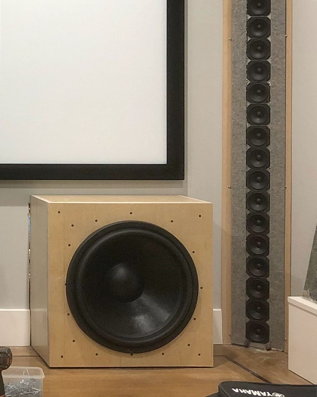

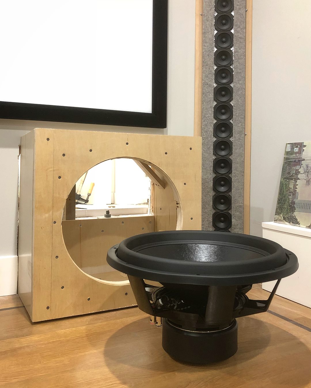

Cut the driver holes. Bolted the cabinets to the foundation. Mounted the drivers into the cabinets. Trim, grill frames, and wiring next.
What's the prevailing wisdom on wiring dual voice coil subs? I understand that I should wire in parallel for more power, but that's not going to be an issue at all given the size of these things and the iNuke 3000 I have powering them. I haven't been able to find any other definitive pros/cons beyond the power issue, so maybe you all have a point of view?
