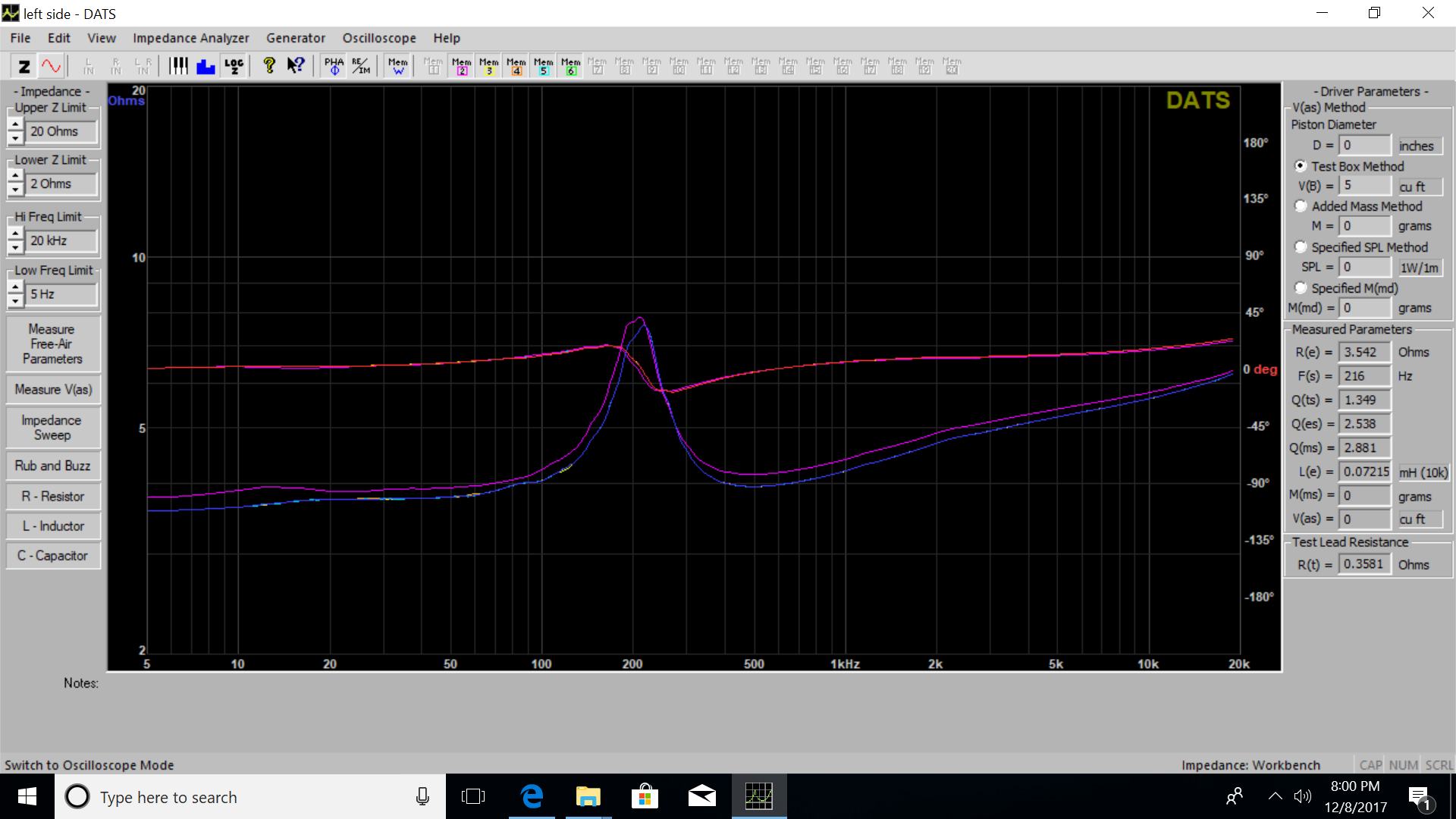

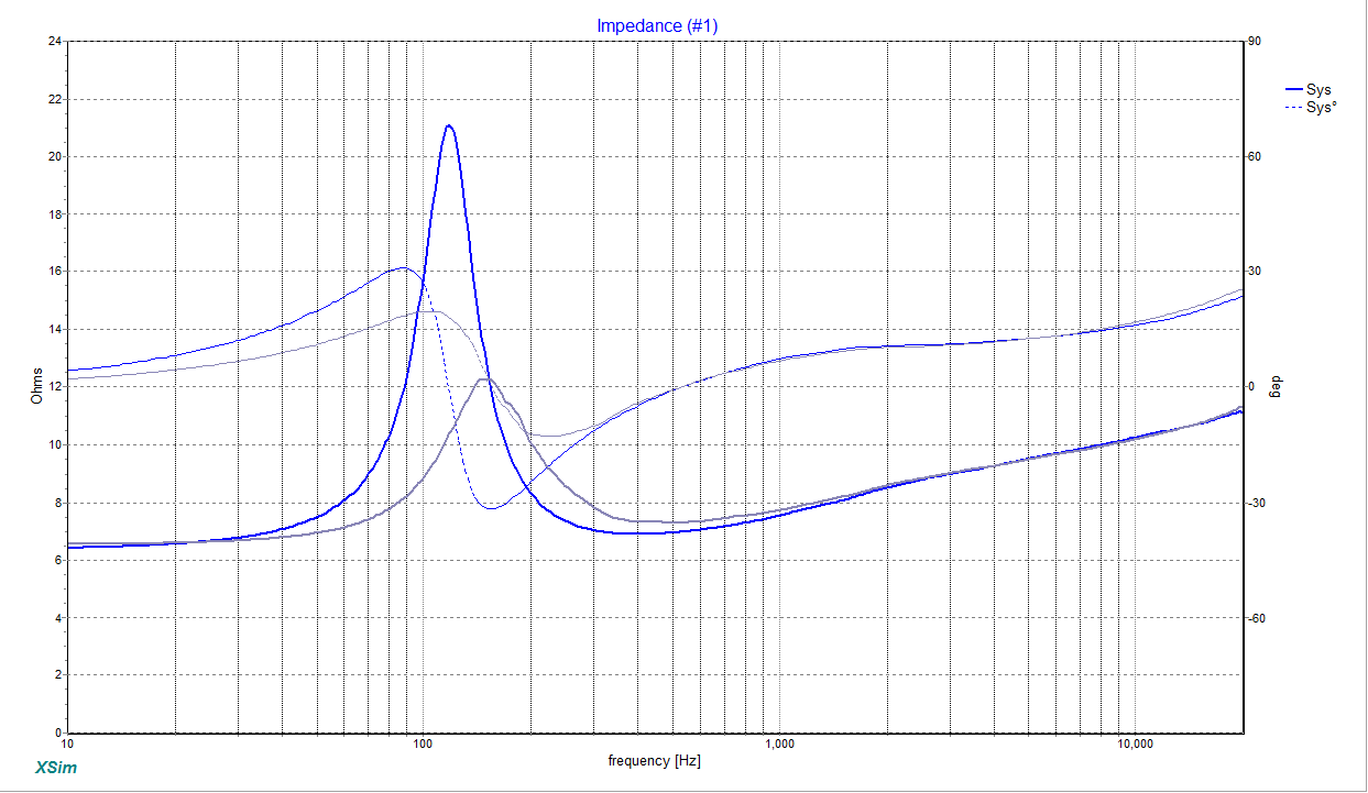

About impedance calculation specifically REW verse DATS i think they pretty much the same, in my previous post i just tried to hint that down the road one can execute and rise performance for diy stuff even better if one can get data up much higher in frq.
Wesayso sent me a REW created zma file in past to develop resonance and inductance compensation networks, below you can see it (grey) compared to mine (blue) DATS created zma file overlaid into XSim and think they probably pretty much the same when we take into account that wesayso's is 25 drivers into damped enclosure and mine is one driver in free air.
Sounds good. I went ahead and ordered one. Although I'm a little scared it's going to tell me there are lots of problems! Although I suppose part of the fun is fixing those problems.

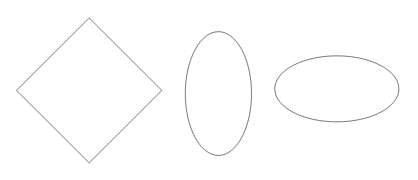

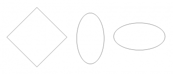

Separate topic... To wesayso's point about avoiding vertical surfaces, does anyone have any inspiration that would help determine how to create the absorption panels with minimal reflectivity issues? I'm tempted to just wrap the batting in fabric, hang them on the wall, and call it a day. But I would like to have them wrapped in a photo printed canvas if possible. I was thinking maybe the frame can be a low profile one. For example, the "frame" could perhaps be made of just a metal wire, similar to a coat hanger in size, and the canvas can wrap the insulation and get clipped to the wire. The four sides would be rounded over so it would be an untraditional look at best. But it eliminates the reflection point. Any other ideas on how to execute?
I'd consider making wooden top & bottom plates, which would define the shape & depth of the panels. Vertically space these plates with all-thread, leaving a few inches between the panels' outer edges & the rods. The outer cover would need to be stretched tightly for clean vertical lines.Separate topic... To wesayso's point about avoiding vertical surfaces, does anyone have any inspiration that would help determine how to create the absorption panels with minimal reflectivity issues?
I also have DATS, and it's been invaluable for me, as the driver manufacturers around here do not give any T/S data, just the size and how much the driver weighs!!!
It's a LOT easier to measure impedance, no more fiddling around with a resistor, cable mess, etc... just connected and click with the mouse. So nice.
And yes, it's also nice to double check capacitors and resistors values as I've had some that were wildly off what was written on them.
It's a great tool I should have bought a long time ago.

Thanks for the ideas on the absorption panels. Is the prevailing wisdom to focus on absorption where possible and diffusion if not? Or should they be combined in some intelligent way? Diffusors are probably less wife friendly but may be an option.

With a little imagination, diffusion panels can be anything.
A wife friendly favorite are bookshelves. Acts like diffuser, looks good.
