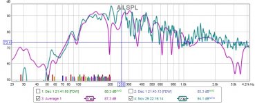

I use the pré EQ because we are not correcting a single speaker in a box. We are correcting a line array that sums real well in certain area's, falls off due the drop off below Fs of the driver on the low end etc. What I'm trying to achieve is to get it within the working range of DRC.
DRC has a lot of math, variables and choices to determine what it does. I want to manipulate it to do what I want it to do. I did try without pré EQ, it did not work out for me.
About the boost vs cut, I've read all the horror stories. Not my game to let that hinder me to do what I want to do. According to many on this side of the forum just about everything I do with the arrays is probably considered bad practice. Even the arrays themselves. I probably read different or other material to get my fix or inspiration.
My way of applying post EQ is probably nuts by any standard. It gets me where I want to be and what I want to hear from my system.
I'll add this: never boost a null. That's the boost I do not do.

As the mic is used to get me in the ball park, and EQ is used to shape tonality to my liking (the ears being the judge for that) the exact way of pointing the mic gets less interesting, as long as it's equal for both sides. I do not paint straight lines with my EQ. even though a lot of people may assume I do.
I listen and correct, repeat etc. for tonality. A slow process that has steered me towards mid/side EQ and a lot of other experiments.
I use my ears to learn what I like, I use my measurements to tell me the trends to look for.

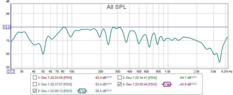

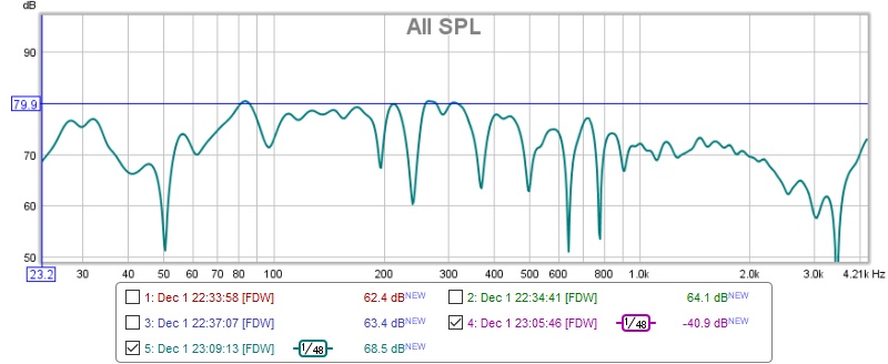

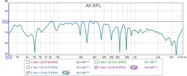

As I work on figuring the DRC thing out, I have another question. I looked at the response with 1/48 smoothing and got this (purple line).
I know we typically look at smoothing at 1/12 or even 1/6 but are those big dips a concern? I assume they're room nodes that will be helped once I get my absorption panels in. There's also now this huge dip at 3kHz. And the line itself is much more smooth at smaller time intervals compared to the previous file in turquoise (less "jaggedy") although there seem to be more deep dips/nulls. The only change is that I started using the 90 degree mic calibration file and I use a 1M sweep instead of a 256K sweep. I wouldn't expect those to make that much difference though? The learning continues!
EDIT: I am playing with WDM and ASIO as well if that makes a difference.
EDIT2: My room is 20'x12'. The diagonal is 22' which aligns with the 51Hz null exactly. And the other nulls correspond to either the width or the length or other reflections thereafter I figure. I guess those room nodes show up much more drastically now that I'm using the mic calibration for 90 degrees!

This shows you've got a FDW active, how many cycles?
