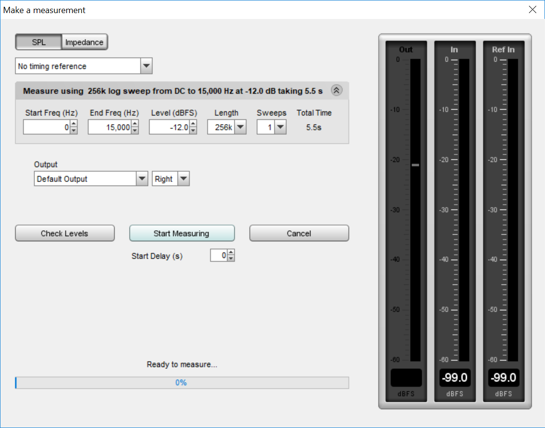

Well I got my Intel NUC, loaded up REW and JRiver, dug out the microphone, and started down the rabbit hole of DSP.
It's going to take a while to get where I want to be and perhaps there will never be an end to the tweaking but for now, a few questions. Hopefully these aren't terribly embarrassing...
1. At a high level, do I have my process right?
- Microphone about 8" from speaker about in the middle of the height
- What smoothing is best? I'm thinking between 1/12 and 1/24
- Any commentary on my target or measurement settings?
- I can load the Filter Impulse Response as .wav file into JRiver... is that the right one?
2. When I play back with convolution after loading, I get a delay... about one second. At first, I thought it was because I had used "acoustic timing reference" but when I tried again with no reference I still had the same problem.
3. When playing through my AVR, does it make sense to use any of the parametric EQ capabilities (Emotiva XMC-1) or just leave it alone with convolution?
4. What's the difference between impulse response and filters impulse response? Is the impulse response just the dirac pulse and resultant ringing? Whereas the filters response is what Jriver uses for convolution?
That's it for now... thanks for your help!

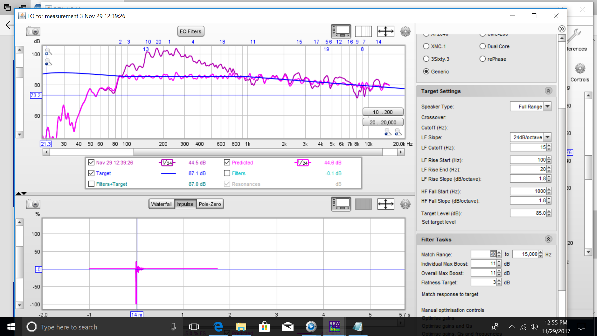

A few things, others will chime in:
- put the mic at your listening position, ear level when seated.
- I usually go for sweeps starting at 20Hz to 20,000Hz.
- I used 1/12 smoothing, but lately, I like to use Psychoacoustic, as it is easier to read.
- target is a preference, so adjust to taste.
- the delay when using convolution is normal. It's the time the JRiver filter needs to apply it in real time. 1 sec is a bit long though. Have a look online on how to optimise audio in a PC. It also depends what kind of interface and drivers you are using. For example, ASIO4ALL is just a band-aid solution and not very good.
- don't add the AVR EQ into the mix. Keep it simple and use the EQ in JRiver only. You can use the AVR to cross to a sub though, if you plan to add one.

I agree with perceval, I'd put the mic in the listeners position due to measuring an array of drivers. The geometry of distance from each driver to the microphone changes if you measure at 8" vs your actual listening position.
I do not know what kind of convolution you use. Are you saving the REW filters as a FIR correction? Those are all IIR corrections and you should not need to get any delay.
Another way of getting exactly the same is to put those REW filter settings in one of JRiver's PEQ banks. It might need you to set the REW type of equalizer to something other than "Generic" to get the exact same "Q". That's why there are so many available as pre-set. The RePhase one reasonably corresponds to JRiver's "Q" settings if I recall correctly.
Any delay in the FIR filter will result from the way the FIR filter is setup or saved. IIR do not need to have any delay. Whenever you actually change phase (to be different from the EQ cuts and/or boosts) too, then you'd need delay. How much would be dependant on the actual used filter resolution and the sample rate you use in the audio chain. The rephrase thread has a lot of information on that should you want to learn more about it. RePhase offers to change phase independent from frequency.
REW's filters are not changing the phase independent from frequency last time I looked. You can exchange certain things from REW to RePhase though, what route do you use?
Personally I do the tweaking of phase and magnitude with DRC-FIR.
I use whatever smoothing for the task I am after, there isn't a magical one that works for every job. I look at unfiltered and filtered plots to determine my goals. My thread is full of those plots, covering from Psychoacoustic to 1/48. And lots of frequency dependent windows. They all have a different way to look at the same information. REW has many tabs, each of them shows the same measurement in a different way. All of them have a role to play to learn what your system and room are doing.
As wesayso talk about REW makes IIR filtering so theoretical there should not be any delay, haven't tried this scenario before myself but think before export IR for correction then look at IR window for that correction and see if there is unusual long time before attack of real impulse itself and if there is then try with "Controls to see if that could be edited out, because for IIR filtering all correction is positioned after top of impulse itself and why IIR filtering is real time correction.
Hmm, ok. I was confused by the JRiver convolution wiki and I was indeed using the IIR .wav file in the convolution tab. And the delay was not a total delay, more like a reverb in that I would hear the same thing a second later. I assume that's because I was doing it all wrong!
I think my next stab will be to remeasure at the listening position. Then input the PEQ settings from REW into Jriver.
We'll see how that goes and then I'll take a stab at DRC-FIR for the phase tweaking. Is it true that DRC-FIR will generate a .wav file that will go into the convolution tab of JRiver as I was *trying* to do with the REW IIR .wav file?

Yes DRC-FIR creates a *.wav file to use as convolution file.
I just checked the REW FIR output (filters exported as a correction) with some random EQ and it sets the peak at the start of that file, meaning: no delay, pure IIR.

So the REW FIR output is not really FIR at all. It's just the IIR parametric EQ configured as a FIR file so that it can be used via the convolution .wav file functionality, correct?
In any case, I guess I did something else wrong as to your point, it should have at least worked to a certain degree, without the weird delay thing I was experiencing.
