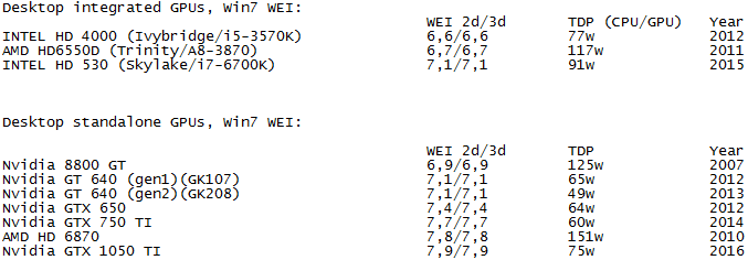

You probably should good enough with todays GPUs, below is my own research for GPU performance for last decade of hardware owned and should be compareable when using same Win7 WEI benchmark for them all. Not that it show video features within each family but think video performance will follow generals there that show than when Intel reach SKYLAKE they as good as what GT 640 did some years before, and when Nvidia reach GTX 1050 they within 75w hit the highest score wall at 7,9 so it can be higher than that and will need Win8 or newer to reveal scores above 8, and years before that it needed monster 151w HD 6870 to get a 7,8 score.

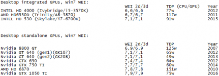

Cool, thanks for the summary!
