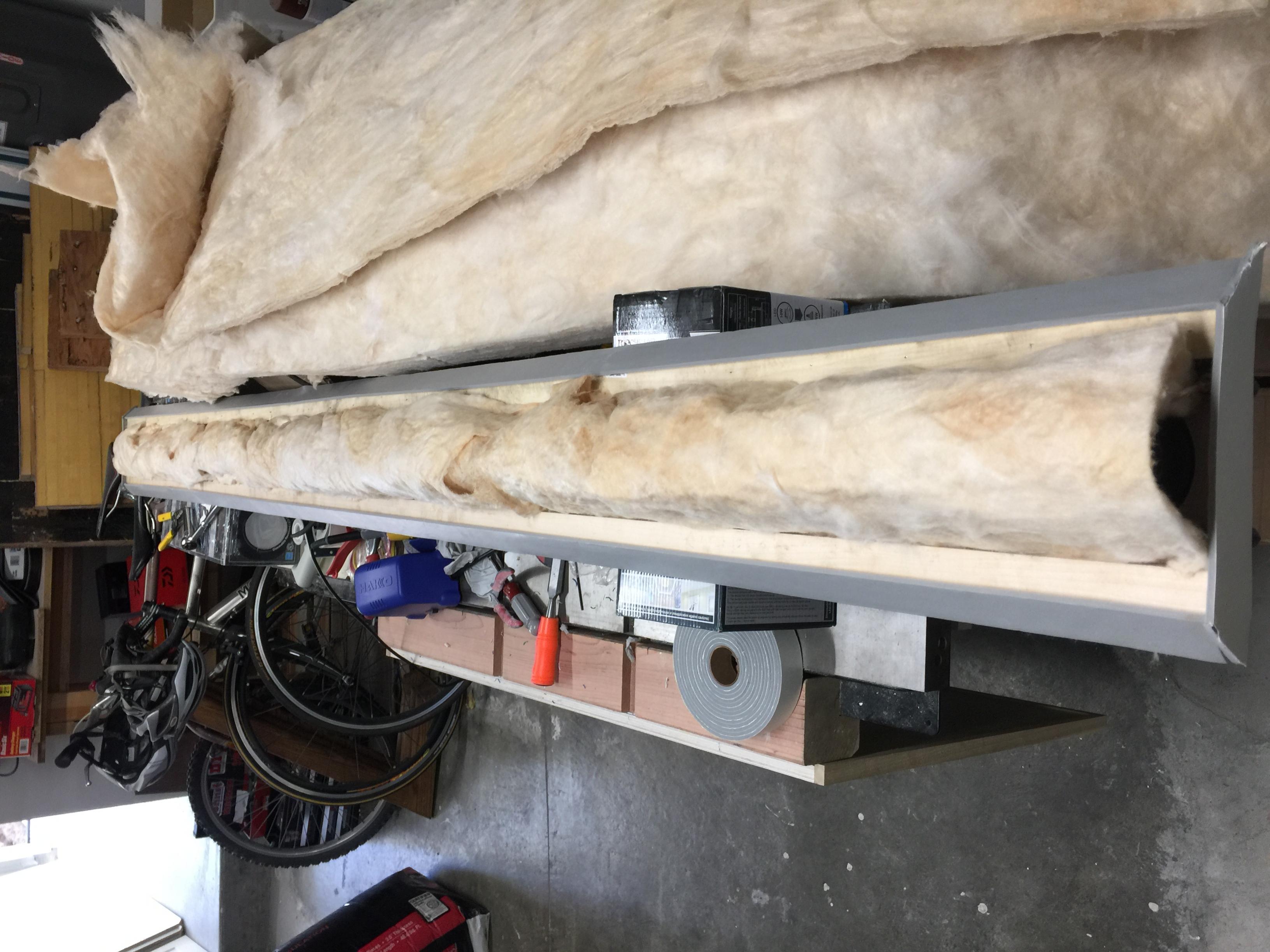

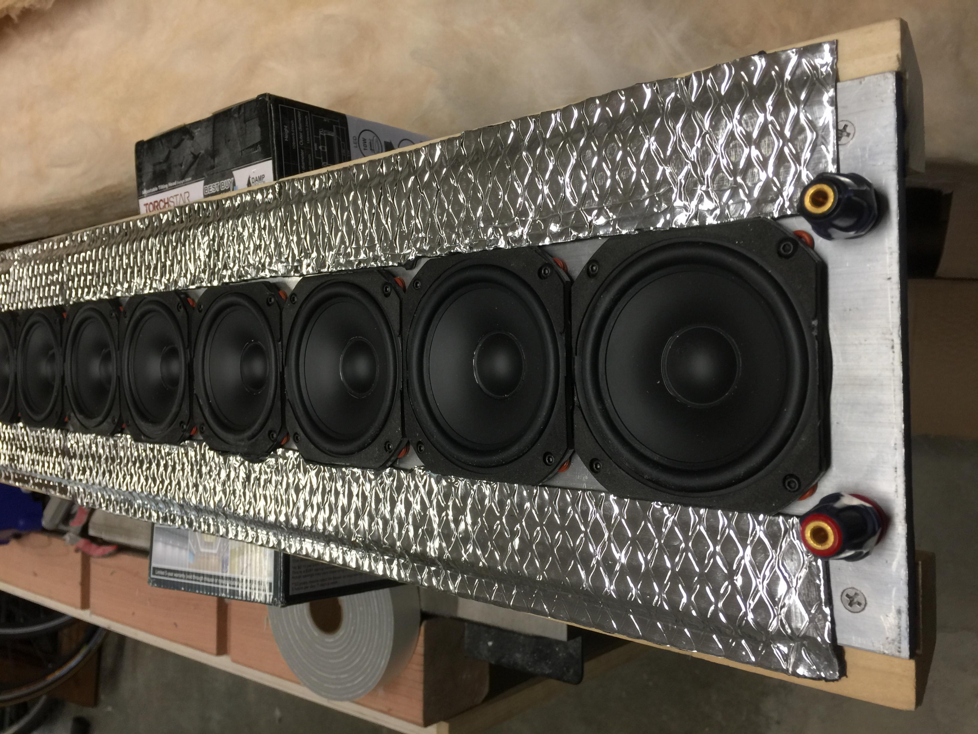

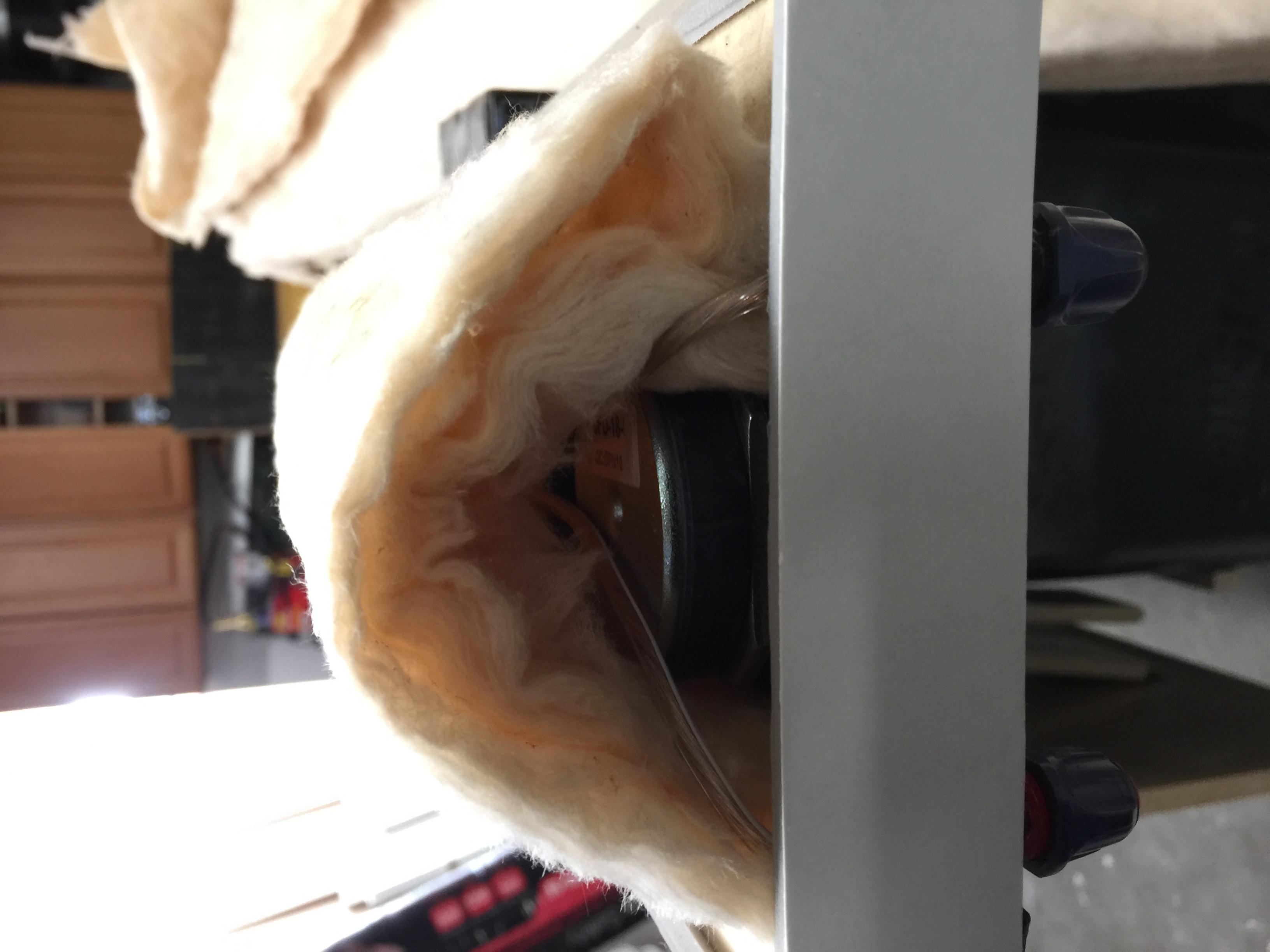

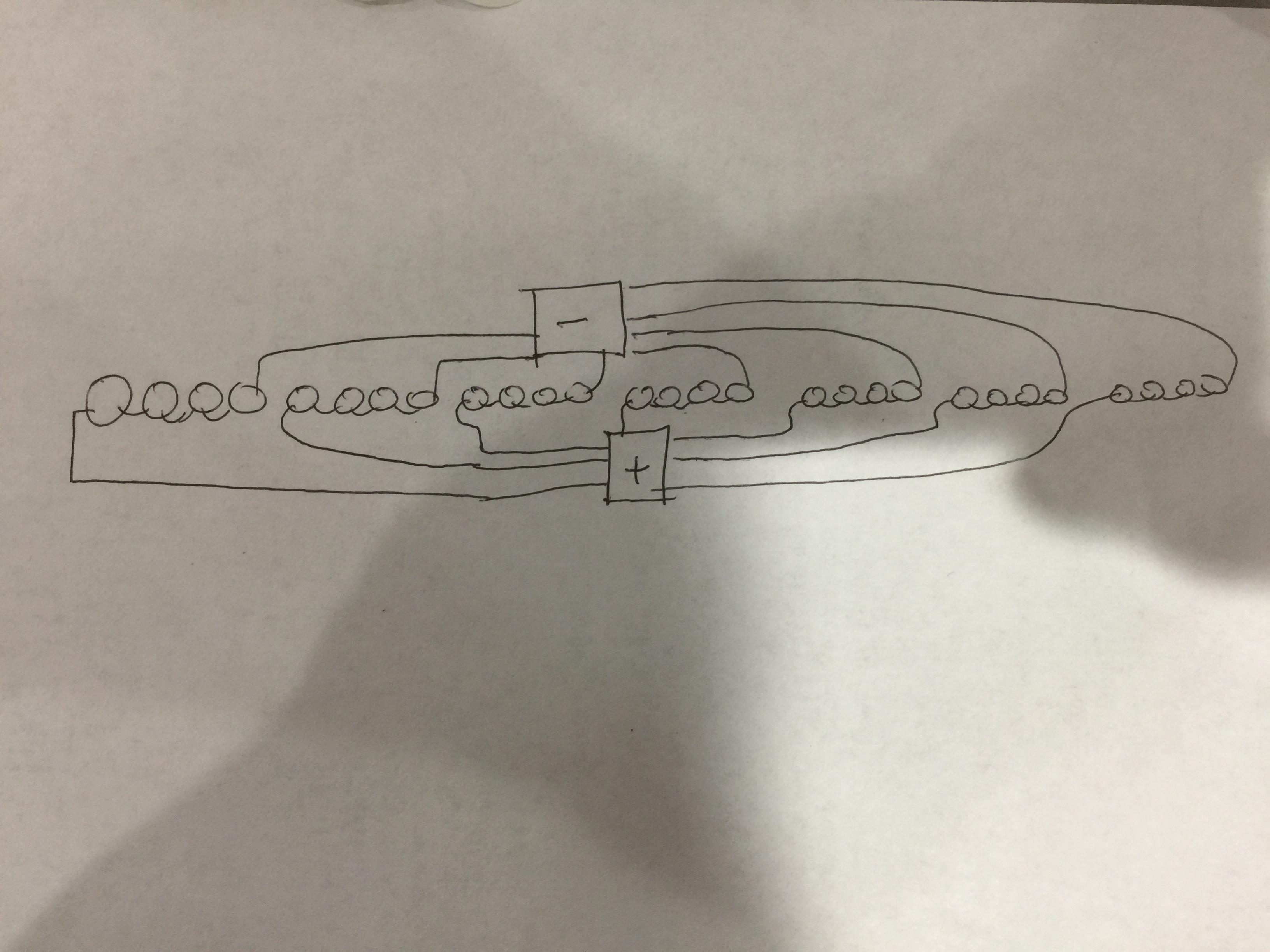

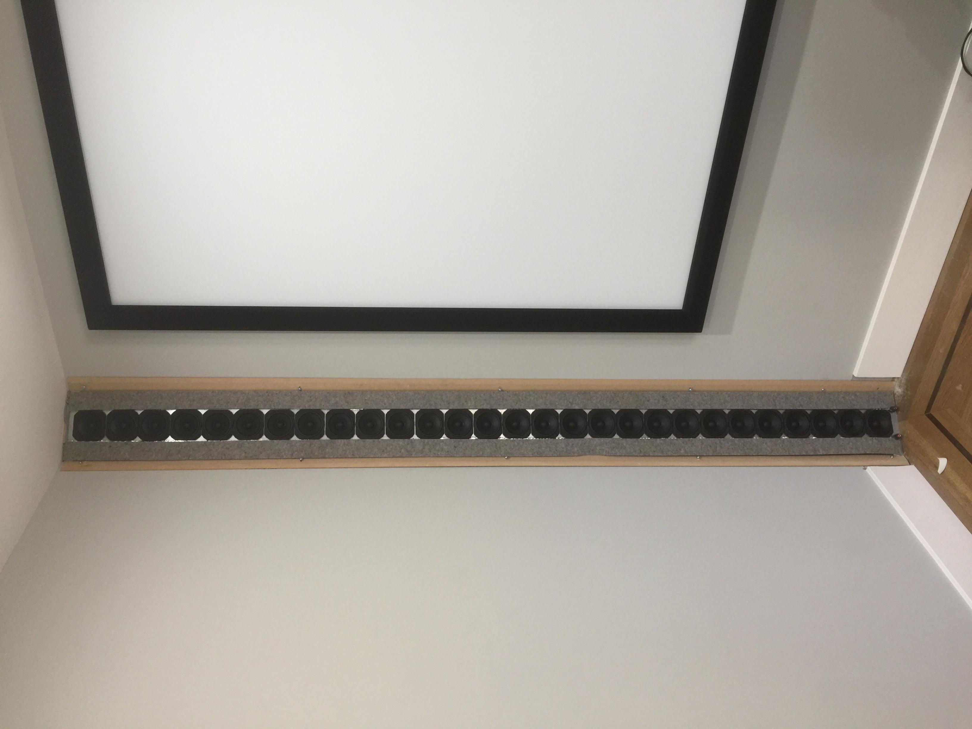

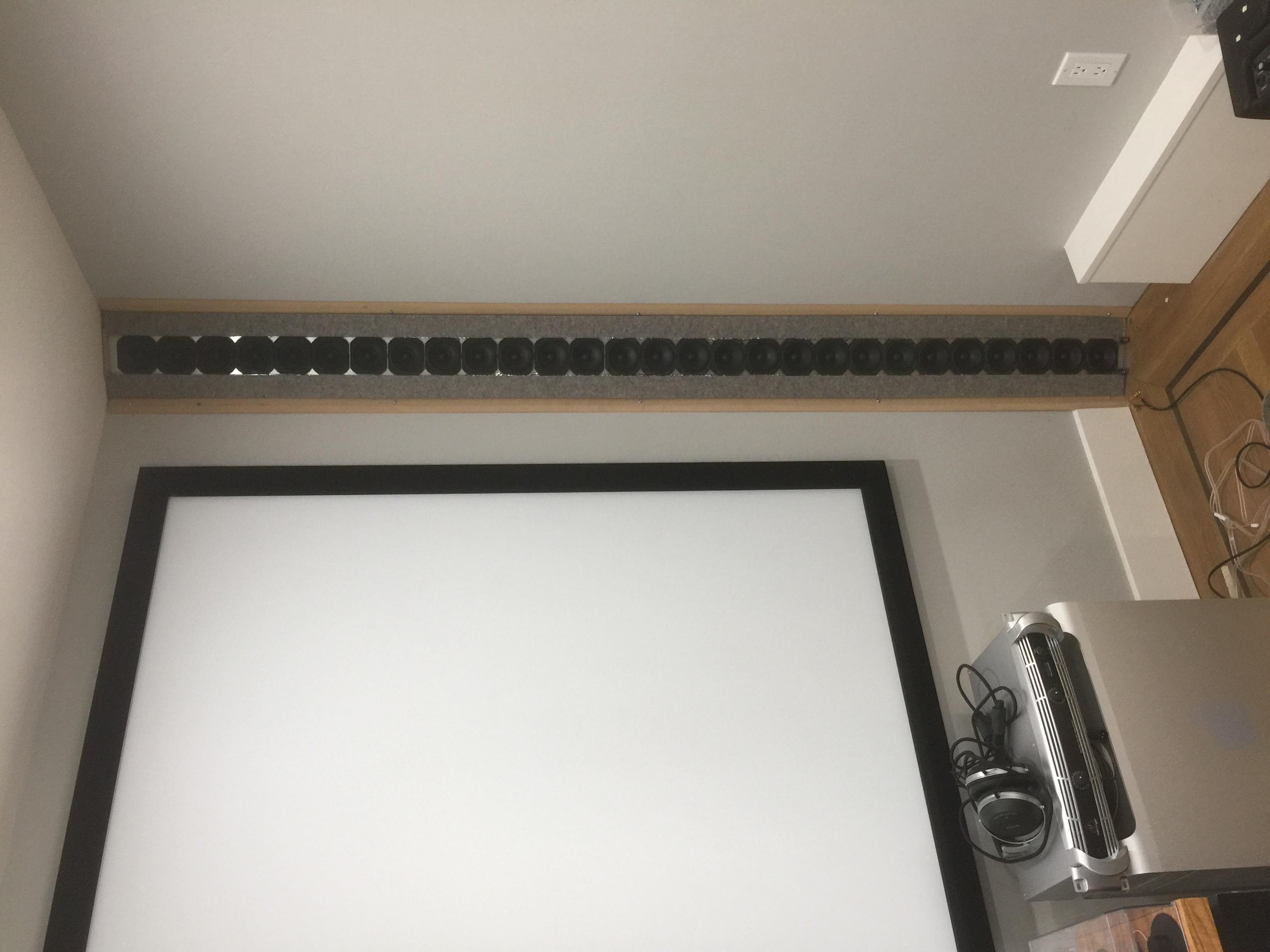

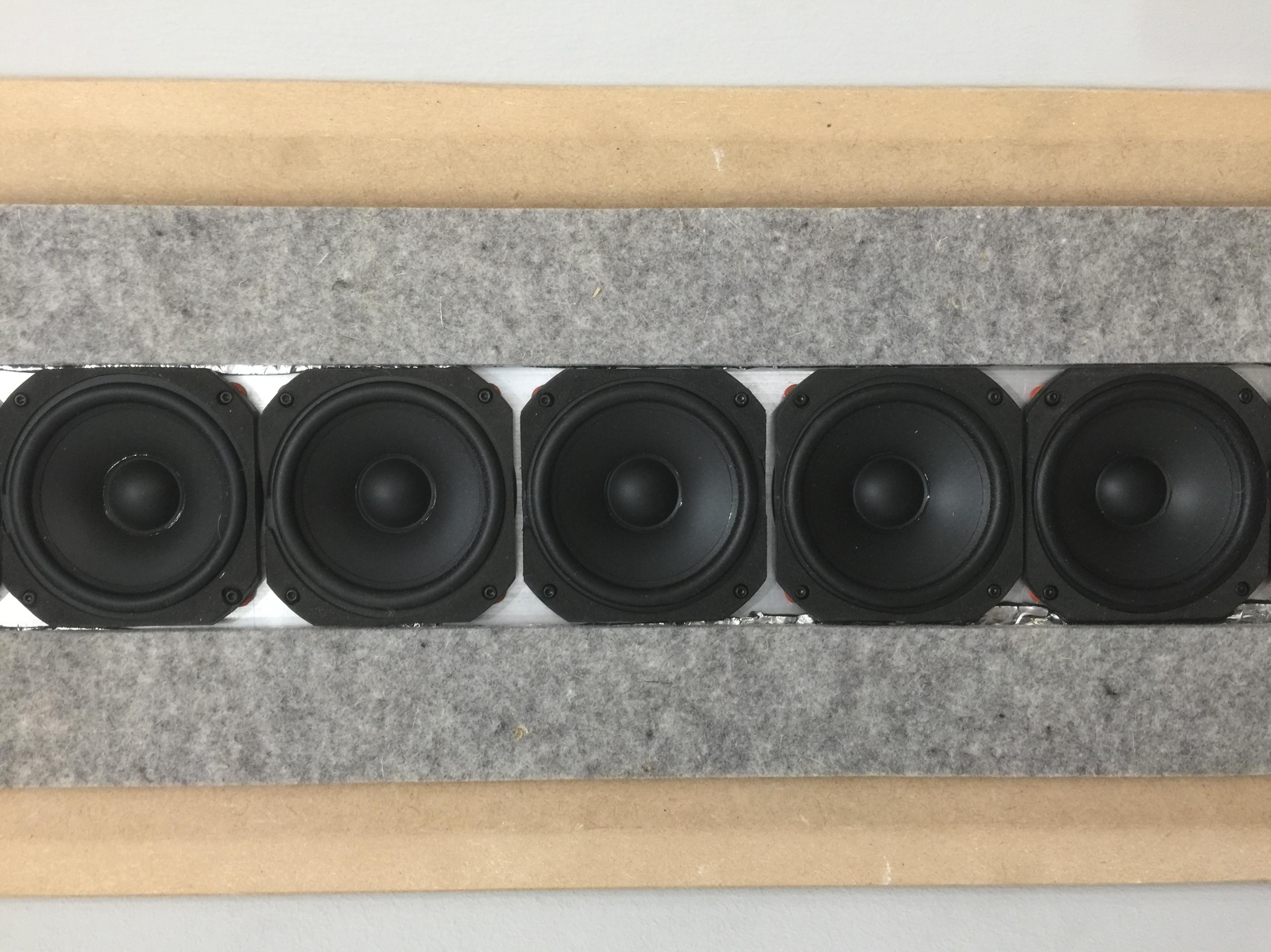

I wired it up as shown above and gave it a low volume whirl. No magic smoke escaped and all the drivers seem to be happy and making the sounds they should be making! Didn't sound too bad considering it was just propped up on my table saw. Obviously, I have no idea what it's going to sound like for real, but it's a major milestone nonetheless!
Still need to get the other one wired up. And I have a new idea about the mounting that I think will be an excellent solution. I'll sketch it out for feedback in the next day or two.
Did you see the discussions and simulations over at fluids thread, based on those if you could get away isolate their back chambers four at a time think there is theoretical improvement run them wired as a 4x paralleled group and then series connect those 7 groups. Separating enclosure or not verse choosing parallel or series groups is the big question, although we up at lightspeed and can't hear or see that process if we think about it its a sequential process where power goes from positive to negative return point so if we could recognize up that speed and it was LEDs then lightning would probably run a little bit or feather, also when series wired its probably not rock solid stiff impedance they see from their neighbors when some voice coils is not at rest position either because its pushed by some electric power or other surrounding acoustic pressure.
Ah, I do vaguely remember that discussion. I'm unlikely to separate the enclosure into sub sections though so I think I'm satisfied as is. Bigger fish to fry than light speed nuances! 🙂
Bigger fish is probably good argument there 🙂 also volume would shrink a bit with separation and it doesn't look like you build house up from beginning to hold more volume into corners as announced in first plans.

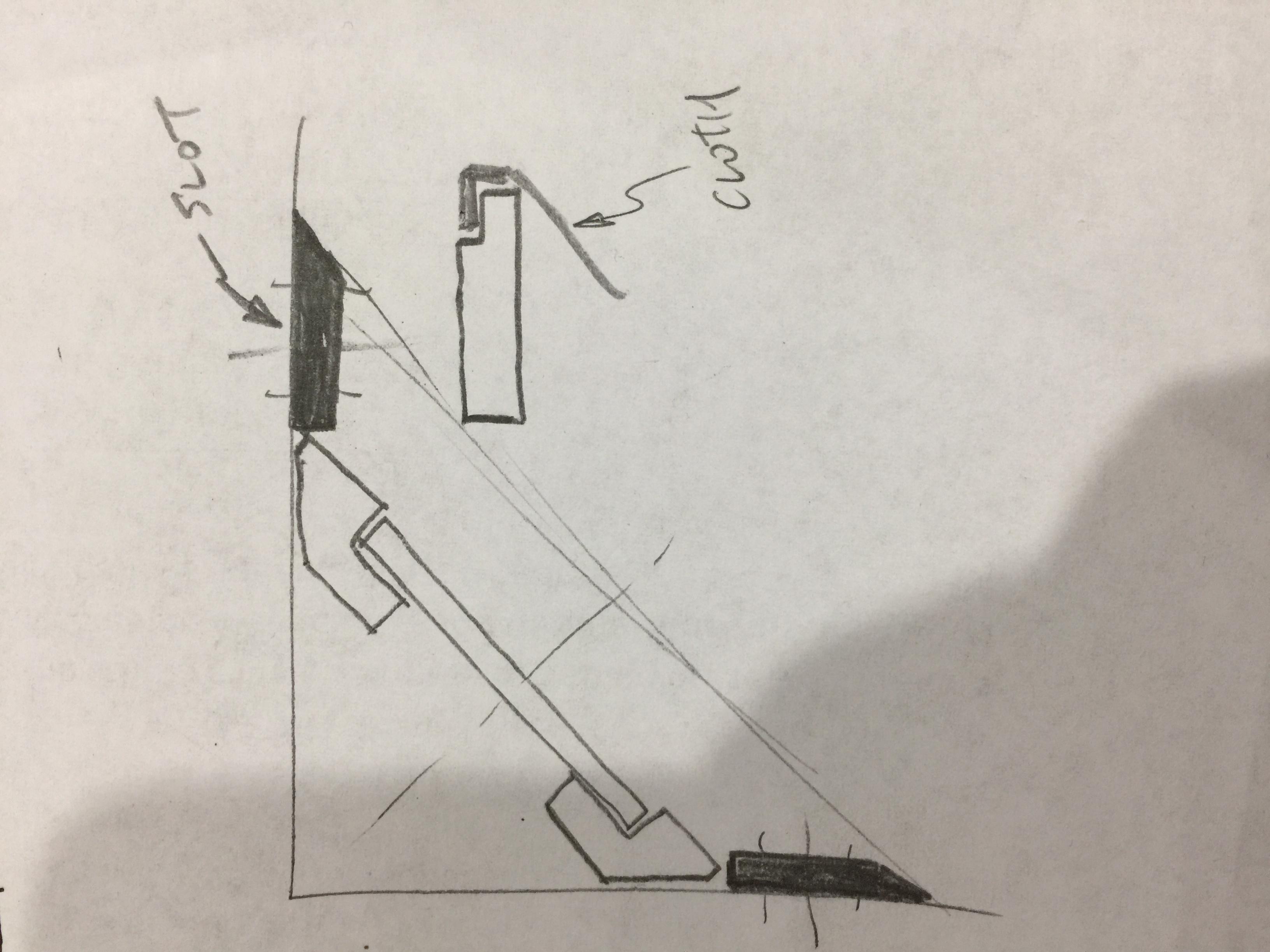

Yes indeed. I'll sketch up my idea for baffle to wall interface and share that for input later this week. But to your point, my idea solves for this and other considerations as well. I'm half way through wiring up the second array but I'm on business travel this week so it may have to wait until the weekend. But I look forward to your thoughts on my idea.

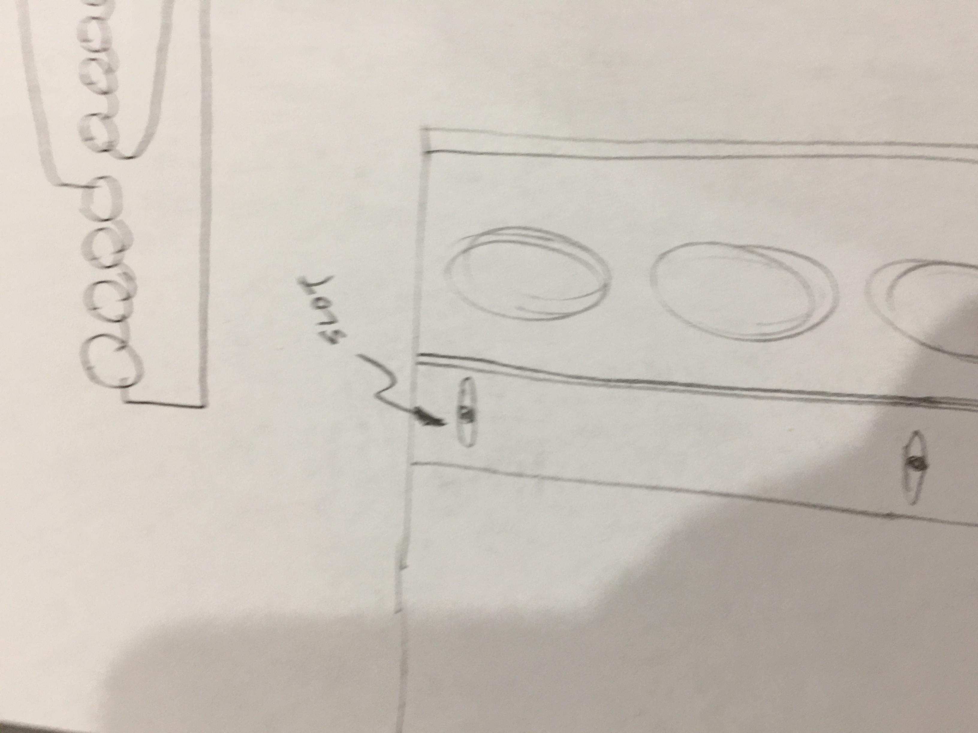

Here’s the idea for affixing the baffles to the corner. Basically, it’s just a piece of thin wood with slotted holes that I can press against the baffles to squeeze it into the corner compressing the neoprene seal before tightening the screws.
Nice thing is that I can use a spacer to get more volume and then cut a new side piece to match the new width and even profile it to minimize any sharp edges.
And of course, removal is easy too. Side note, in the sub sketch you can see I plan s shallow rabbet along the outside edge that will accommodate a strip of wood that the grill cloth will be wrapped around a couple times. Should simply wedge in tightly.

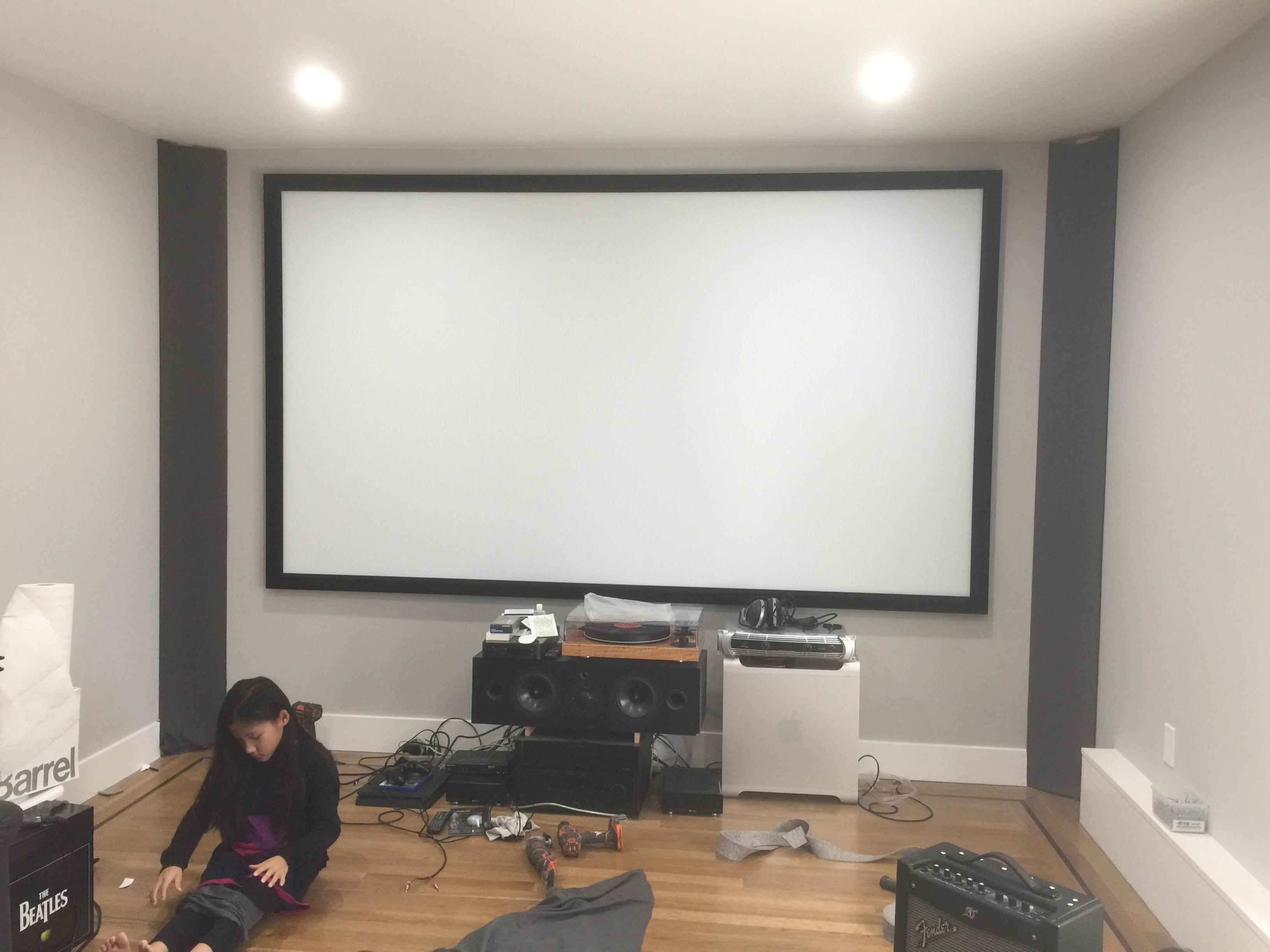

Got everything ready to rock and roll today. And did a quick Dirac Live setup with my XMC-1. Sounds pretty good but I need to fix some things.
First, the braces I sketched out were too thin. I tried using some 1/4” MDF I had lying around but I think I need 1/2” thick material to make a more solid “clamp” so to speak.
Second, I still need to apply the felt to the sides and the MLV to the wall.
Third, and perhaps more importantly, I need to start studying my convolution stuff again!
Then there are the corroborating projects to get moving on. Namely the subs and the room treatments.

I got everything buttoned up today. Still need to clean up some of the not so clean parts of the grill cloth at the ceiling. But otherwise, it turned out pretty nicely.
I ended up just screwing the baffle directly to the wall partially so I could use the braces purely to hold the grill cloth in place and partly because it was just stronger and simpler that way. Originally, I was not going to do so because I was concerned about not having plywood behind it but it turns out the shear wall was there on all three walls.
Next I need to think of a way to trim the grill cloth at the top and bottom. And of course, get out my convolution tutorials.
