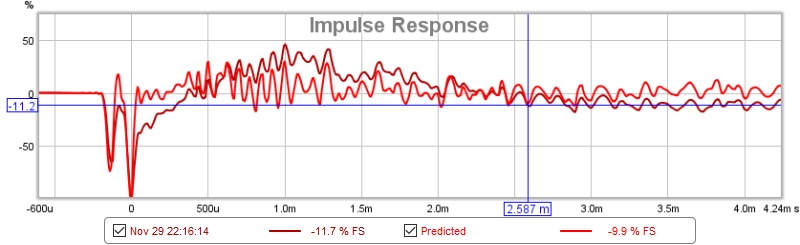

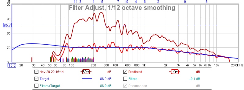

In other progress... I thought I'd share the EQ and impulse graphs that generated the PEQ I'm currently using.
The impulse is pretty wonky but I have a lot to do in terms of the room. Even just basic stuff like putting a bunch of random crap away and building the shelving so my gear isn't strewn around the front of the room. But there's also the sound absorption panels that need to go in. Even so, it looks really bad so I may need to do something differently. Maybe windowing?
Also, when I choose XMC-1 as the equalizer, it doesn't let me boost above 6dB although I know the XMC will allow larger values. When I use generic, it creates more than the 11 filters the XMC allows though. Is there a way to limit the number of filters but not the boost? Which brings me to my next question...
Is there a theoretical ideal for how much of the spectrum to boost vs reduce? AFAIK, you don't want to boost too much to make sure you don't damage any amps or speakers. And also keep signal/noise in check. But I don't know if there's an ideal target.
In any case, if there's anything that you see in the graphs that you think I should do something about or is interesting, let me know.

Something into chain or microphone is inverting IR, that could be dynamic reversed for each measurement on IR tab, or to do it static for future measurements use "Preferences/Souncard" checking "Invert".
Another thing is double peak and guess its caused by measure both speakers at listening position so think before making any EQ based on measurement you need to sweep and align microphone moving it a bit from side to side until both peaks align and then its ready to be sweeped to base EQ correction.

I noticed that. I can just swap the wires at the speakers but I'll double check the signal chain. Otherwise, I'll check the invert button.
Good call on the double peak. That makes a lot of sense but I wasn't thinking that way since the peaks look pretty far apart to me but I guess we're only talking about 100 micro seconds or so. Also, I assumed REW aligned the peaks automatically but in retrospect, I'm not sure why I would make that assumption.

You can use either EQ, whatever brings you the best results. In my home JRiver is connected (trough the DAC) directly to an amp without EQ, so all my EQ is done in JRiver.

I think I remember reading early in your thread that you keep this pre-EQ pretty broad with maybe 4 filters that had fairly small Q to just get the FR in the ballpark and let DRC take care of the rest. Did you manually do this or is there a way to force REW to limit the numbers of filters and the Q like you can limit the gain?
I did it manually, within JRiver's EQ environment. If you use a 6 cycle FDW it will be easy to see general trends in the response.
The FDW is used to get a view without a lot of room response mixed in. It won't avoid the room but does soften the effects of the room.

Seriously, I tried to level out the result. Cut around 200 Hz as much as boost needed down low. It would depend on the enclosure volume but I'd keep it below about 20 dB max. I need less boost out in my room.
To be clear, my max boost is higher than my max cut. However I picked an arbitrary average level between the two. It would be easier to say the enclosed area of the cuts is about as big as the enclosed area of the boosts. Does that make sense to you?
Maybe its easier to say the average level between 20 to ~ 18 kHz is used as the target.
