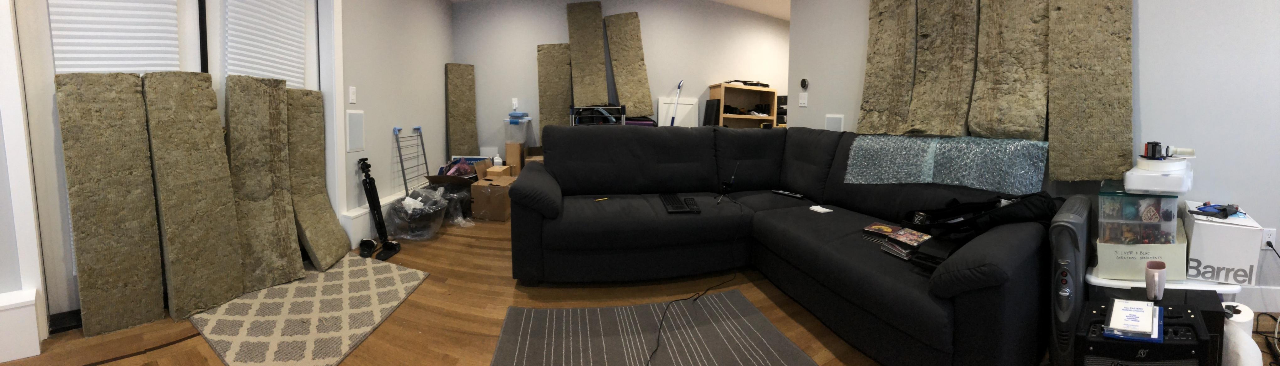

I'm tempted to just temporarily throw all the rock wool I have ready for the panels against the first reflection points just to get the measurements done even though the panels themselves and the photo canvas that will cover them aren't ready yet. Or I guess I can just sit back and enjoy where I'm at for a while and measure when they're done. Nah!
Be aware if you hang framed damping panels you're not hanging them "inside" your wave guide and add another ridge parallel to the array 😉.

I opened my bag of roxul just to see how things might sound. I seem to notice better soundstage at minimum. And clarity if that makes sense.
Took a few sweeps in REW also and it’s obvious the reflections are much better tamed. The main room nodes are still there but not as pronounced. I redid my XMC PEQ with these new measurements while I was at it.
