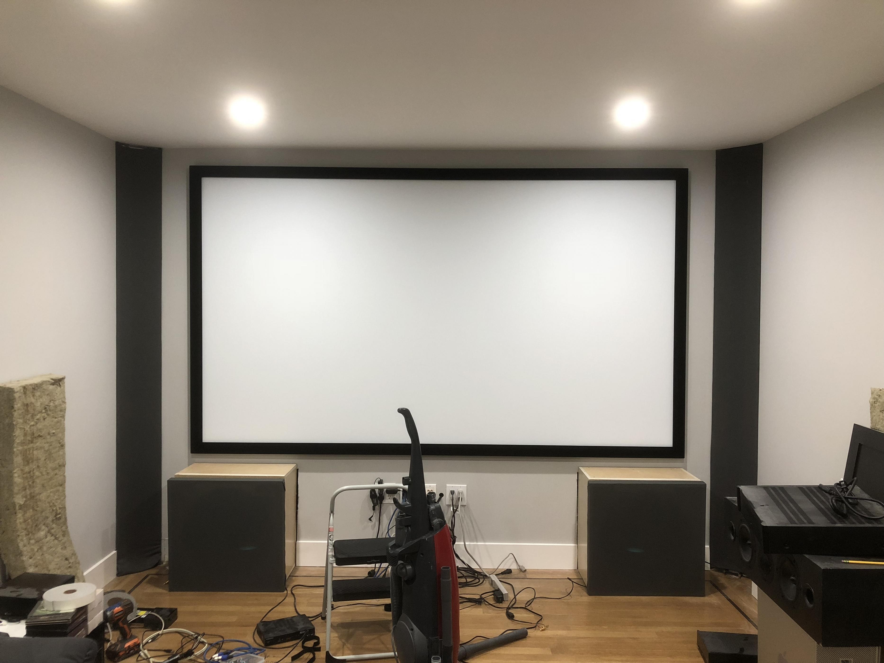

Cut the driver holes. Bolted the cabinets to the foundation. Mounted the drivers into the cabinets. Trim, grill frames, and wiring next.
What's the prevailing wisdom on wiring dual voice coil subs? I understand that I should wire in parallel for more power, but that's not going to be an issue at all given the size of these things and the iNuke 3000 I have powering them. I haven't been able to find any other definitive pros/cons beyond the power issue, so maybe you all have a point of view?

Redid the line array grill cloth and framed the sub grill covers. Just need to get the magnets installed so they’ll hang from the fronts.

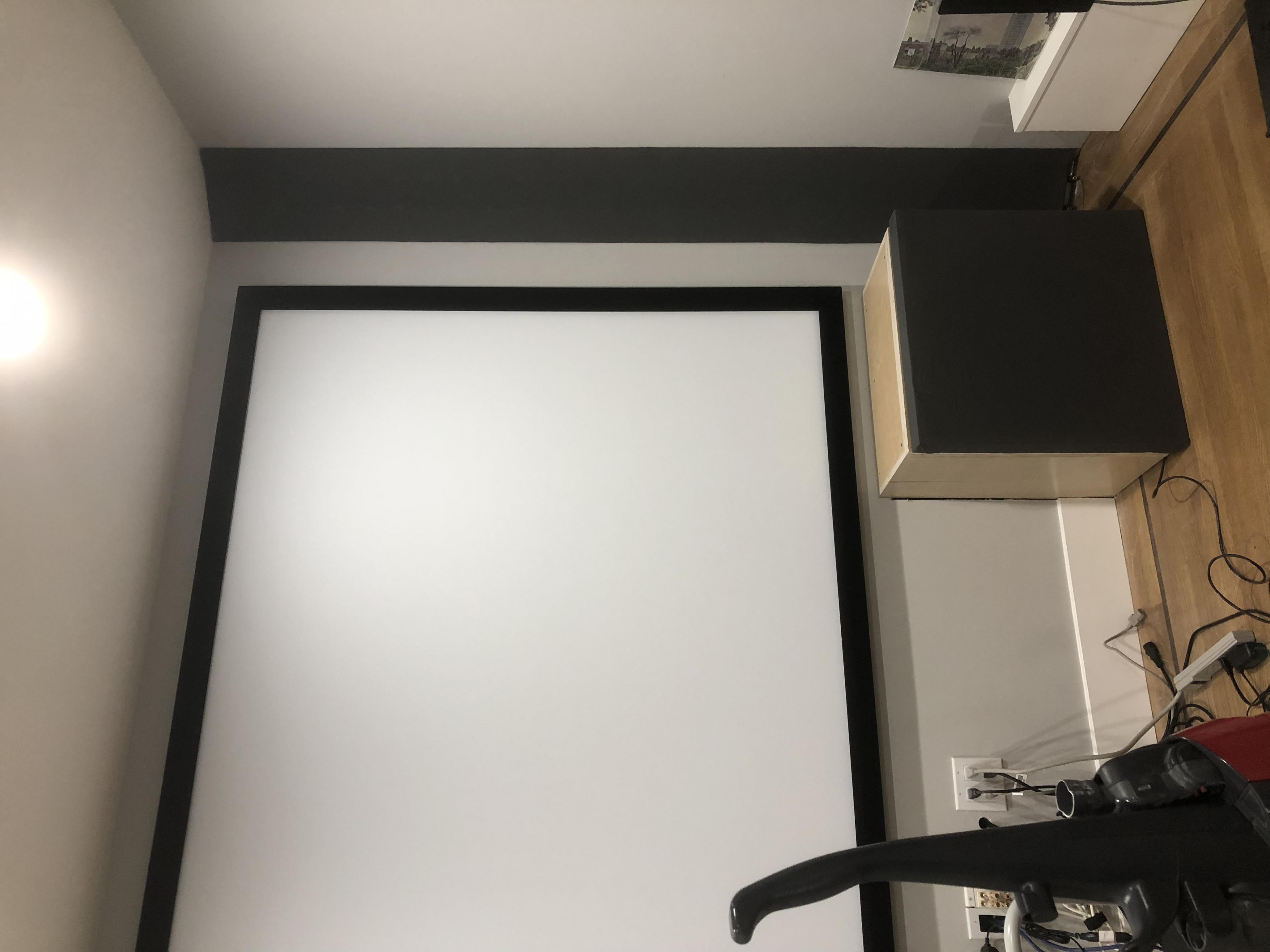

Trying to decide what to do about the cabinetry between the subs for all the other stuff now. Oh, and I mounted the iNuke on the other side of the wall since the fan is so noisy. XLR cables are routed between the wall plates for the other speakers and the four gang outlet.
No. That was the original plan as I thought the concrete foundation started on the other side of the wall. But instead, they built the wall on top of the foundation. (Long story as to why the foundation is so high on the other side of the wall.) So... they stick out a bit. Exactly one 2x4 (3.5") farther in. It messes up my line array a bit on the bottom and is visually a bit obnoxious. But the grill covers help. And I think they look more integrated once I get the cabinets done in between them as well.
EDIT: The cabinets are 10" deep and stick into the wall about 1.5". They are 23" square though so they are quite big. I don't think I'll have any problem with clean LFE at movie levels! =) I hope the room doesn't vibrate too badly though.

My worries are more about the reflection/bounce from the lower part of the arrays, messing up with the phase.
Yup... one of the compromises I had to make. In retrospect, I may have done a single sub in the center or placed the stereo ones closer together. But those are compromises as well. So we'll see how it goes. There were actually many other layout options but this is where I ended up after weighing all the pros and cons.

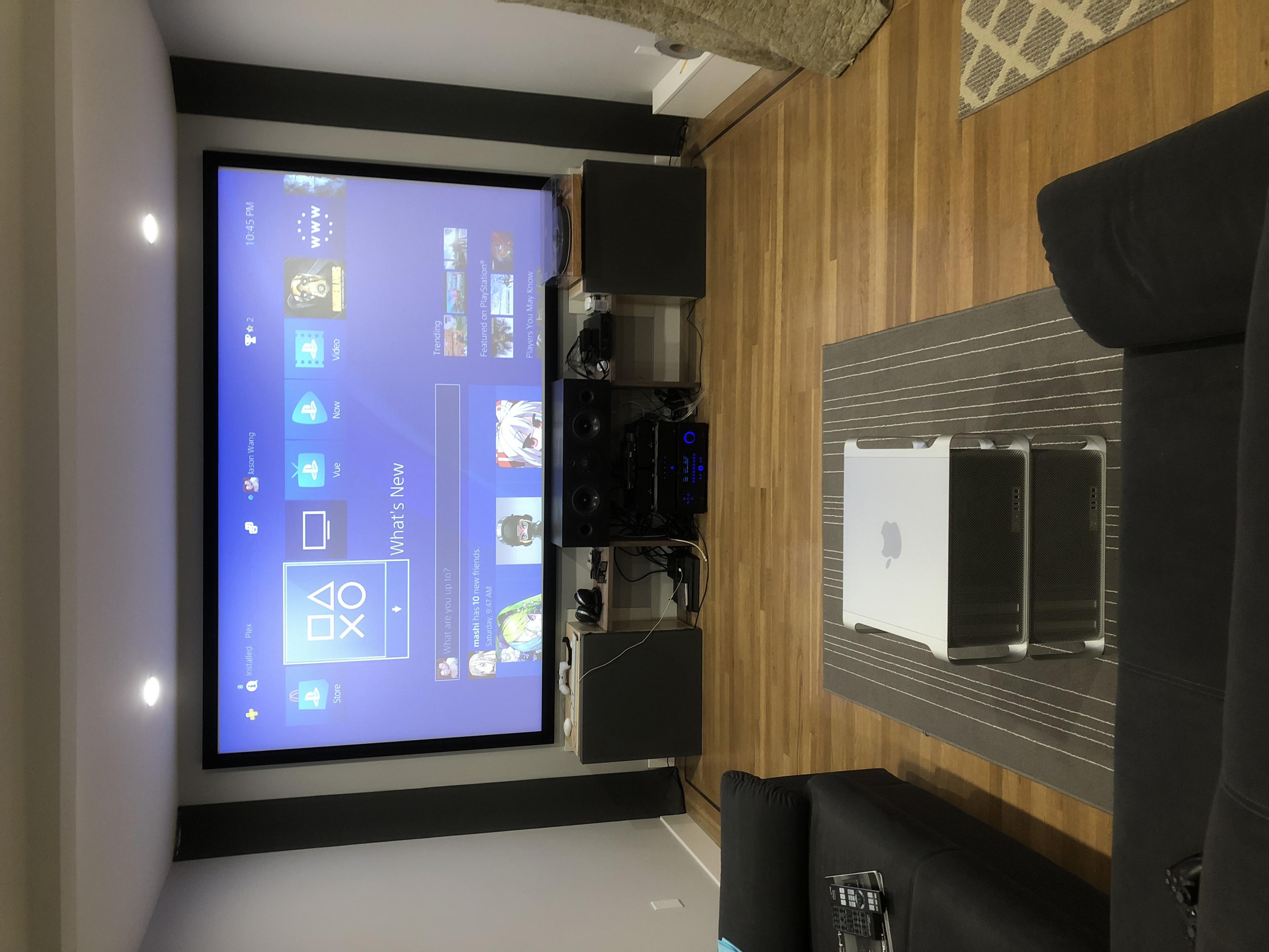

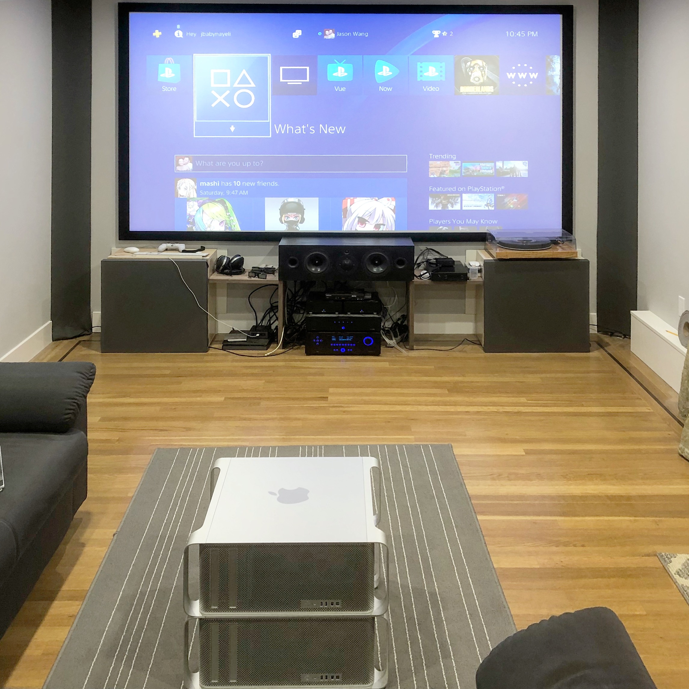

Up and running! Man, movies are more fun with subs. The infinite baffle concept works well too from what I can tell in that they’re not boomy at all. Still need to re run the PEQ as well as the DRC designer stuff. But I’ll wait until our canvas photos with roxul are up. Sounds pretty good for now.
And yes, those are two Mac pros acting as a coffee table!
Looks very nice... if I tilt my head to the side! 😉
I'll bet movies sound great! I'm sure the music is pretty good too!
Enjoy!
Now comes the tweaking part... just as hard as building the whole thing... if not harder! 😉
PS. Lucky you with those coffee tables. They still sell those MacPros between $800 for a G5 to $3,000 for Xeon over here!

Both mac pros bit the dust a while back. One is mine the other is a friend’s. I think the motherboards went. They’re both circa 2005-2006 or so. I may get a glass top and make it a more conventional coffee table. But it’s actually not bad as is!
