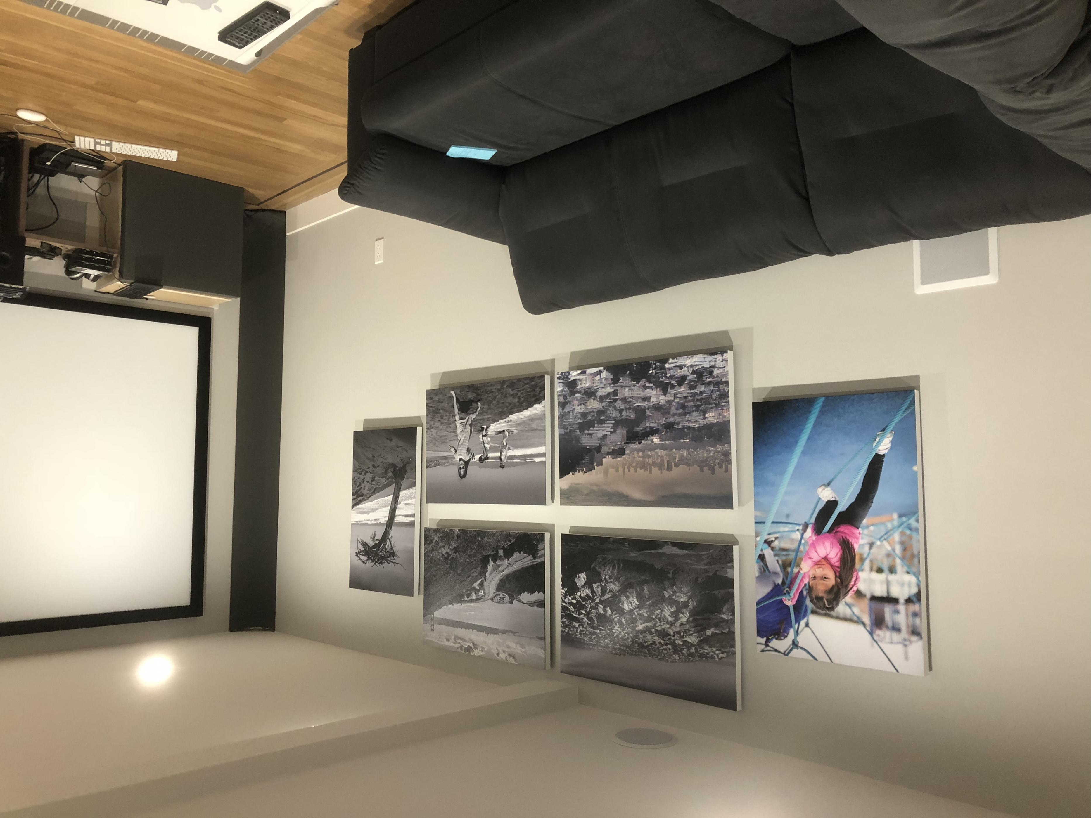

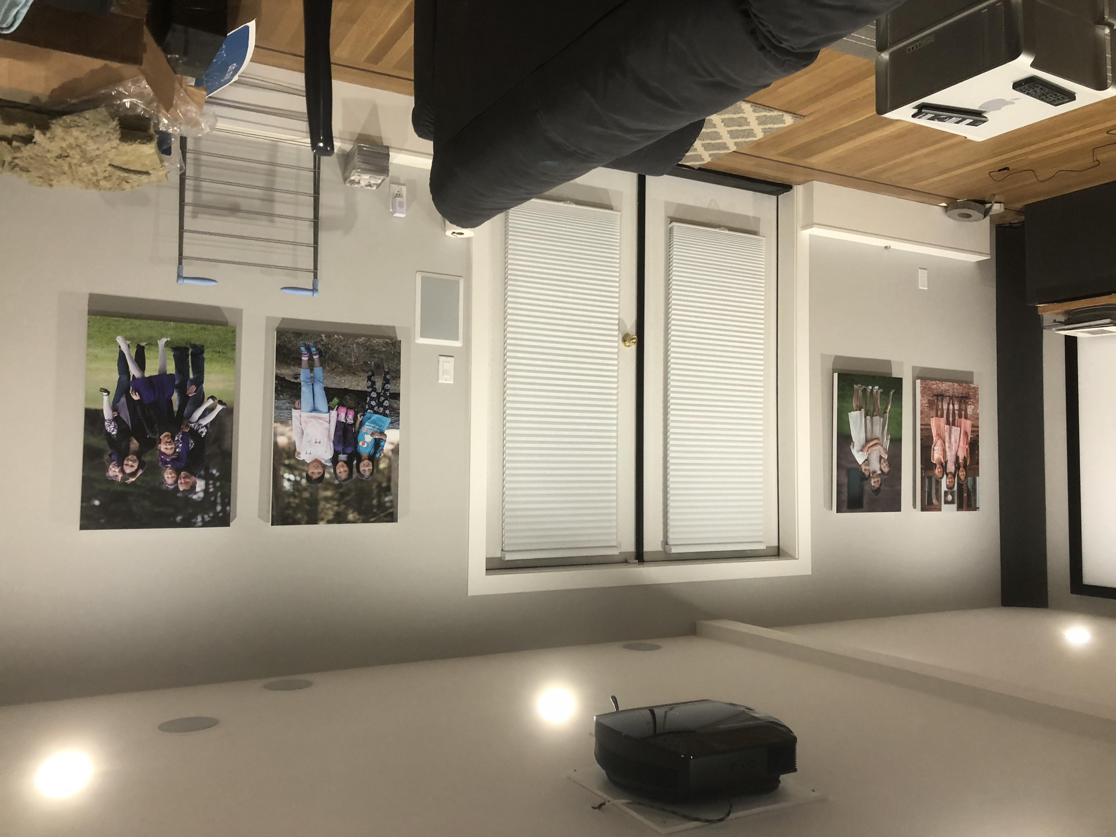

Had 13 20x30 canvas photos printed at Costco. Stuffed above 2” of Roxul behind each one and here we are. Seems to be pretty good as far as the clap test goes. Probably could use some more at the French door so I may make a temporary one that I can move when as needed. Otherwise, it’s done for now until I get the wet bar behind the couch built.
