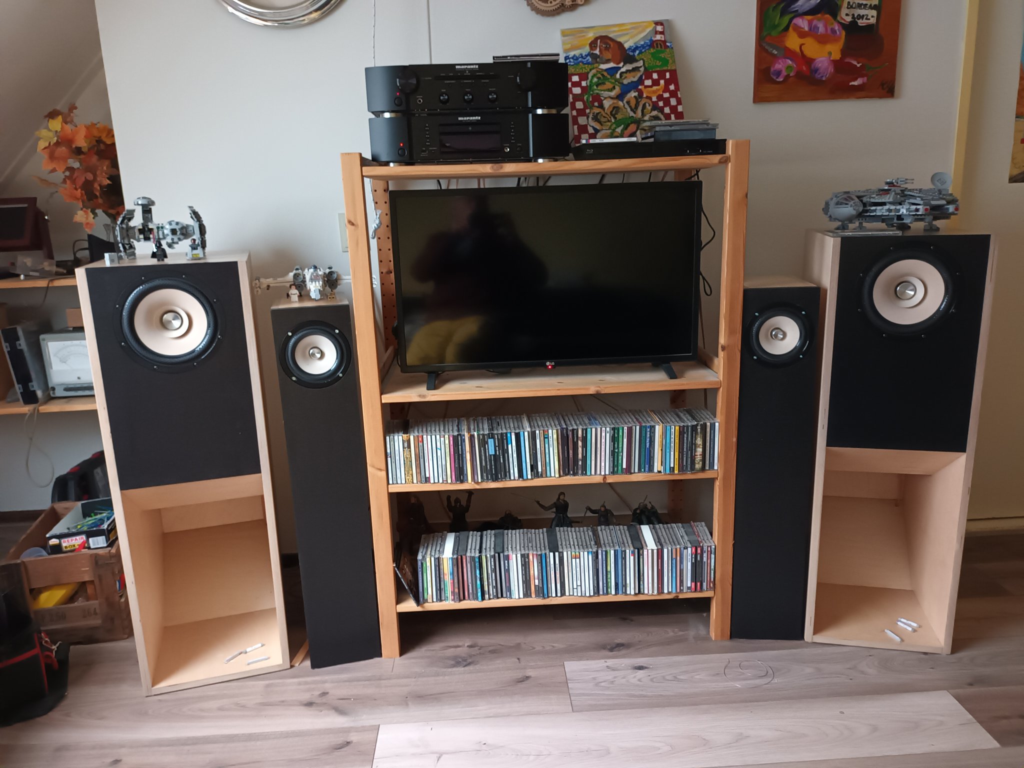

These are Corbra Horn II's. Next to them are the Merlin ported boxes, also from Hobby Hifi. They have the Tangband W5-2143 inside. The Corbra's totally blow away the Merlins.

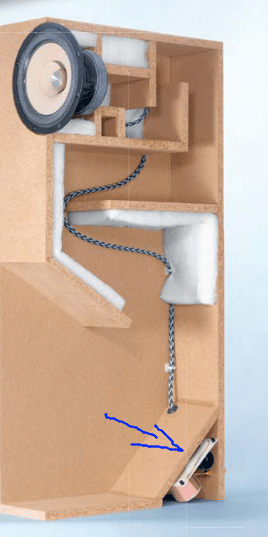

There is empty space inside the Merlin and separate space for the triple notch filter. Also there is a helmholtz resonator inside to suppres the lengthwise standing wave. So imo this is a classic ported box.

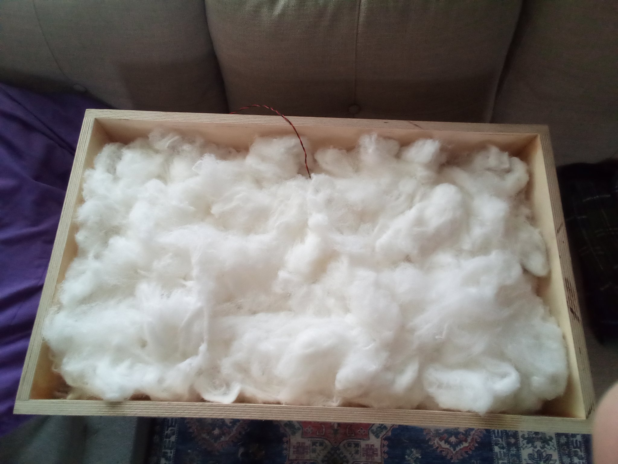

sorry, no pics yet.........
But builder brought in box and I stuffed it.
I'm an overstuffer, box is just over 3ft3 and 3lbs of acousta-stuf wasn't enough to me (after teasing then adjusting).
I'm bringing home, will add more stuffing, then pics tomorrow late afternoon.
I'm happy the driver frame will be clear up to the top edge, only 1 screw in a generously drilled out pilot hole and wood glue for the top screw, going into the top wall baffle. 13 ply baltic birch.

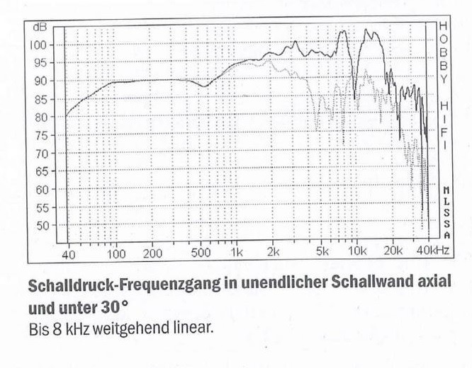

I can see from hobby hifi 2017 that there is the typical 2.5khz +5db peak found in 8" drivers.
Cobra 2 has notch using expensive mundorf parts, 1mh (12g .3ohms) + 4.7uF + 3.9 ohms.................
Think I saw on a German forum where the resistor can be 3.9, 4.7, or 5.6 ohms, up to you.
Can't say as the peak bothered me, especially for movies, but if you all could point to some music that would spotlight it, so if I made a notch filter, I could hear it is a help........

The peak/dip was not annoying to my ears.
Usually 8khz peak is hissy, or too much s's and t's.
I am curious about the dip at 10khz, maybe something to do with the phase plug being a cylinder instead of a bullet, not even reaching the top of the whizzer.
That baffle step looks bad.

From the hobby hifi 2017's test
"Conclusion: the w8-2145 is currently one of the best 20 cm full range speakers, and at a very popular price. Assuming careful linearization of the frequency response, it achieves high-end qualities in the cobra horn."

To be fair, the published graph from tang band shows maybe a +4db spike at 2.5khz

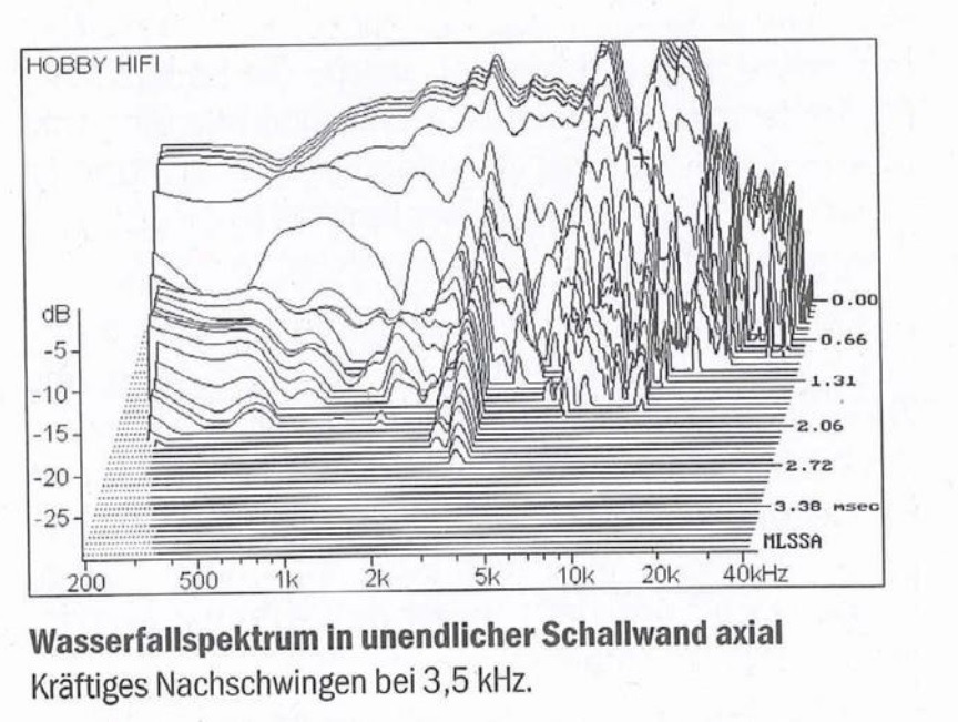

Picture from hobby hifi 2017
Translated from german.....
"powerful oscillation at 3.5 khz"
