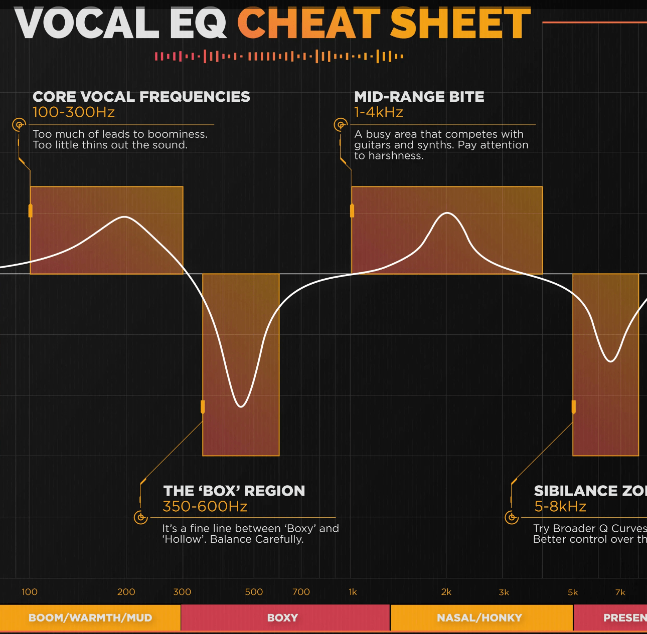

Saw this chart over on audiosciencereview............
Soldering circuit together tomorrow night, posting opinions on monday perhaps.
I've also been eyeing 15 band equalizers, they have a slide at 2.5khz (problem area for 8" drivers).

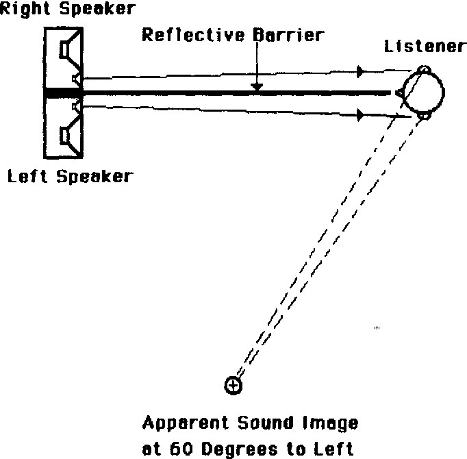

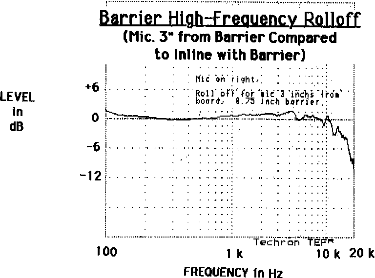

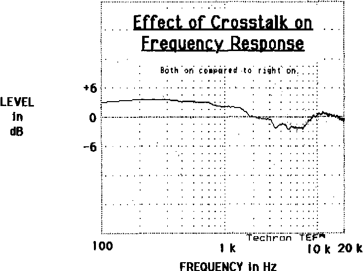

Those of you who have played with ambiophonics.
Cheaply done, move your speakers so they are side by side, then put a barrier between them extending from the speakers to your nose.
The center image is right there in front of you.
seperate the speakers, remove the barrier, and the voice is a hazy blob maybe 6db lower in level.
However, music is mixed on a stereo pair in front of you (basically mixing through this), so you will hear way too much midrange if you only use 1 loudspeaker (I think).

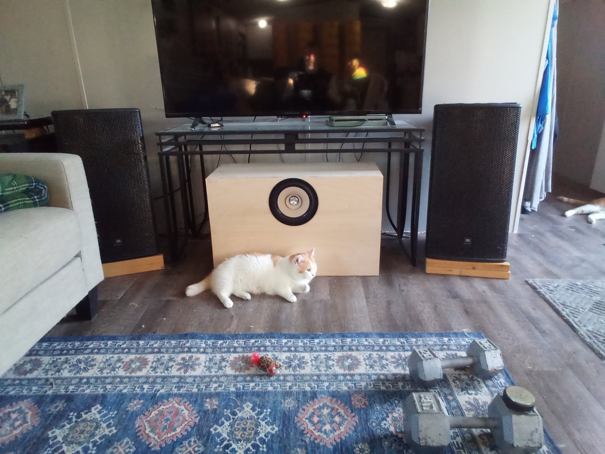

Ok, I ended up with 5ohms in parallel with the cap and inductor.
So 5ohms + 1mH + 4.7uF
Close to what someone on a german forum came up with, a little more resistance than for the actual cobra2 notch.
Next up, passive baffle step, or "bass boost" for my liking for music.

The voices when watching a movie definitely localized under the tv.
If it had wider dispersion (like a dome tweet), I think ceiling bounce could help localize voices to the center of tv.
I did prefer the driver directly next to the tv about centered to the tv (up and down).
