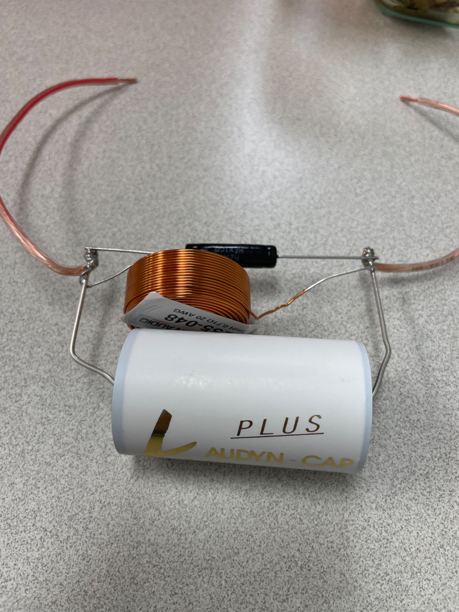

And they need at least two notches (either passive or EQ) to take out some really annoying peaks.
Let's face it, I've never had a driver that I liked out of the box, they all need some tweaking.
But with the notches, they become really impressive. The thin light cone paper really resolves music details well, coupled with that big magnet to control it.

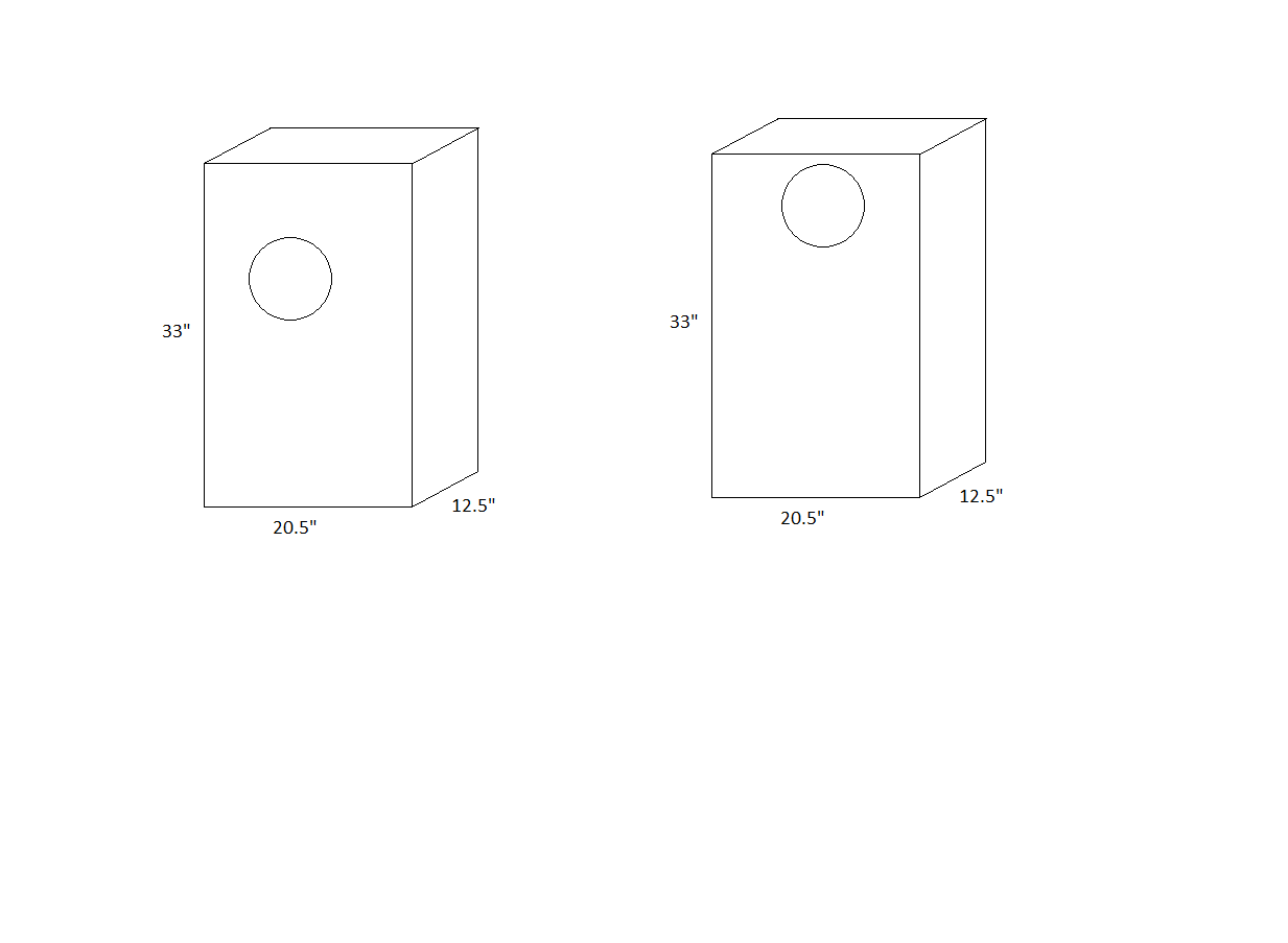

Yup. Making a bigger sealed, 36”tall x 22” wide x 14” deep (1.618 ratios), with the driver up at the top.
Different listening space, should help with mid bass (it does on the other speakers).

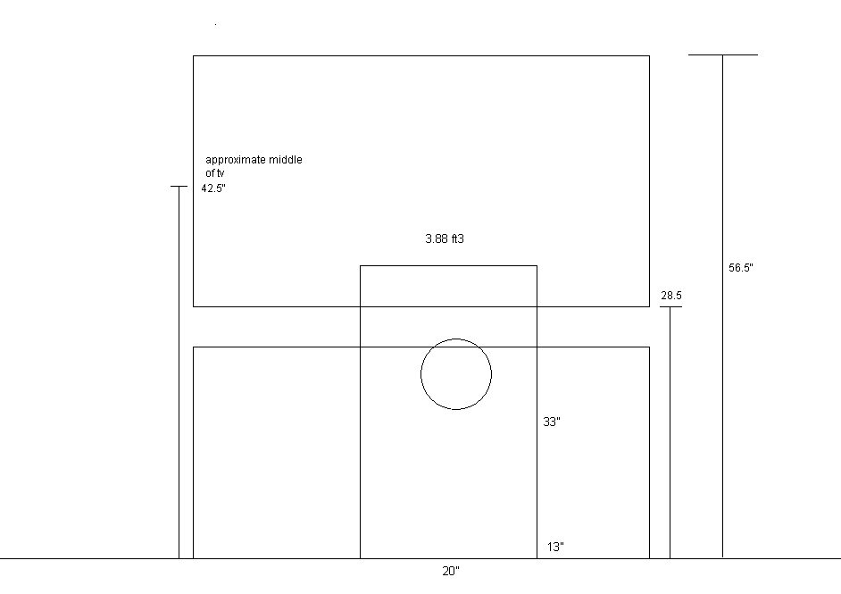

I'd appreciate your thoughts on driver at top or driver a bit down.................
To me, I'm leaning on driver at top to get speakers closer to TV middle.
Sitting 8' away, maybe movies 15% vs music 85%.....
Speakers will be on either side of the TV................
At extreme top; max TL gain at the expense of ideally needing more damping, so a bit of a 'catch 22', whereas at odd harmonics we get a progressively smoother response, minimal extra damping required at the expense of a less LF loading.
Note that driver(s), vent(s) ideally need to be at a pipe's odd harmonics, so with 'L' = internal height, 'Z' = driver, vent and using the acoustic center of clustered drivers........
Z = (L)x ~ 0 (top), 0.217, 0.349, 0.424, 0.561
Vent offset only (if used), depending on box HxWxD ratio: Z = (L)x ~0.651, 0.714, 0.848, 0 (bottom)
Can box be taller to get the optimum 0.349 (MJK), 0.424 (GM) preference?

Even golden ratio baffles benefit from optimized driver locations when fairly large like yours.

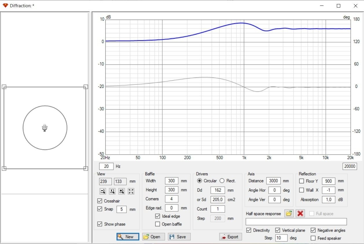

I can't see HF ever hitting the edges based on a head's dispersion at 8'.
I'm not so sure about say 2khz or 1khz (diffraction on the front).
Or internal peaks making it though to the outside

post 10
an ideal 8" on a 12" baffle
Way better than how a (centered) 1" tweeter lights up the edges (pic below it) .............
post 13 then 15 show moving the tweet around to get flatter responses................
This is an outgrowth of another thread. It was suggested that we needed a new thread where people could post their VituixCad simulations to enhance the general knowledge of cabinet diffraction issues and baffle layout.
It started with AllenB making a point:
I added my thoughts:
Ironing a driver flat shouldn't be a problem if you choose the passband carefully, however there are many peaks and dips in measurements but many are not due to the drivers. If you EQ them all you may create problems.
To expand on what Allen is saying: It is very enlightening to experiment with...

There is also software called The Edge that lets you do baffle simulations. It has one purpose and is perhaps more intuitive than vituixcad. Simply trying out locations is going to demonstrate very quickly which frequencies are affected and which aren't.

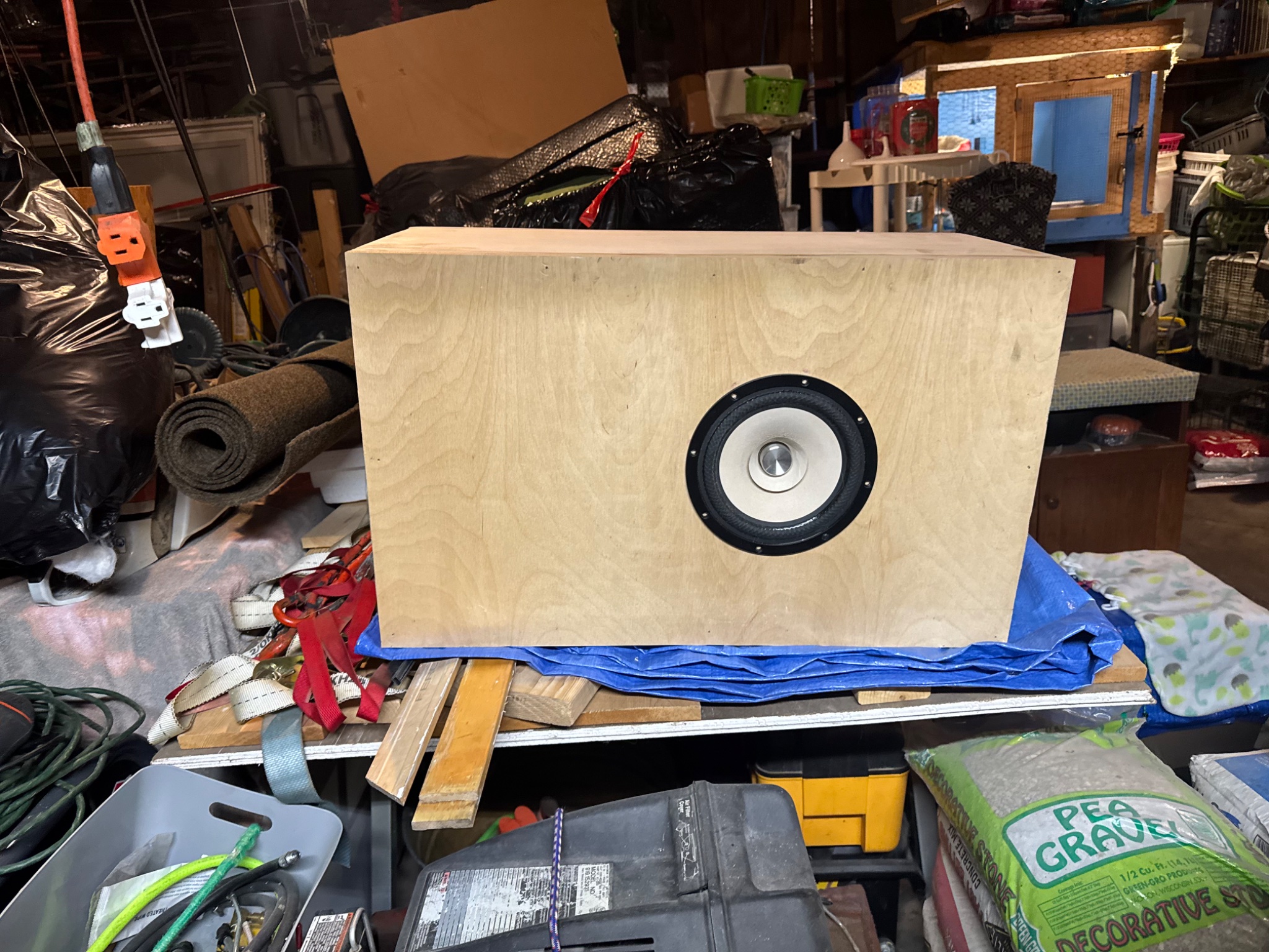

lol, well the builder couldn't pop the front panel off.
Instead, he cut a 10" hole for the driver in the original baffle, then shaved the 10" disc down to near 7", used it to plug the hole when the driver was right up against the edge.
Maybe this weekend add the 2nd baffle to the front of the box (with the hole so it looks like the pic in post above).
Still needs sand / putty, and the new driver installed.....................
But, coming along.
