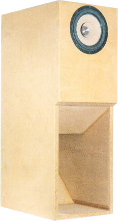

Hobby Hifi has a backloaded horn design with it, and detailed measurements. A very nice driver. The high frequency rise on axis is about proportionate to the fall off axis. Angling them more in or out allows for tuning to taste. Otherwise no obvious nasty traits to frequency response and waterfall plots.

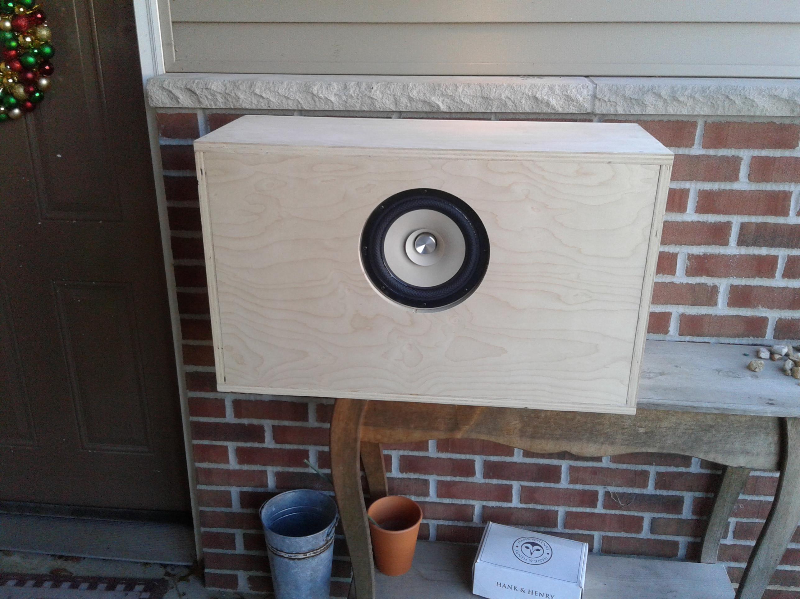

well, can port it instead of a big sealed.
qts .45, Vas 2.39ft3, fs=40hz
Outer dimensions (3/4" wood) 12" x 19" x 31"
golden ratio
I made a 1' x 2' x 3' box for a pioneer b20, worked well for what it was (qtc .57 sealed).
The 19" high works to get speaker at bottom of the tv (under it).

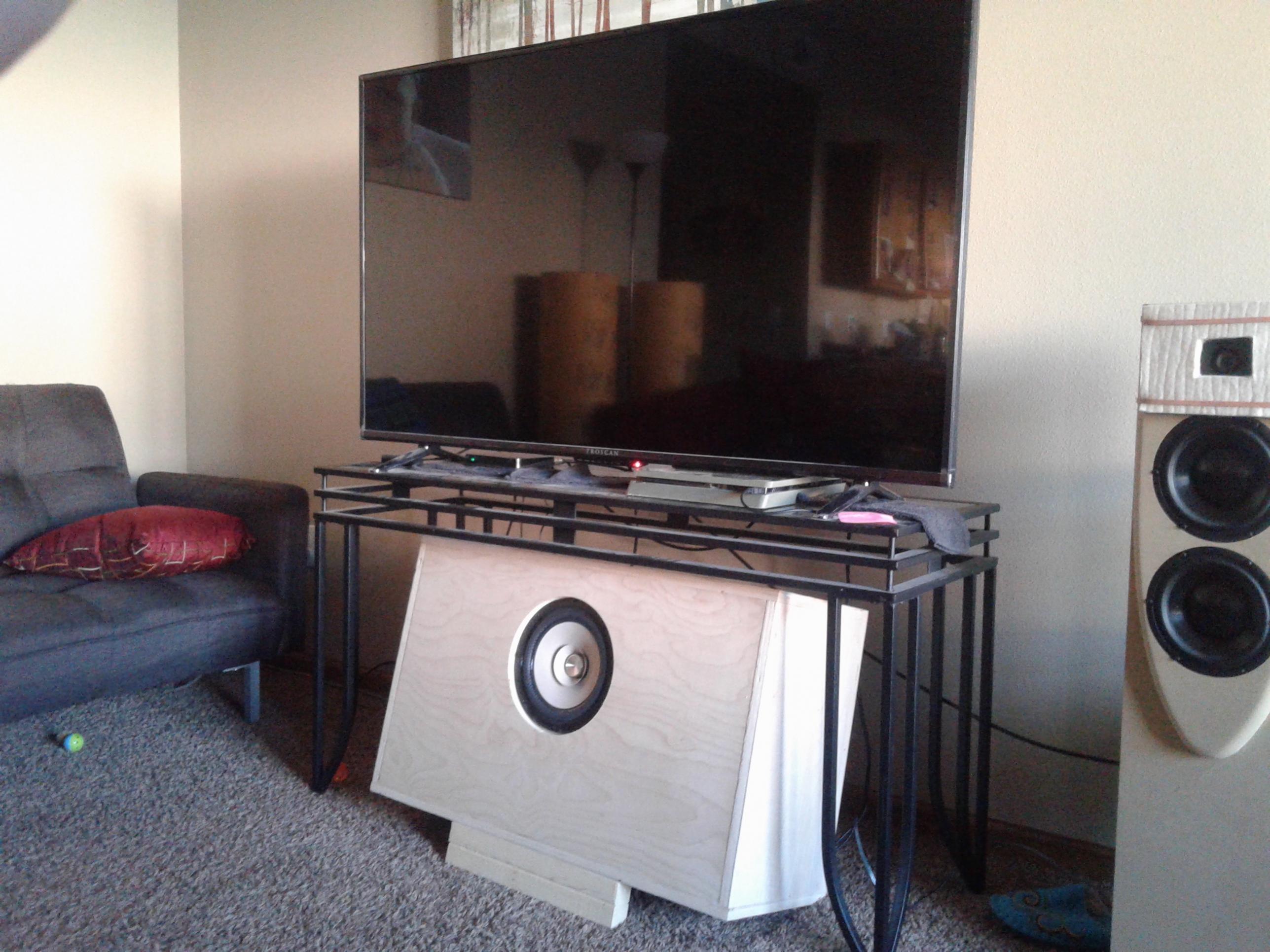

As expected, less than 90 degree dispersion, maybe couch wide at 8' or further away.
I'll aim the speaker between me and my wife, maybe tomorrow.
I believe a whizzer adds a decade for 90 degree dispersion, so if an 8" gets down to 90 degrees at 2khz (estimating), maybe a whizzer lifts that to 4khz.
Needs a bit more loudness curve applied than my morel solstice.
Bagby said there is baffle step in the crossover, i can't find it.
Solstice MLTL Reference Tower Speaker Kit
And my wife directly on axis agrees, that this center channel needs the blocks under it for the highs.

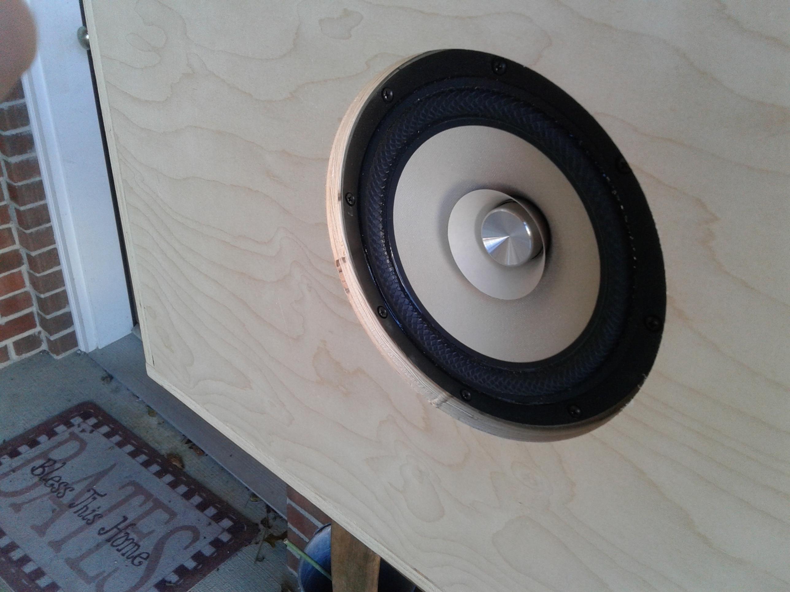

A few things wrong with the box, but it is done.
I'd written "flush mount", instead it is counter sunk (double walled the front, not asked).
So I'm sure i could measure a peak standing wave from the 3/4" deep 8" across column.
I'd have liked for the driver to be closer to the top of the box.
