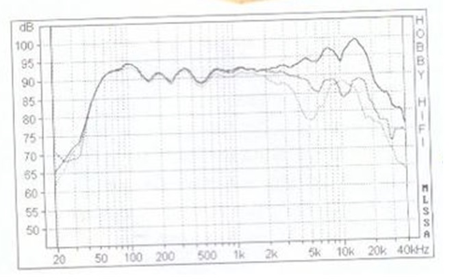

The 2145 actually has a bit of climb, that to my ears needs bass boost to balance it (not even mentioning baffle step).
I remember the w8-1772 with its climbing response needed 10db or so worked into baffle step (bob brines). Can't remember width of mltl.
I'll post a freq response measured from overseas later tonight.
Don't get me wrong, it is excellent and 1/2 the cost of 1808 (too hot 1-4khz) or 1772 (climbing response).
I just need to get it dialed in.
For an 8" full range, $200 plus you make boxes, price of entry is very reasonable.
I'd love to see others build some mltl, ported, whatever and dial in some passive baffle step circuits for us.
Should be fairly easy due to its flattish z-curve.

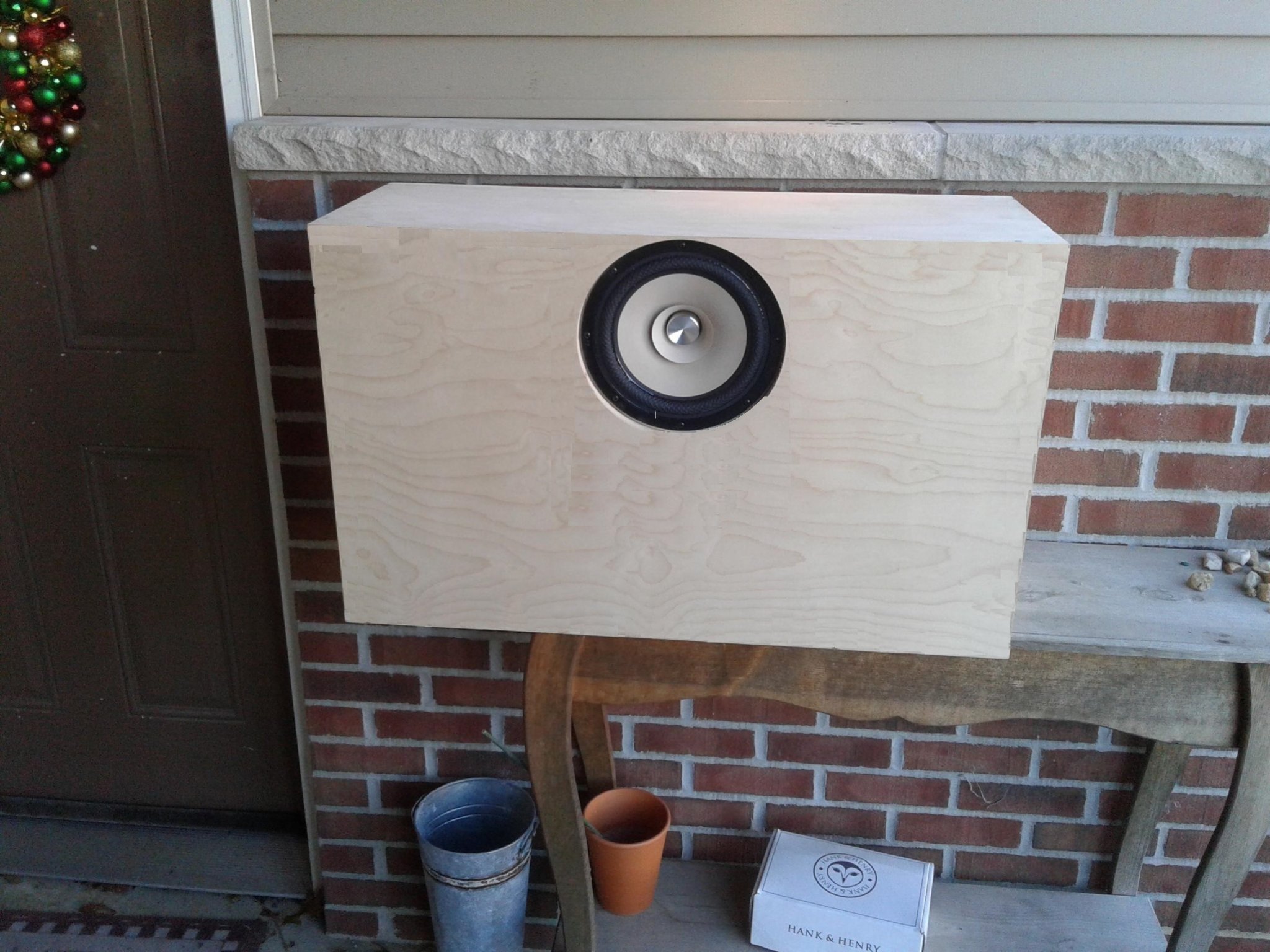

I'm thinking of remaking the box.
This time...............
Front baffle 1 piece (no lines).
Driver flush mount (not counter sunk).
Box exact same size, maybe ported.
And get that driver right up against top of the box, bring dialog closer to the tv instead of the floor.

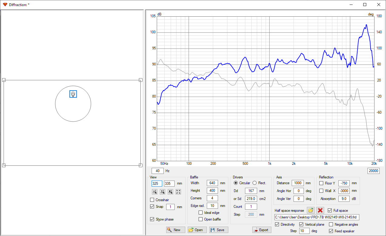

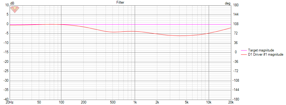

Here is the proposed box.

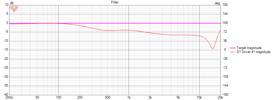

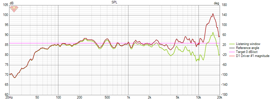

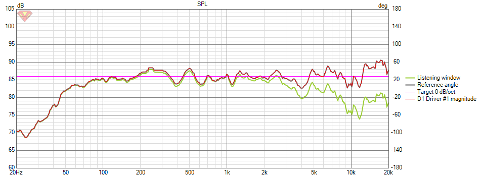

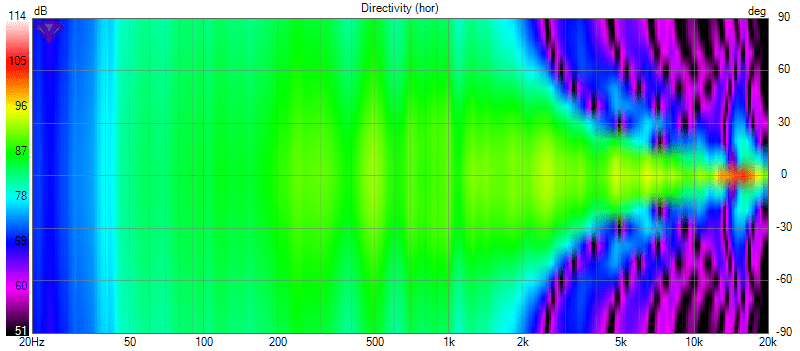

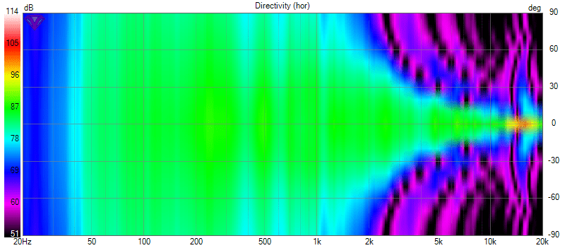

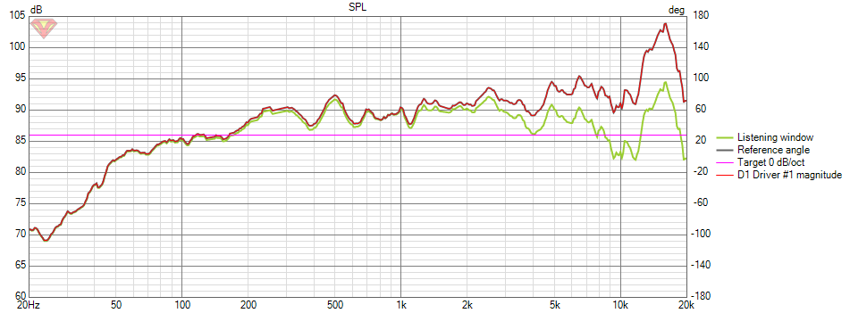

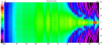

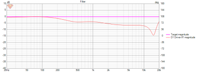

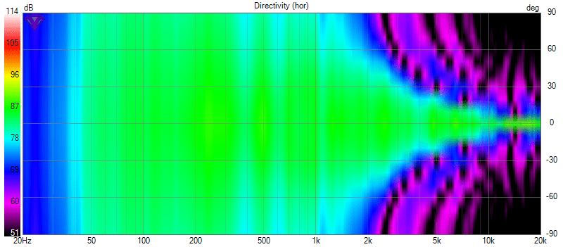

Was just curious what low end SPL might be in full space on that baffle.
Its around 86 dB. So depends how aggressive you want to get with parallel notches.
Keep in mind that is sim assuming 220 cm2 SD. So real world the Second cone
might hold up a little better.

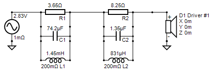

I can get it with relatively low Q notches so not much is lost off axis.

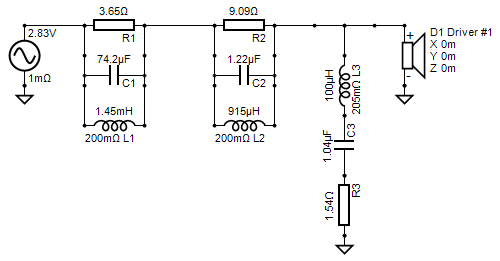

The peak at the top can be done with A high Q series. But likely not a
issue. looks like it would. In reality and can see just 10 degrees off and that
goes away.
just quick sim values, obviously would be changed to standard values
If you really want high Q notch at top end
real life likely not needed. just looks good in sim
Be too much off axis.

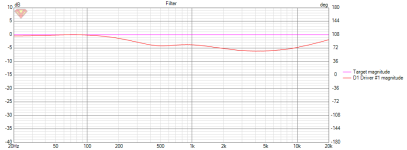

Downside I guess is passive filters are cut only.
So efficiency has to be brought down to 86 dB
Then bass would be apparent.
Then again looking at the easier way is basically a slight
bass boost on a simple 2 band EQ on many receiver's / amplifiers.
Remember seeing a review on youtube of some old Yamaha receivers.
Think so at least, trying find it.
anyways point is the Treble and Bass EQ could be shifted with a switch.
Bass was 450 Hz or 250 Hz. Which seemed pretty smart feature.
with this speaker could set it too 250 Hz give it about 6 dB
and be all done.
8" wideband will behave like a 8"
I dont mind either I have a liking to 8" as well.
And either way a 8" wideband makes a good 2 way.
The tweeter can be crossed at the usual 3k
And the second cone holds up well to the crossover point.
Because Sim diffraction wont exactly represent them exactly.
Because the model assumes the larger SD
