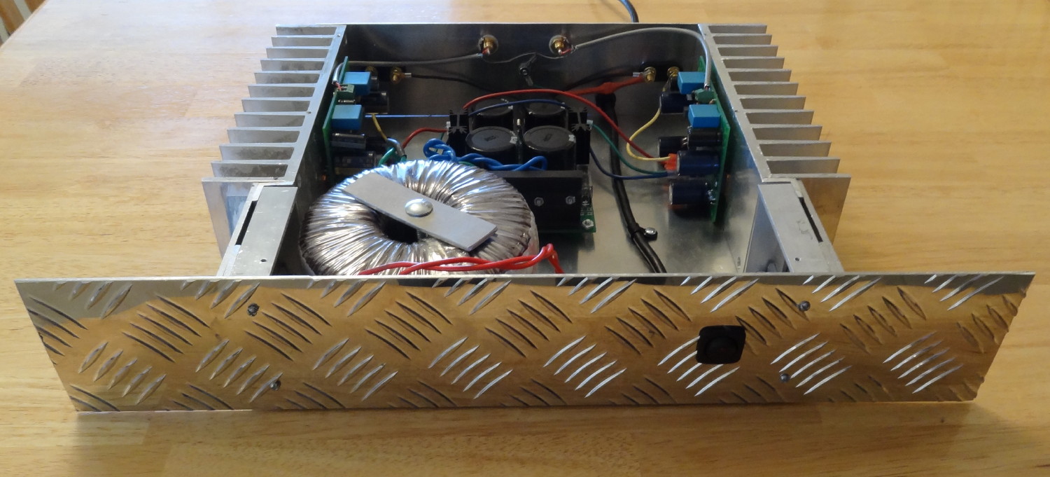

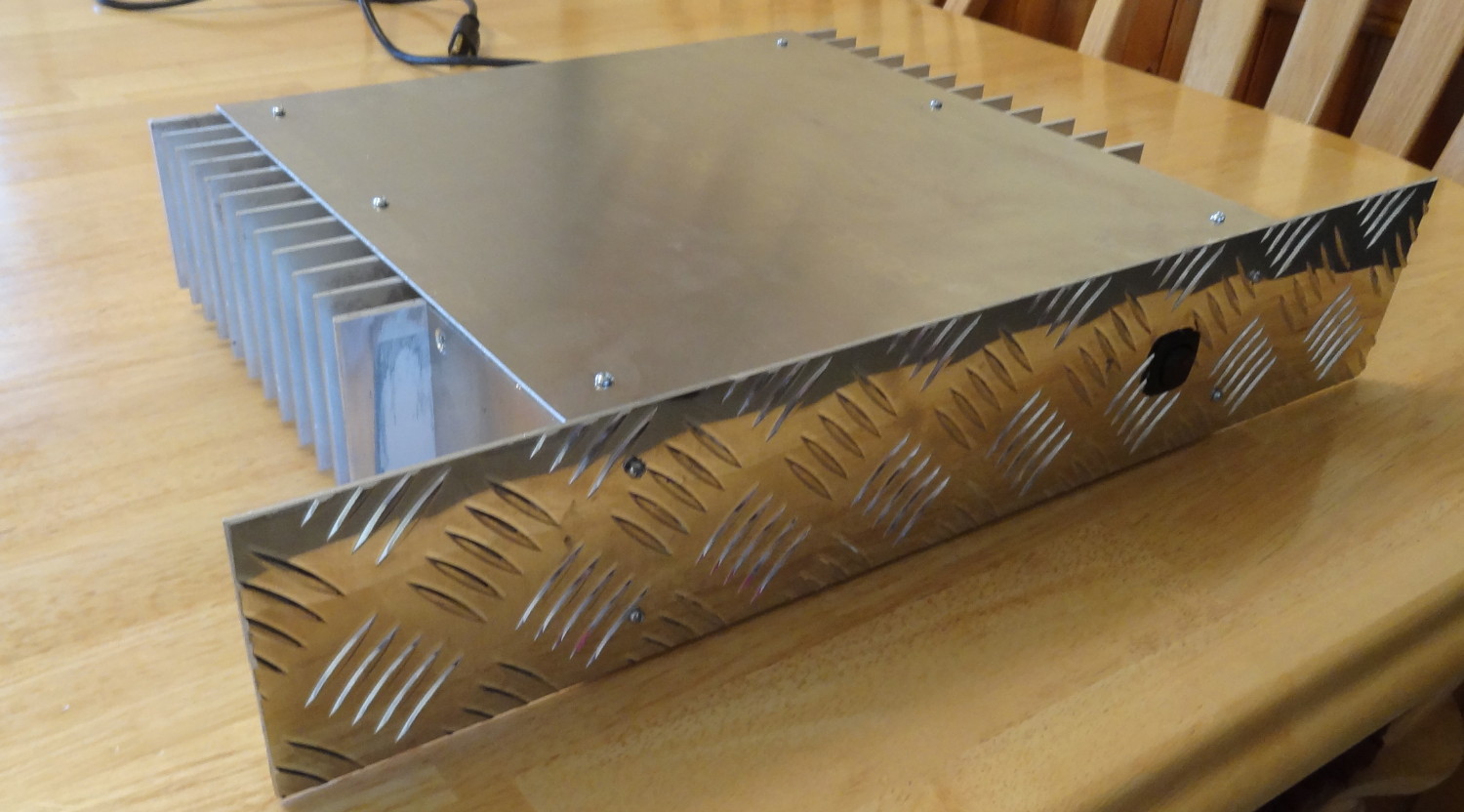

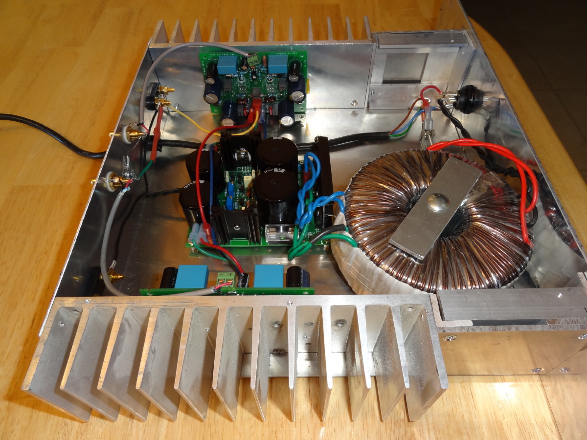

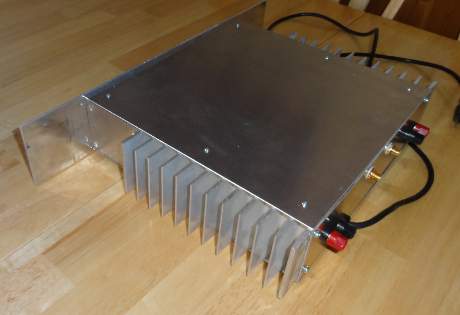

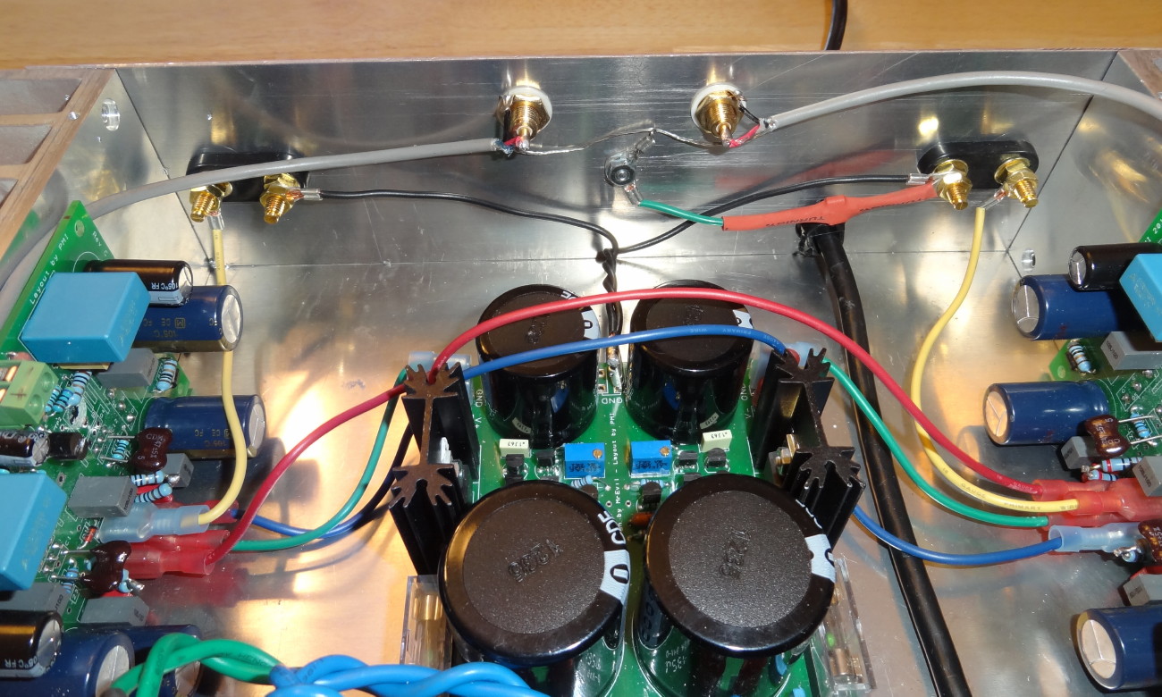

Finished the case.
Hi Guys,
I built a case for this amp yesterday. Tried to fire it up last night through my light bulb tester and the light burned dimly so I shut it down and left it for this morning so I could check things out with fresh eyes. What I discovered was that with either channel powered separately, everything was fine, but with both channels powered, the bias would go from 145mA to 350mA. Both channels did the same thing. I had a very similar experience recently with my SKA. I had not installed a ground from the circuit to the case so I clamped a 10R 10w resistor from star to case and everything settled back to normal so I installed a 10R 1W resistor bypassed with two diodes and all is well. It sounds very very nice!
