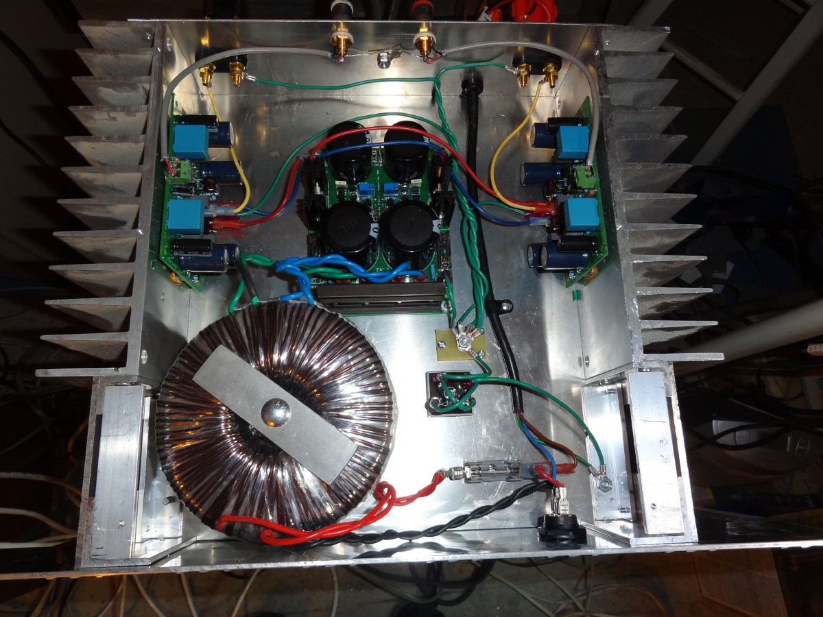

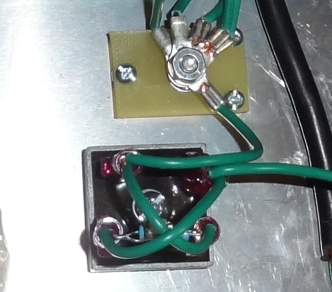

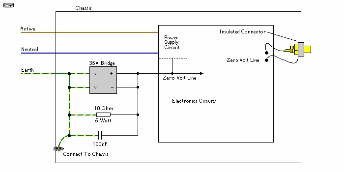

I wanted to give an update on my amp. I had a problem with blowing fuses if I changed inputs while the amp was on. I also noticed a slight hum. I decided to revisit my grounding scheme. I built a ground loop breaker and then installed a star ground bolt and reworked all the ground wires to land there. No more issues now and it is completely hum free. I thought I should share since I was asked about the ground scheme earlier.

Thanks for the photos, Terry. Just to make sure I understand the grounding, the bolt next to the ground loop bridge is isolated from the chassis, correct? Thanks.
