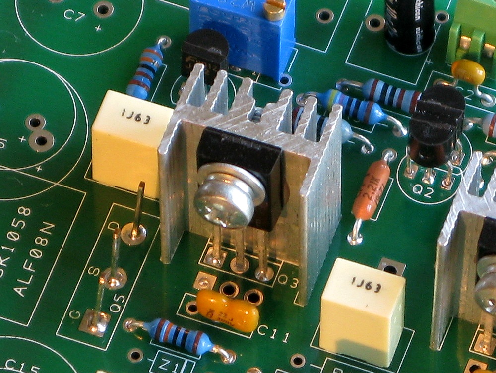

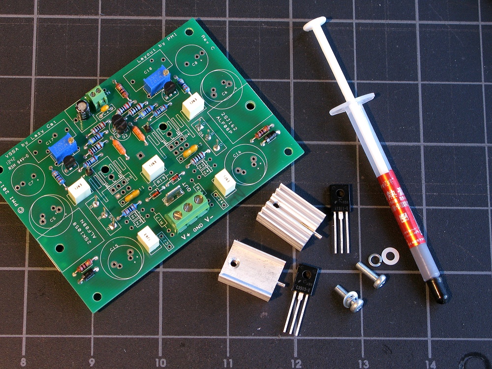

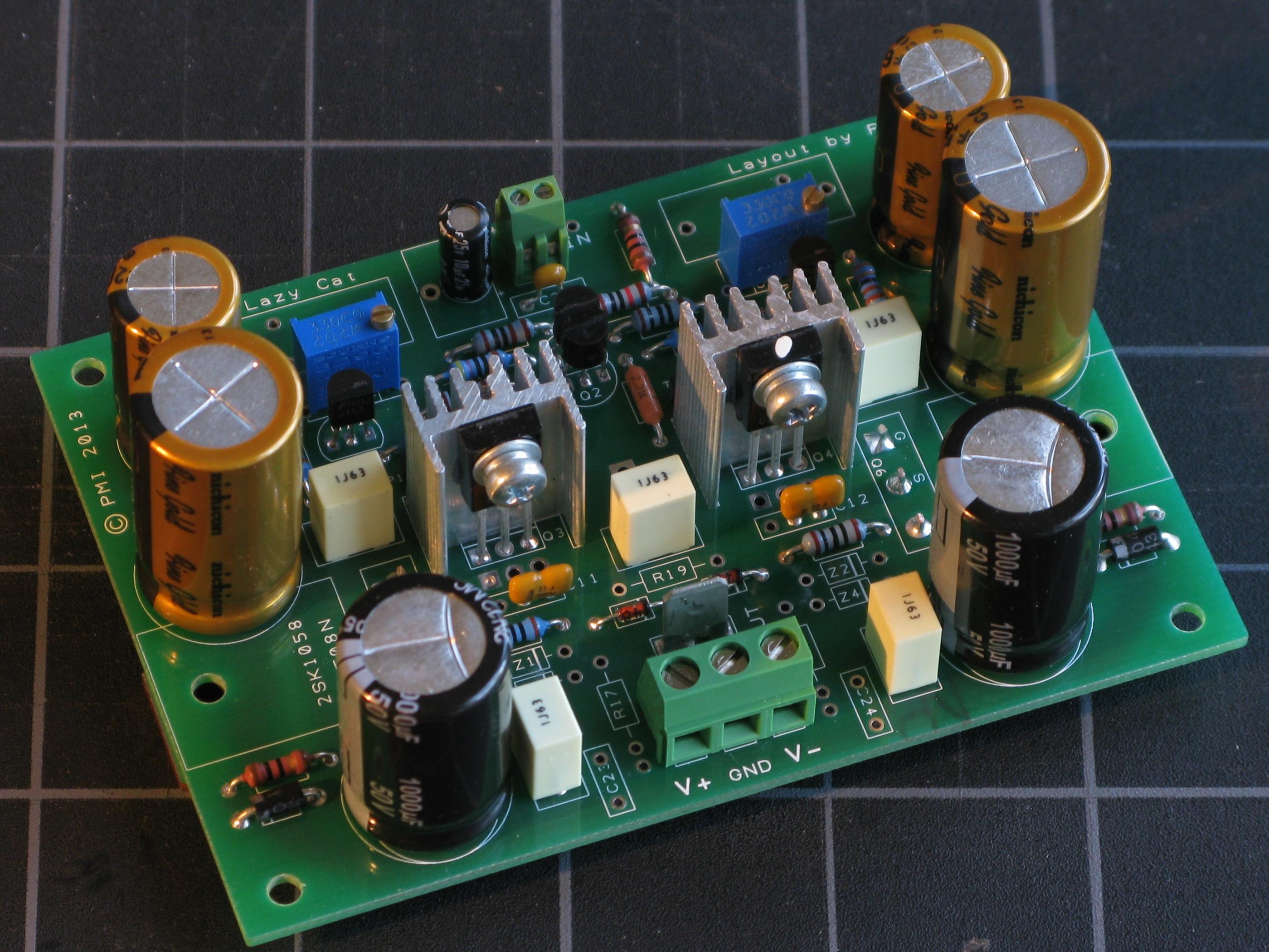

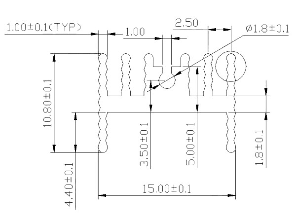

VAS Heatsinks
When reading heatsink ratings, the "Thermal Resistance" figure shows the expected increase over ambient temperature for each watt power dissipation. In general, lower figures are better.
The heatsinks shown in pictures of the VSSA rev. C board are small extrusion-type TO-220/TO-126 heatsinks, with tapped holes for M3 screws. See first pic below for dimensions. This heatsink is a popular type sold on ebay and elsewhere online. These were purchased from an ebay seller called "Goldpart", and cost about $0.35 each, with free shipping. The seller ships very quickly, even from China.
Common U-shaped aluminum heatsinks can also be used, up to a 15x13 mm footprint. Dimensions are usually listed with the thermal specs. Example:
From Mouser, Aavid Thermalloy 577202B00000G
Heatsink temperature can be estimated from the power supply voltage and VAS bias current.
Example, for the Aavid Thermalloy heatsink above:
Supply voltage: +/-36V
VAS bias current: 14 mA
Thermal rating: 25C/watt
Temp. Rise above ambient: 36V * 0.014A * 25C/watt ~ 12.5C
This is an estimate, expect figure to be about 5C higher. Proximity to the main heatsink may increase the temperature another 2~4 degrees, and so will internal chassis temperature.
The KSA1381/KSC3503 transistors have an all-plastic body, and a small amount of thermal grease should be used for best contact with the heatsink. The heatsinks from Goldpart are tapped for M3 screws, length about 8~10 mm. Example: M3x8 + flat washer (M3x10 + lock washer optional). The
Aavid Thermalloy heatsinks are not tapped, so those require a nut or similar fastener. Example: Aavid Thermalloy p/n 577202B00000G + M3x10 + lock washer + flat washer + M3 nut. Typical mounting hardware is shown in the second pic below.
The TO-126 transistors should be mounted on the heatsinks before they are soldered to the board. Usually, it will be best to assemble the VAS transistors after all the smaller parts, and before the taller electrolytic capacitors.
The second pic below shows what the board should look like before assembling the heatsinks and transistors. The third pic is a close-up of the soldered heatsink and transistor. The last picture is an almost complete board, after the tallest caps are soldered.

  • Apply small dab (2-3 mm in diameter) of thermal grease to heatsink
  • Attach VAS transistor using M3 mounting screw, finger tight
  • Insert into board and solder transistor leads w. heatsink in place
  • Loosen mounting screw
  • Make sure heatsink is seated against board, if not, reflow transistor leads
  • Re-tighten mounting screw
  • Solder heatsink retaining pin, if the heatsink has one
