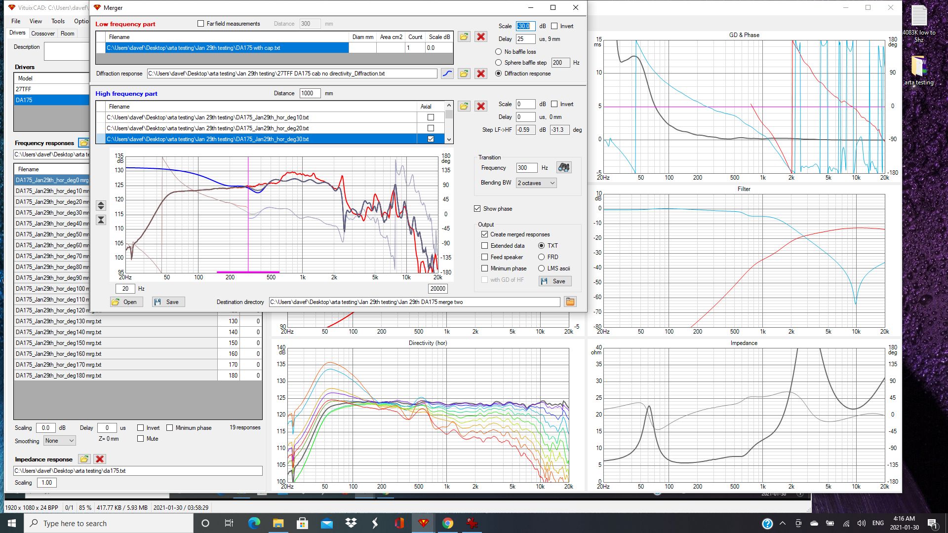

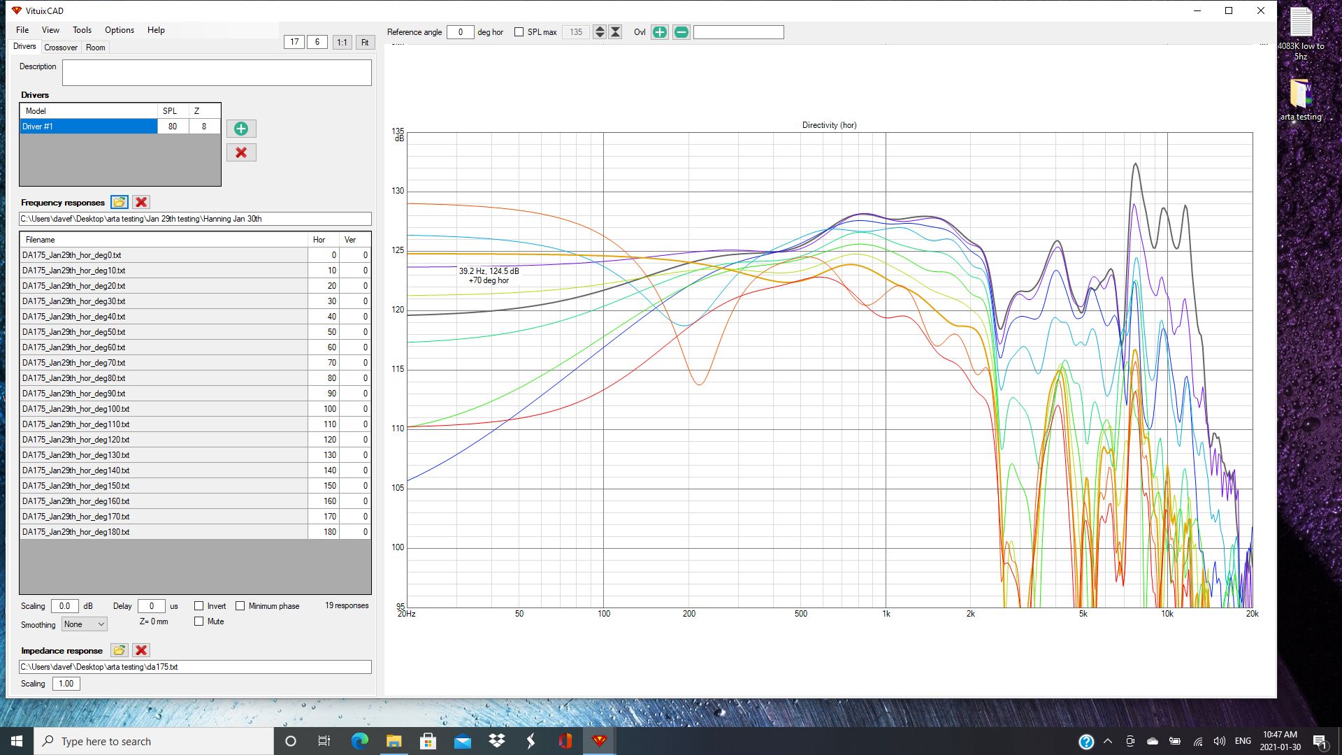

Normalized off,
Still doesn't look right.
The cyan (light blue) response is 30º and it does not look like the merged version.
It looks fine when I click the "axial" button for each response, but that doesn't seem to be what is being saved.
Axial response is "hor 0" which should be checked when exporting all responses with Export button.
One possible problem is DC offset either in reference channel with loop back or measurement/mic channel. Significantly too high level and response variation at low frequencies in several far field measurements indicate DC offset or environment noise. DC offset is quite unfortunate because dual channel mode is sensitive to it. 'Convert IR to FR' has compensation for DC offset which might reduce the problem, but it's not guaranteed.
Single channel mode is not so sensitive to DC offset, but has other problem: it cannot measure sound flying time i.e. time differences which is required for simulation up to 180 deg off-axis. But single channel mode is one method to test possible DC offset in reference channel.
Time window should be short enough to block the first reflection which could cause level variation and directivity errors at LF.
One trick to reduce level variation is to use Hanning or Tukey 0.75 time window. Negative side effect compared to Tukey 0.25 is reduced resolution at LF.

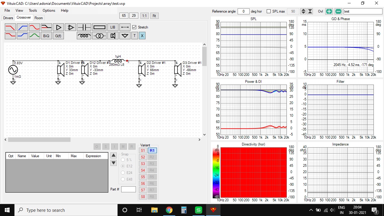

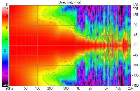

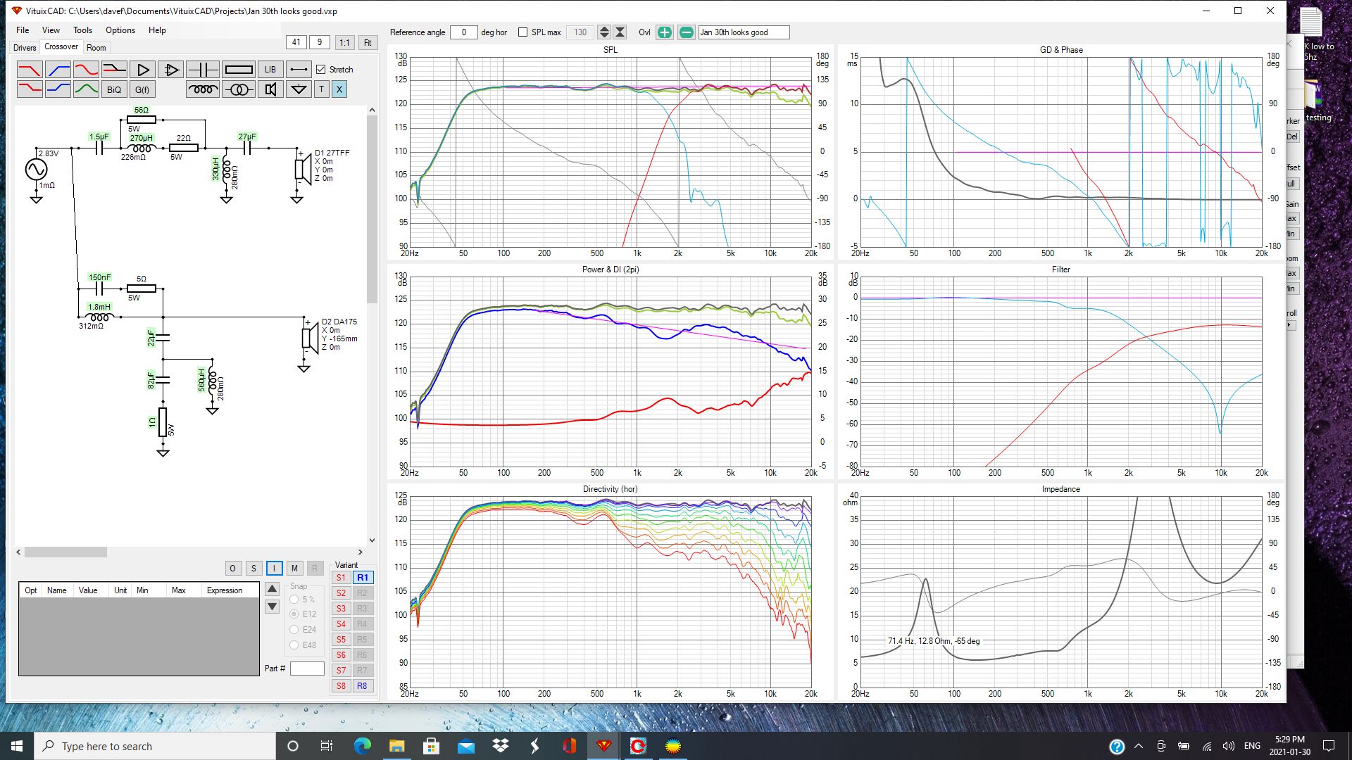

Suddenly polar plot stopped working.

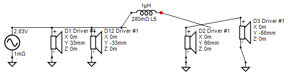

No it did not. Wiring of your crossover looks this so the last two drivers don't get any signal. Don't mess with wires. Don't add extra wires between components. That is just waste of time and increases risks to mess up whole network.
Drivers don't have off-axis responses so they are handled as omni. Show vertical to see lobing.

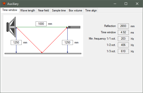

"Too long" measurement distance may require "too short" time window assuming that distance from DUT to floor and ceiling are limited constants. 1000 mm from baffle surface to mic (mentioned in measurement instructions) is logical compromise especially with SPL calibrated systems, though it's not necessarily perfect far field yet and time window cannot capture higher order diffractions.

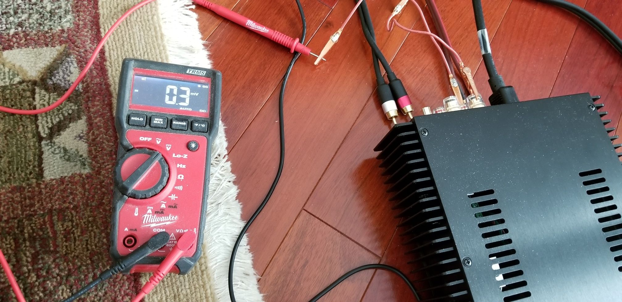

Here is the DC offset of my amplifier,
Here is Hanning window pir export, no merge, no XO.

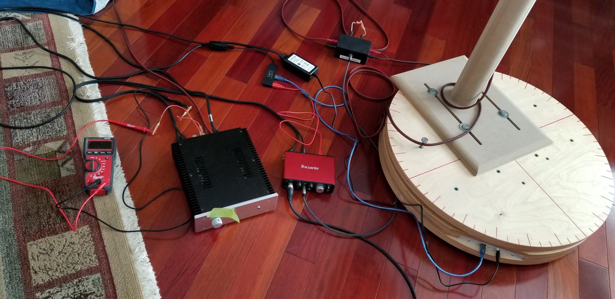

Here is my setup,
I have a couple different amps I can try, a newer Gen 3 Focusrite Scarlett Solo and maybe shorter RCA's and speaker wires to see if that makes a difference.

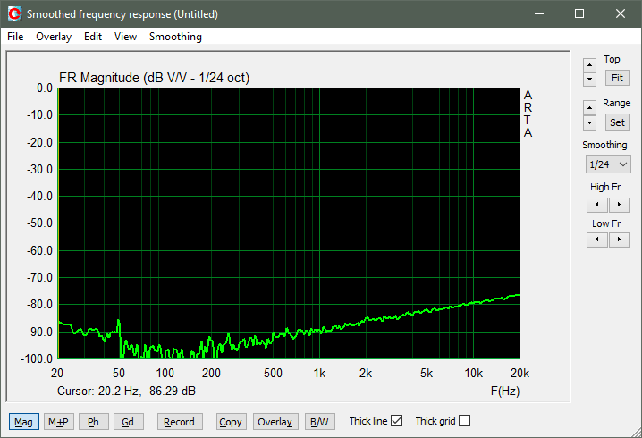

Another useful trick could be using Pink PN instead of sine sweep for woofer and mid. Looks that is gives more stable zero to IR than sweep at least with my Scarlett 2i2 2nd gen.
Mic disconnected, phantom power on, loop back from sound card i.e. semi-dual. Input pot at ~7/10:

Since you mentioned it was a DC Offset problem, I noticed there was a DC offset button and clicked it, all is good now. :)
^Excellent. Next step is to include 100-180 deg measurements and fix sound balance which is not yet ok at least for far field speaker. Show In-room response and Total ER response in Power & DI graph and redesign balancing so that all visible traces are balanced without significant S-curve.

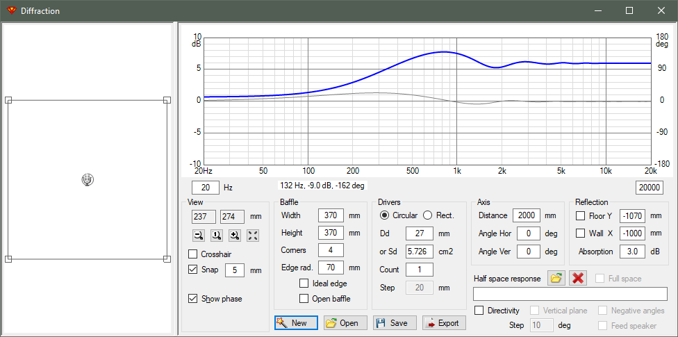

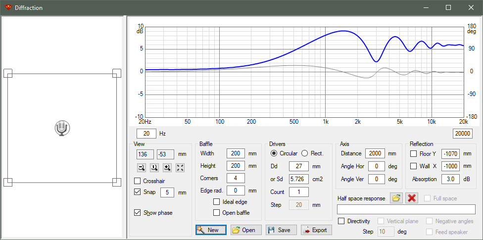

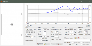

^Diffraction simulations are easier.
First one is close to worst case 200x200 R0 edges. Second one is 370x370 R70 edges. The last one is more compatible with 2-way crossed at ~1800 Hz because directivity index due to diffraction decreases from mid towards XO frequency while combination of hard cone and phase matched crossover reacts opposite.
