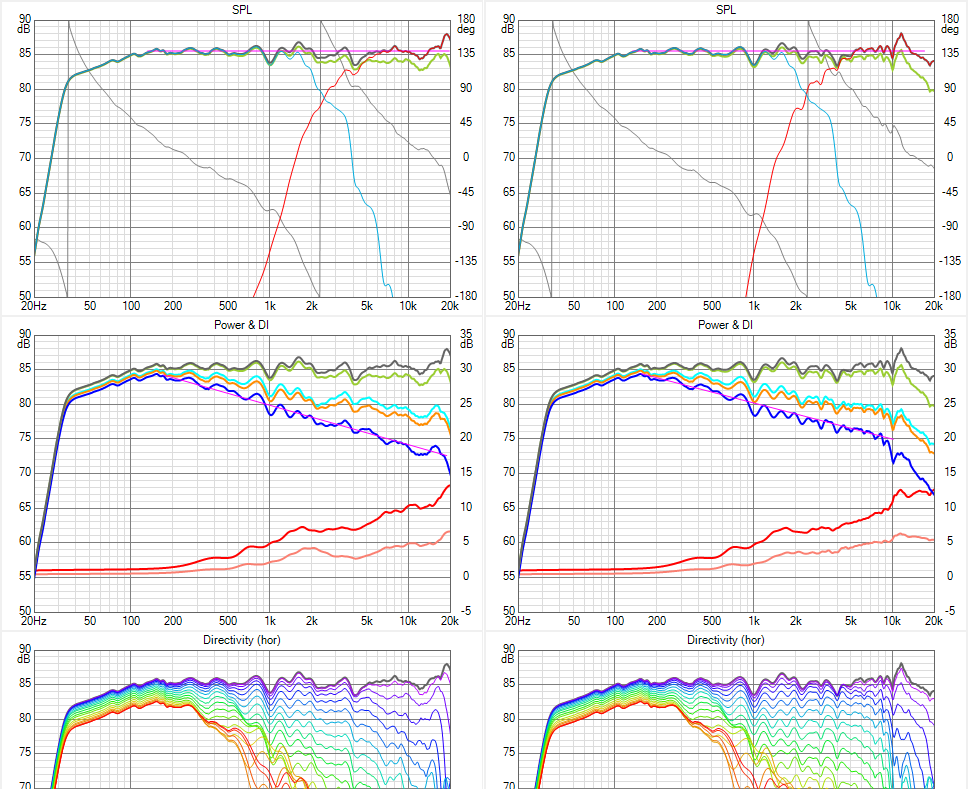

I have a question. I currently use VituixCAD to post process my FEM/BEM simulations (I export the frequency and phase response horizontally and verticalle and open them in VituixCAD). To save on computation time I only simulate the woofer to around 100 Hz( it is till a trail later this will go to 500 Hz) but when I import the responses, the Interpolation of the data does this:
Is there a way to adjust that or do I have to manipulate my data in order to avoid it?

Slope detection and extrapolation is on by default so extra row e.g. 40 kHz added with text editor is only option at the moment. One octave above the highest existing is adequate in practice.
I just made cheap trick to revision 2.0.61.1 build 2021-02-05 which limits slope detection:
- maximum slope of frequency response extension is 0 dB/oct at HF
- minimum slope of impedance response extension is 0 "Ohms/oct" at LF
No need to edit manually if max. 0 dB/oct. extension is okay.

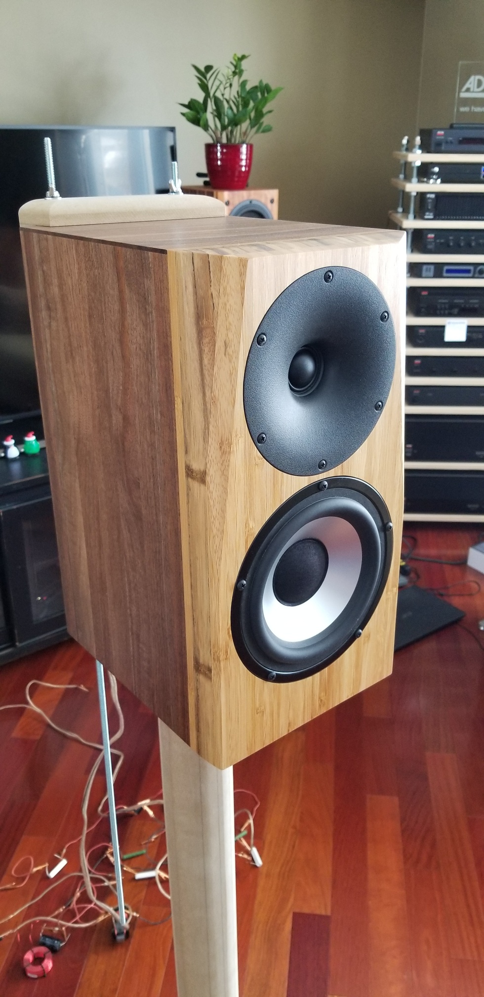

7" alu woofer is not the best starting point but you should try.

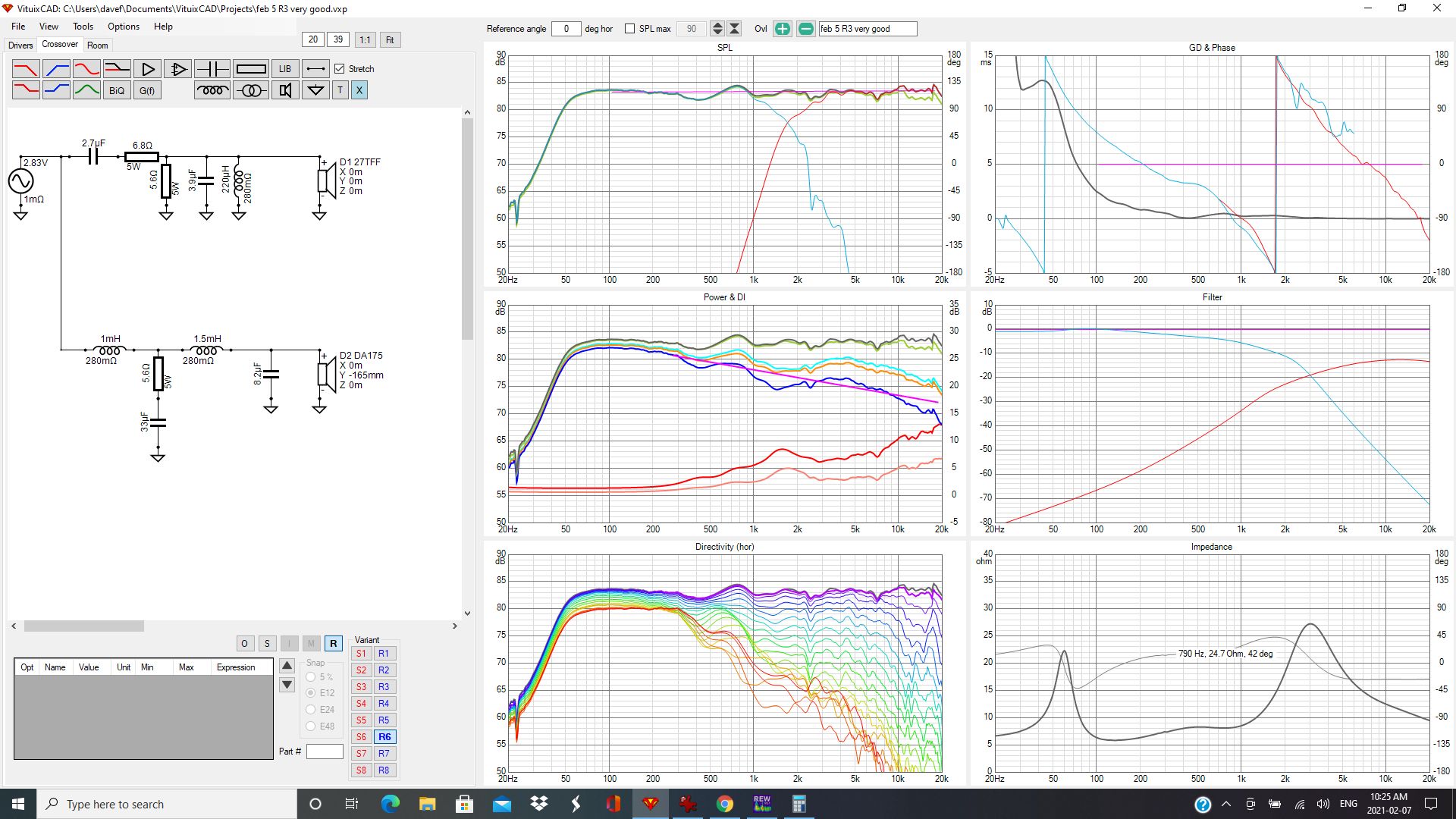

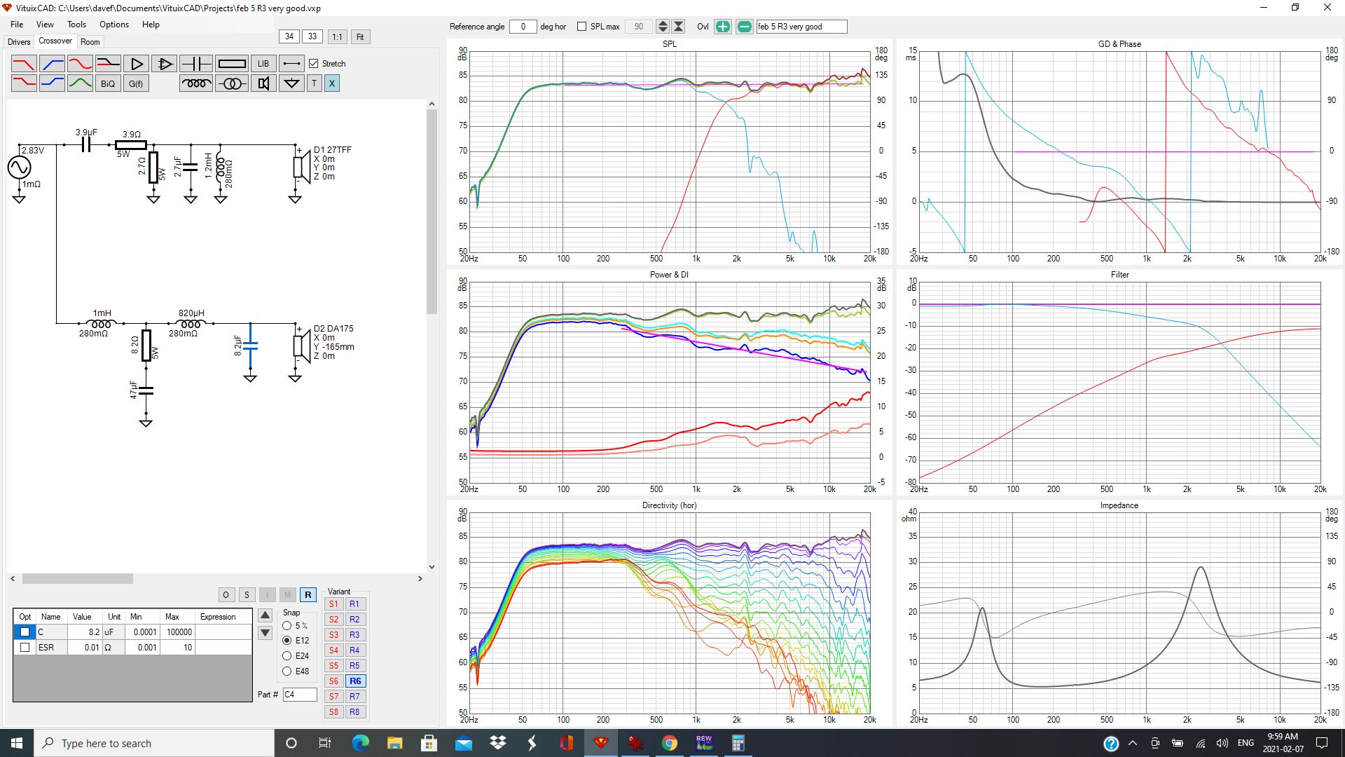

How is this response?
Unusual reverse null,
Prior to the turntable and using your software I would have probably gone with this response because of the great reverse null,
Not knowing what the in room and power response was.

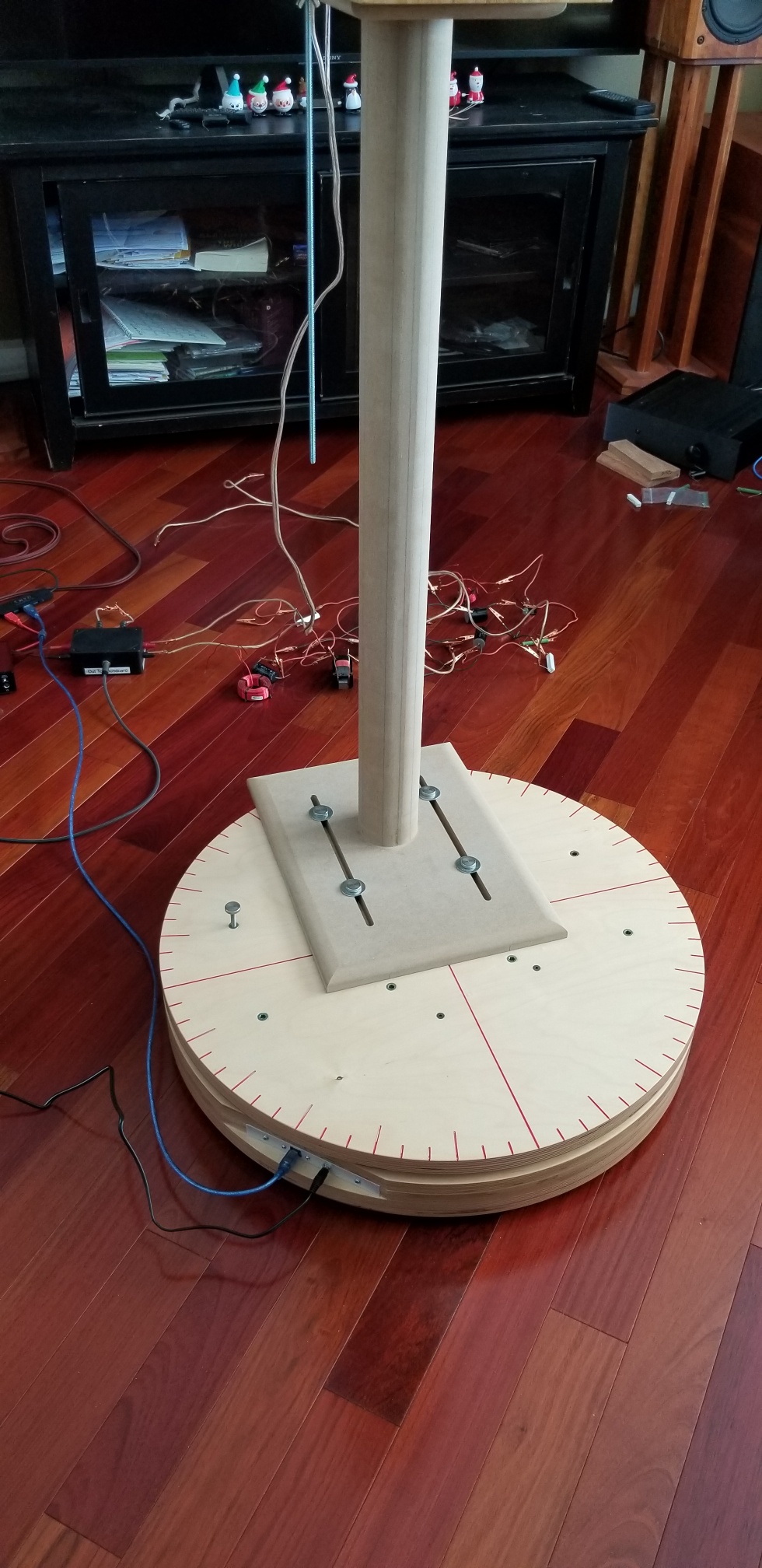

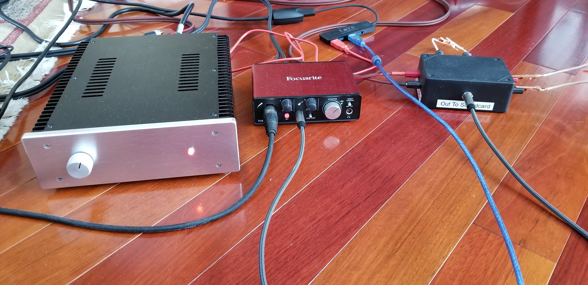

Keep in mind these drivers and this speaker build is/was just for learning and to test out my new finally completed measurement setup. I had never used ARTA before, I built a small amp that I can move outdoors with the rig in the summer, new ARTA turntable and ARTA box which I had never been tested. If I was going to wreck something, these drivers wouldn't matter.
Problem is, while I was getting the rig together, I ended up making a nice housing for this speaker, so I think I am going finish it.
Thank you,
David
^Axial response has still all the weight i.e. is too flat and tiny dips and humps are not necessarily in the best positions. So power response and other off-axis are still unbalanced.
Post #2676 tried to explain how to optimize both axial and power/off-axis to make working compromise so that over-optimized axial won't ruin the others. It's not very detailed, and perfect result is usually not possible. This would be easier to show with some project, but unfortunately I can't use my commercial projects.
In addition, reverse null doesn't have to be perfect and symmetrical. Controlled phase mismatch -> match over XO is able balance power on both sides of XO. Also turning of main beam a bit up is possible if slight mismatch is allowed.

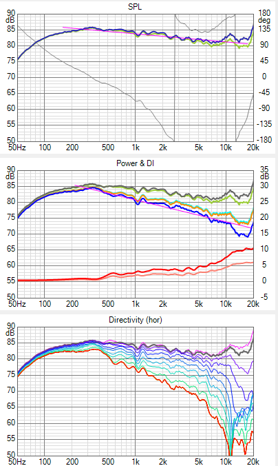

I am not implying this is a "good example" the way Dave asked, but here it is anyway, sharing with you. Designed with V2 and ARTA measurements. Following Kimmo's advices to the best of my knowledge.
This is an actual measurement @ 1 m, tweeter axis, 0-90 hor, gated.
SB17NBAC04 + XT25/WG148, closed box, radiused edges r25 mm.

🙂 I believe that you can see clearly. Only obvious thing by looking diyaudio and measurements of commercial speakers is that most of us and other speaker designers are not aware how CTA-2034-A traces should look. Almost without exceptions beginners with VituixCAD design exactly as bad as with XSim and other single...few response tools. It's mentally almost impossible to get rid of traditions of four...five decades and refuse illogicalities such as rising power and ED from XO frequency to octave above and e.g. accept compromise having tiny shallow hump below and tiny shallow dip above XO on-axis or play with phase mismatch below (but not above) XO.
Crossover cannot fix everything so shape and location of drivers including c-c should support smooth total directivity index in order to avoid compromises between on- and off-axis.
