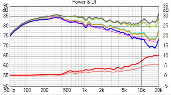

A couple of questions for Draki (posts #2711 and #2713):
- I thought that any LR4 response using separate drivers (not a coax) would have a power response dip at the crossover point. My understanding this is a result from the LR crossover being a constant voltage vs a constant power type. So either my understanding is wrong or your crossover response doesn’t exactly follow a textbook LR24 response.

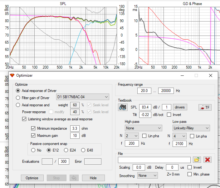

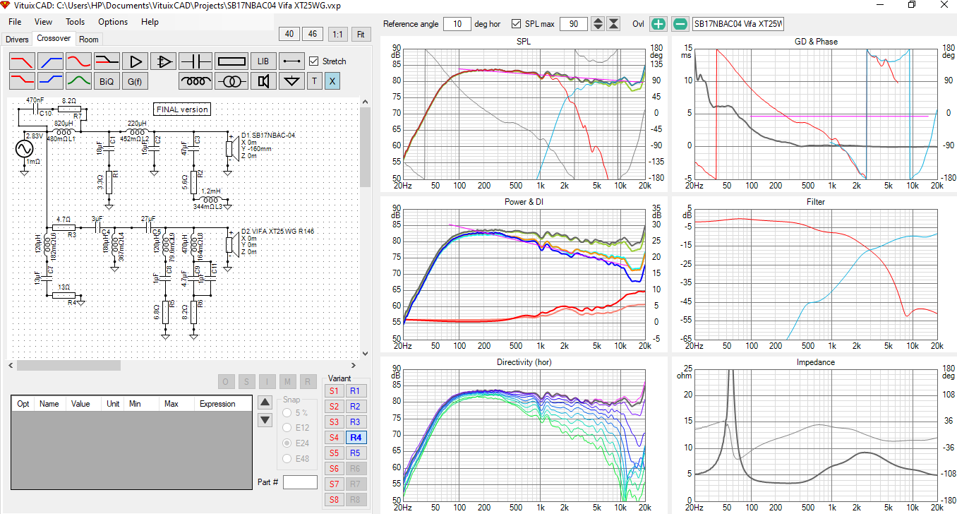

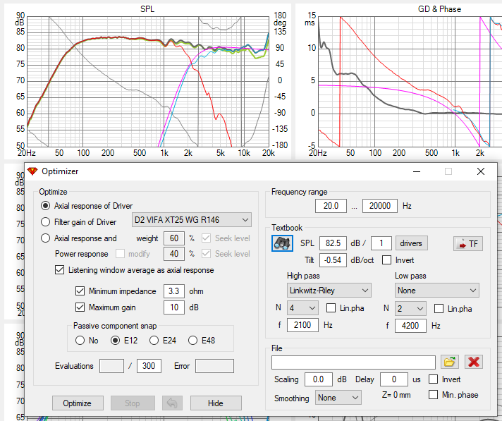

Hi ErnPerkins
The system ended with almost textbook LR4, see attached target curves for both BM and the tweeter.
But I was not chasing it, it just happened to be LR24. Frankly, I am trying not to have a textbook target during design, nor a theoretical one, I find it distracting. Just keep "massaging" the xo while keeping an eye to the SPLFR, Power and DI.
Attached is a final xo version and the predicted simulated responses. Of course different (better) results are very probably possible, this is where I stopped.
The actual measurement was posted earlier but I am posting it here again for an easier comparison. I had the speaker and mic left at the same position for a week (!) so they - the measurements - are under same conditions.
I think he's omitting the vertical plane in his measurements, thus you don't see the dip in the power response.A couple of questions for Draki (posts #2711 and #2713):
That's definitely it! Makes sense now.
Emperkins, verticals are there, explained in my previous post. Careful eye would notice DI bump at 2kHz, which is usually sign that some sort of vertical measurements were included. Power response dip is not visible, the acoustic responses are not textbook LR24 responses, most probably, which is not a problem.

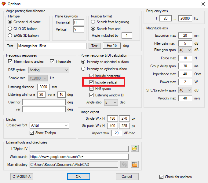

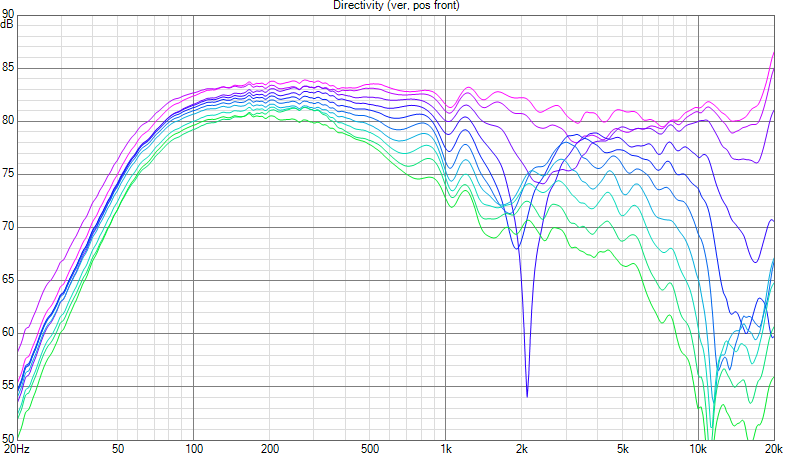

I must be missing something. Here’s Draki’s DI plot from post #2711. I just don’t see a bump at 2 KHz.
I see, I was looking at Draki #2726, there are 4 images, I refered to the second one (attached). The first one has flat DI at 2kHz as in #2711.
Draki, I think for the first one verticals were OFF (probably just measured horizontals of final complete loudspeaker), for the second one verticals ON (crossover modelling with individual driver horizontal responses). Am I correct?
For both - the system measurement and the simulation - the Option had both hor and ver active.
Just to be clear 100%:
- the simulation was made with 0-90 deg hor measurement at each DUT individual axis (x,y,z =0 for each)
- the system measurement was made 0-90 hor at the tweeter axis (thus making bass/mid at y -160 mm)
- both at 1000 mm distance to the mic
