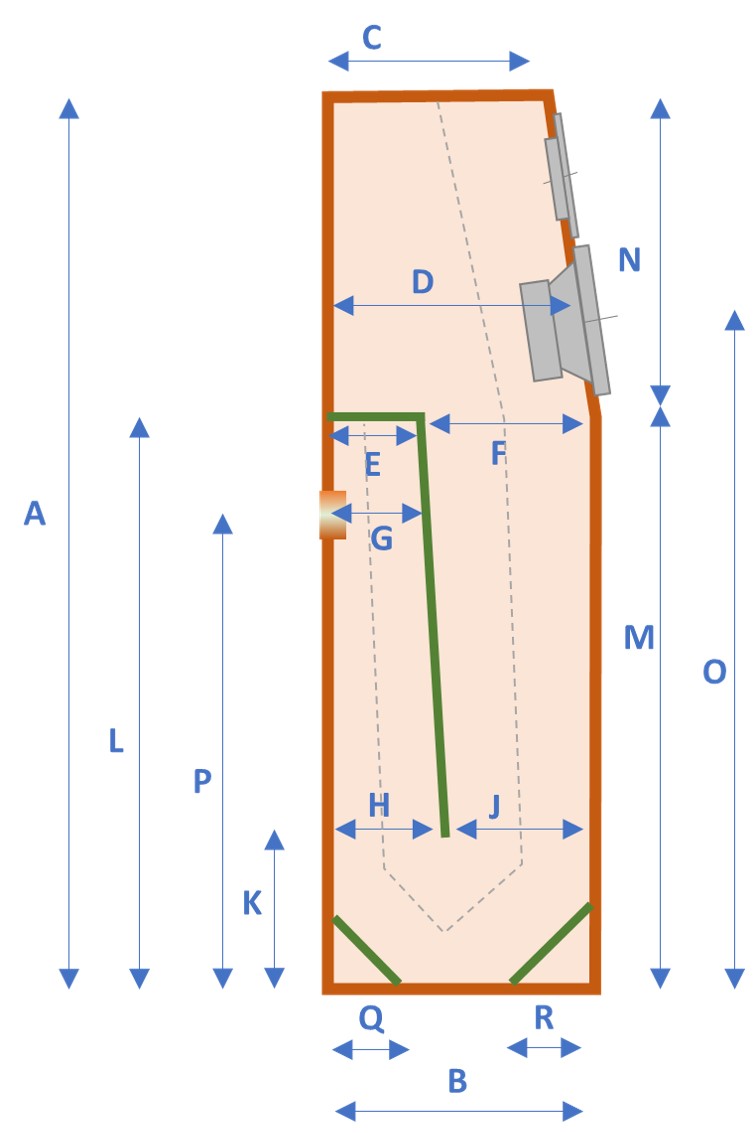

Creating a speaker design can include the task trying to minimize some of the effects from the room, and the speaker position. Using MathCAD and Hornresp I have an optimized design with the looks of the below picture. None of the two program results have design features for compensation of room and position. And still the design has no crossover.
So along that way of the quote. The below design has a tilted (only 2 degrees vertical listening angle) , bent baffle so the effects from the baffle are there. Also it has the port pointing to the wall about half a meter off the floor which will have a large impact depending on the position of the speaker.
So for me, with almost 50 years of experience building "others" designs but just recently stepping into the world of own designs, it would be interesting to know YOUR brightest thoughts of how to compensate for those two things:
1) The tilted and bent baffle.
2) The MLTL port pointing against the wall a half meeter from the floor.
Thanks in advance!🙂

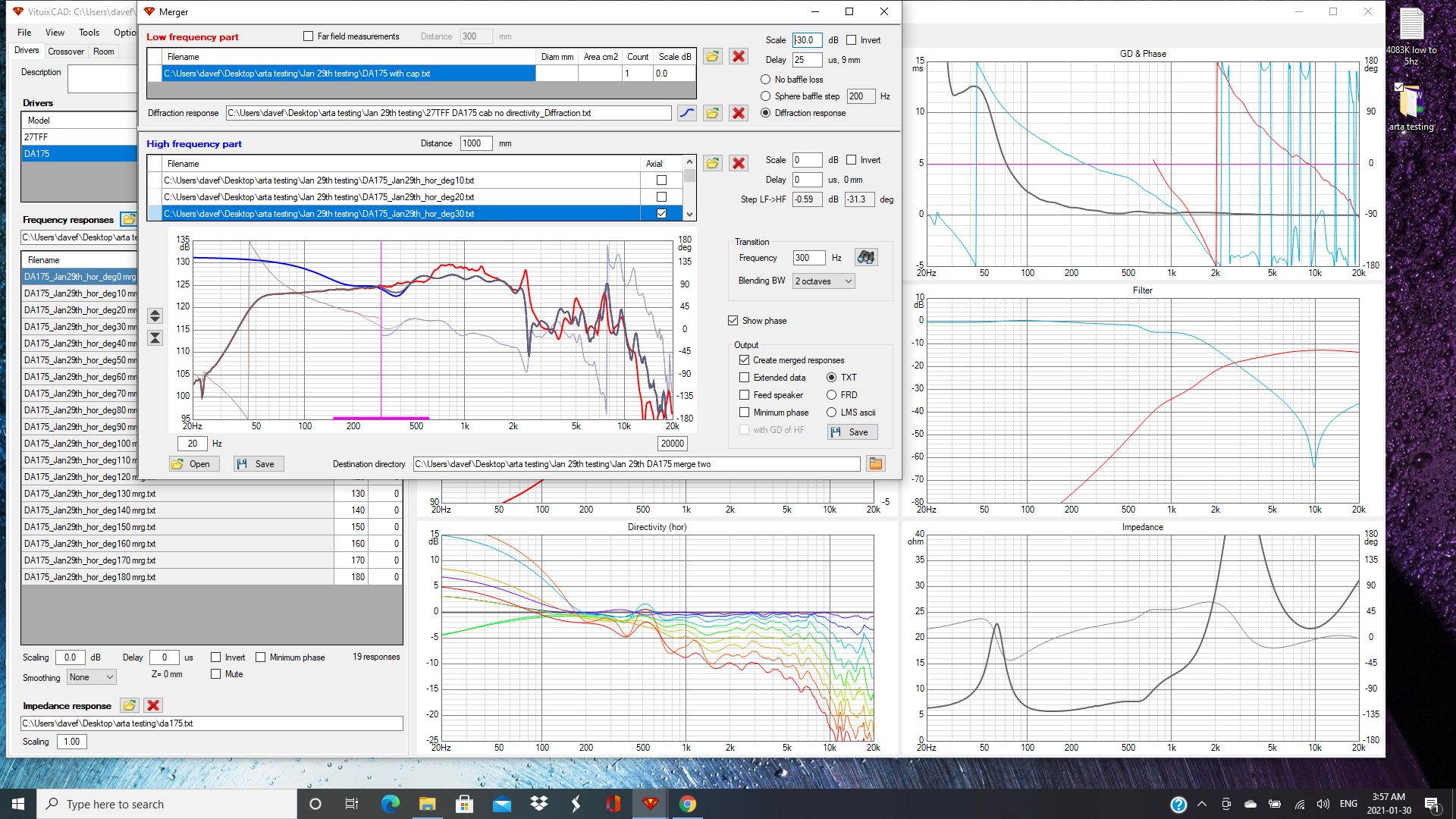

i do not understand the extended z model in the calc t/s parameter feature:
if i have two curves loaded: free air with no mass + free air with mass then the extended z model error box lights up red, but if i remove the added mass curve then i get a nice fit. but as soon i load the added mass curve then the error box turns red again, i guess i need both impedance curves to get accurate t/s calculations?
it would be nice if both 'basic z model' and the 'ext z model' where saved and the user later could easily select between basic / ext / none z model when doing box work.
also, it would be nice if it where possible to import a box impedance measurment to the simulated box impedance, in that way it would be easy to adjust box parameters to match the measured impedance curve for further box tweaking
Calculation of extended Z model parameters alone needs free air response. Second response should not be loaded. Program does not change standard T/S, and Error text box shows error within 8 x fs ... 20 kHz where extended parameters are effective.
If you are calculating standard T/S parameters while extended Z model parameters are kinda side product, you should load two or three impedance responses. You also need to enter Sd and Re for added mass or sealed in addition to correct mass(es)/volume. Error text box shows error within 0.8 x fs ... 20 kHz so text box will be red very easily if you are not really calculating all T/S with required and correct parameters from user.

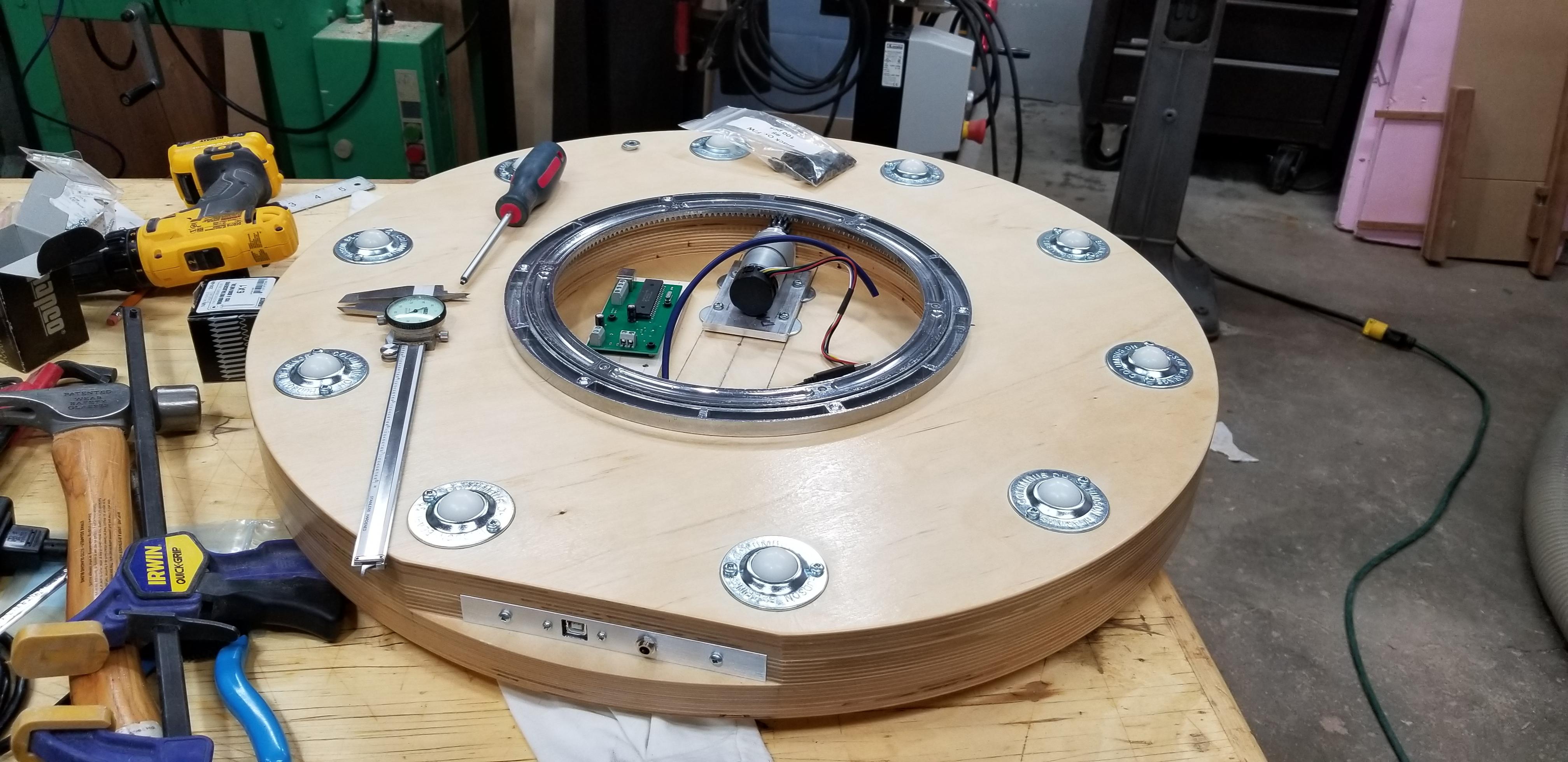

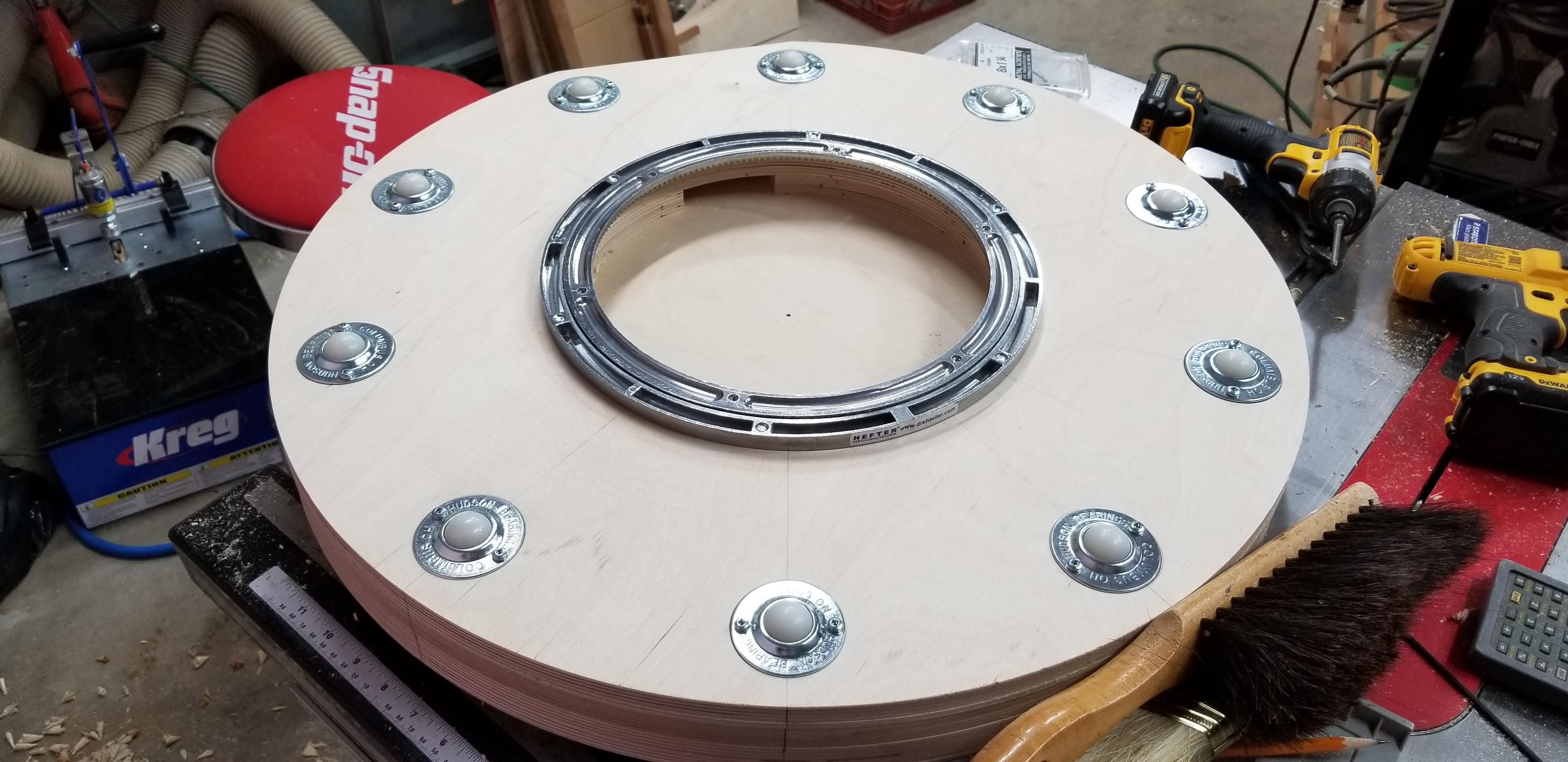

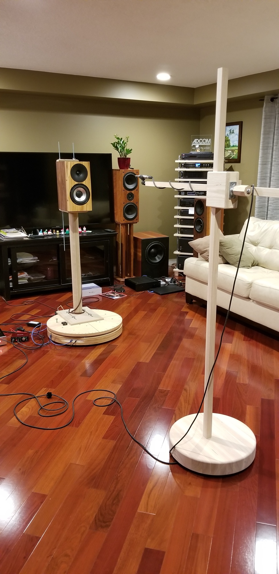

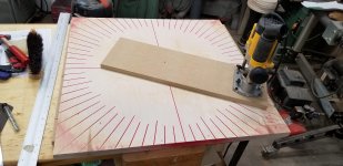

I have my Automatic Arta turntable all setup and working now, just a quick question about frequency recording types.
Is Sine Sweep better than Periodic Noise?
Can the two types be combined with the expected output levels the same?
i.e. Can you use Sine Sweep for woofer and Periodic Noise for tweeter?
Thank you, David.
P.S. I ended up making my own mic stand that only goes up and down in order to maintain distance between DUT and mic when measuring drivers. My speaker stand has a stop on the back of it, also to maintain distance.
^All signals (White PN, Pink PN, Sweep and MLS) have the same level in ARTA.
Sine sweep has the best S/N ratio so that's recommended especially for woofers, ports and mids. You can switch to White PN for tweeter to reduce power at LF. No need for separate high pass with conventional domes.
MLS can not compensate response errors in dual channel model so it's not recommended without calibration including both mic and sound card in case response of sound card is bad.
David
P.S. I ended up making my own mic stand that only goes up and down in order to maintain distance between DUT and mic when measuring drivers. My speaker stand has a stop on the back of it, also to maintain distance.[/QUOTE]
Hi David, I know that there are Plans at the ARTA website and on the internet but I had some trouble following them for an automatic turntable, especially the sourcing of materials. Would you very much mind sharing your Plans and sourcing information?
Thanks,
Jay
Thanks,
Jay

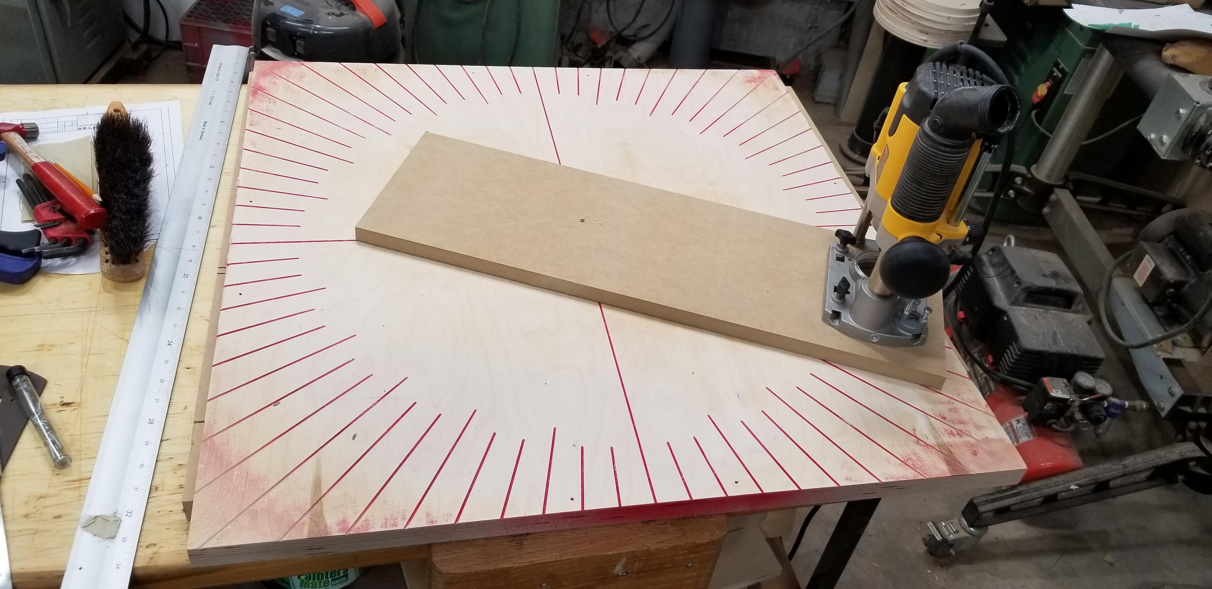

Here are the instructions, I translated them from German to English as best I could,
View attachment ARTA-Hardware&Tools AutomaticTurntable-GerRev1.2.de.en.pdf
View attachment AP-9+ARTA-AutomaticTurntable-GerRev1.4a+(1).de.en.pdf
Here are the hard to find parts that I used,
Motor,
Pololu - 150:1 Metal Gearmotor 37Dx73L mm 12V with 64 CPR Encoder (Helical Pinion)
Motor gear,
https://www.amazon.ca/gp/product/B0087EA32Q/ref=ppx_yo_dt_b_search_asin_title?ie=UTF8&psc=1
Circuit board,
ARTA Drehteller Modul - Ingenieurburo Grafe
Geared lazy susan turntable (slewing ring),
Drehkranz Alu-Druckguss 330 mm verzinkt | Alu-Druckguss | Drehkranze | Hefter Fertigungstechnik
A couple of pics of my build,
Boring as heck Video,
Arta Turntable 0 to 180 to 0 - YouTube
If you are in NA like me, expect to take a LONG time to collect everything you need and for it not to be cheap.
