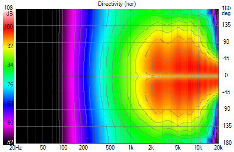

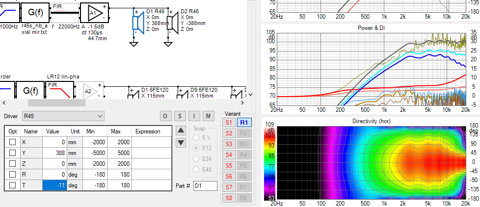

Hi Kimmosto:
I am modeling a .75" x 30" ribbon as a stack of 42 18x18mm (or 21 18x36) rectangular diaphragms. No matter what I do, it gives me an axial DIP of about 6 db and 10 degrees wide. I find the existence of such a dip hard to believe as it would have shown up in ribbon measurements by this time but I can't find anything I'm doing wrong. If you would be kind enough to take a look, I expect you will spot the problem in a minute.
I called it an on axis DIP but it could also be a calculation artifact. The reference angle SPL is 6 db lower than other angles which look like what one would expect from having imported them into REW. When I compute directivity in 10 deg steps the dip is 20 degrees wide; with 5 degree directivity its 10 degrees wide. In other words, only the 0 degree SPL line is anomalous.
Thanks for your help,
Jack
Jack
^Simulation has two separate HF radiators with c-c distance of 2x388 mm. Separate radiators need tilting of atan(388/2000)=11 degrees towards virtual microphone to get flat axial, assuming listening distance of 2000 mm in Options. Lower driver T=+11 deg (up) and upper driver T=-11 deg (down).
I guess you have generated responses with Diffraction tool. Root problem is that Diffraction tool calculated individual small radiators to infinity so you need to generate single long radiator instead of two shorter.
