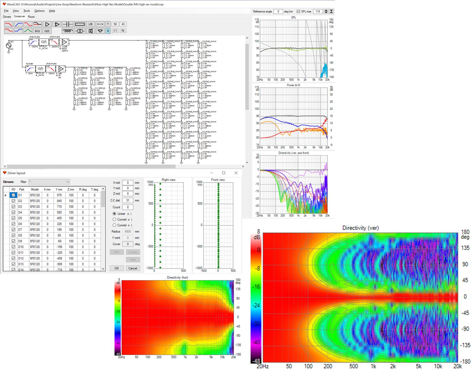

So the dip is because of the path length difference with vertical offset! I should have seen that.
but if I actually buy two of these 30" ribbons and stack them vertically I will have a gap between them which I can't model in a single 60" long ribbon but which theory suggests I might be able to ignore...

^Three ribbons is one option to avoid possible problem due to narrow gap between two ribbons. But problem could be small - maybe fully acceptable in practice.
You can also improve simulation with Diffraction tool by creating tall radiator with one extra driver and then erasing the middle one.
Off-axis simulation with BesselJ1 and sinc functions is fast but unfortunately not accurate because formulas work to infinity. Calculation with multiple point sources (such as in The Edge) supporting near field is more accurate, but radically slower. I tested that once, but rejected due to poor performance.

But when I do this I have 50 driver limit and 30" or 60" or 90" to span so the individual elements are 18mm W x 36 mm tall and the frequency response has ripples just like a discrete array. This is not what I would expect from a continuous ribbon.
It seems to me I need to make a driver that covers 1/50th of the vertical span using diffraction tool and then instantiate 50 of them on the XO schematic, with gaps as needed. Is that my best plan?
I got the highest resolution by modelling hierarchically. Each 30" ribbon is modelled as a stack of 16 18mm wide x 48mm tall blocks placed on the XO schematic. Each block is modelled as 48 1mm tall slices in the diffraction tool. This looks a little better and its more believable.
Continuous long ribbon has ripples too.
Tall straight radiator is "unstable" anyway because response shape depends on distance. This is quite unpleasant feature imo. Main reason why I don't dream about line arrays.
You have quite many LF drivers so simulation speed is already low. In order to speed up calculation and avoid problems in the main program due to two separate directive point sources, it's worth to create single long radiator with Diffraction tool, and export responses with Axis Distance = Listening distance in Options e.g. 4000 mm in both if you finally listen at 4 meters. After that off-axis angles in Diffraction tool are compatible with off-axis angles in the main program, and you have just one driver instance in crossover. Maybe with some extra ripples, but should be okay for preliminary study.

I did hierarchical modelling - made a 48 mm segment in diffraction tool and placed multiples of these on XO schematic to model the tall ribbon which turned out to be when I found a photo 3 15" segments with 1.5" gaps; those gaps being large enough to affect response above 10 khz. Simulation speed is good enough; would be better on a faster machine or if your code could use multiple cores.

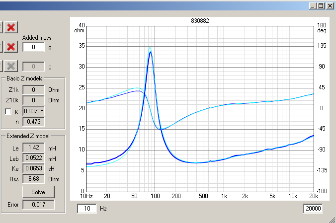

In the T/S parameter calculator, I seem to get inconsistent values for the extended Z model for semi-inductance. It seems to rely on the component values being near the expected value previous to hitting the "solve" button on the calculator. The curve can often be a fair bit off on the measured impedance, but hitting the solve button again doesn't get any closer. Starting from all parameters = 0 does not result in as good a result as if the parameters are manually adjusted somewhat.
It would be great, to allow manual adjustment of the extended Z model values, to help nudge the curve fitting algorithm in the right direction. As it is, I have to close out of the T/S calculator to change the values on the "edit parameters" window , then re-open the T/S calculator to see what the curve looks like and re-solve.

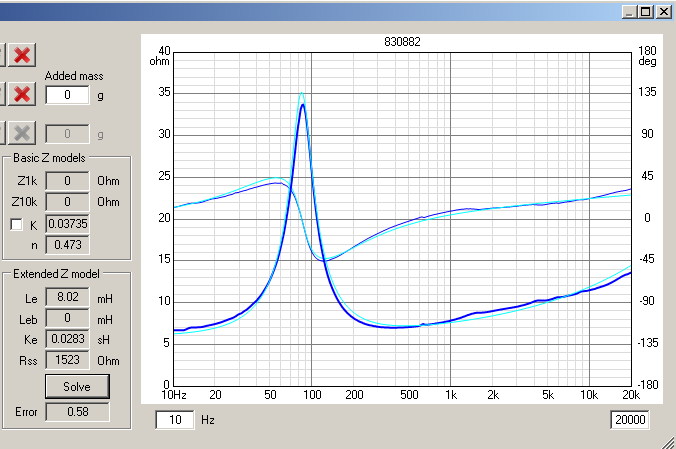

Here, we started at all values for Le, Leb, Rss, Ke = zero. Error = 0.58 and you can see the values are very different than above. Hitting the solve button multiple times will never get to the error = 0.017 result above.
