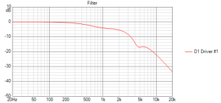

filter coeffs
Hello Kimmosto,
Is there an option in VCad to generate all the filter coeffs in one shot for a filter with a transfer function such as in the attached picture? I could do it in 3 blocks or so separately, but would like to know whether there is a "all in one" coefficients function available.

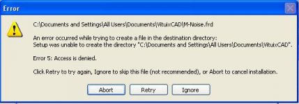

Problems installing VituixCad under Windows XP
I am getting errors when I try to install VituixCAD under Windows XP. The errors are access issues concerning creating files under C:\Documents and Settings\All Users\Documents\VituixCAD. The Documents folder is inaccessible. I have deleted all files in my Temp folder, but still have problems. Anyone have any suggestions since I can't change the installation paths.
