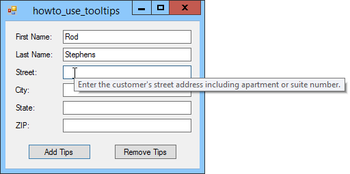

I haven't tried VCAD yet, but if it's not yet implemented, then implementation of tooltip would be very helpful.
Tooltip - Wikipedia
Use tooltips in C# - C# HelperC# Helper
Would it be clearer as a Calculator function?Already done & tested but who would understand this?

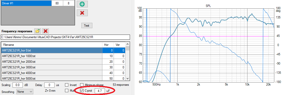

I'll give this measurement method a try on my next design which will also have Ribbon tweeters as I was never completely happy with the measurements I took using dual channel mode for compensation of the protection capacitor.
Judging by the screen shot this correction is applied to the imported FRD response of the driver, (so the frd file would always have the roll off of the cap) would it have been better to include it in the impulse response processing tool to apply the correction permanently when converting an impulse to an frd ? In that case you would process the impulse response once with the special knowledge that the effects of a capacitor were included in the measurement, and the frd exported would then be compensated and able to be used in the project without retaining that special knowledge of a capacitor value in the project file.
Edit: Thinking about this it would not be so easy as the Impulse conversion tool would then need to be able to import the impedance curve of the driver as well which it currently doesn't.
Working with impulse response does not make any change other than more complex calculation and work for me.
Advantage of calculated series reactance by protection capacitor is full level of reference signal because reference channel is connected to output of sound card or power amplifier - before high-pass filter. Also simpler measurement and post process.
But that does not help with noise at LF in measurement channel. As already mentioned, noise much below final high-pass by XO is not dangerous. One option to reduce measured noise is to protect with (active) shelving high pass e.g. -20 dB. That could help with ATM and magnetostatic planar, but not with true ribbon because they cannot produce pressure at LF. One possible math trick could be cropping LF, extending slope down as minimum phase and merging to response with measured phase.
