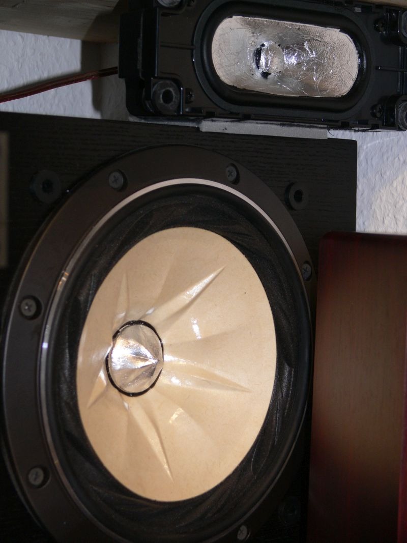

I described two techniques:
household alu foil and silicone sealant (glue is applied thinly on the foil)
or
thinner foil from the goldsmith and the glue they sell with it in german called "Anlegemilch". (glue is applied on the cone)
The thinner one I use for smaller drivers or whizzer cones.
The B 200 is a high efficiency light weight cone so I would buy the thin foil.
But household foil would do very well, too.
One sided already makes a big difference in sound.
You can do A/ B listening test modifying one driver versus the untweaked one with the balance knob on your preamp.

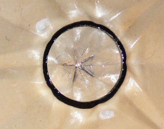

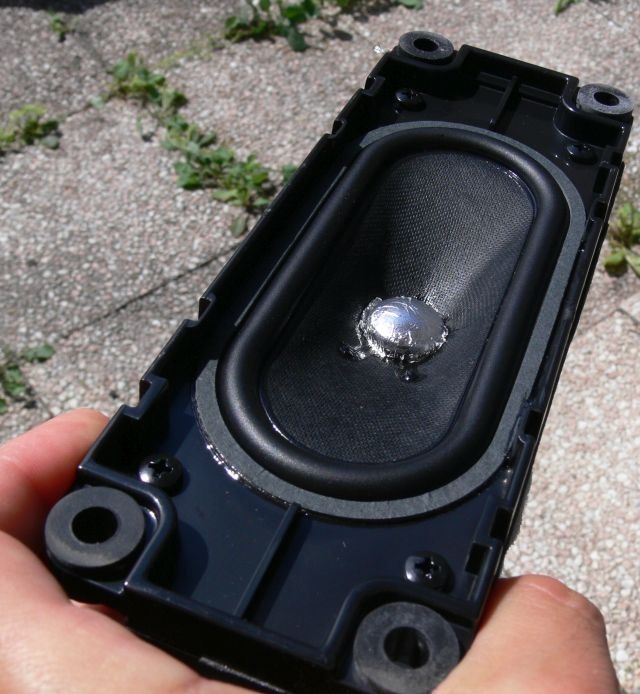

Hello,
here I want to describe how I do make a sandwich cone with aluminium foil.
This can be done with normal household aluminium foil and normal glue you can buy everywhere as "universal glue".
You need a scissor and the materials like aluminium foil, glue and the loudspeaker.
The foil can be applied easily to paper cones / diaphragms.
You can use thin aluminium foil from the gold smith and the glue they sell (in german "Anlegemilch") for making sandwich cones with polypropylene loudspeaker cones as here normal glue will not work. Also for delicate whizzer cones the thin aluminium...

just be prepared for a completely different sound.
Its underestimated that a composite material of metal and paper gets the best from both worlds:
damping from the paper and the tensile strength of the metal adding stiffness.
At the same time resonances are damped giving nice waterfall responses
