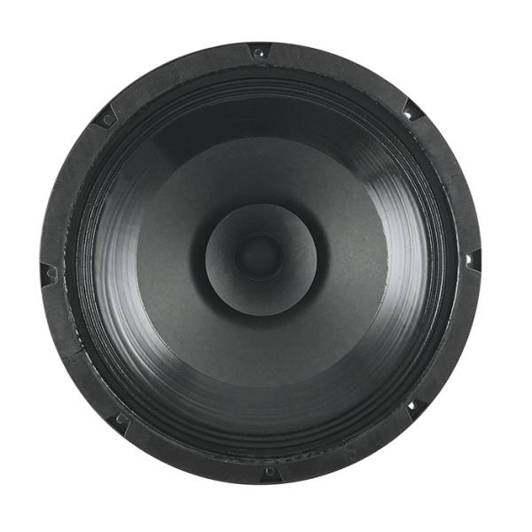

the b200 has its merits as it omits the problems with a whizzer cone.
And it really is highly efficient
Some LTS50 or Modgepodge or alu tweak and EQ would make it sound less "papery".
Diffusing elements are not necessary could be integrated into a loudspeaker grill.
Some side tweeters would add high frequency dispersion easily without touching the driver
I would tweak the B200 - if I would be too lazy to put foil on it - like this
2 thin coats LTS 50 front side
1 thin coat LTS50 back side
If some dampening liquid available (I don't know what and where!) then a similar coating of the outer parts like with the Sica 12d.
Should be quite audible as effect (stabilizing, damping)

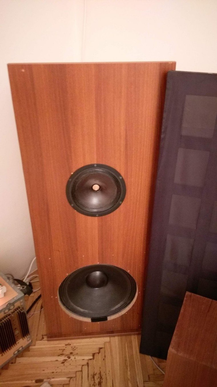

I found an old foto of my two modified fullrangers: Visaton B200 and Fostex Fe206e
At Visaton, I applied a thin coat of varnish damar and made sort of a phase plug. That improved the sound quite a bit.
With Fostex 206, I had made a mistake of inserting a wrench socket as a phase plug and could never pull it out...

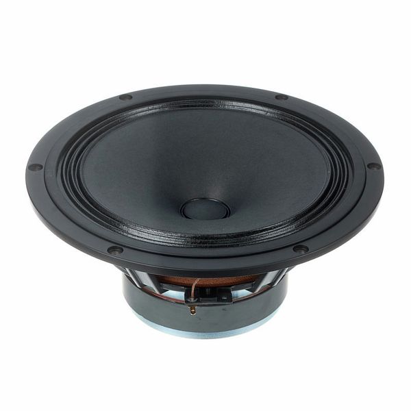

… did you find much difference between the lowest priced markaudio drivers and the top of the range moap ...
I can only make some general comments. I have not heard all the drivers, and the kit can make a big difference. Taste & room as well.
Most of the Markaudio are at least good, the best are outstanding.
The really cheap, CHN-50/110 are better than good, cheap as they use an dirt-cheap off-the-rack basket (i haven’t heard the CHP-50). What they lack compaired to the Alpairs (and some of their decendents, ie P7HD, CHR/P-90).
The first 2 are quite smooth (trade off for DDR), the higher end metal drivers can have HF control issues. You see many people deciding they like to use band-stop notch filters to help ameriolate them. I prefer to tackle those issues at theproblem by modifying the drivers. Most of the MA i have listened to have been EnABLed. My favourite was/is Alpair 7.3eN. Almost as good as the MAOP 7. A7.3 is a bit better midTop than A10.3. I assume the same with the MAOPs, althou given the A10.3 brought the A10s closer to the A7 vrs A10.2 (i cannot recommend A10.1) so the M10.2 may …
The monoSuspension in the A5/7ms/11ms drivers have the potential for more DDR without a 2nd suspension with different resonance characteristics fighting the other. But it becomes hjarder to control the top. In find A11ms has some annoying stuff up top which i find is largely controlled by an simple coating of Acrylic Gloss. https://www.diyaudio.com/community/...-tweak-and-other-metal-cone-markaudio.409632/
I’d really like to hear some MAOP 5s.
The paper cone drivers (with some exclusions) are voiced differently with much greater control up top, a smooth “vintage” top end. The A10p was a favourite of the SE tube crowd, The A6p one of my favourites (i have kept 3 pair of A6PeN to build a triple A6 Mar-Ken, better midTop then A10PeN, triple the cone area down low as a single. I preferred a set og mMar-Ken with A6PeN to a set of Rogers LS3/5A i retored for a buddy.
I would avoid any of the first gen drivers, CHN-70/P7PHD are voiced for the Japanese market and are not to most western tastes. A7p takes a very long breakin and some treatment to minimize some HF ringing (uncharacteristic) from the less controlled cone.
Probably the impetus for Deckard's (doing the same thing) phase plug.
