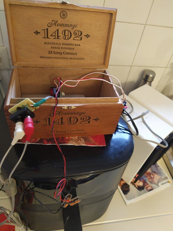

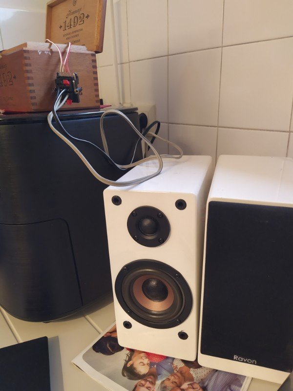

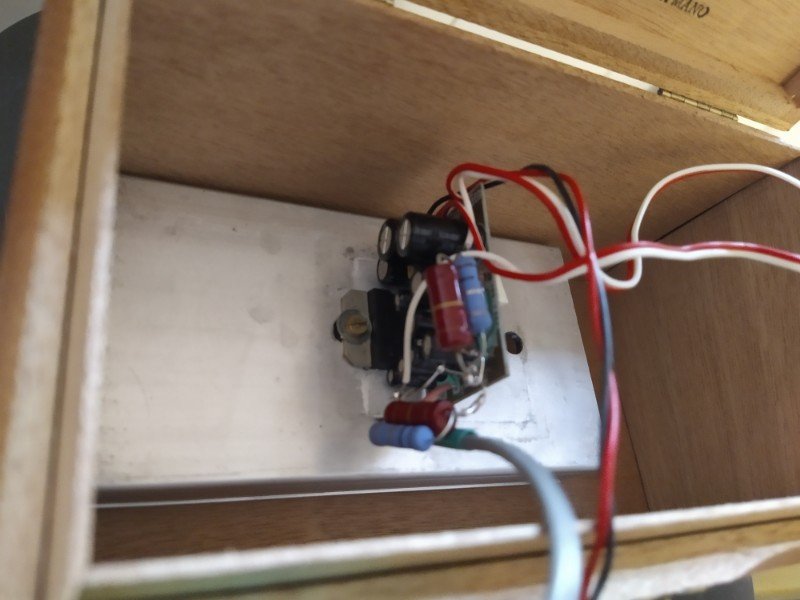

To give you an example of the simplest transconductnce amp: A modified tda 2005 chip.
Is it hi-fi? No.
Is it underpowered? Yes
Is it ugly? It depends.
Is it fun? Oh Yes!
So now playing in the kitchen, (while I bake pancakes) connected to a pair of small basically fullrange speakers.
So, not to get far offtopic:
Keep your Visatons, put them in a selaed boxes, as biggest you can find/build. Anything between 50-100 liters will work. (The bigger the better)
Build/buy a transconductance amp. Use it as your secondary system.
Enjoy! 🙂

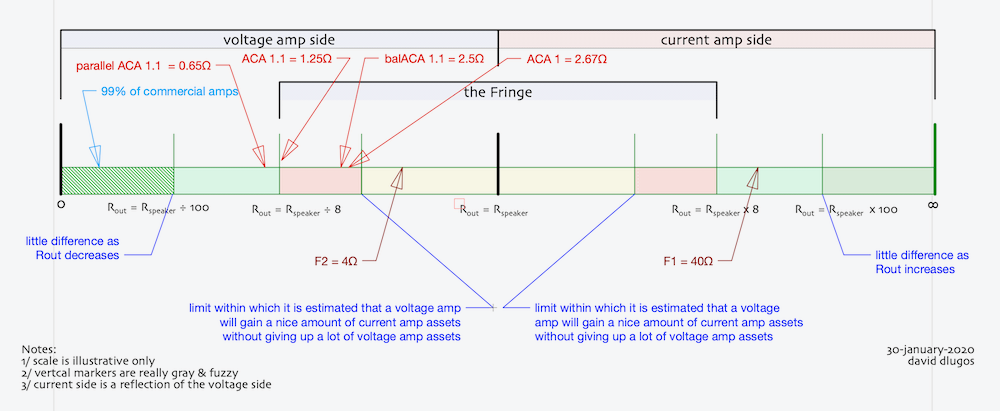

Tube amps are often have high impedance (Rout) but rarely greater than the loudspeaker’s impedance. This means they fall on the voltage amp side of zero. But they are often — especially SE amps — close enuff to 0 that the loudspeaker impedance starts to impose itself on the end frequency response of the system.
The Pass ACA also falls into this camp. This disgram might help — note this predates more accurate Rout numbers (they aren’t quite soclose to zero).

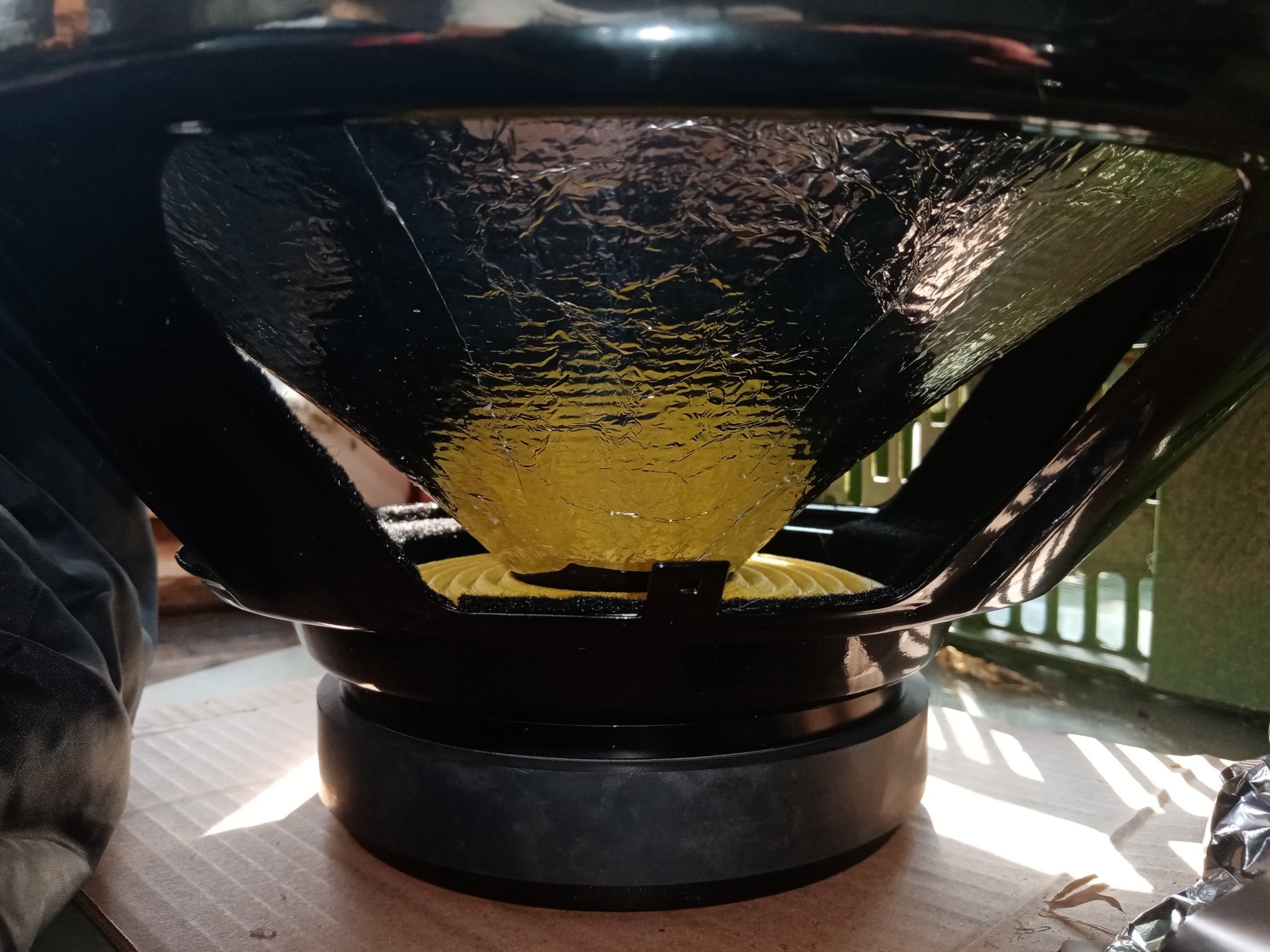

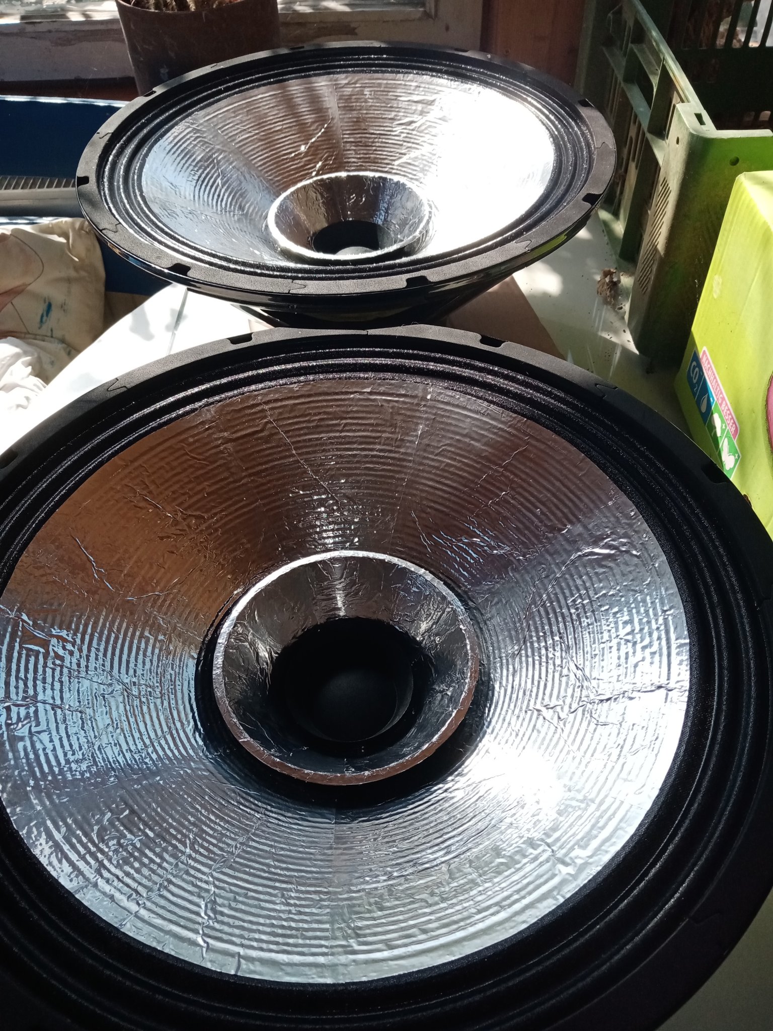

not knowing the markaudio drivers but as someone who likes the magic of the use of metals for loudspeaker cones (diy metal foil on paper cone drivers) it is obvious for me that already the cheaper drivers of a brand using metal cones in their drivers in the tradition of Jordan Watts bring all the magic of good impulse response / transients this material has to offer:
Jordan: "the cone makes the music"
More expensive drivers usually have better ventilation, bigger magnets, longer stroke and maybe also some refinement on the cone itself.
diy sandwich aluminzed Fane Sovereign 15 300tc
Reactions: goodguys
@Freedom666
Thanks for tge pictures. Very nice. I'll have to try this mod on some of my old/spare fullrange speakers. 😉
