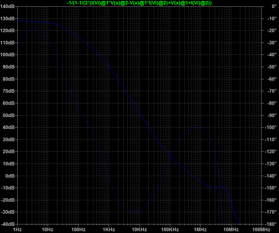

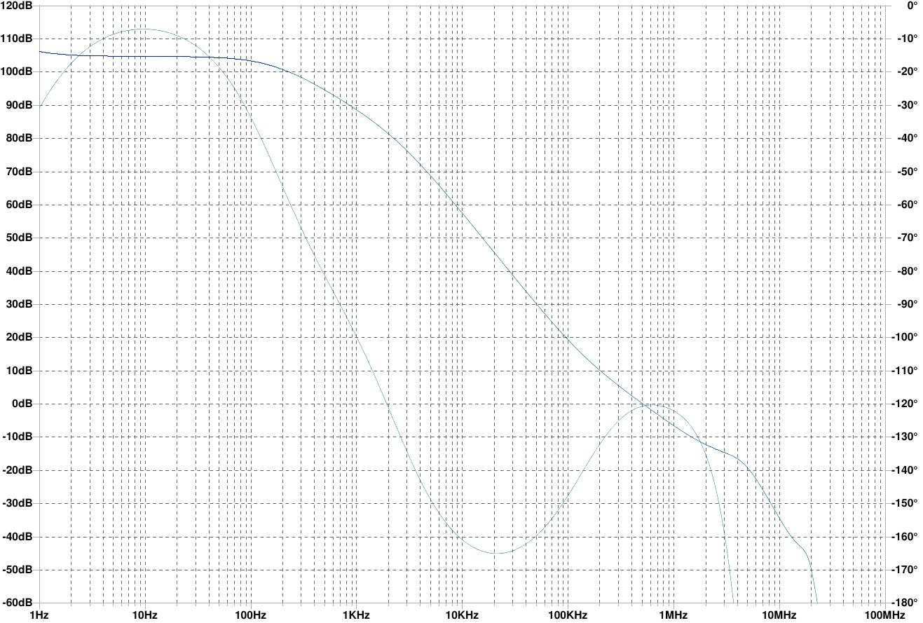

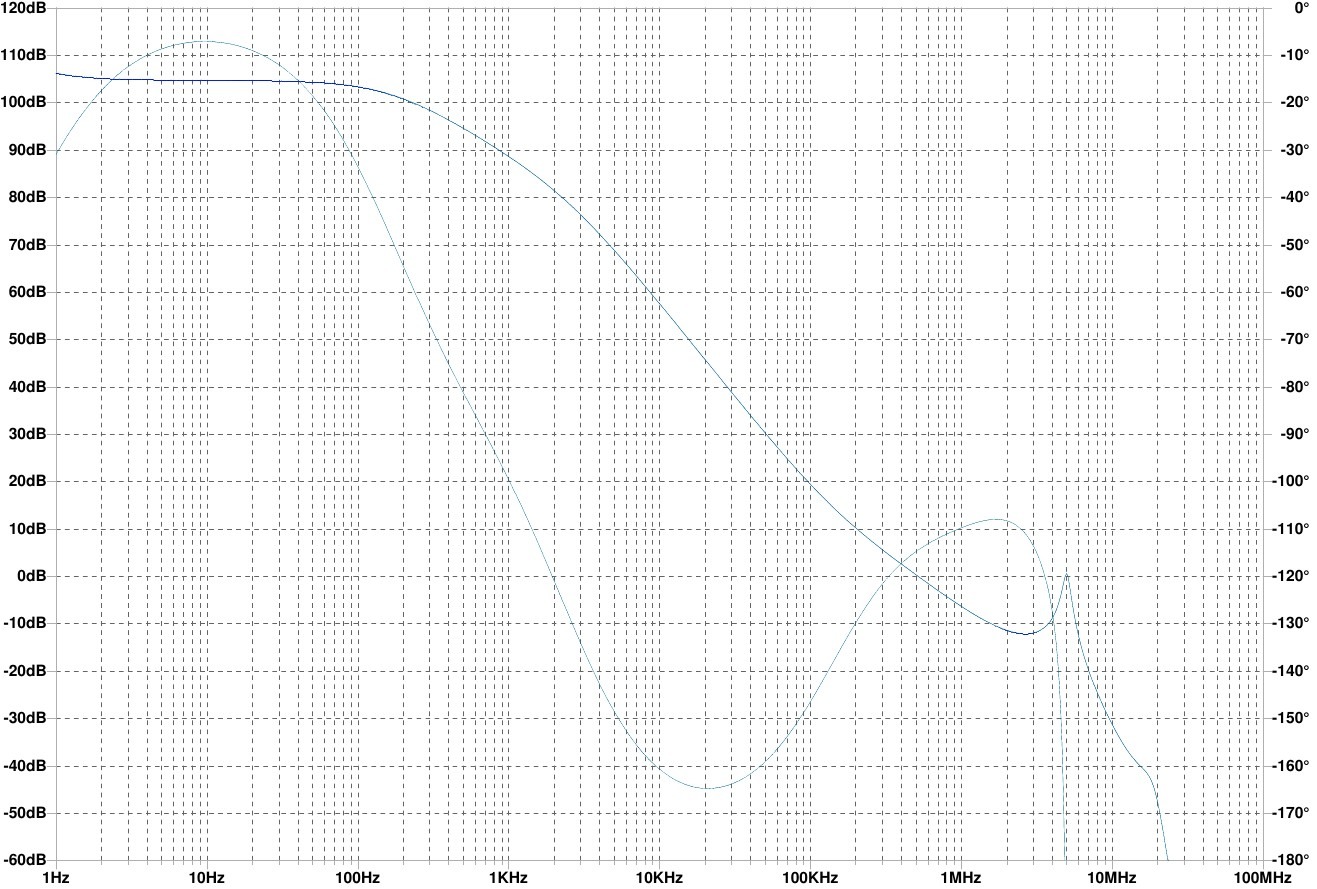

Getting back to simulation I found that the sim setup was off and once I corrected this, I saw the gain peak again.
This gain peak can easily get masked by high UGLF of the compensation loop and the amp looks stable then, but isn't.
The gain peak can be controlled by C3 and C4 of the diamond driver module. Maybe there are other ways to do this?
Increasing the capacitance lowers the gain peak and therefore increases phase margin at -180°.
Downside is that more capacitive loading of the previous EF destabilizes this stage then and also cuts into phase margin above ULGF.
This is why I have R5 and R6 to mitigate the load a bit, but too high resistance makes the capacitance ineffective again.
I increased C3 and C4 from 680pf to 1n5, but this didn't help with stability.
Attached two plots illustration the gain peak. The comparison is between 330pF (instead of 470pf) and 1n5 to illustrate the effect.
I guess I need to work at the compensation and learn more about TPC and how to apply this correctly.

This won't help your stability problem because it's a low-frequency thing, but an observation about your "BTC" capacitor. A tiny capacitor there has an outsized effect. If you look in my HPA thread, on the simulation, just putting a Baker clamp diode across the TPC network is enough to radically alter the compensation curve. It looks like you're splitting the low-frequency TPC poles (there's a break around 100Hz, then at about 2kHz). If you read the bottom of Harry Dymond's paper, he talks about adding a capacitor in series with the TPC resistor, which he incorrectly calls (and corrects in a revision) three-pole compensation. This capacitor nicely knocks down the TPC peak and it's a large value (around 150nF, IIRC) so may be less fiddly. Seems to work very nicely on simulation. Again, this probably won't fix your amplifier, but it's a nice technique to learn about, I think.
This may or may not be a helpful suggestion, but in the world of software development there's something called "thrashing" (not to be confused with other uses of the same term). It's when you have a really complicated program and you don't know why it's failing. You keep changing things without understanding the root cause, and you end up fixing one problem but causing others. When this happens to me, I will sometimes try to find the simplest possible implementation that works, then add features back in until it breaks. I know you're being very methodical so I apologize if I'm insulting you by stating the obvious.
In any case, if you get too frustrated, it might help to build a simpler model amplifier with fewer moving parts to give you more confidence and a better handle on these different compensation schemes. As a bonus, when you finally get your complete design working you can compare the two and see if the extra complexity bought you anything in sound quality. Maybe not a helpful suggestion, but it's all I can think of right now.

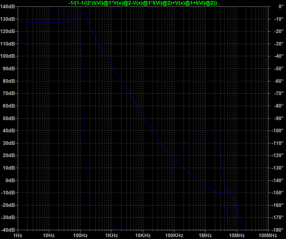

After reading the papers, I went back to simulation.
First issue I found out is that I connected the resistor of the TPC network (R84) the wrong way and this both impacts PSRR and the compensation.
For this amplifier topology, the resistor needs to be connected to Vcc like Michael shows in his paper.
The wrong connection explains why I didn't see the typical low frequency gain peak associated with TPC.
I'm not really surprised about the impact on PSRR because Harry shows that connecting the resistor the wrong way impacts PSRR.
But I'm a bit surprised about the impact on the TPC.
In a model amplifier with voltage controlled voltage source as OPS; the gain peak is there in any case, but with the DBT OPS (plots in previous post), the resistor connection matters.
Must be having to do with connecting the modules together.

Here is a little update:
I found out that the capacitor labeled "Cx" in Michael's paper (e.g. in figure 57) is incredibly useful with TPC.
In the loopgain analysis, this seems to have roughly the same impact like the shunt compensation of the input LTP (C80 / R80), but it works differently and brings stability with TPC, whereas the shunt across the LTP does not.
Another very helpful addition is lead compensation across the feedback resistor.
I have this from Michael's paper as well.
I added 33pF and 1k.
I also found out that stability is far better with the TPC resistor being connected to Vcc instead of ground.
Connecting the resistor to ground obviously not only ruins PSRR, but also the compensation.
While the latter isn't obvious from simulation, at least to me, it showed on the bench.
Current values of the compensation are:
Cx (Michael) = 100pF
C85 (Miller) = 150pF
C84 (TPC) = 560pF
R84 (TPC) = 2k2
This gives roughly 400kHz UGLF and still 40dB OLG at 20kHz.

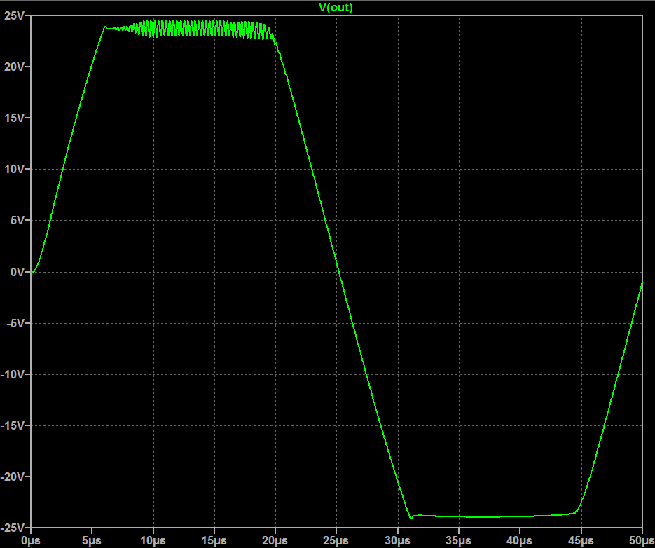

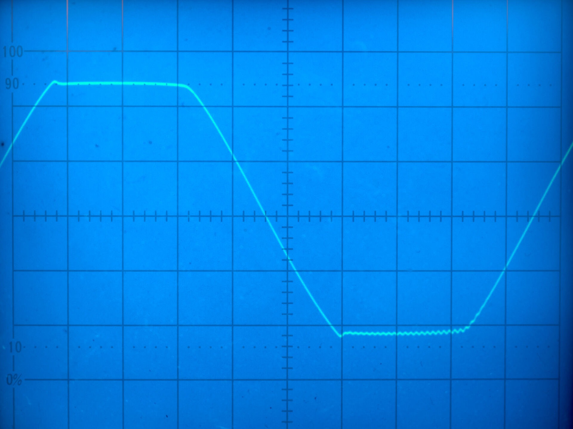

Attached a snapshot of 20kHz sine waves clipped.
This may be the first time that the result of simulation is close to what I observe in reality.

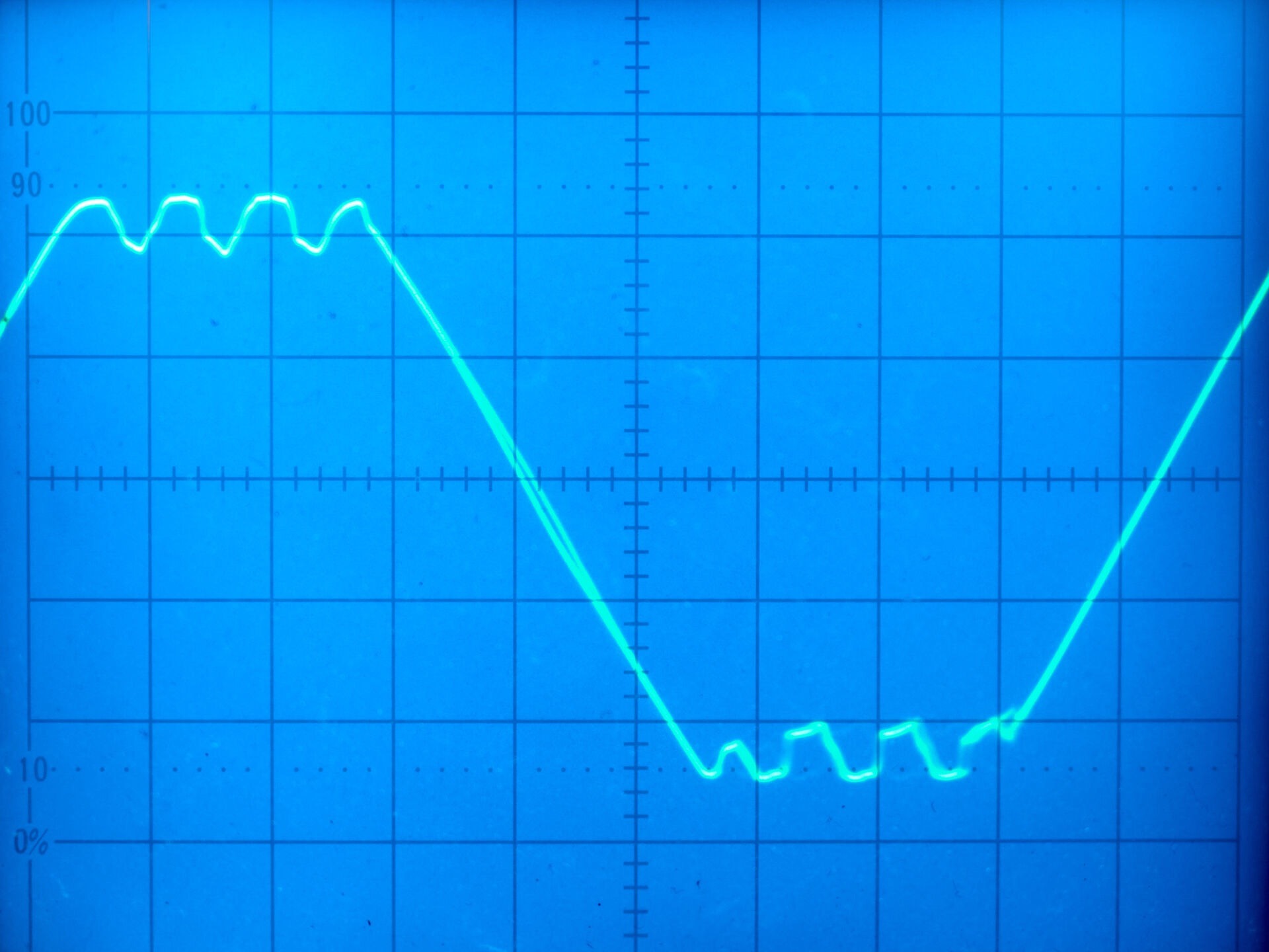

Please find attached two screenshots showing behavior during clipping with the pre-drivers connected to the next stage emitters (i.e. bootstrapped) and another with the collectors connected to the opposite power supply rails.

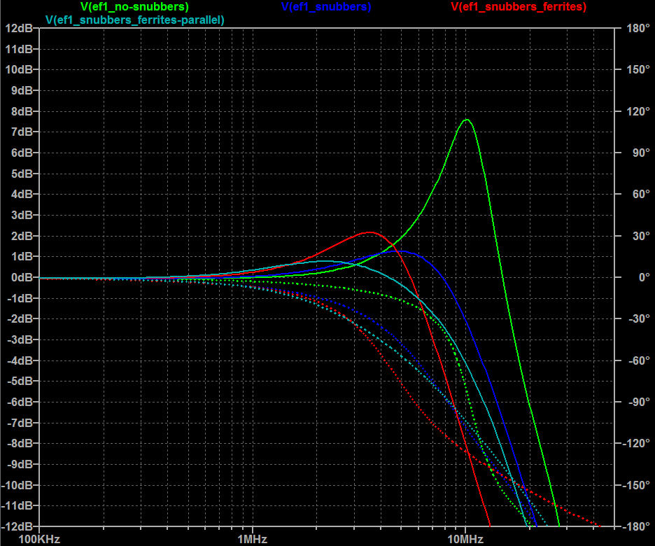

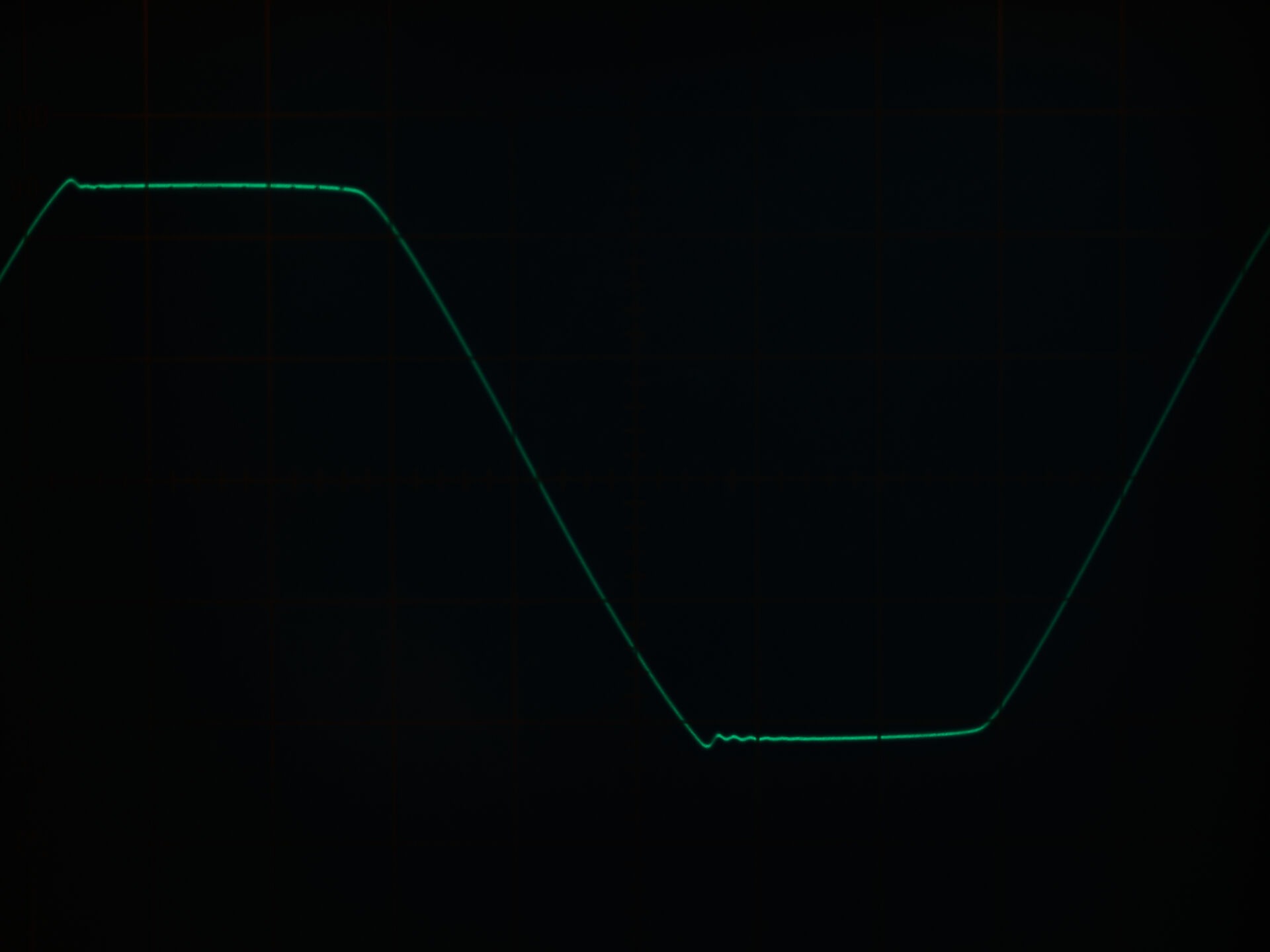

I simulated and experimented a bit to further stabilize the DBT output stage.
Conclusion is that the base to collector snubbers at the power transistors are good.
Better component values are 33R and 1nF instead of 100R and 47pF I had before. The previous values were never engineered, but blindly copied from Bob's HexFET OPS (where they likely make sense).
I reduced the drivers snubber caps to 1n5 without compromising stability. 3nF was really excessive.

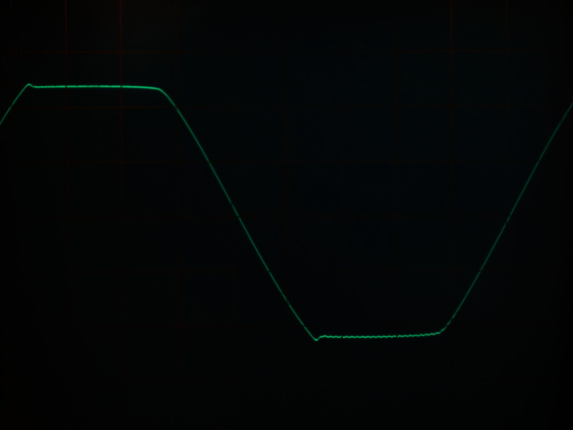

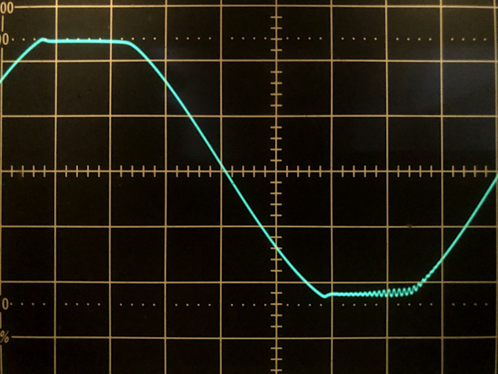

As you can see in the previously posted scope screenshots, there is still some tiny oscillation present on the negative clipped edge.
I experimented a bit to figure out how to tame this.

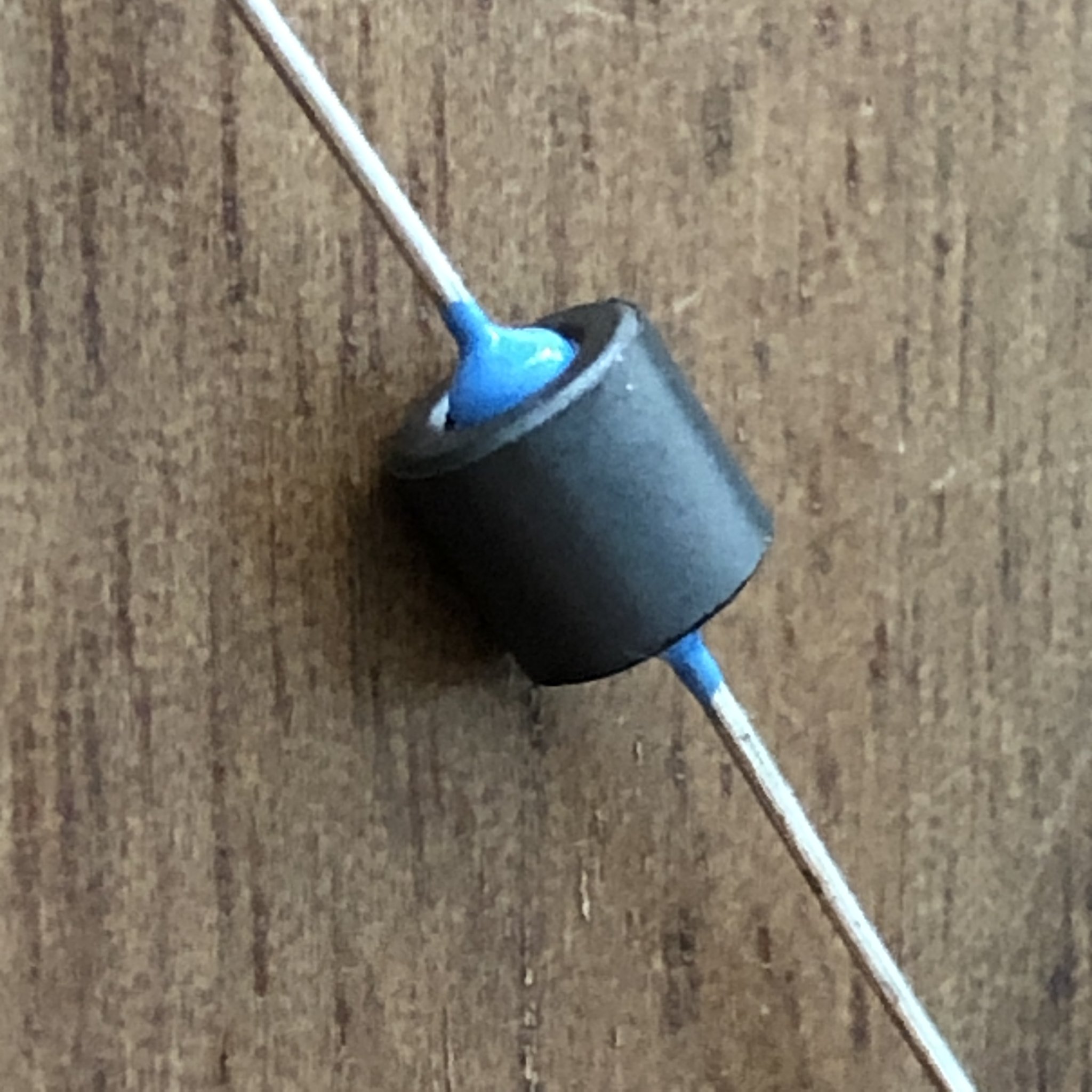

The best result was achieved by adding ferrites in between the driver module and the OPS module.
I had some Würth 742701121 at hand.
With the ferrites added, the sustained oscillation is gone and just a bit of (lower frequency) ringing following entry of clipping remains.
Adding two ferrites in series does not further improve anything, but adds some minor ringing to the positive half wave.

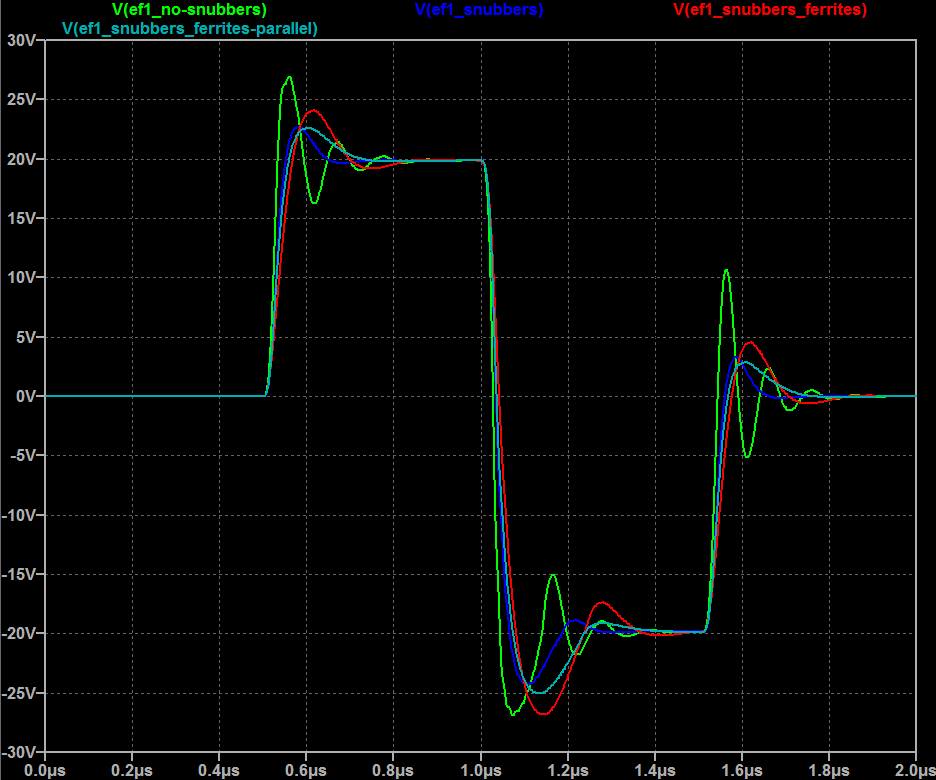

I thought about trying ferrites for some time now, but simulation suggests that this is a bad idea.
In reality however, the result looks promising.
Square wave overshoot is unaffected with the measurement capabilities I have (which is a 1kHz square that produces only 6Vpp at the amp output).
I'm currently looking for a proper signal generator to improve my measurements.
Maybe I pick up the idea of putting small ferrites in series with each base stopper of the power transistor again...
What do you think about ferrites?
What is your experience?

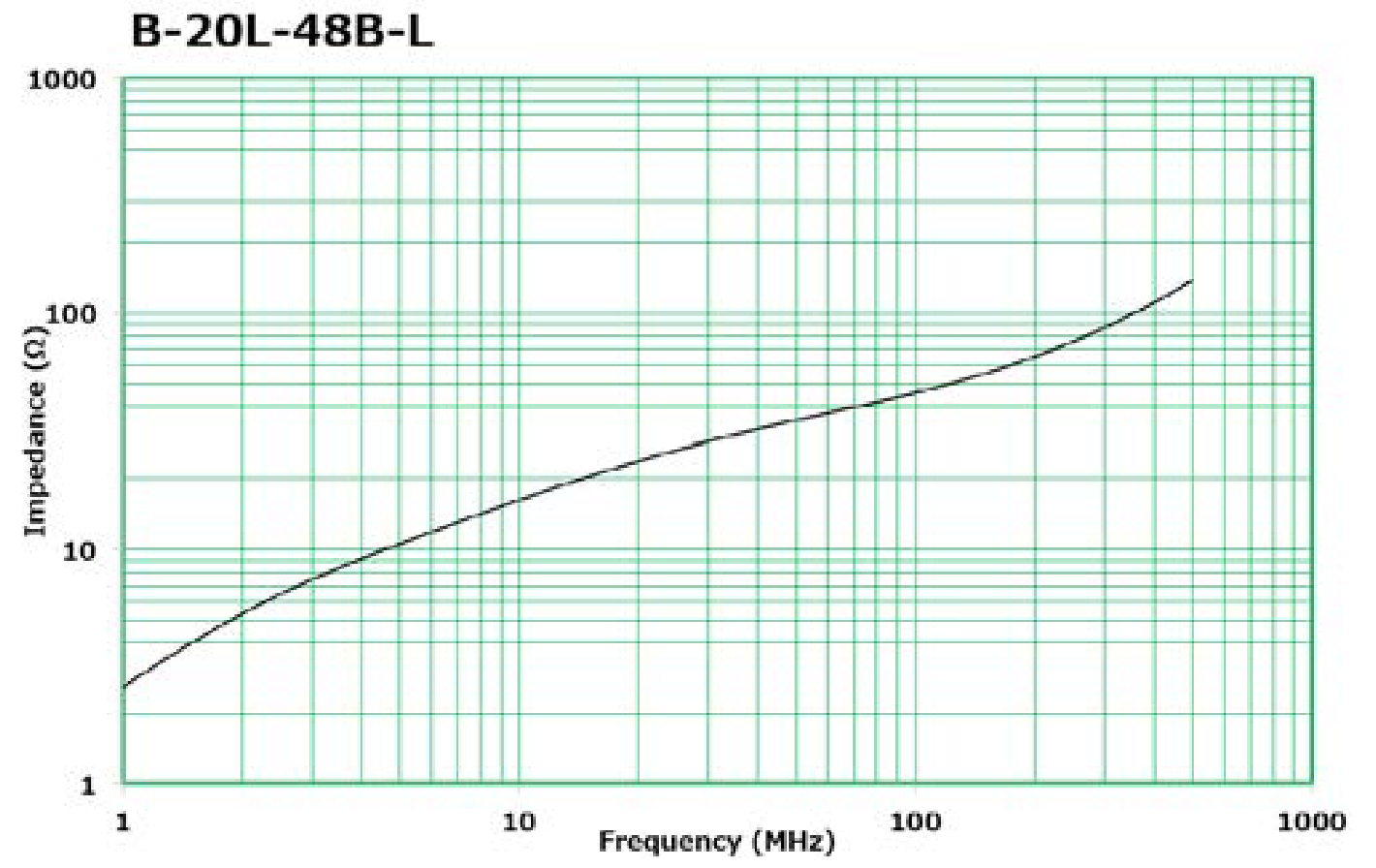

More ideas regarding ferrites:
I bought some Kemet B-20L-48B-L earlier for maybe putting them on the transistors terminals like that:
However, since I'm also having the snubbers from base to collector, the ferrites would counteract the snubbers when being put in between the snubber and the transistor.
This leads to the idea of putting the ferrite in series with the base stoppers like that:
The B-20L-48B-L has a characteristic that seems suitable to me.
Low impedance at 1MHz and reasonably high impedance at higher frequency:

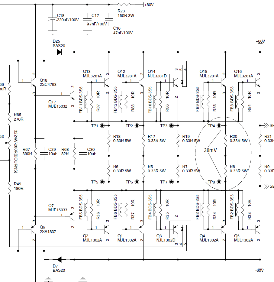

Perhaps this is can be a reference at certain extend.... Harman Kardon HK990 also has ferrite beads over the base stopper resistor at the output transistors base, where the base stopper resistor itself, at a value of 10-ohms, works as a damping resistor to reduce the Q factor of the FB.

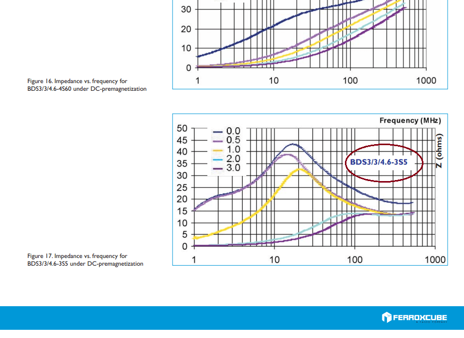

I noticed 3S5 ferrite material is selected for its lower-ish frequency range application, up to 30MHz. The 3S5 FB has a nominal impedance of 10-ohms at 1MHz.
Also can be noticed, in the datasheet attached, is that the impedance of a FB drops as the DC bias current it passes increases, what they call DC premagnetization, significantly when the DC current exceeds a certain level, say 0.5A, indicating saturation.

I didn't have the idea to parallel the base stopper with ferrites yet, but this looks most promising.
Damping is something I was concerned about. Ferrites have an inductive part as well and this may be significant.
With the parallel resistor (just like the output filter of the amp) the Q is well controlled.
Another advantage of the parallel arrangement would be better current sharing of the power transistors since the base stoppers counteract the balancing effect of the emitter resistors.
I thought that the base stopper in series with the ferrites also lowers Q, but this seems less effective than with the parallel arrangement.
Unfortunately it seems a little known fact that ferrites saturate because most datasheets omit this information, just like the inductive contribution to Z is often not shown.
I've seen such a tiny ferrite on a drain terminal of a commercial product somewhere here in the forum.
Once there is significant Ic flowing, the tiny ferrite becomes pretty much useless.
May be desired in that application, who knows?
I did a simulation in order to align my observations in reality with the theory.
Adding ferrites contributed to stability in reality, but simulation says otherwise.
In reality, not only the faint ringing was gone, but also I was able to load the NFB node with more capacitance.
When playing small square waves and I put 4n7 at the NFB node, the amp bursts into oscillation.
This behavior seems pretty binary because at 1n5, the amp doesn't care.
I would have expect some more overshoot at the corners followed by some ringing.
However, with the ferrites in place, the amp doesn't care about 4n7 and it takes 6n8 to provoke oscillation.
Here are some plots from simulation of the power output stage only (EF1) driven by a voltage source with 1R output impedance, illustrating four cases:
1. No snubbers (green)
2. 33R and 1n base to collector snubbers (blue)
3. same snubbers and 74276031 ferrites in series with each 2R2 base stopper (red)
4. same snubbers and 74276031 ferrites in parallel with each 10R base stopper (petrol)
Ferrite datasheet for convenience: 74276031 Würth Elektronik

I experimented with adding ferrites to the output stage and here are my results:
Adding bespoke Kemet ferrites in series with each base stopper resistor did not show significant effect in reality.
I received some free samples of WAFB ferrites from Würth Elektronik and installed 7427605 ferrites with 12R resistors in parallel.
I chose the stronger ferrites because the weaker ones (in series) did not show enough effect.
Actually I have many of those in parallel compared to the single 742701121 I used on the common drives for the whole OPS.
The parallel arrangement cured the faint oscillation.
I bought a better DAC, which allows higher frequency and higher level output and now clipping at 40kHz, there is some tiny ringing (only a few cycles) following entry of clipping, but this is barely visible in the milliVolt range.
Conclusion is that all the snubbers are essential for a stable triple and the ferrites added further refinement.
Another conclusion is that the compensation of the front end cannot fix an unstable output stage being included in the negative feedback loop.
