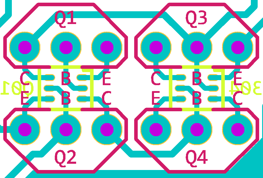

I just like to briefly mention how nice the dual transistors in SMD package fit in between the THT components:
In most cases it is easy to fan-out the pin-out of the SMD transistors to the THT ones quite nicely given the flat sides of the THT parts face each other.
The SOT 363 package is super tiny, which is great because it consumes very little space on the PCB, but the pitch of 0.65mm is difficult to solder.

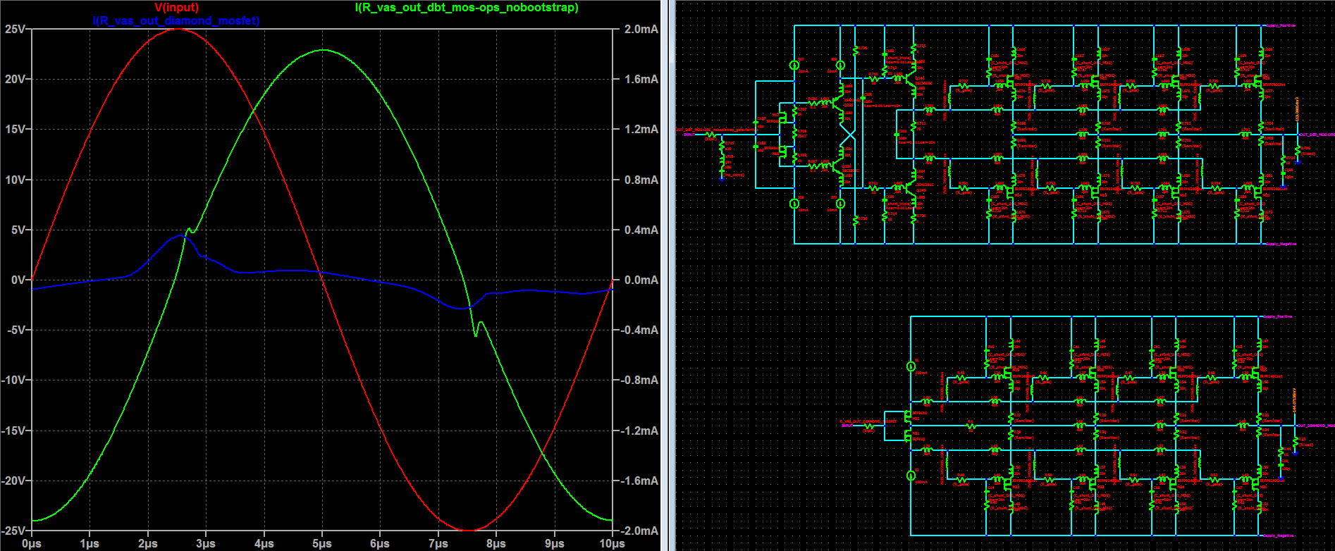

Inspired by your lateral MOSFET driver idea, I simulated a MOSFET Diamond OPS with bootstrapped drivers. This seems a very interesting option indeed. This kind of OPS draws almost no current from the VAS - compared to a Diamond buffered triple with same MOSFET OPS attached. Also, the MOSFET Diamond OPS is very simple with low part count, does not even need a Vgs multiplier.
Here is an illustration (image is a bit small, but you get the idea):
Legend: Red is the signal swing, green is the current drawn from the VAS by the DBT and blue is the current drawn by the MOSFET Diamond OPS.

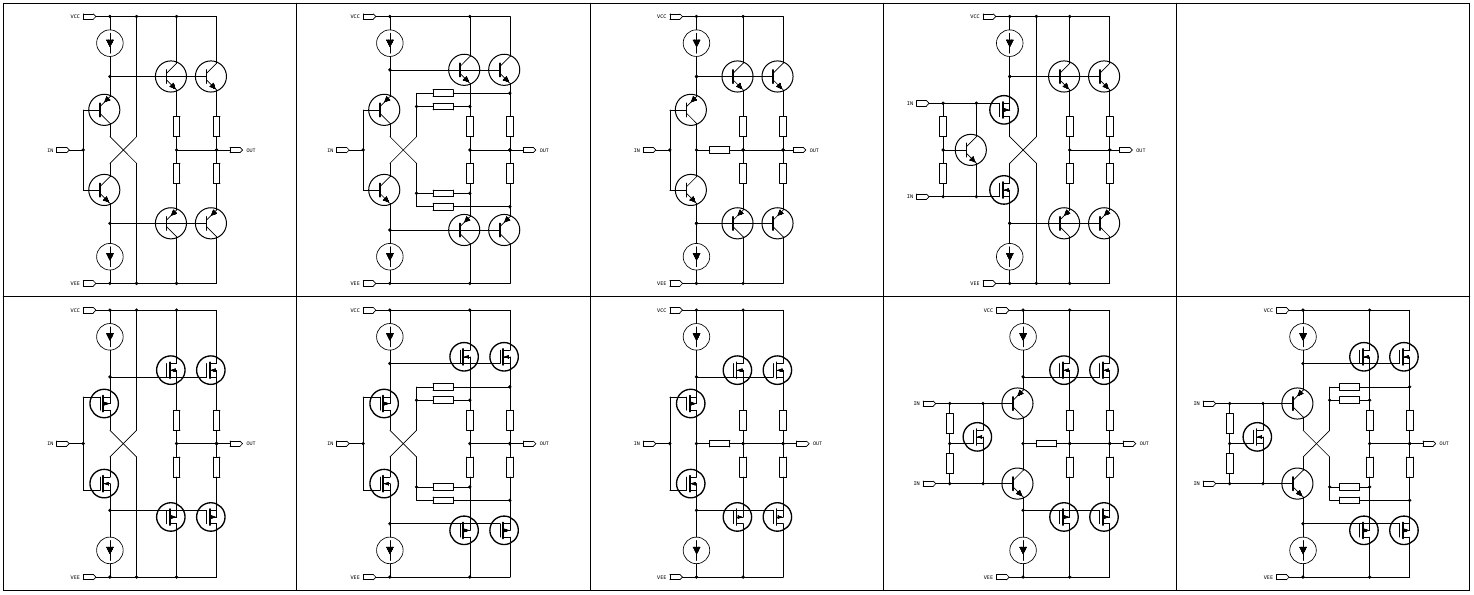

Bob Cordell wrote some good advice about MOSFET OPS bias stabilization in his book.
All arrangements with BJT drivers and BJT OPS suffer from low current gain. Best case this has a current gain of 10000 roughly, whereas the DBT easily has over 1000000.
The rightmost variant in the top row has rather high input capacitance just like the three all-MOSFET variants.
Probably best are the two variants with BJT drivers and MOSFET OPS.
I would need to do some simulation in order to find the best solution, but the PCBs are pretty flexible so I can procure them already.

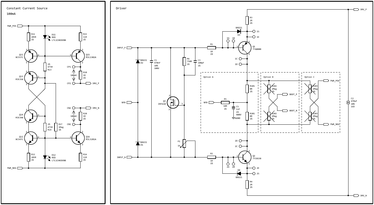

Here is the updated schematic of the driver module:
Besides adding more options to connect the collectors of the drivers and adding a Vbe / Vgs multiplier, I also updated the CCS.
The new CCS features slightly lower compliance voltage, better SOA and is a bit simpler overall.
Note the "boot" connections would be to the OPS emitters / sources like in the lower right or second from the left schematic examples.

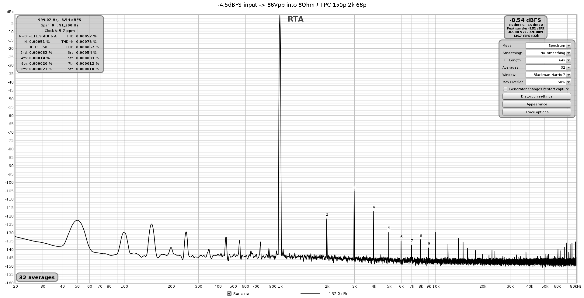

Small update from me:
I built the revision four of the front end and I'm still doing measurements. So far, it doesn't look too bad.
Due to some stupid simulation mistake, I accidentally changed the compensation to ~1MHz UGLF, which is a bit high IMO. I consider lowering this a bit.

More interesting in my opinion than some numbers, is the harmonic spectrum.
At such high levels, the Topping DAC outputs quite some harmonics and some seemingly unrelated HF trash.
I built a second order active filter to get rid of this prior to feeding the amplifier, but the filter does not work well apparently, thus I don't use it at the moment.
Instead, I just installed a cap that makes a first order filter roll off at 1.5kHz / 15kHz so that there is some attenuation at least.
Here is the spectrum near clipping:
The h2 must stem from my amp entirely since the DAC does not output any. Instead, the DAC mostly outputs h3 and I guess this is why h3 is highest. Beyond h4, the passive filter seems to do a good job filtering the input and the amp seems not to add a lot of higher order harmonics on its own. This is what I wanted to achieve.
Overall, the DAC has 0.00019% THD at 1kHz and the level used for the measurement. May I just subtract this number? Probably not.
Still difficult to say how much exactly each device contributes.
