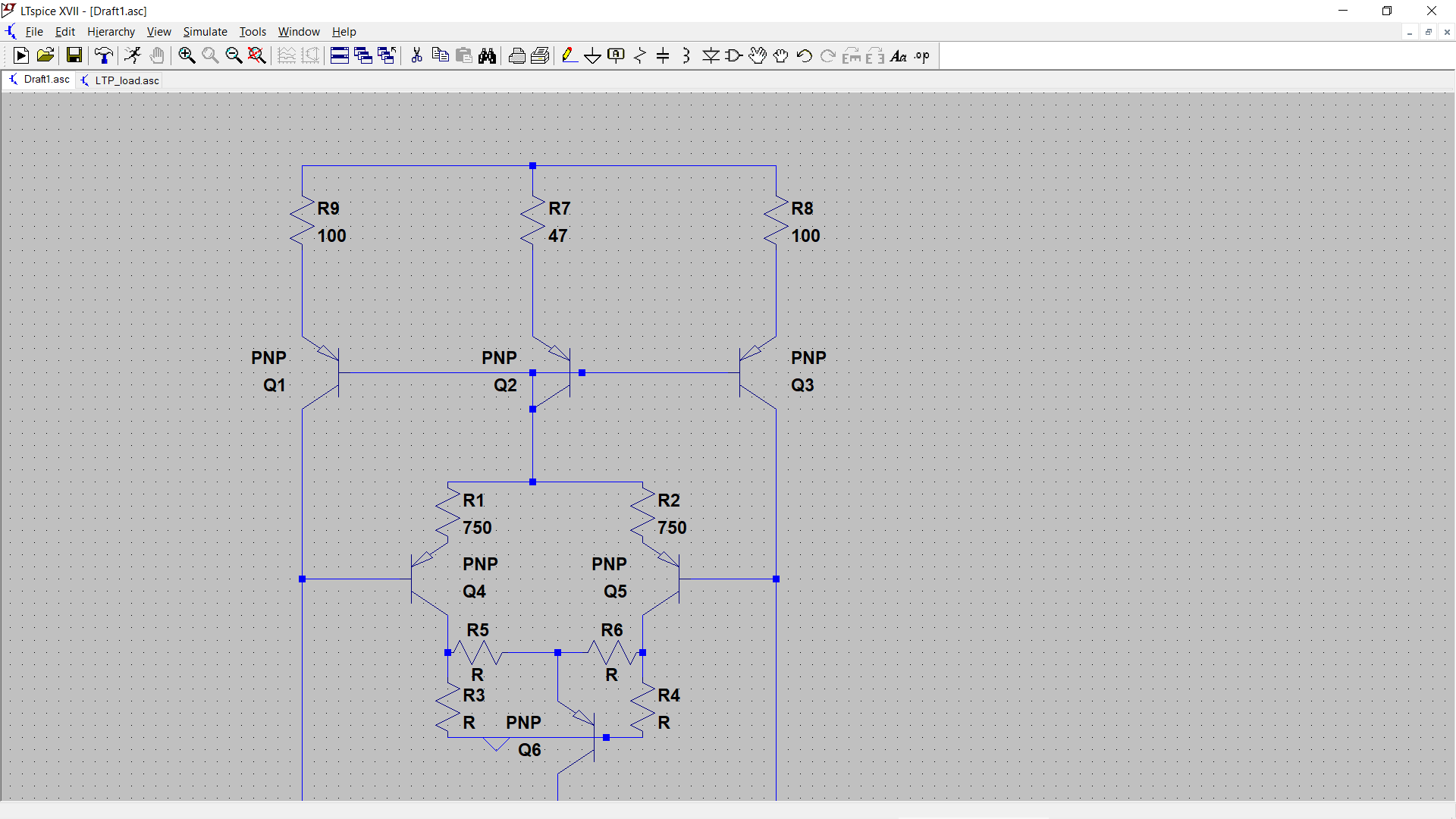

The low Vce of the transistors is a real issue and fixing this greatly improved the performance. All it takes is one resistor.
I set up a small test jig (see attachment) to play with different options.
What I found so far is that all options, means the original Cordell circuit, the modified Cordell circuit with "R7" to increase the Vce and also the circuit I came up with based on your suggestions behave well in the AC domain. Mine has ~6dB lower gain, but this is something I don't mind.
Here is the AC response:
Green = original Cordell
Blue = Cordell modified with extra resistor to increase Vce
Red = My Frankenbuffer
Petrol = standard current mirror

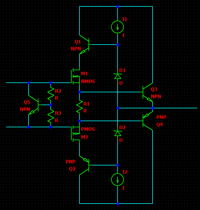

Trying to understand what is going on, I have redrawn the circuit another way:
I still don't get it. Does anybody recognize this circuit somehow?
It looks like Cordell's CM distortion reducing circuit, doesn't it?

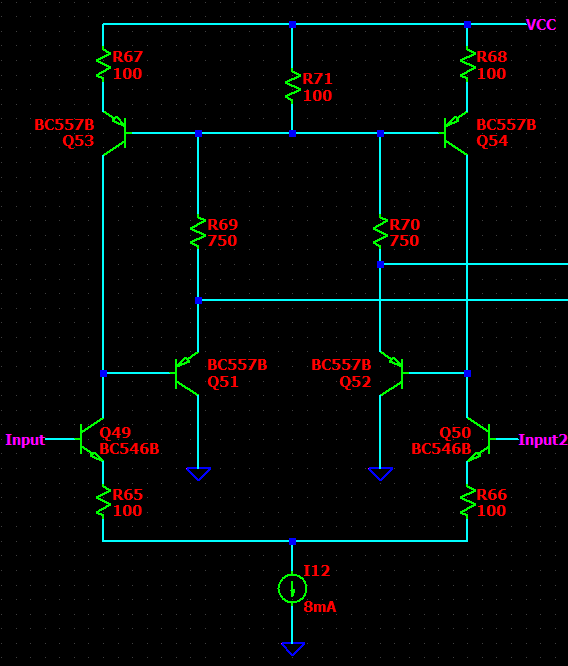

R67 and R71 can be seen as a mirror, R68 and R71 can be seen as a mirror.
Now having two mirrors in paralell common current feedback is related to R67 and R68 in paralell 50 Ohm and R71 at 100.
Would have thought R67 // R68 = R71 makes a common current feedback ratio, also bias at 2nd stage makes U R71 equal Ubase emitter in the common current feedback or? Was there som latch up mentioned? Like a bistable "mirror" ? Then R67 // R68 should not be lower than R71 ? Or ?

I tried substituting a random transistor for the BC557C instead of BC557B and here it shows that it no longer works as expected.
The Cordell circuit is most sensitive to mismatch. It may even fail to work properly at all. The book authors quoted earlier wrote that matched transistors would be best for the Cordell circuit and simulation confirms it. This one seems to behave worst with transistors not matched.
The Cordell circuit with the extra resistor is way more tolerant towards mismatch. The extra resistor helps here, too. Great!
The new circuit is also pretty sensitive to mismatch. All magic low THD performance is gone with slightest mismatch.
Well, this happens. Something seems great in simulation, but does no longer work with real life tolerances.
Good thing is that all circuits are just assembly variants. By adding or removing resistors, three variants can be built.
Planning in matched transistors would be nice, but such parts are extremely expensive and hard to find.

Regarding the CMRR of the different load options, I made some plots.
Both inputs are shorted together and driven by an AC voltage source.
See for yourself:
Surprising observations are:
All active loads are no better than resistor loads. No idea why.
The simple current mirror performs worst even with perfectly matched components.
The emitter follower enhanced CM is great in theory, but also fails in reality.
The simple resistor load with 1% tolerance preforms pretty well.

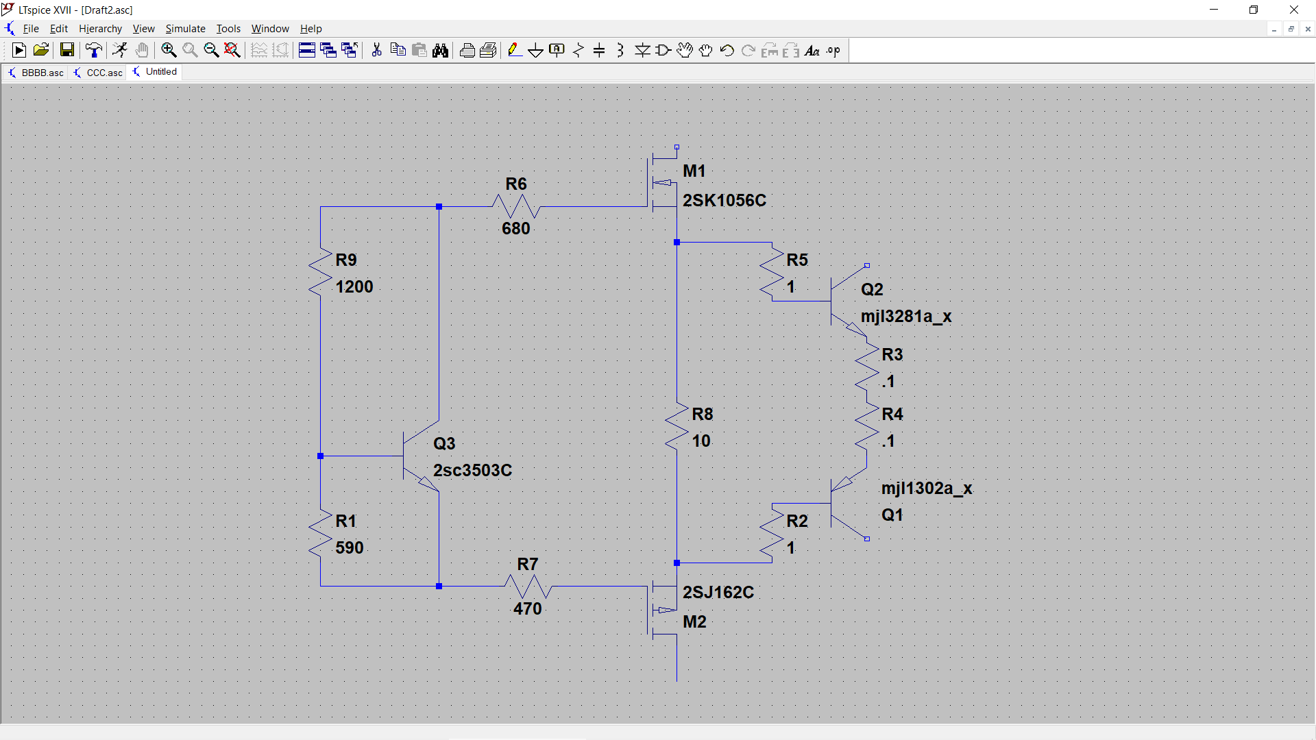

2sk1056 & 2sj162 as drivers, they need abt 100mA or so to preform.
Clever idea to use lateral MOSFETs since they tend to stabilize their bias at a certain current.
However, they present a massive (gate to drain) capacitance to the VAS output.
Bootstrapping makes this capacitance constant, but also maximizes it.
