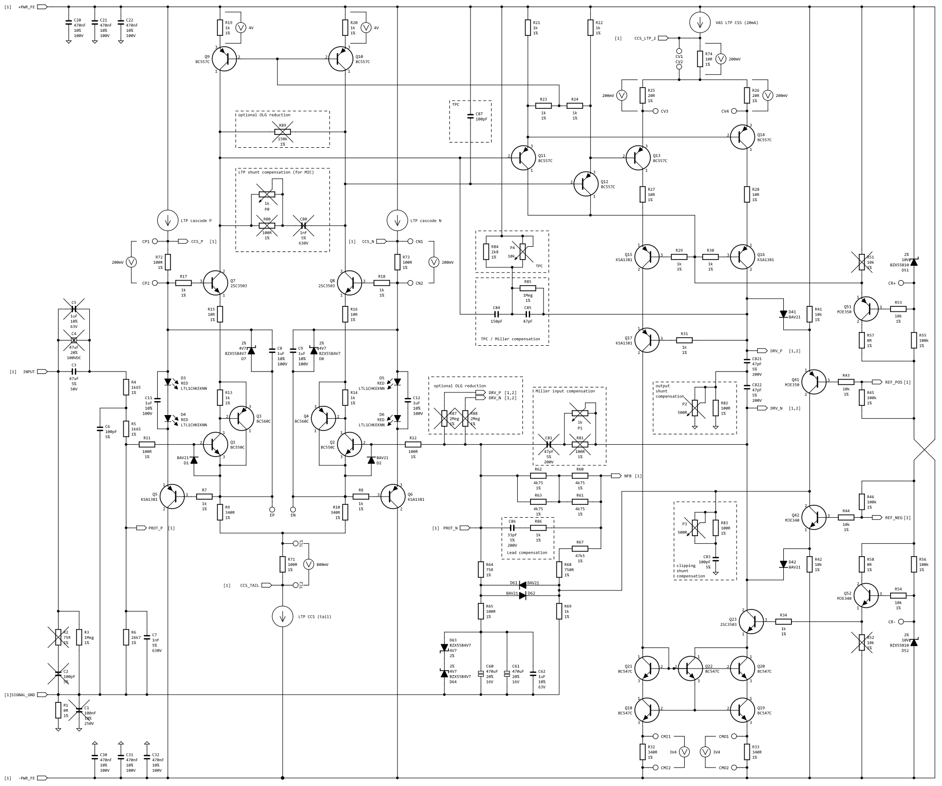

In order to provide some context, I will attach and explain the new schematic in the next post. Imagine the front end driving a diamond buffered triple that has four pairs of power transistors as presented earlier.

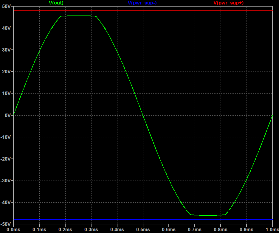

THD of 1kHz near clipping (~90Vpp) into a 4 Ohm load is 0.00013%
THD of 20kHz near clipping (~90Vpp) into a 4 Ohm load is 0.0013%
Clean clipping is also one of the objectives for this project. Here is a 1kHz sine wave clipped:

So here comes the new schematic bit by bit.
First I changed the constant current sources.
There was nothing wrong with the CCS unless one either power supply fails and the amp develops unhealthy DC operating conditions. I redesigned a lot of circuitry to tolerate loss of either power supply.
This looks way more complicated than it actually is.
What you see is just a "ring of two" CCS to the left that has the sole purpose to output each half's current into the other half's reference. Thus, a very stable reference is generated across LEDs D141 and D151. Attached to those reference voltages are as many cascoded CCS as needed - one for the LTP tail and two for the bootstrapping of the LTP cascodes.
There are some decoupling options, not sure yet which to install.

Further changes are that the capacitance multipliers were substituted by R-C filters as simplification and to free up PCB real estate for other circuits.
The tail CCS of the VAS is the same.
Reference voltages for clipping are generated the same way, but refer to the opposite rail now instead of ground.
Here is the actual amplification part:
Note I added some options to toy around with like OLG reduction. I don't think I'm going to use it, but addition was a low hanging fruit.

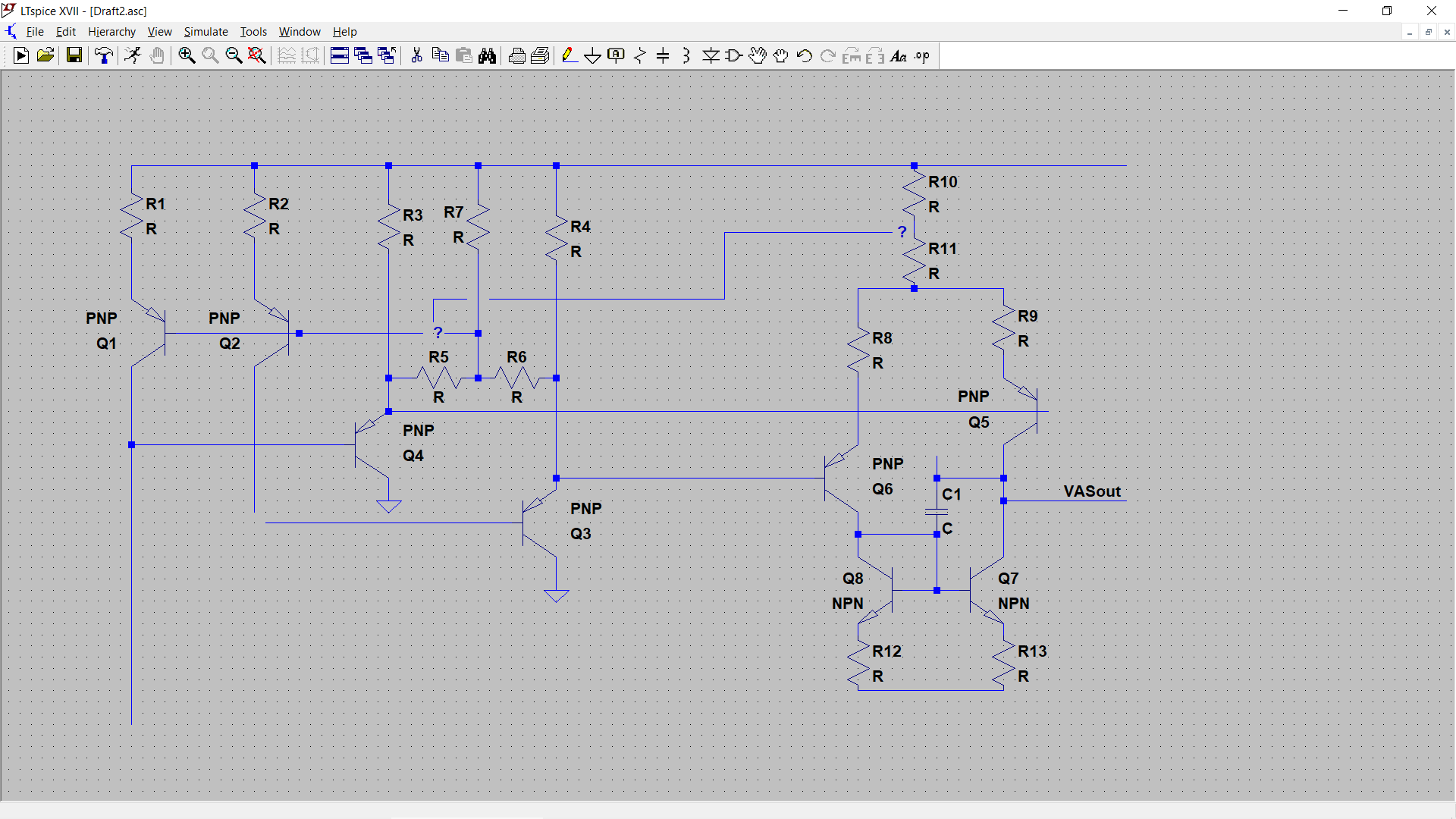

Think youre Q9 and Q10 have to low UCE. the double current sorce could have either adjusted values ad 1K bases to psu as this would drop voltage and emitter resistors would bee redused in your "double current sorces".....Or get the bases of the sorces from V amp stage. The Ubc would be abt 1-1.2 V. And for the bc5** that ist just in the unlinear delta Ib delta Ic (Ib1- Ib0)/(Ic1-Ic0)
The R19 R20 would be abt 100 Ohm.
I think some of your values would need to bee adjusted. to make it work properly. Or?
Edit put 2* 1n4148 in series withe Q11 Q12 emitters

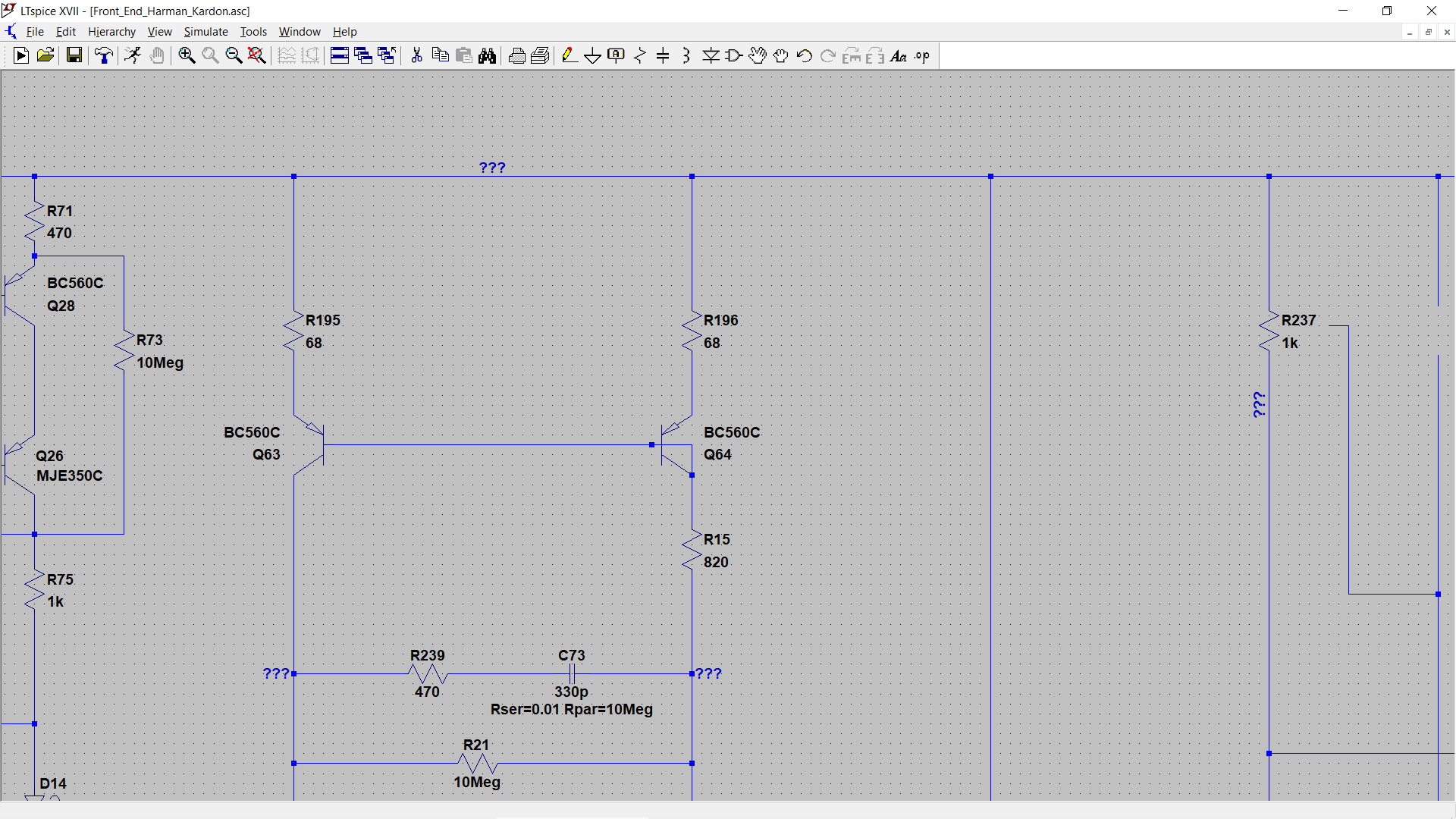

I toyed around with bootstrap options and came to some general observations:
I'll keep the footprints for the capacitors tough.
While the CFPs on their own seem to be stable, variants with CFPs cause a slight peak and may even show a huge peak in conjunction with some peaky bootstrapping options.
Thanks for the tip regarding the cap across the current mirror. This seems to work with some mirrors, but not all. The one it works best with is the beta enhanced CM. As little as 10pF across the CM null the slight peak it shows without and this method maintains good bandwidth. Bob Cordell recommends a few hundred pF from base to emitter of the helper transistor, but this significantly reduces bandwidth.
Here is what Bob Cordell writes about the differential current mirror load (ref-des fit the schematic I posted):
The key advantage of this circuit is that it allows the use of a balanced current mirror structure to load the input stage. The differential current mirror exhibits very high impedance in the differential mode, but rather low impedance in the common mode. It thus provides some additional common-mode rejection. The primary elements of the differential current mirror are current sources Q9 and Q10. Emitter followers Q11 and Q12 jointly act as the current mirror helper transistors, creating and feeding back a common mode voltage to control current sources Q9 and Q10. The emitter followers also buffer the differential signal before application to the VAS LTP.
The differential current mirror establishes a well-defined common-mode voltage level to be applied to the VAS LTP. This, combined with the differential drive of the LTP, allows the use of a simple resistor tail for Q13 and Q14.
I added a separate CCS for the VAS LTP (Q13 and Q14) because I observed that any slight variation of the bias in the first LTP has dramatic effect on the VAS bias, which has impact on the OPS bias. My idea was to just establish more reliable DC conditions. Michael Kiwanuka pointed out further benefits in his paper (discussed earlier).
The voltage drop across R19 and R20 sets the bias of Q11 and Q12 (5mA in my case). Lowering R19 and R20 reduces the bias and eventually leads to violation of the compliance voltage of the VAS CCS. With this Q9 / Q10 arrangement being a current mirror I see no way to increase the voltage across Q9 and Q10.

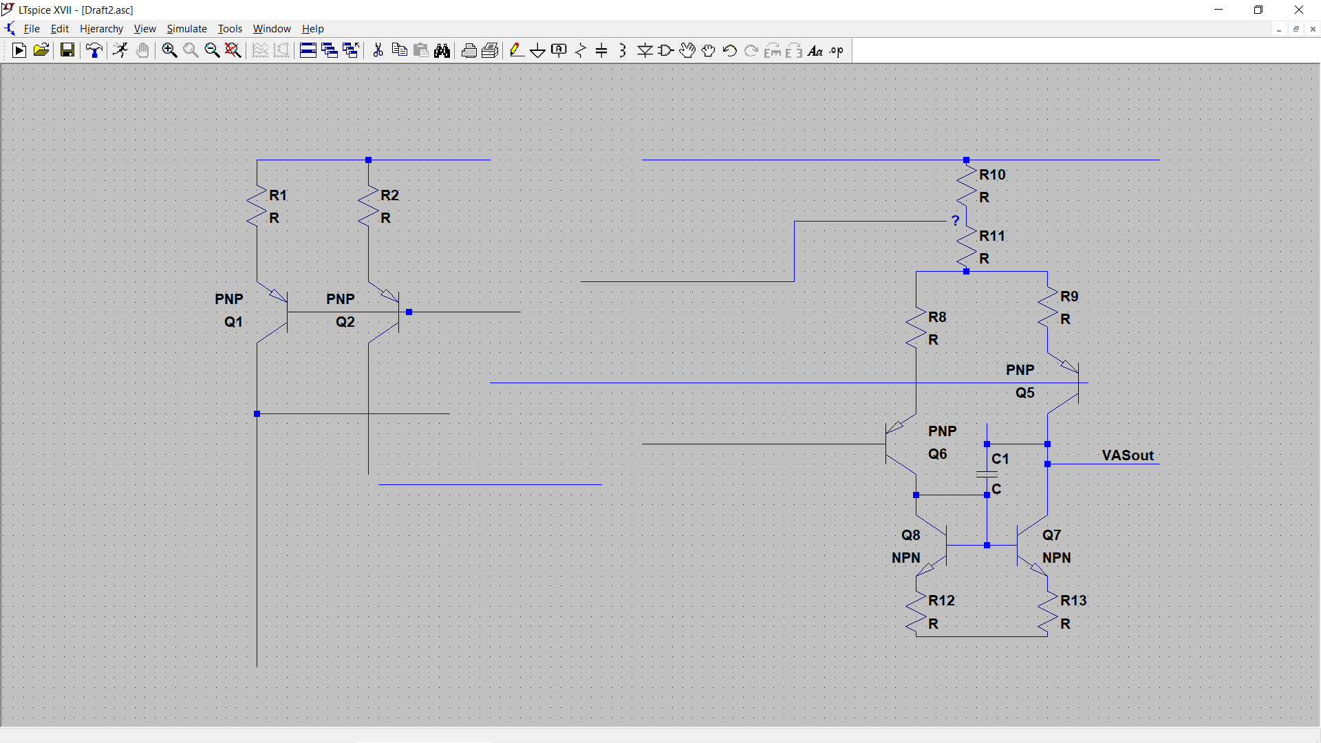

Hi, here is scetch of where i wold use as current reference piont. To improove the Uce Q1, Q2.
I really belive R7 is missing in the original ! And no R3 Or R4
At R7or at R10.
At R7 Voltage drop R5//R6 and R7 makes Uce Q1, Q2 "adjustable" adjusting R7 . Tyical R7 = R5 and R6 in paralell.
If at R10 and adj R11 to make Uce min .
R11 if ref at R10. R11makes Uce min "adjustable"
(i also find that 2sa970 or equiv has lower Uce min than bc5**).
Here is the scetch:
At R7or at R10.
Here is the scetch:

R7 in the first schematic you posted seems a worthwhile addition. (Q9 / Q10 bases to VCC in my schematic).
This resistor allows to increase Vce of the transistors and else seems to maintain the properties of the original circuit by Cordell.
Hi, the first time I saw the circuit on paper there were potentiometers for the emitter resistors in the current sources. (35-40 years ago?) It should also make matching easier.. My values are taken from the drawer and only give a hint of what I see as necessary. Also, my point is to get the transistors in the current sources to work and not throw them there. Then you could just cut them out and use two resistors. Since you are well underway, it was important that these transistors should work as intended. The happy "R7" makes it possible when the emitter resistances are set to get a compromise between Uce and not too low emitter resistance or potentiometer due to matching Ube. i belive you find your own values, as it looks like you are on "revisjon2".
For inspiration:
There is an other solution to the doubble current sorces, two resistors. The two resistor circut has a name (i dont remember), have a a look at Goldmund, two resistors replace the curret sorces.
AND
Harman Kardons solution. a current mirror with gain, one more resistor. It wll also give higher open loop gain here, but wil "destroy" som other parameters. The Harman Kardn solution is somthing worth have a half eye look at anyway when study or... ( belive the Harman input mirror froma tread here and it was used in a phono stage(????)
AND
