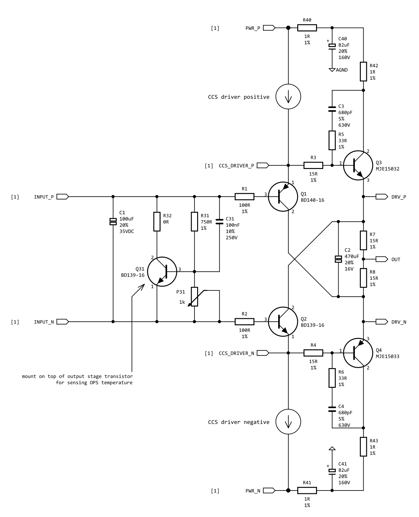

Hi Lee,

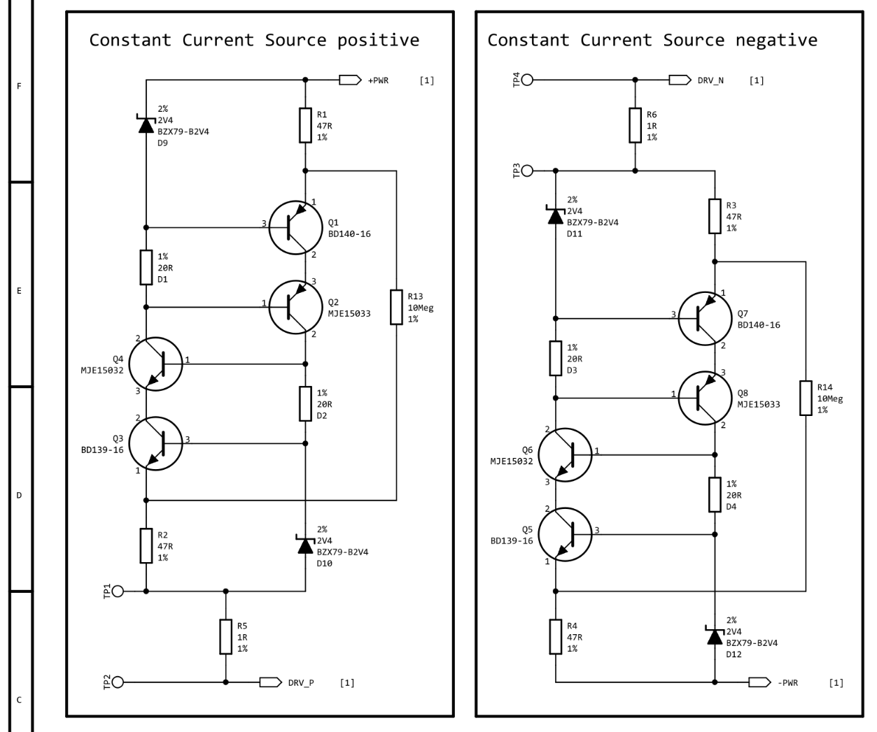

If your actual build is in line with the schematic, and if I did the calculation right, the CCS seem to be sourcing/sinking about 36mA.
In a diamond buffer like yours, it appears to me the driver transistors need to have a Vbe smaller than that of the output transistors by a certain margin in order to operate at a certain, sufficient level of quiescent current. Emitter degeneration at the output transistors can help biasing the driver transistors if the drivers' Vbe is higher than what is desired, but in the application in question you don't want to increase that degeneration. So a driver transistors having a suitable Vbe seems to be a must.
On the other hand, if the output transistors have a known Hfe at 100 or less, and they are operating at 3.7A as your earlier post hinted, they would have taken all those CCS supplies as their base current, and left nothing to the driver transistors. That, to me, seems to be suggesting the drivers are not being biased sufficiently -- you should be seeing CCS surplus from output transistors' Ic/Hfe, but you don't.
Hi nattawa,
I don't know how to calculate the current of a CCS by hand, but simulation says this should be 105mA and this is also what I measured on the bench.
You are right, there seems to be an issue with starvation of something.
I did some simulation and found out that this is related to the filter R12 / C2. Increasing the value of R12 starves the driver.
This seems related with what you also mentioned: Vbe of the transistors. There is only a super small margin by the OPS degeneration resistors. I guess that once there is some current flowing through R12, the driver transistors Vbe is starved.
Next experiment would be to remove the filter R12 / C2 entirely. Maybe the issue is gone then.
Ronaldo asked for simulation files. The file is a mess I'm currently cleaning up a bit and may post before I leave.

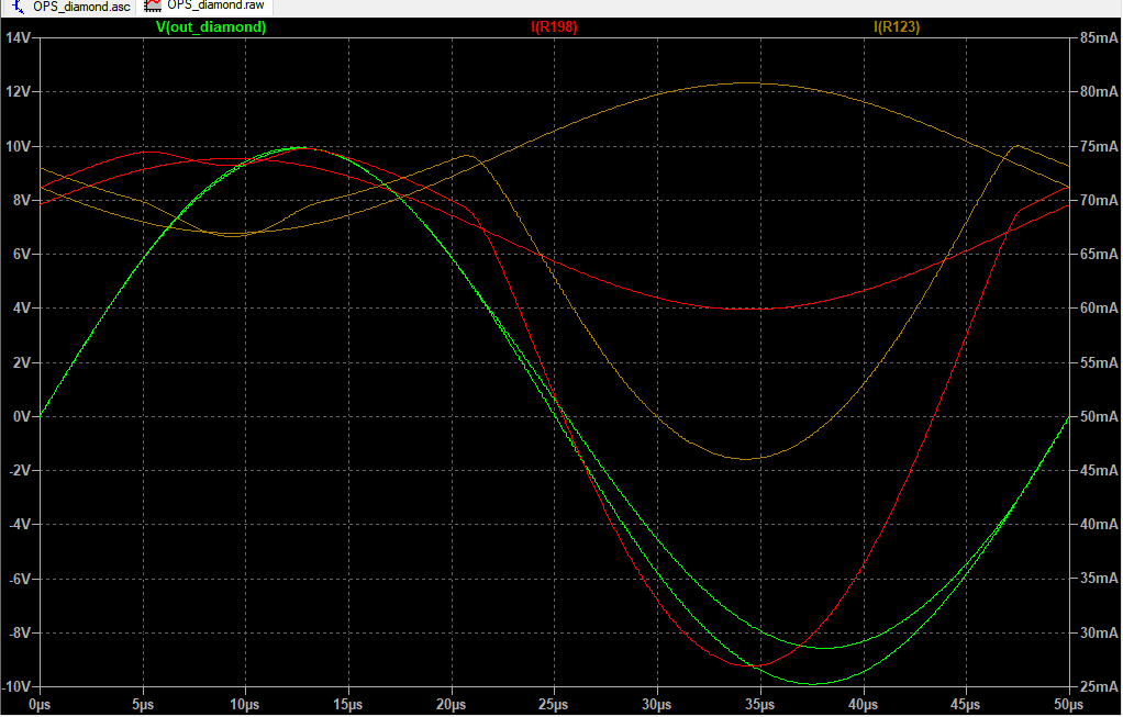

Here is the driver and OPS simulation file illustrating the issue in transient analysis.

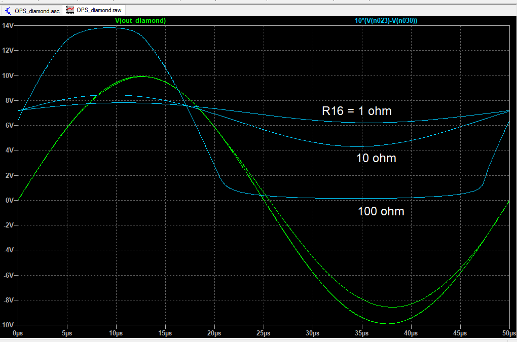

Hi Lee, I must confess I was not paying attention and made a mistake in working out the CCS current from the schematic by missing out one of its two paths -- I should have doubled what I thought to be the CCS current. So my calculated CCS current should have been 36 * 2 = 72mA. That was base on 2.4V Zener diode voltage drop.
The voltage drop over the Zener diodes at the operating current in the simulation is a lot higher than 2.4V, at 3.16V, so we are seeing very healthy 100mA CCS current. Your build matches that quite well.
The driver current plot in transient analysis shows no signs of starvation. Yet it does show the current discontinuity in the driver transistors when higher resistance R16 is in use.
The Vce plot of Q39 shows the driver transistor goes into saturation at R16 = 100 ohm. It's cascoded collector gets too much voltage drop over R16. (in the plot the Vce is blown up 10x for visibility)
The R16-C1 seem to need some special attention to keep the driver transistors from saturation under all valid audio signal conditions, plus some good margin.

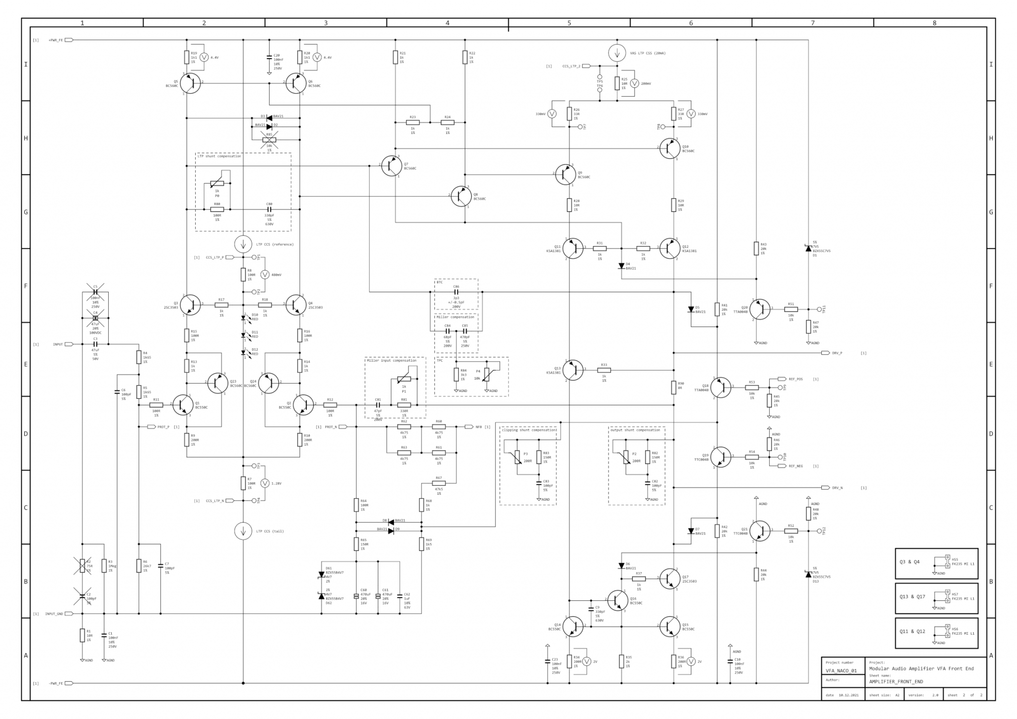

After taking a break for some time, I picked up this project again.

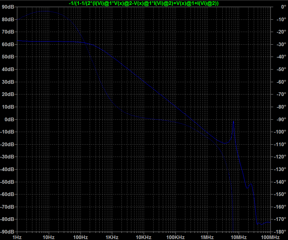

I figured out that there is probably nothing wrong with the diamond buffer output stage once R12 is low enough and C2 removed. I blindly coped this from Bob's design. This filter might work well in the original application Bob had in mind, but just doesn't seem to be a good idea in my application. For the time being, I also dropped C3 to be sure it doesn't get in the way finding the root cause of the oscillation.
I found out that the front end is the root cause for the oscillation, likely because the miller input compensation is not optimized.
The oscillation frequency is roughly equal the unity gain crossover frequency, which indicates that the miller compensation loop is not properly compensated.
I set the unity gain crossover pretty low to be on the safe side (~600kHz), but obviously this didn't help to get it right easily.
I experimented with optimizing the compensation and found that this is difficult in simulation.
In simulation, the amplifier seems to be more or less stable all the time regardless of how I tune the six components involved in compensation.
In reality, the setup optimized in simulation oscillates terribly on the bench, while the best working bench setup simulates terribly.

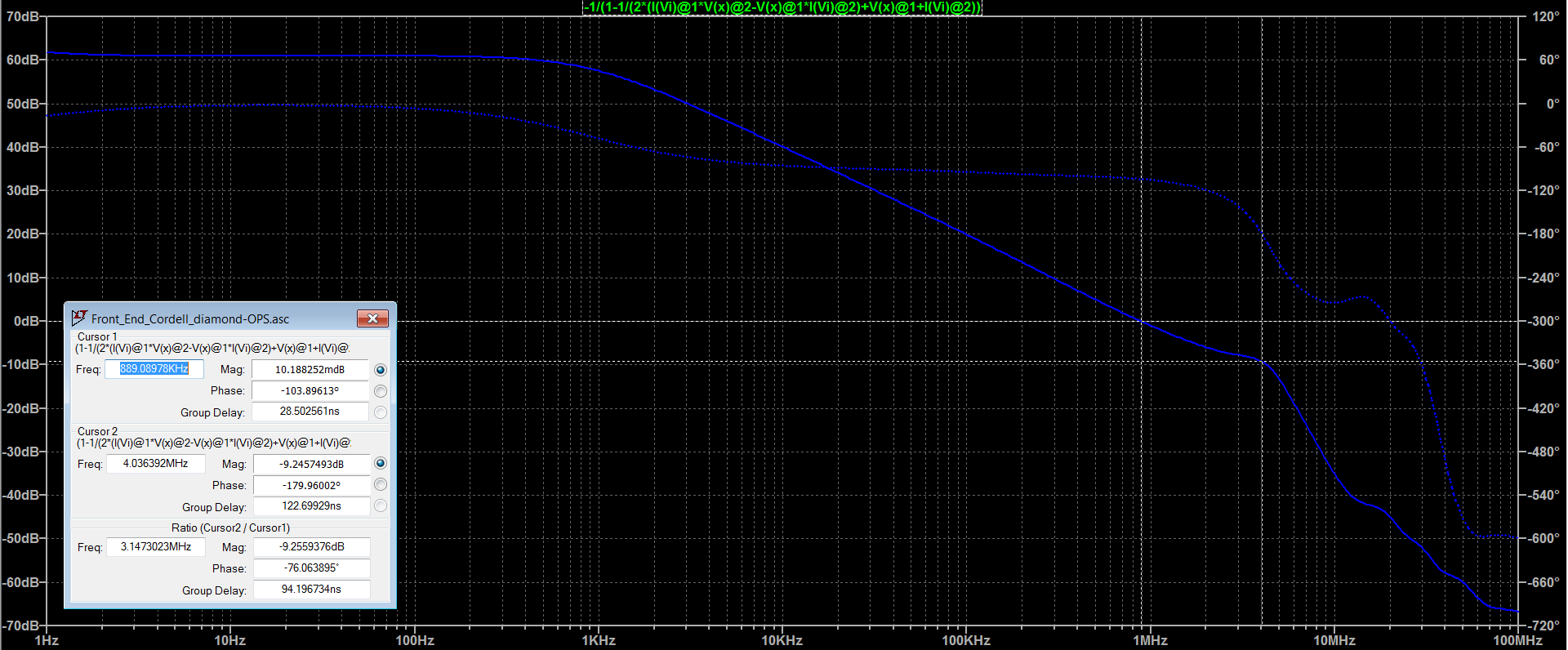

Finally I succeeded stabilizing the amplifier using the shared experience I found here on DIY Audio.
First I will explain how I stabilized the amp and later I will collect everything that helped me so that anybody trying to stabilize an amplifier using miller input compensation might enjoy this more than I did.
The biggest step towards a stable amplifier was lowering the gain from 40 to 20. I can't remember why I set the gain so high. This project is ongoing for years now with breaks in between of months and years. Sometimes it is as if a stranger designed my circuit and I just wonder about all the questionable design decisions.
With the gain set to 20 like in Bob's amp and book, everything makes much more sense.
I figured out, that by lowering the gain, I can keep the miller cap at 22pF and that the resistor in series with that cap is best at roughly 680 Ohm as proposed. I chose 750 Ohm. This results in a unity gain crossover frequency of roughly 900kHz in my case. Note that the other compensation components also influence the crossover frequency (to lower).
The shunt at the output of the VAS is recommended to have the same time constant like the miller cap and the resistor in series with it. I chose the shunt cap to be 100pF since a higher value has helped previously when the gain was higher. Bob recommends 50pF, but also has observed that higher values may contribute to stability in certain cases. With the shunt cap being 100pF, the shunt resistor in series would need to be 165 Ohm. I chose 150 Ohm because this is the closest value I have at home.
With four of the six compensation components set, the lag compensation of the LTP can be optimized. I started with 150pF and a few hundred Ohm and experimented until I found the optimum values. This was outright unstable.
I quickly found out that the resistor should be much higher in my case than in the examples. The zero formed by the resistor seems extremely important for stability. 1kOhm was not enough and I settled for 1k5. The effect of the resistor is clearly visible in simulation. Neither too low isn't good, nor too high.
The effect of the capacitor isn't obvious from the simulation I did. Maybe this is because I'm not really good at simulating circuits. The higher, the more stable, but once a certain value is exceeded, stability is lost again. I didn't try a larger cap than 330pF.

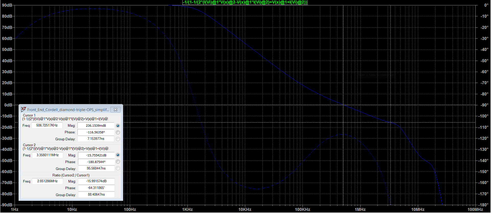

The tricky point is well visible from the loop-gain plot. At roughly 4Mhz, where the phase drops quickly, there is a tendency for a gain peak to occur. It is difficult to find a proper balance of the components compensating the miller loop to not create a gain peak here.
What makes MIC so complicated to optimize is that so many components are involved. A seemingly infinite number of combinations can yield the same (apparently stable) result, which is not stable in reality.
I think the best order to set component values is:
1. The miller cap
2. The resistor in series with the miller cap
3. The shunt resistor at the VAS output (with the shunt cap being a fixed value of maybe 50 to 100 pF)
4. The compensation of the miller loop in the LTP

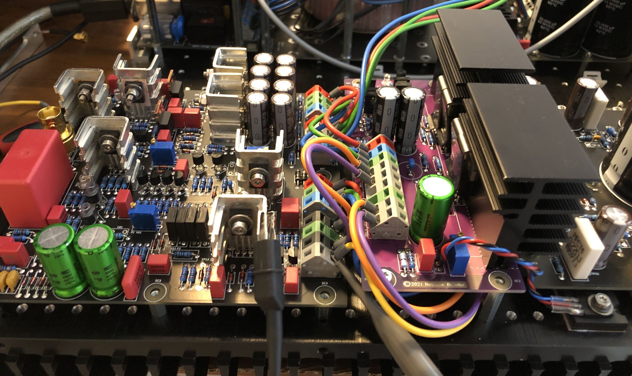

Once the amp oscillates, there is smoke for sure and it takes less than a second after onset of oscillation to show up.
Oscillation at ~500kHz does not do as much damage as oscillation at ~4MHz.
With the gain set to 40, the oscillation occurred at ~500kHz and with the gain set to 20, I mostly had oscillation at maybe 4MHz (couldn't measure that quickly).
Once the amp started to oscillate, the oscillation was persistent until I pulled the plug.
I burned several 15Ohm resistors at the loudspeaker output shunt (R51 and R52 in the OPS schematic). Meanwhile I replaced the two parallel 15Ohm resistors by one 10Ohm 4Watt metal oxide resistor I found in the resistors box. The output inductor apparently does not save the shunt at the loudspeaker terminal from high frequency.
I haven't understood yet why I also burned several ground breaker resistors (R1 in the front end schematic). Maybe this has saved other components from burning down.

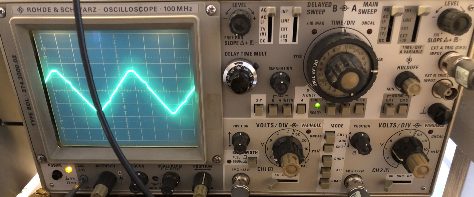

At the moment, the amp is pretty stable, showing only a bit of overshoot at the square wave corners, and tolerates some capacitance as (only) load connected after the output inductor. I tried 33nF, 100nF, 1uF and 2.2uF and there is just a bit more overshoot at the corner of the square wave.
In simulation it is tolerable to connect up to 100nF as load prior to the inductor.
So far, I'm pleased and will investigate how to further tweak the circuit for better performance.

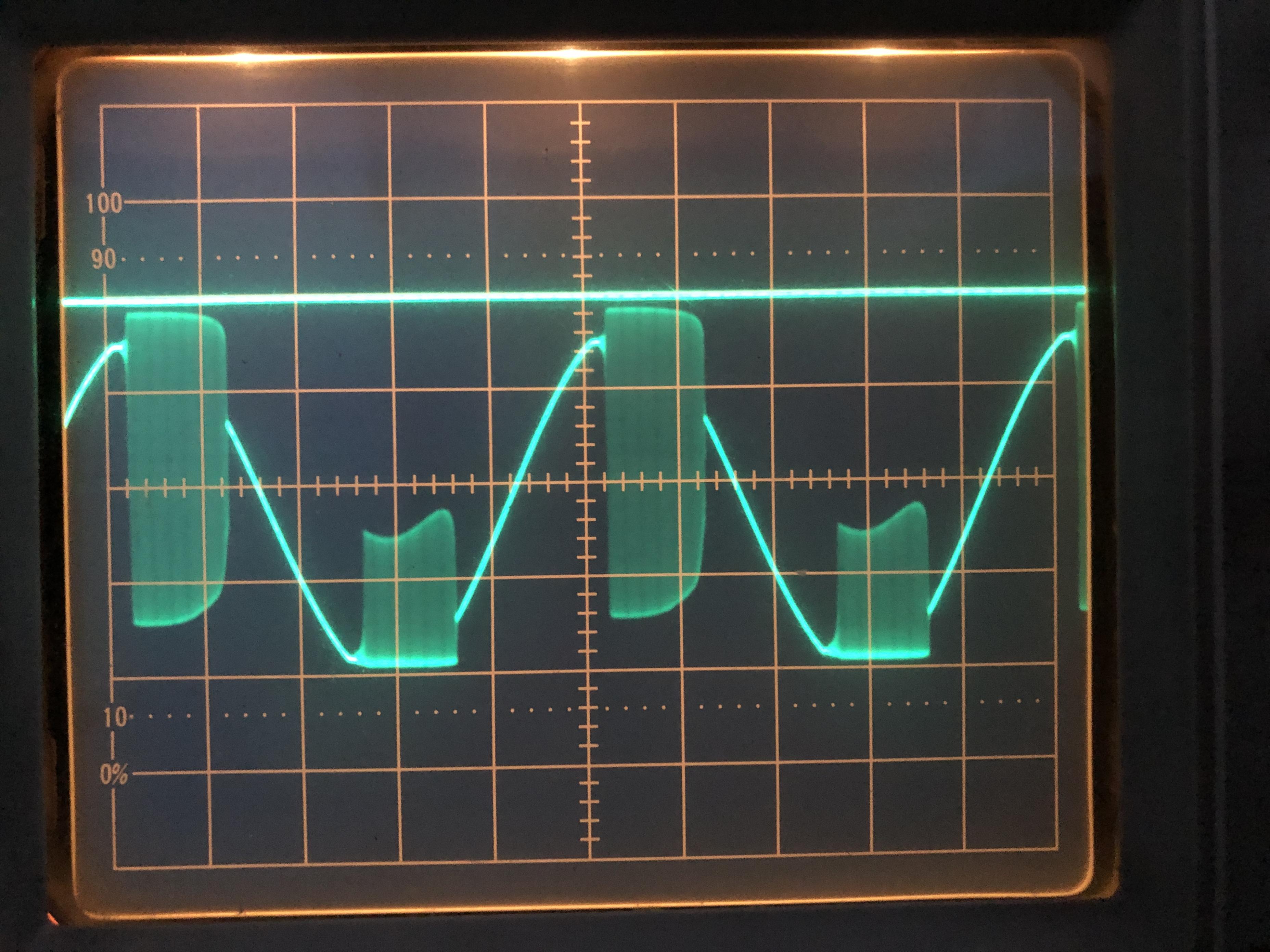

While the square wave tests looked promising, there probably was a mistake in the setup: Due to a soldering issue, the loopgain was collapsed significantly. I can't remember exactly when I found this out.
Also, square wave input was only 0.3Vpp so with a gain of ~20, this was not a large output voltage.
When I proceeded to sine wave testing at higher volume, I discovered a lot of instability that plagues me for many weeks now.
Meanwhile I replaced all resistors involved in the compensation with trimpots in order to quickly change compensation.
An important omission in the first design was the R-C shunt at the node where the clipped signal is conducted to. I added this to the assembly and it improved stability during clipping.
I also replaced the driver transistors (TTA/TTC) by BD139 / BD140 because I believe they are better suited in such extremely low Vce applications.
However, I'm still far from a stable amp.

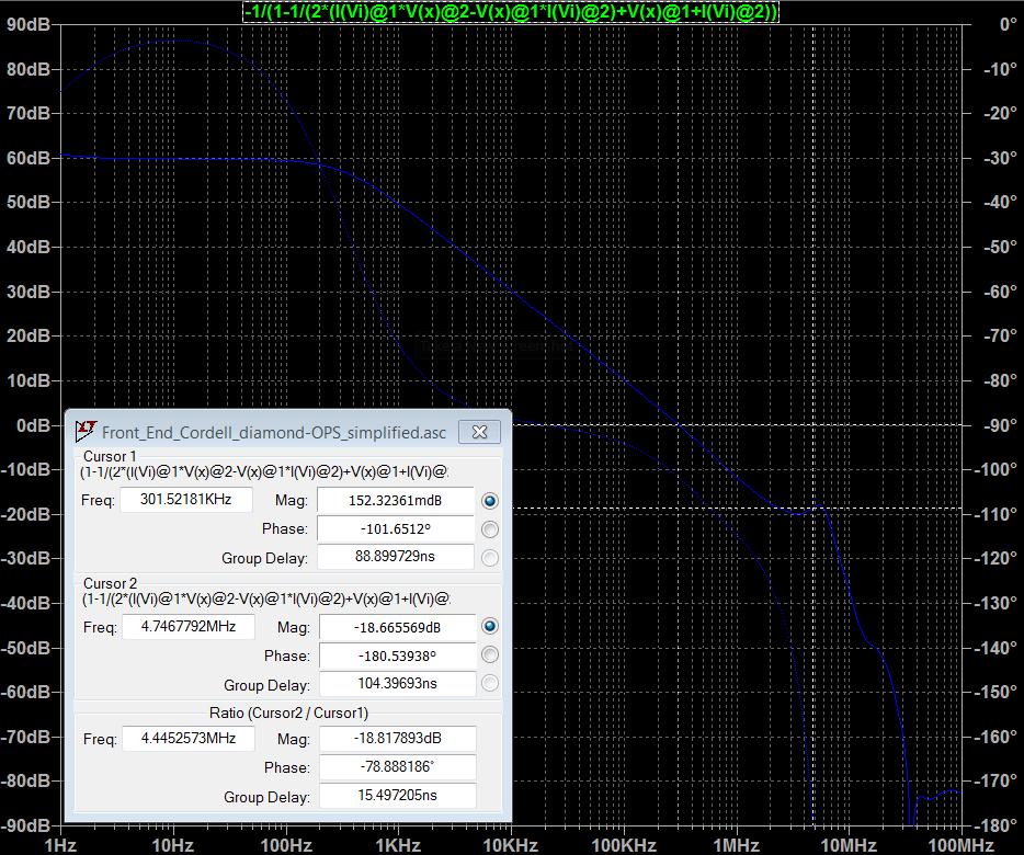

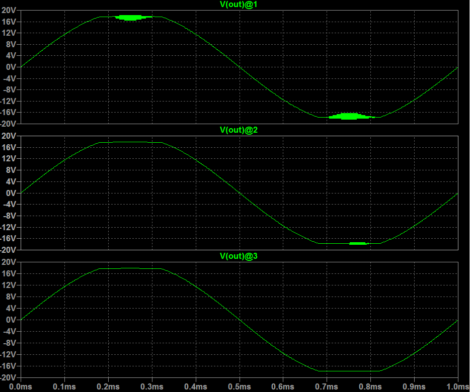

Please find attached simplified LT Spice file in case you like to play with the circuit. This is currenly a mix of what I built and what I plan to improve in the next revision.
In simulation, the amp is still easy to get stable and performs well. Reality disagrees.
Even worse, reality is the exact opposite: Setups that should be totally unstable in simulation work somewhat well in reality and vice versa.

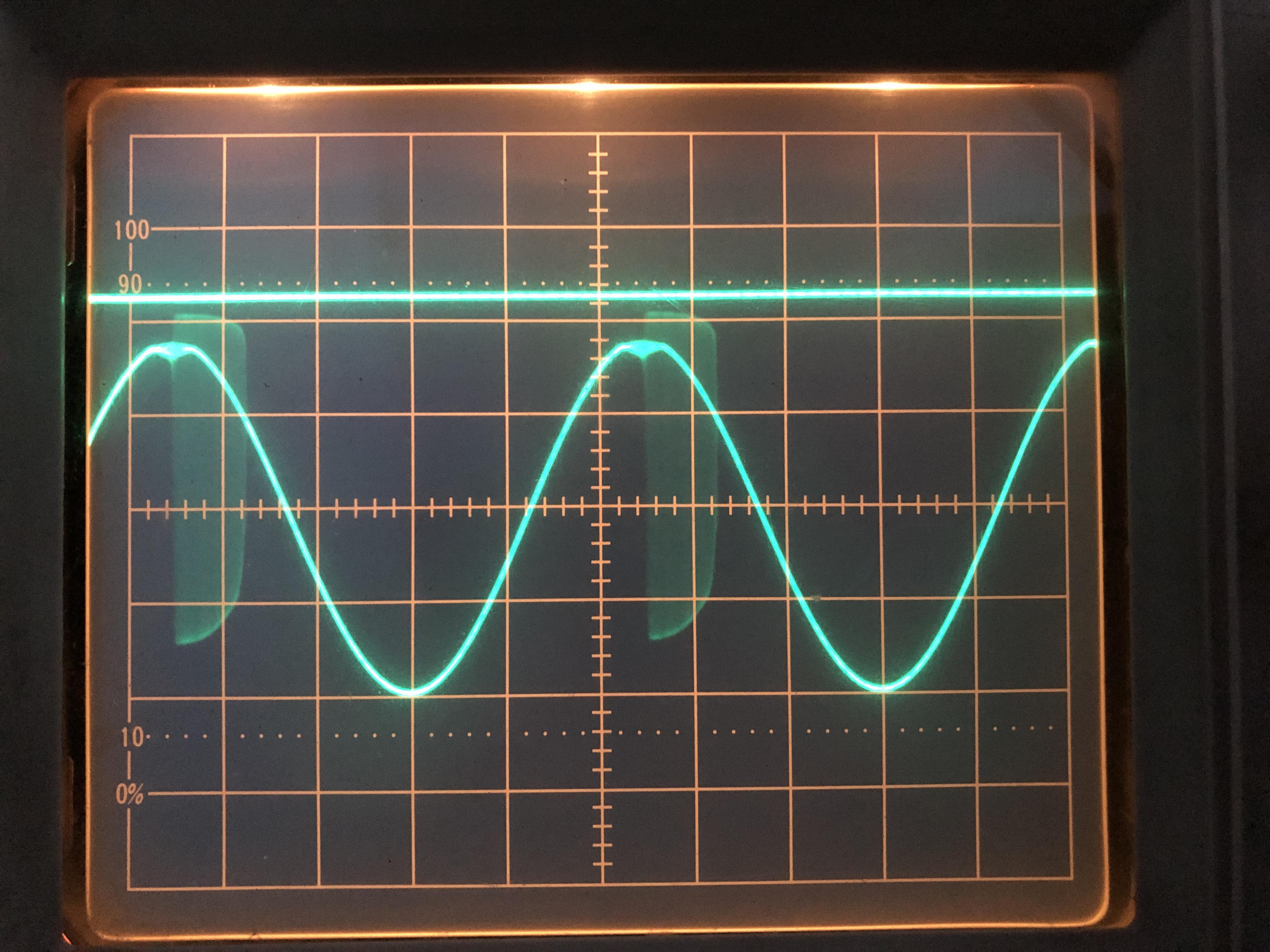

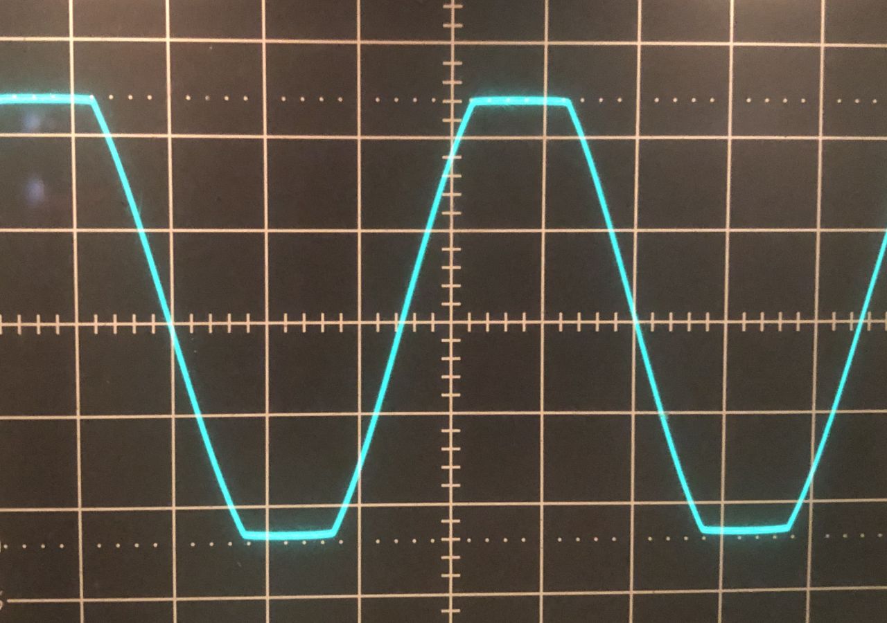

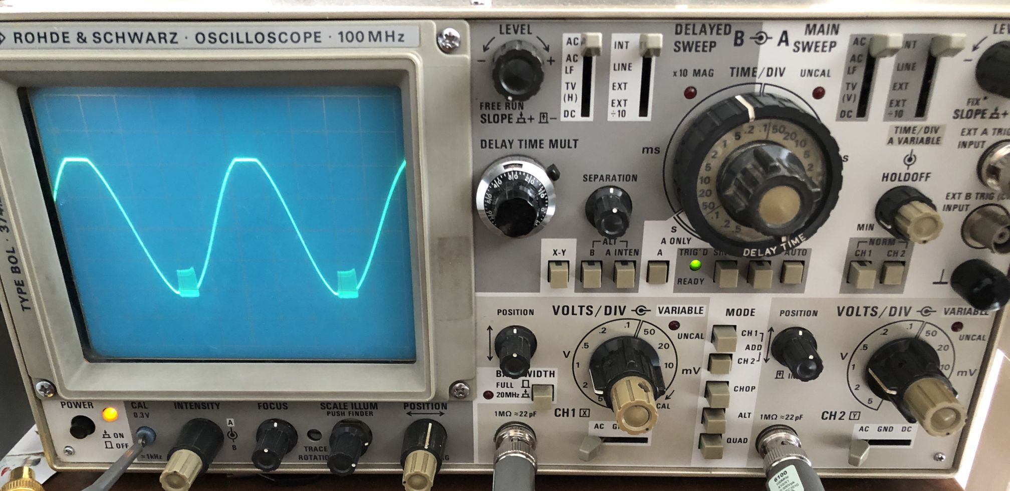

Here are some screenshots of clipping.
What I find odd is that the positive clips earlier despite the clipping references being exactly same voltage.
The worse picture was taken during power up. This shouldn’t look worse because according to simulation, the amp powers up well behaved.

I increased the Miller capacitor dramatically to see how much it would take to get rid of the oscillation.
Maybe 47pF would have been enough, but at 100pF and the potentiometers optimized, it is almost stable now.
When I put the numbers into simulation, I saw that not only the unity gain crossover frequency has dropped to ridiculously low 300kHz, but now something became visible that was hidden before: A gain peak at 3-4MHz. This is where the phase turns -180°.
This gain peak probably has been there all the time, but was covered by much higher ULGF before.

My prototype of the front end with all the improvised changes and additions increasingly fell apart during experiments and I decided to continue with a new PCB revision that includes all changes I improvised plus some small improvements.
Among the improvements are more compensation options like simple Miller compensation, TPC and BTC.
There is a trimpot option for most resistors of the compensation network. This is really fun to experiment with.
I also went back to simulation and figured out that MIC with less than 47pF Miller capacitor won't work with that powerful output stage.
TPC / BTC looks very promising, allowing me to lower UGLF in order to maintain stability with the huge OPS and a lot of NFB at 20kHz.
Attached is the schematic of the revison 2 board.

Since I could not figure out whether the front end or the driver stage is to blame for all the weird instability, I also designed a different driver stage.
This is a pretty textbook like diamond driver stage, that forms a diamond buffered triple together with the output stage.
The CCS output 10mA.

The config with the diamond driver is totally weird:
It oscillates right away with no input signal at roughly 200kHz in triangular shape.
When I used this with MIC, briefly connecting and removing an additional Miller cap (C86) stopped the oscillation and the amp worked fine until it broke into oscillation again eventually. I was hoping that is goes away with plain Miller or TPC, but it doesn't.

P0 is set to 470 Ohm and P4 surprised me to provide most stability at 1k5, which shapes the TPC slope pretty aggressively.
Attached is the loopgain plot with the DBT OPS. I guess that with the folded driver, this would not look much different.
There are many loopgain plots in simulation that indicate stability, but only a fraction of configurations is somewhat stable in reality.
Testing for stability, I attached capacitors at the output prior to the inductor.
Square wave shows a little overshoot typical for TPC.
Note that I have the low pass filter caps at the input installed.
Adding caps at the output shows no effect on overshoot until:
At 6n8, suddenly there is some sustained oscillation on top of the square waves.
I had expected that slightly lower values show some damped ringing already.
And somehow I expected to see that the amp tolerates more capacitive disturbance.
I would guess that the stability margin is not large.
Note my squares are only +/-3V at the output.

With the OPS configured as DBT, I still have the triangular oscillation.
The "old trick" to stop this by temporary tampering with the compensation still works:
Briefly connecting 100pF at C81 (MIC cap) stalls the oscillation and the amp works nicely.
Even clipping sinewaves is well behaved.
In order to revert to the unstable condition, cycling the power is enough and at next startup, the amp oscillates again.
BTW: The nice and smooth clipping is one of the main objectives for this design.
