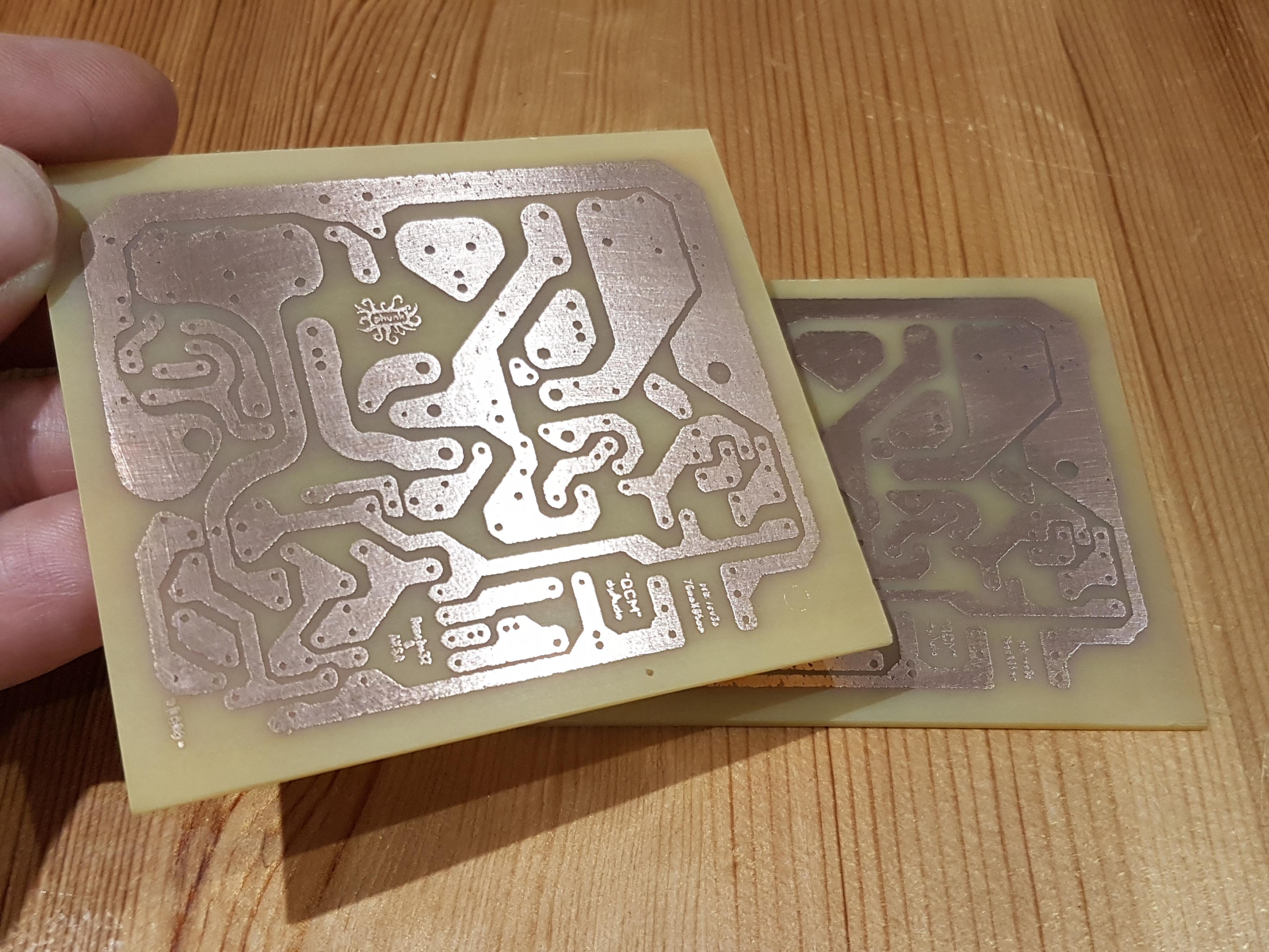

I thought I would have a go at etching my first boards - far from perfect 🙂 Thanks for the files Phunk! I have some pcb drill bits arriving tomorrow so I should be able to finish them off.
For rev.3 is the attached parts list the most up to date and compatible with Phunks layout?

Nice work and looks great even for a first board. What a coincidence I just etched my first board too - a simple hand drawn layout using nail polish. Those drill bits break really easy so be sure to get extras.
Here is my very first home etched board - a single ended classs A head amp.
What did you use for the iron on transfer or did you use photo resist?
Thanks. Your head amp looks tiny! Which one did you build - do you have link? I may try and build Juma's head amp
I printed on the shiny backing paper of a sheet of Avery labels. I found it much quicker and it didn't require so much heat. It also peels off without having to soak in water.
Sticker backing paper is a good idea. I always thought that was too waxy to work.
