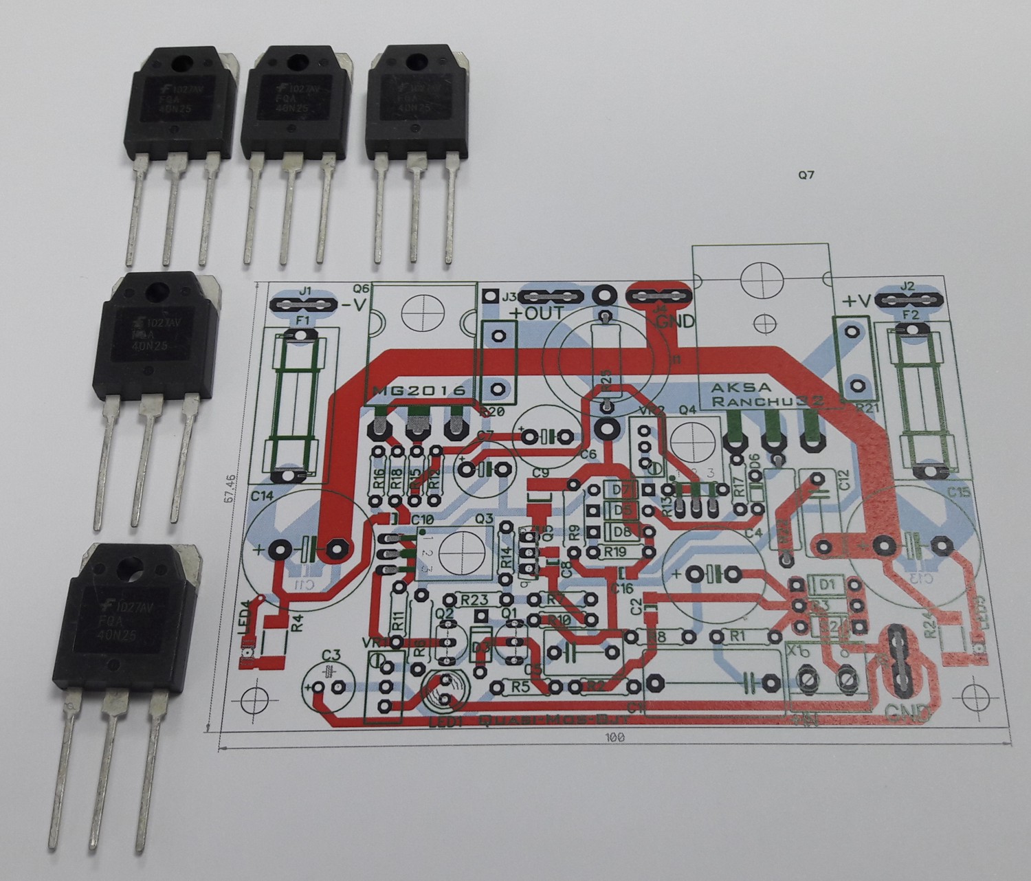

Which one are you building? as per my layout, C2/C10 should preferably be a NPO/C0G 220pF cap. C5 should be preferably be a silver mica as per recommendation from AKSA.

Hello everyone
A member of the forum generously gave me a set of PCBs designed by prasi but I have a small question.
For the capacitor C4 it is given for 2200uF/16V but on the PCB the location is small, what value can one put?
Thank you.
Thank you.
Hi, i think there are plenty of options available in 10mm dia cap. 2200µF 16V Leaded Aluminium Electrolytic Capacitors | element14 IndiaHello everyone
Thank you.
you may go even lower voltage like 10v/6.3v and still be fine...
I have Nichicon KA 2200uF/6.3V.you may go even lower voltage like 10v/6.3v and still be fine...
Thank you prasi! 🙂

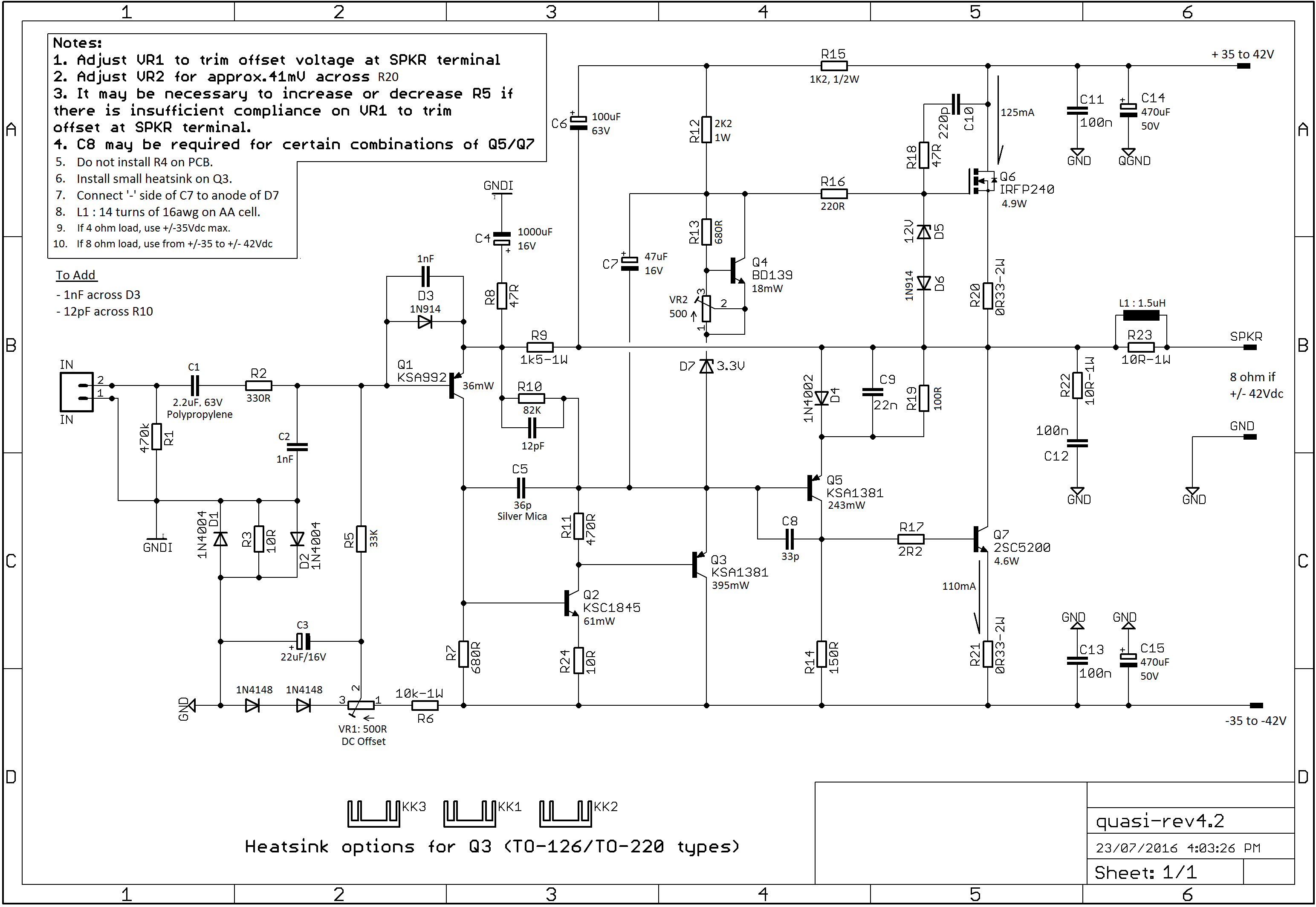

Salut Olivier,
Have a look at the attached schematics, I have added many notes on the left side of the schematics. It shows how to build L1 and a few items to add.
BR,
Eric
BR,
Eric
That's a very comprehensive schematic Eric, thanks for posting.Salut Olivier,
BR,
Eric

Salut Eric.
I had not followed everything but now I have all the necessary information to carry out this project.
Thank you!
Thank you!
