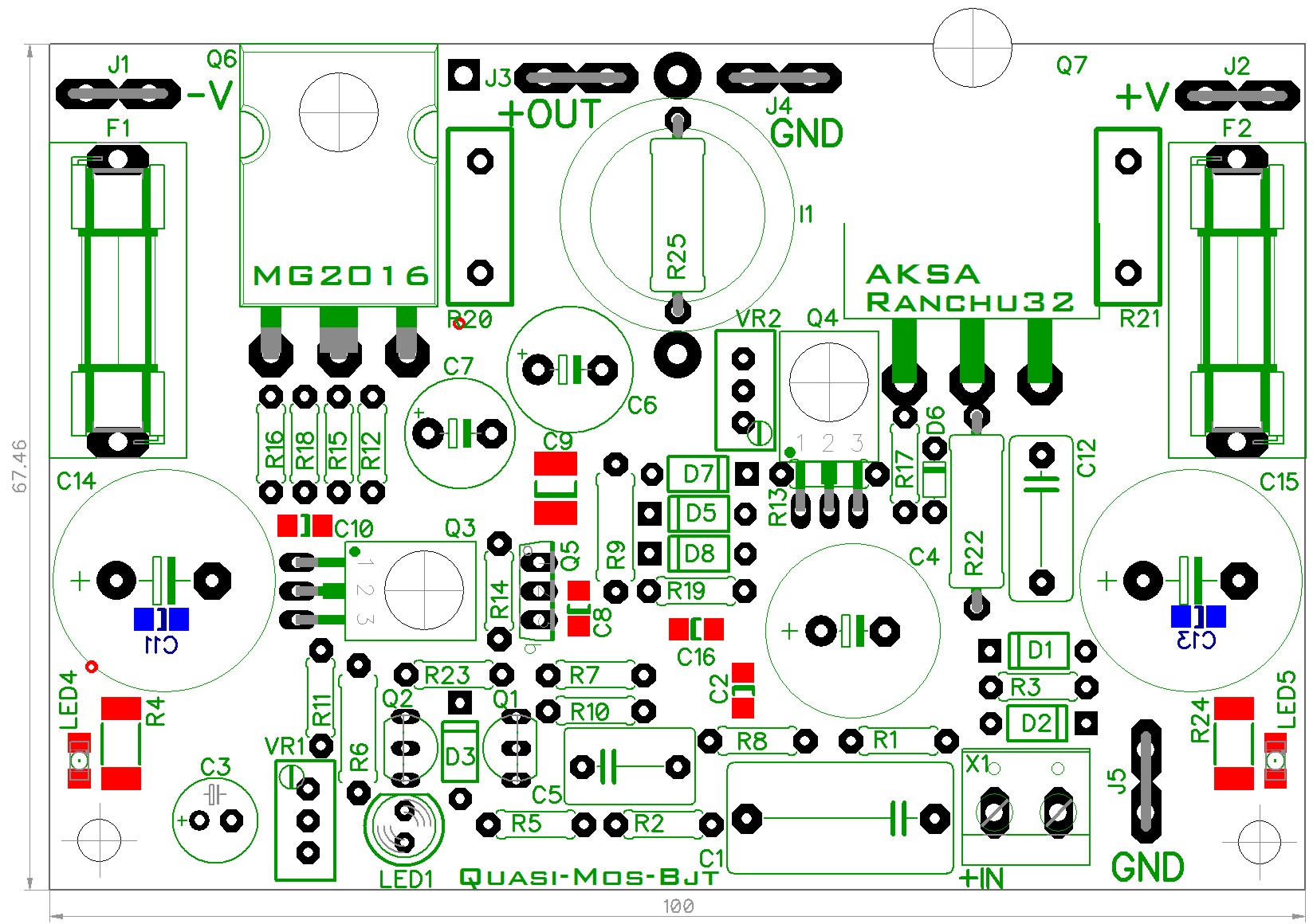

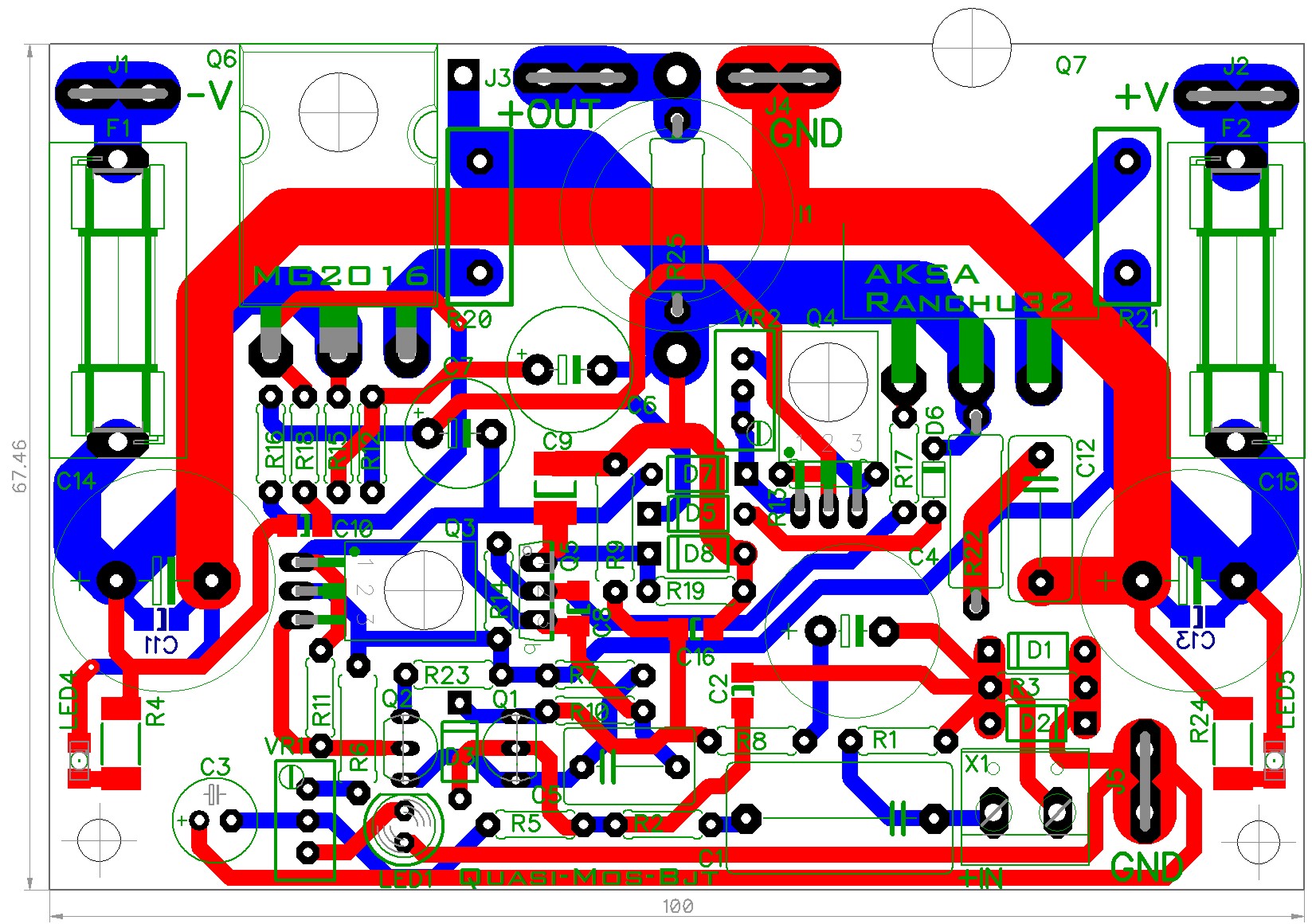

That 3rd picture, is that some kind of flower power option in your CAD program and if so what's the name of the program, nonetheless beautiful. 🙂
Hi maiko
I'm using Sprint.The tracks was formed by using curves & arcs joined and filled with "zones".It was a bit slow going at first but it picked up pace as I went along.It was also my first time using Sprint,so I played around a bit.
Regards
phunk

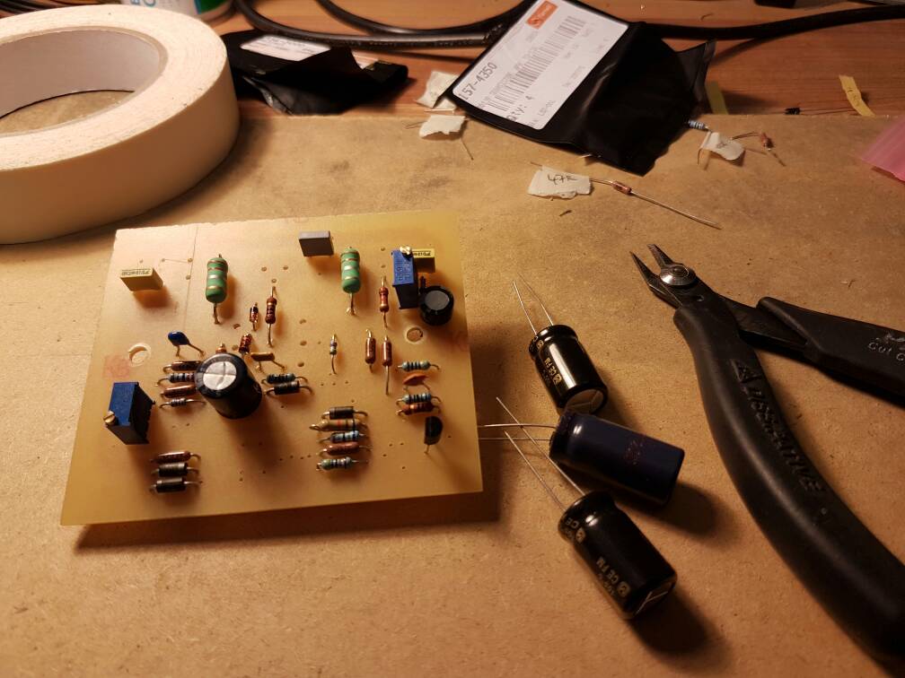

You may use 2W without any problems for r20/21 as its what the original design specified.Hi All
I have started soldering and noticed that Phunk specified 5w resistors at r20 and 21. I have 2w. Is that okay?
He also has 1k8 1w at R9. I have 1k5 - is this still within spec?
Many thanks
Richard
Sent from my SM-G935F using Tapatalk
i believe, R9= 1k5 was the original spec.
however you could use a series of resistors to give equivalent value.

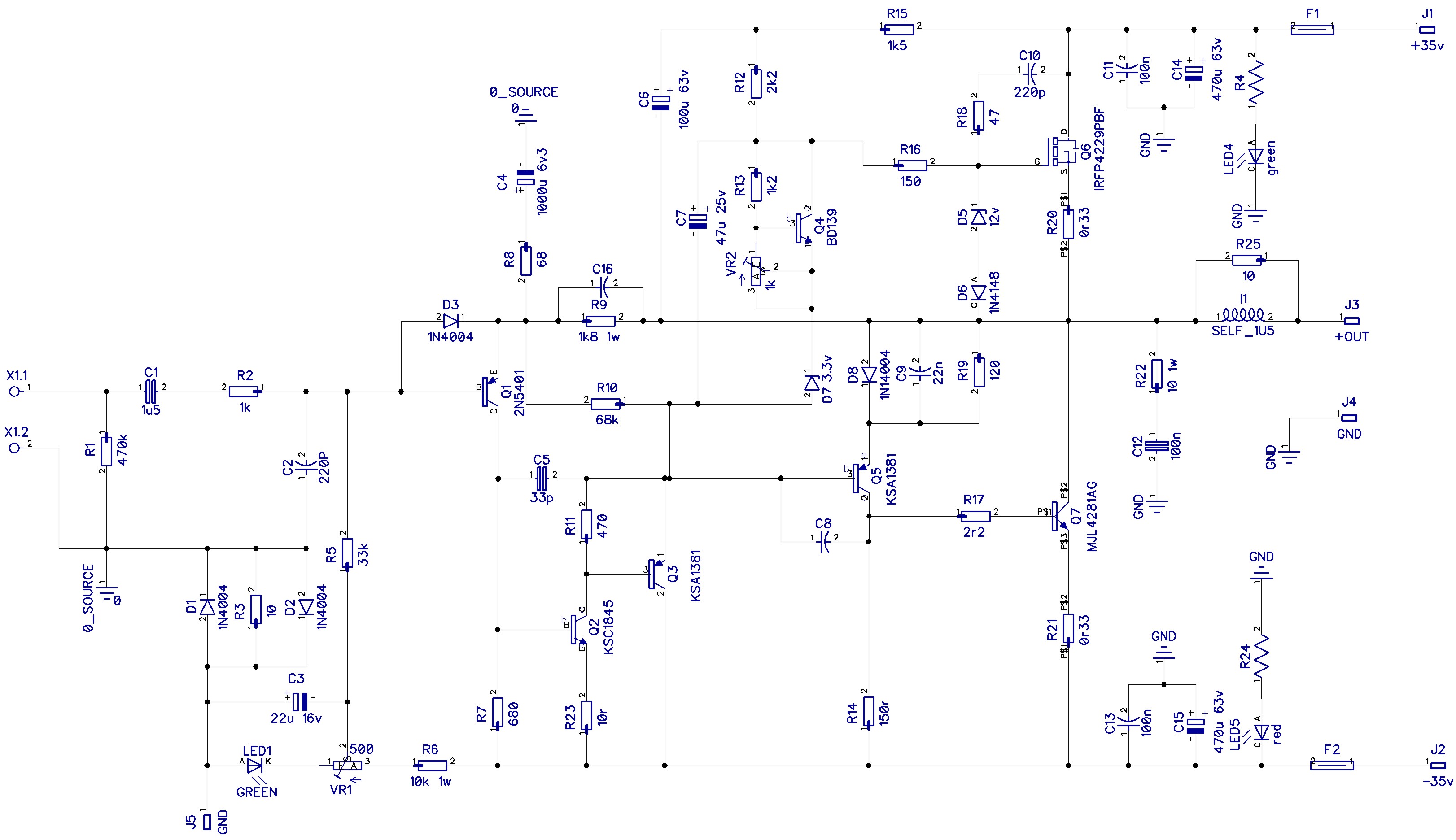

Ho ho ho the Sinterclaas too early
Great work Marc.
Now can start the next run to build.
And i see in schema the IRFP4229.....hmmm.
Great work Marc.
Great work Marc.
You can use either IRFP4229/FQA40N25 and severel other devices Aksa gives in this thread....I chose the FQA40N25 instead IRP4229
