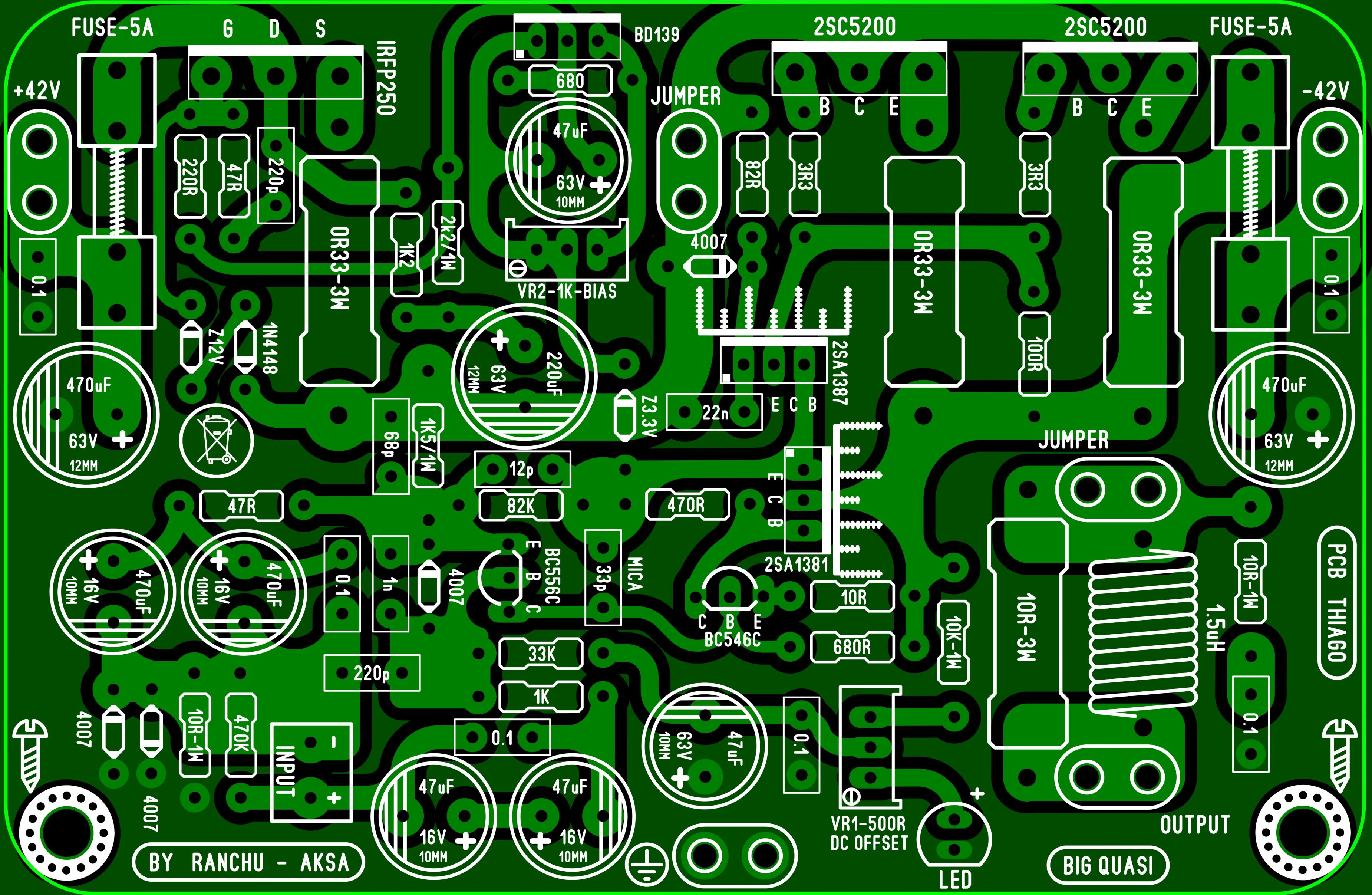

It seems a bit quiet here,so let get to more quasi.I`ve got a surprise and i think you will like it.The layout was promised last week and i`ve been trying to upload since last week Tuesday on my cellphone.Definitely a nightmare.
Without further ado,let`s get cracking.
First a thanks to everyone for the positve feedback.I`ve made a couple of changes which i think is for the better.
Let`s not drag this out and let the layout speak.
Regards
phunk
ps:There are gerbers,pdf`s and a Sprint lay file of each version in the zip files.
nice curvy layout!. small correction on silk, c2 220p.

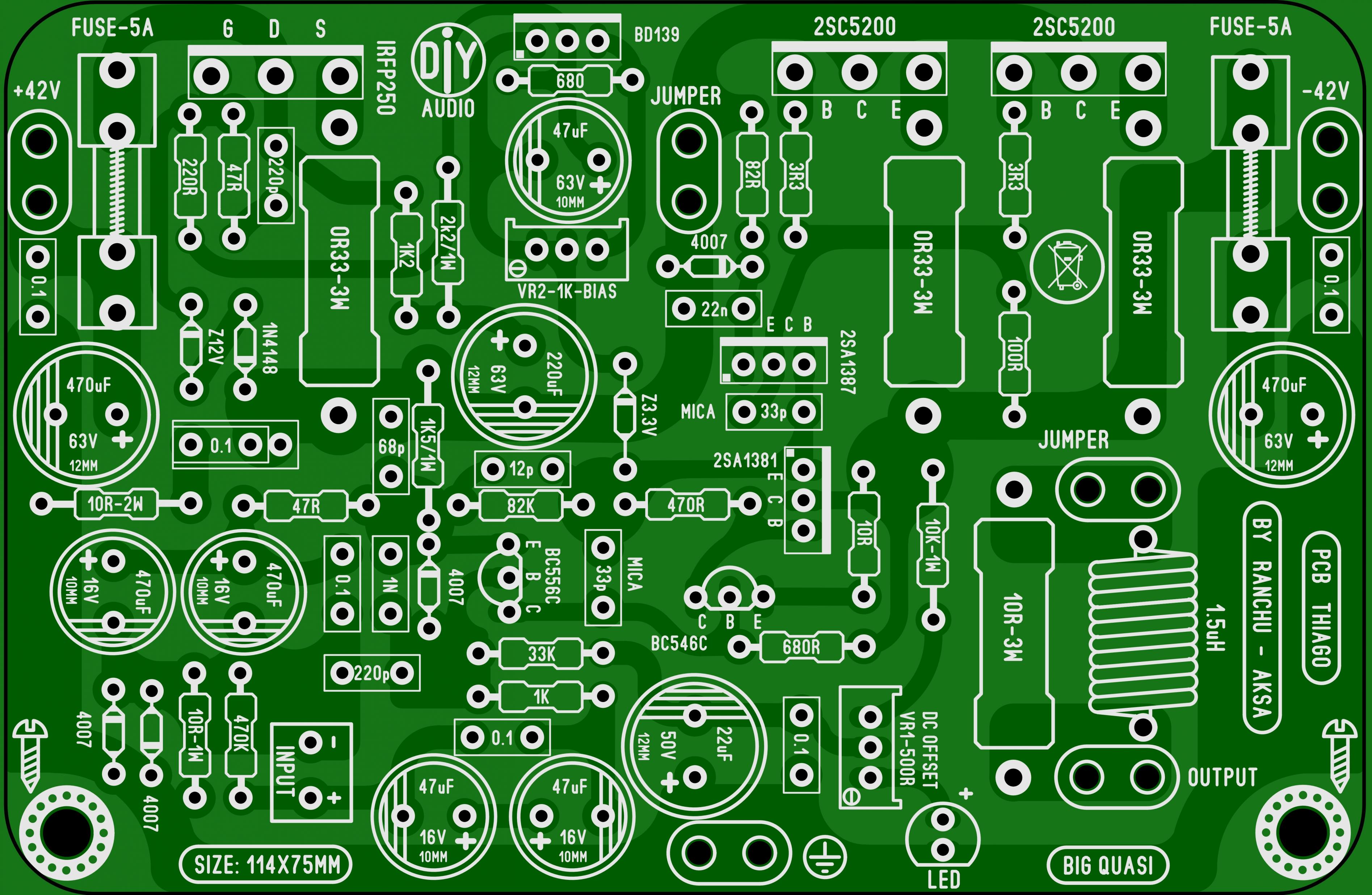

pic 3 looks very like the hand drawn traces one found in 1970s manufacture, before CAD was allowed to take over our thinking. Very retro and nice.

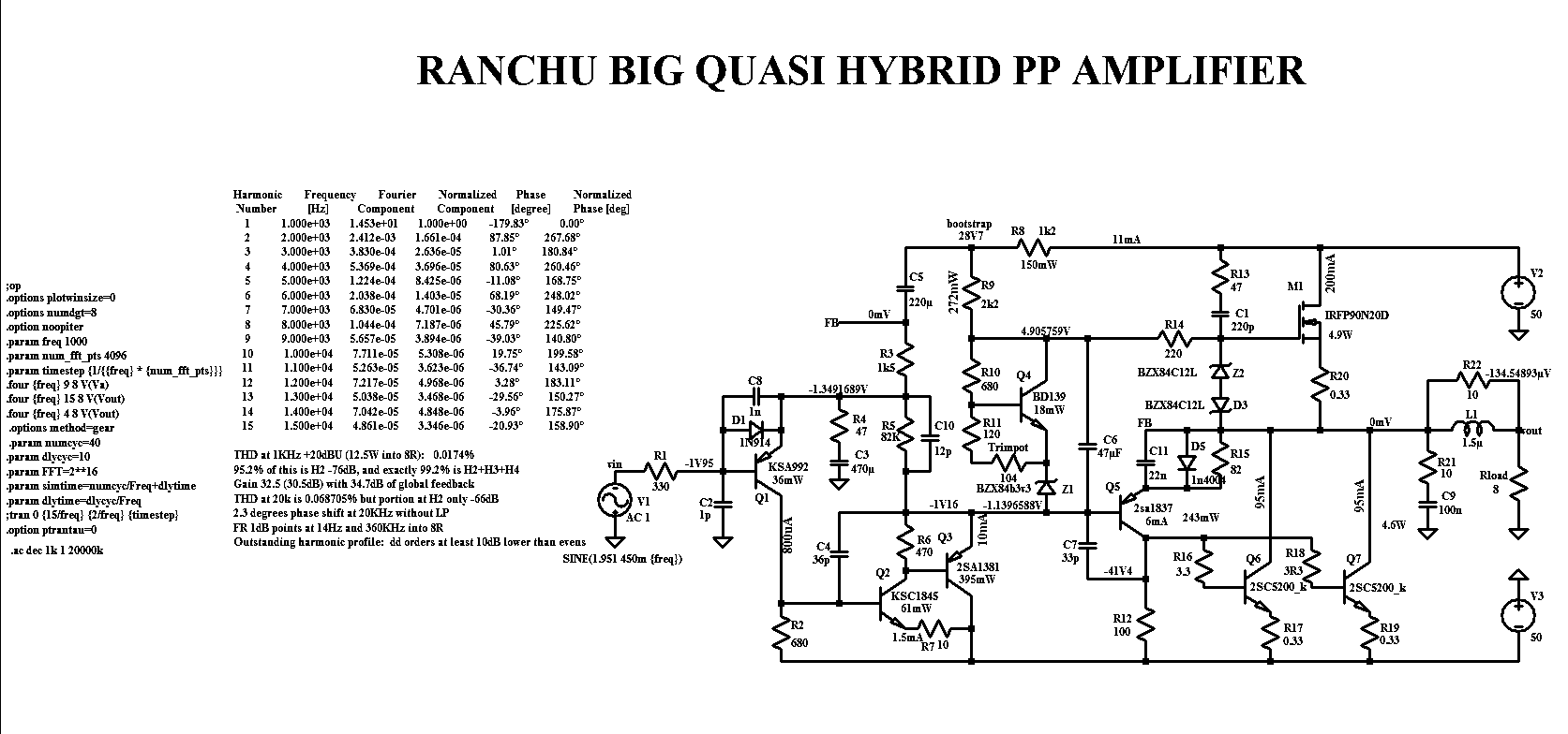

BIG QUASI
Hi All
I haven't built anything for several years but I'm keen to start a new project. I've been following this thread and fancy etching my first boards. I'll start this tomorrow. I can make the under mounted fets work with my heatsinks, but it may be easier if they were located at the side of the board. Has someone designed a board that I may have missed? No worries if not 🙂
Many thanks
Richard

Thiagomogi's layout above is for vertical mounted heatsink.

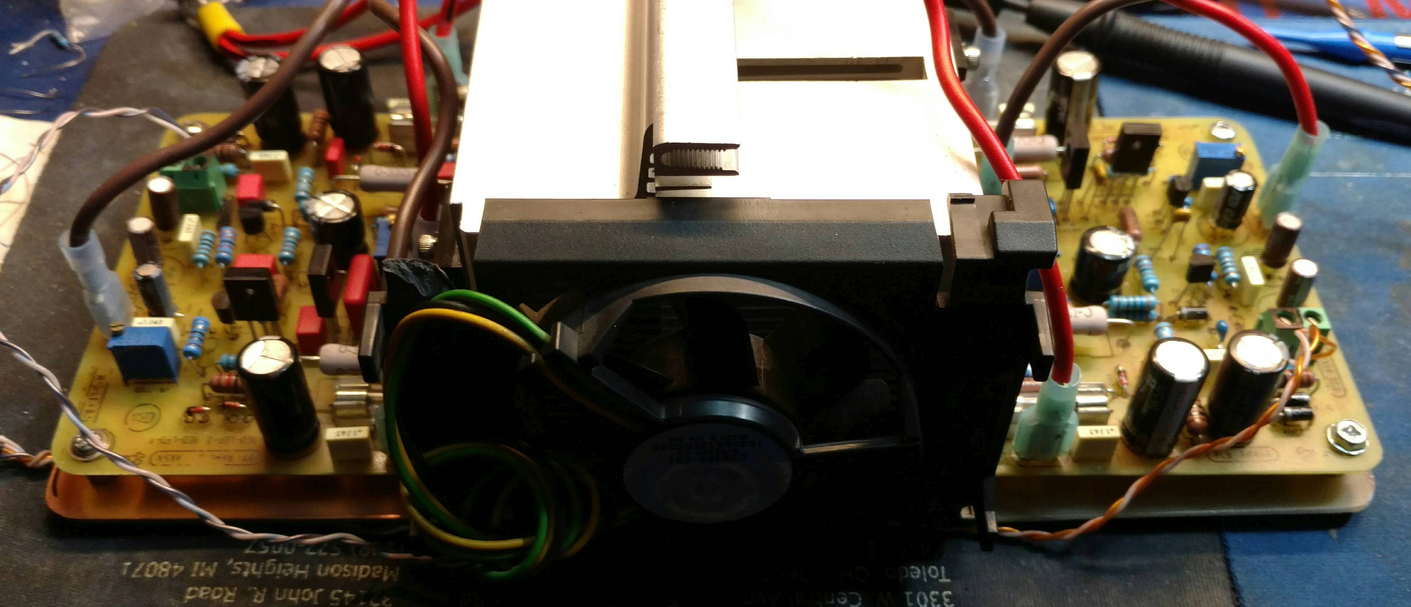

This thread moves fast! new layouts and now a Big Quasi...
Tonight I listened for 2 hrs with headphones and it does sound good.
I loaded the output with 7R 15W resistors and ran the 50R phones off that.
the first one was built with whatever compensation caps I had, mostly MLCC and closest value.
the second board uses wilma MKP and so thought I might hear some difference.
Square wave response shows some spikes on the side I used the correct value cap's.
the output coils are not installed, are they needed for testing? or just for speaker duty?
my understanding is they protect the amp from the speakers.
anyway Great thread, and Thanks
